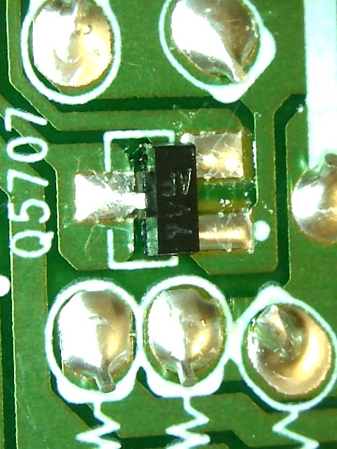

    trying to identify this transistor
    its from a denon amp where one channel burnt up a couple resistors and transistors.

    Uh what marking codes do you read? You're a little closer to the part than a jpg.
    What model number?
    You can try wet the top or find the same transistor somewhere else to better read it.

          Re: SMD transistor ?
          [QUOTE=redwire;1262196]Uh what marking codes do you read? You're a little closer to the part than a jpg.
          to me looks like the markings on it are YV and AF sideways

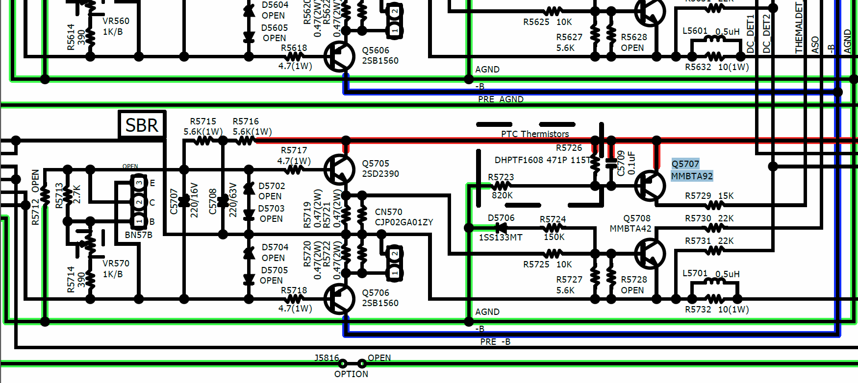

            Re: denon avr-s730h amp SMD transistor ?
            Q5707
              thank you that's exactly what i needed
                Q5707 not likely to fail, it has resistors all around it and even then it's just the over-temp detection with the thermistor. SOT-23 SMD marking code YM MMBTA92.
                Not sure why Denon left out the over-current protection diodes like D5702-D5705.
                The bias transistor I could not find data on a BN57B. It would get blown if an output transistor fails, and it's on the heatsink. Something to check.
                  BN57B seems to be a plug location, BN51B ~ BN57B for Bias Transistor q2104 ktc3964 mounted on a small board
                    what failed was q5105 and q5106 where shorted along with q2104 on the small board on the heatsink plugs in at bn51b. also resistors r5117,r5118,r5119and r5121 were all burnt.
                    was only checking q5107 because i get a different reading on that part then every other channel (the pic i used was q5707 same part different channel )
