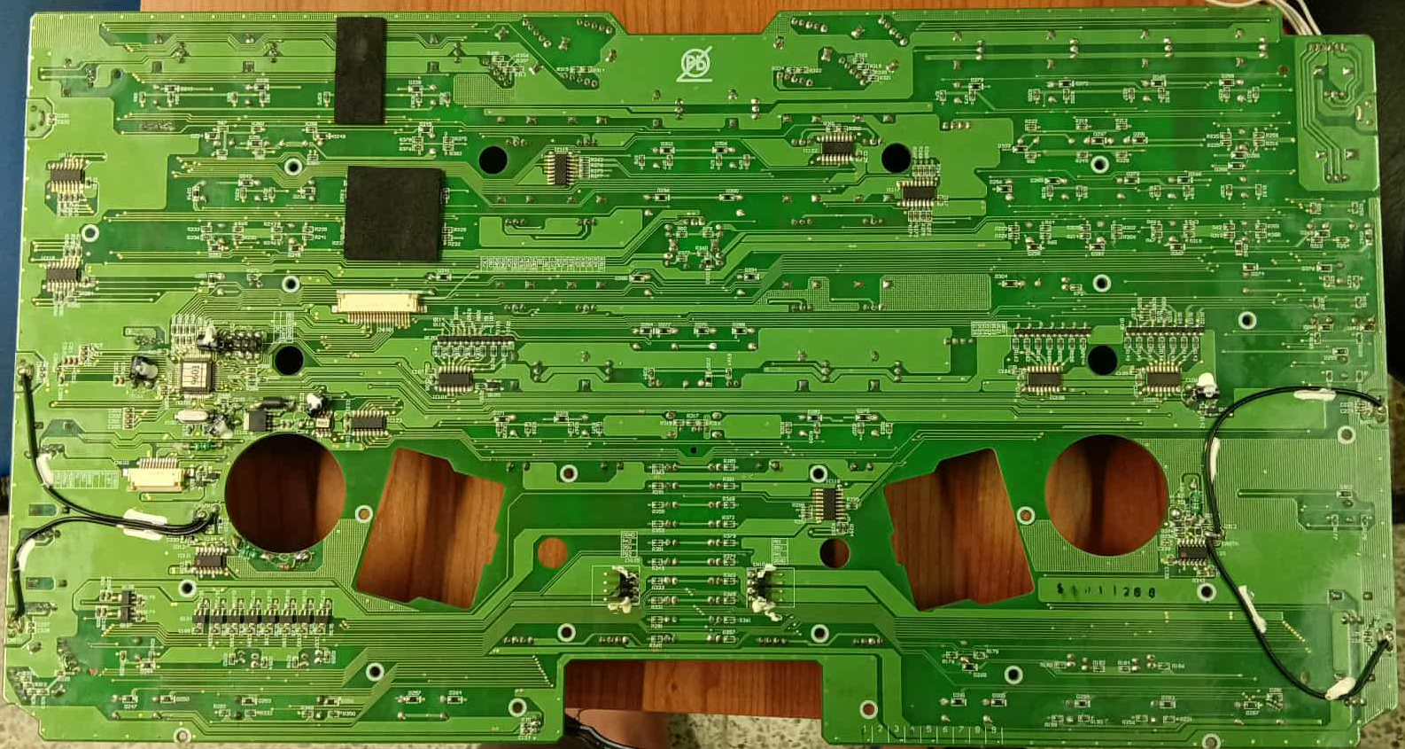

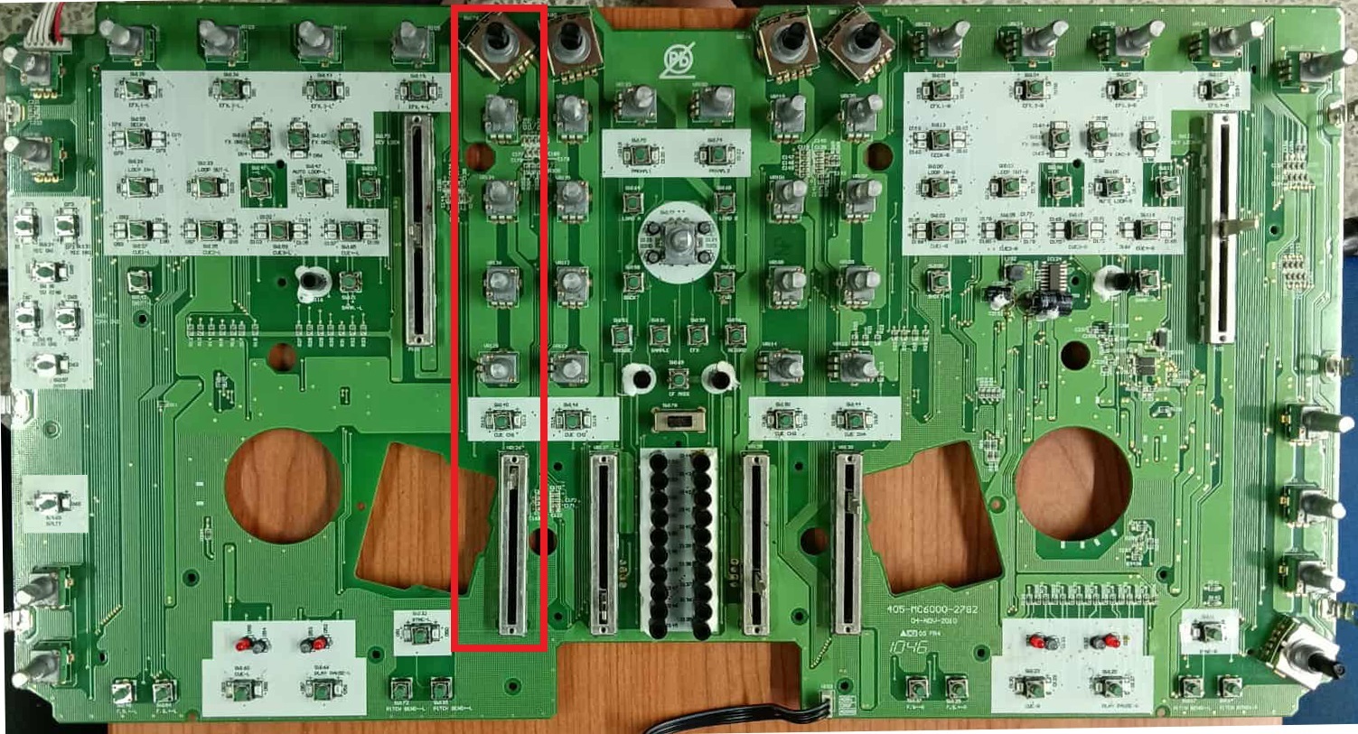

    Hello
    I need your help with a non-functioning channel on this Denon controller. I noticed the problem because, with the mixing software, the channel appears completely off and none of its controls work. At the top of the channel, like the others, there's a selector switch that moves between MIDI and external audio inputs. I also tried connecting an audio source (since it's also a standalone mixer) and I got no input. The flat cable connecting this panel to the sound card is fine. I'm attaching a photo and the service manual. I hope someone can help me resolve the issue. Thanks.

          I solved the problem, it was the 4 position switch with the broken tab inside sw179
