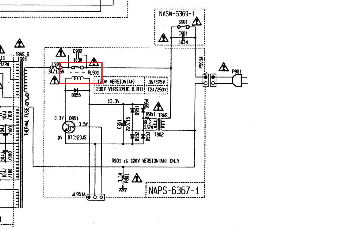

    Everyone -- I am trying to troubleshoot my NAD C740 stereo receiver, which either won't power on or won't consistently stay powered on.
    I will start by saying that I am a hobbyist, and while I am decently handy with basic DC stuff, I am more hesitant when it comes to mains-powered equipment (that is, reluctant to poke around with a multimeter when it is powered on)
    The central issue is that after a long period of non-use, the receiver powers on and all functions seem to behave normally, but after a couple of minutes, it powers itself off.
    If I attempt to power the radio on again at this point, nothing happens. But if I allow it to "rest" for at least a few hours, I can power it on again. The amount of time it stays on after this "rest" seems to depend on how much "rest" it has had (more "rest" = stays on longer)
    In some cases, the receiver can run quite happily for an hour or more, but if I manually turn it off, and then attempt to turn it on again right away, it simply won't turn on again.
    At first I thought this was a power supply issue, specifically of a relay in the initial power supply stage. The service manual (with schematics) is at https://www.manualslib.com/manual/1254519/Nad-C740.html and in the lower right corner, the initial power supply stage is shown (also highlighted in the attached image). I replaced the relay notated as RL901 in an initial attempt to fix the radio. This doesn't seem to have changed anything.
    It seems from the schematic that this relay is in fact energized (through the transistor DTC123JS -- not sure what type that is) by a signal coming from the socket labelled JL951A. I can confirm that socket connects to the "NAD Link" sub-board (presumably used for components to control each other). But that in turn is connected elsewhere in the radio, which I haven't explored.
    Presumably that "elsewhere" in the radio turns the DTC123JS transistor on and keeps it on.
    I'm really mystified as to what is going on -- the behaviour itself and why it is time-dependent (the "rest" periods). My guess would be that some component is failing as it "warms up" and turns that transistor off. Perhaps a bad cap? Is this the usual failure mode for a bad cap? None of the caps that I can see look obviously damaged or bulging, and the main power fuse is fine. But there are many dozens of capacitors in this receiver (some very large, some very small)
    Has anyone seen behaviour like this in consumer electronics before? What are some other likely culprits?

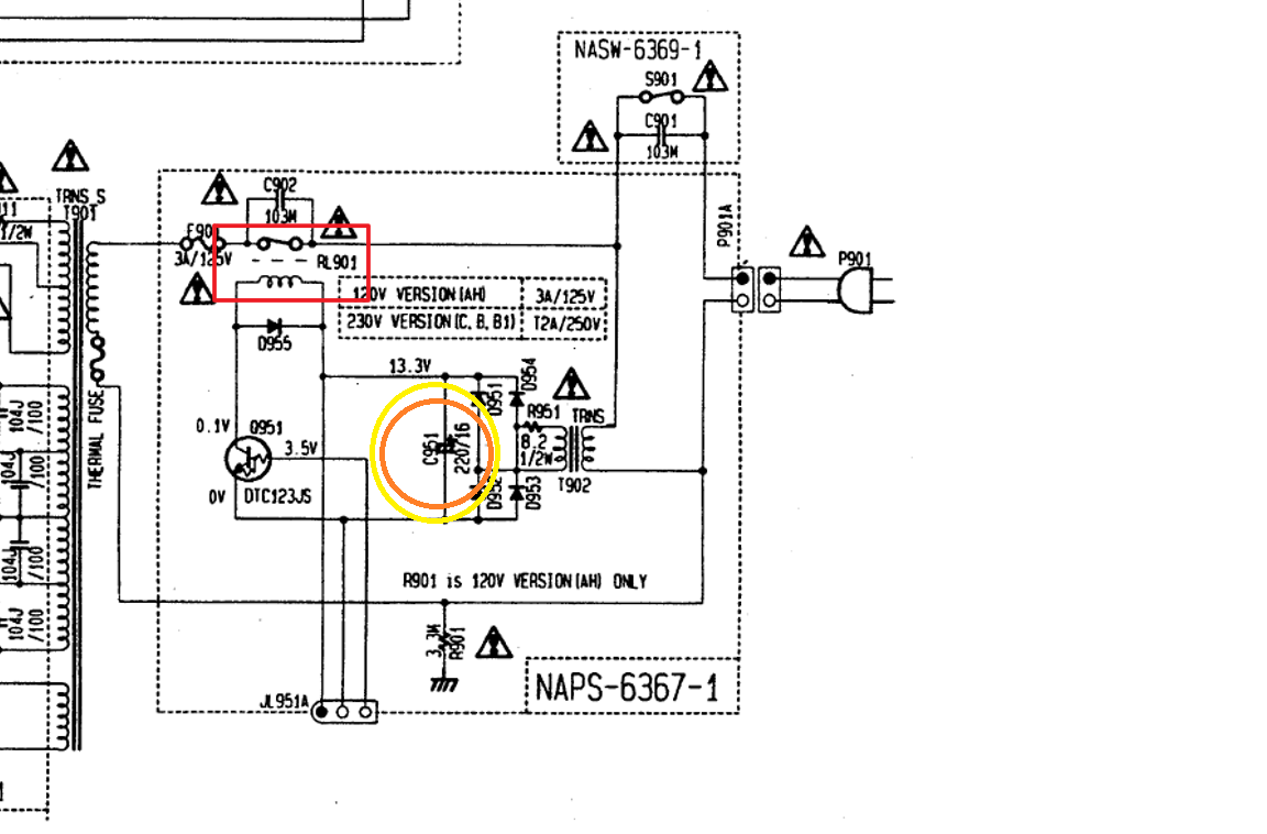

    I would start by replacing C961, it is for the standby circuit and the fact it is always plugged in, this cap can dry out over time.
      Thanks for the tip, I think the one you are referring to is C951 (the second number does look like a 6 at first) -- 220 uF 16 V capacitor that is part of that standby power supply stage across the four-diode rectifier component, correct?

        R_J is right , it's C961.. Compare it to the "5" in the nearby diode ..
        Update : It's C951 ..Sorry

          This one...

            Thanks for the advice. I replaced that cap, and while the radio seems to be behaving a bit better, and will stay on and behave normally for several hours, if I power down the radio it will still not power up again right away -- but will do so after what seems like 30+ minutes "rest".
            Any ideas what to try next?

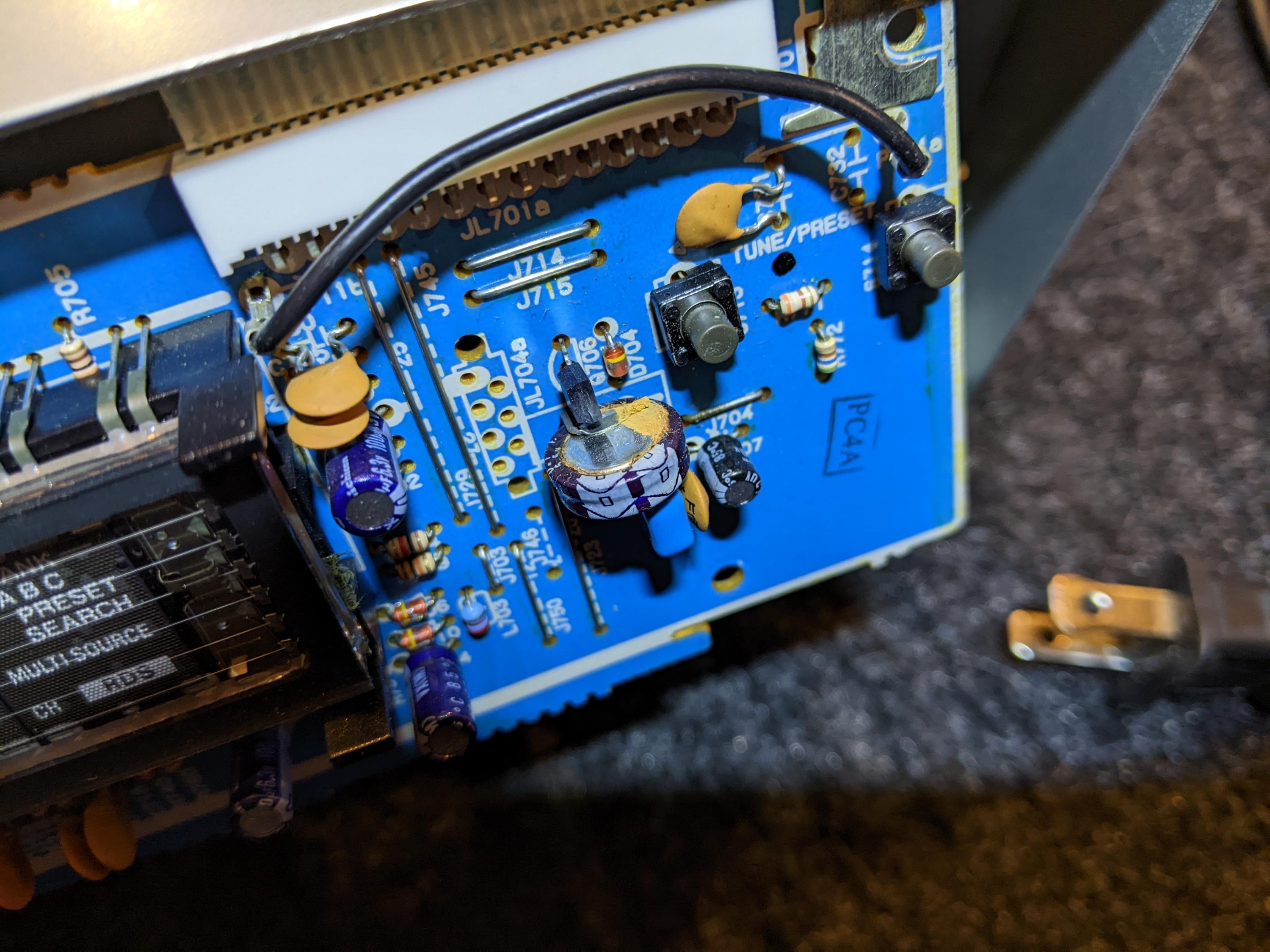

                        Sorry for the delay, I wasn't able to get to this until today.
                        I managed to find C712 on the board. As you suspected -- there is some kind of orange goo emanating from one side (see photo below). I removed it.
                        The radio doesn't power up at all now, so likely there needs to be something there. I will try to find a replacement tomorrow.
                        • JordanW
                          • Jan 2023
                          • 9
                          Re: Diagnosing NAD receiver -- unexplained shut-downs
                          An update -- Replacing C712 (the "coin cell" 0.1F cap responsible for maintaining the station memories) got the receiver back into working condition, and I was able to run it for about two hours with totally normal behaviour, including powering it off and on a few times. But after powering it down for the night, it now won't power back on again at all.
                          I got this receiver for a very low price, second-hand, about 10 years ago, so it doesn't owe me anything!
                          I'll try replacing that cap again "just in case" (I got a spare) but otherwise will sell it for parts / someone else's project. Thanks everyone for the advice.

                            It isn't that cap then. My guess is that orange goo coming out of it corroded or shorted some traces nearby. Look closely around the position of C712, use a magnifier or microscope if you have it.

                              I have both, and will take another look, but I didn't see anything obvious. And the orange goo never hit the circuit board (just on the cap itself) and never made it to the side with the traces.
                              I was so excited when the receiver started up normally after replacing the cap -- and then it died. Could be that the cap I put in got fried within its first use ... or it could be something different.
