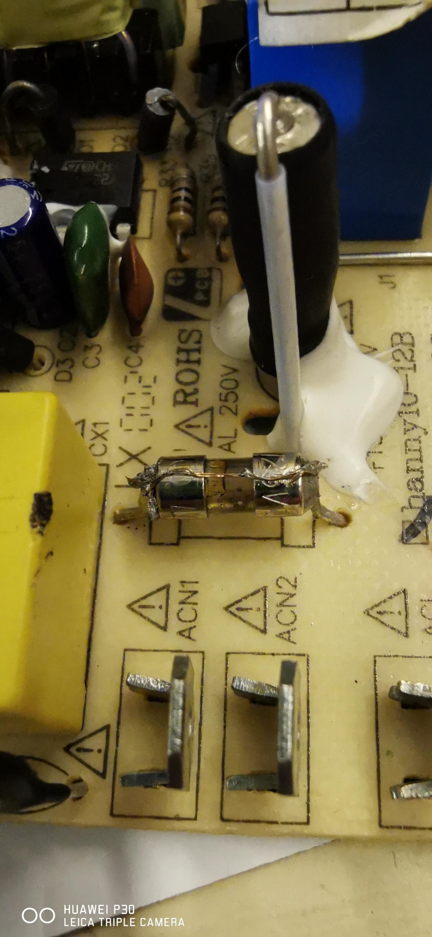

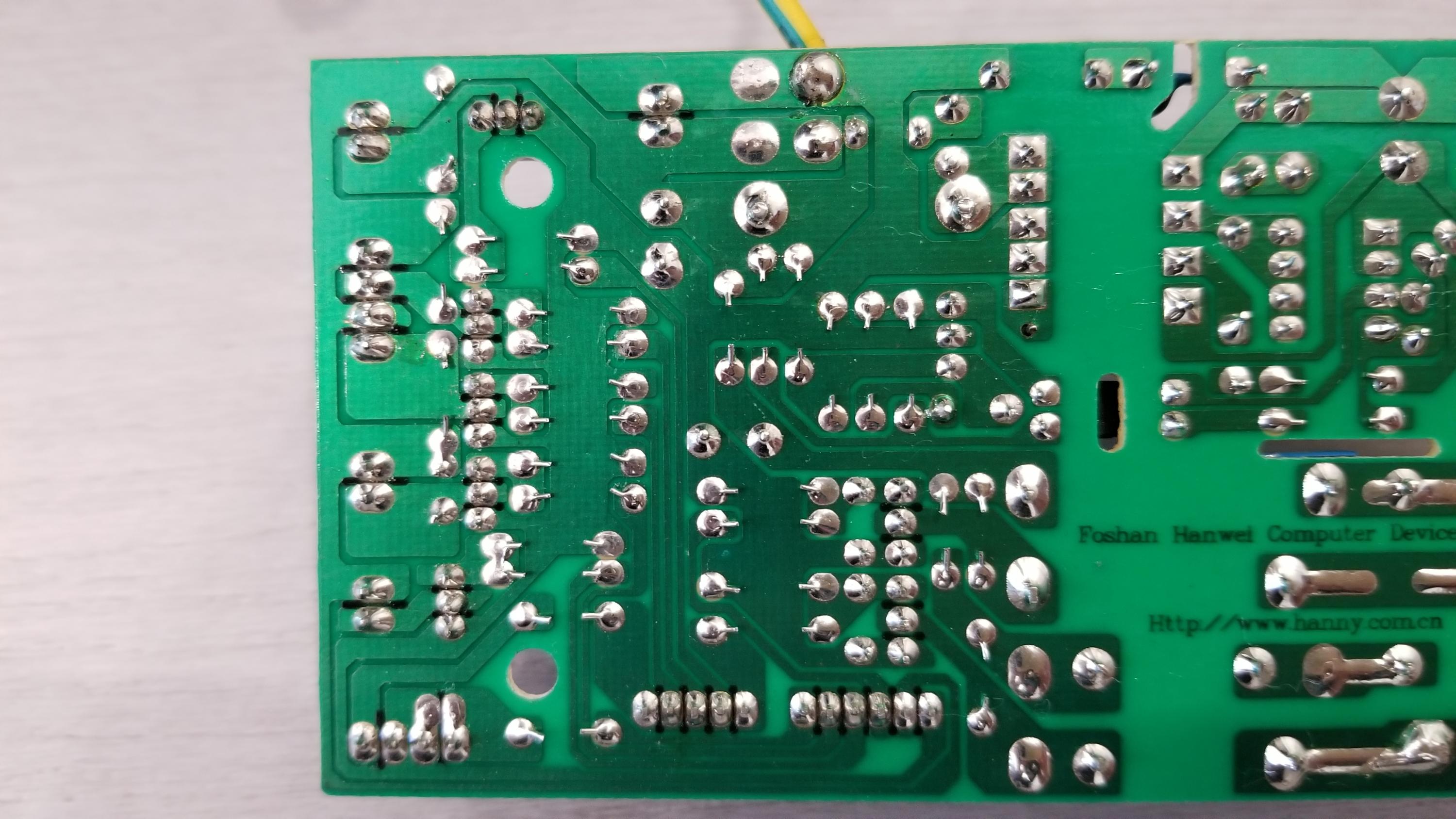

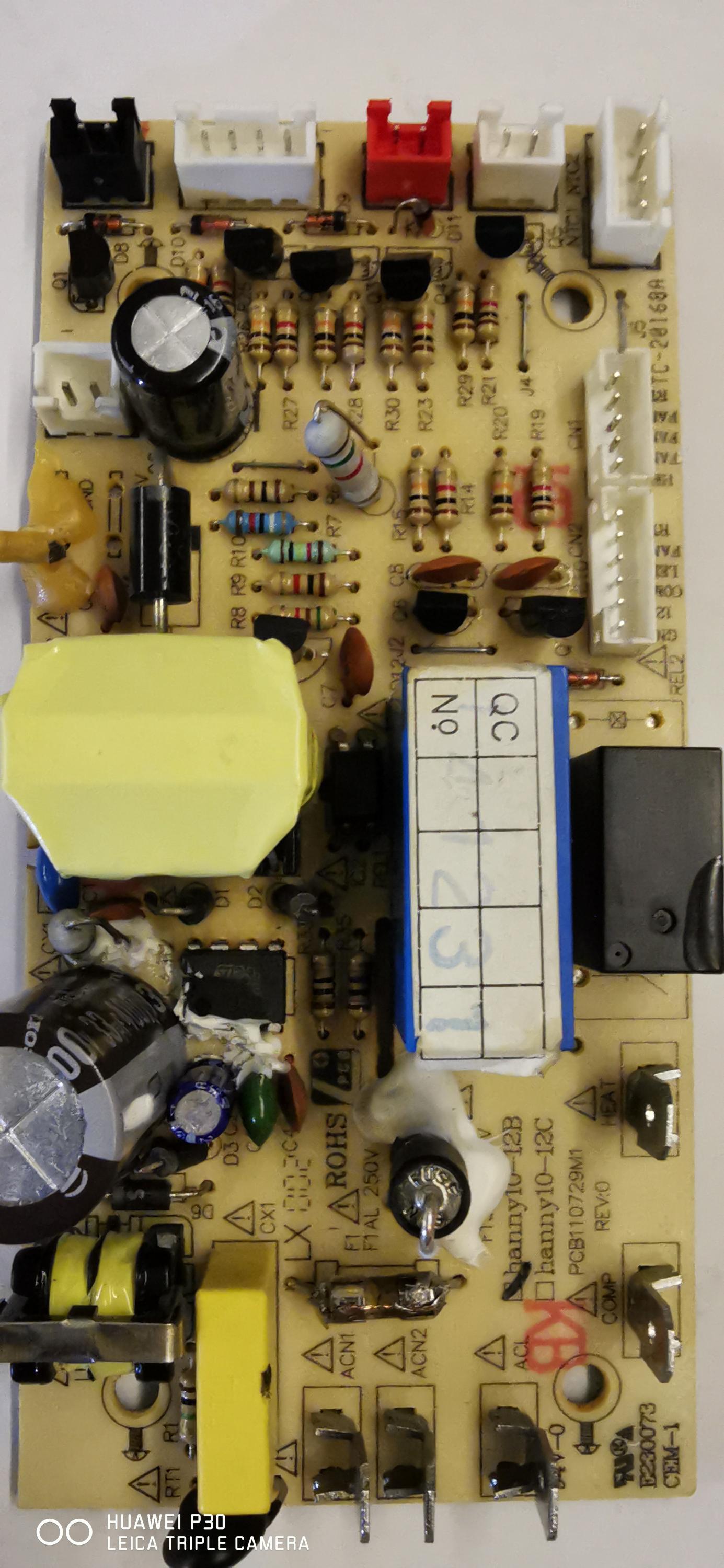

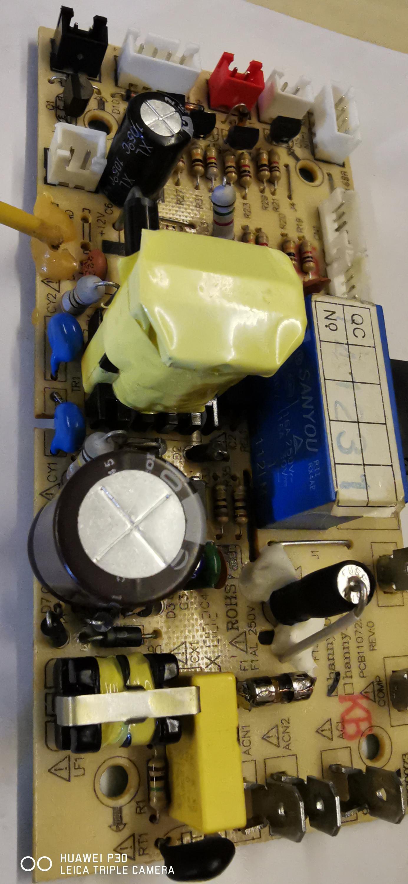

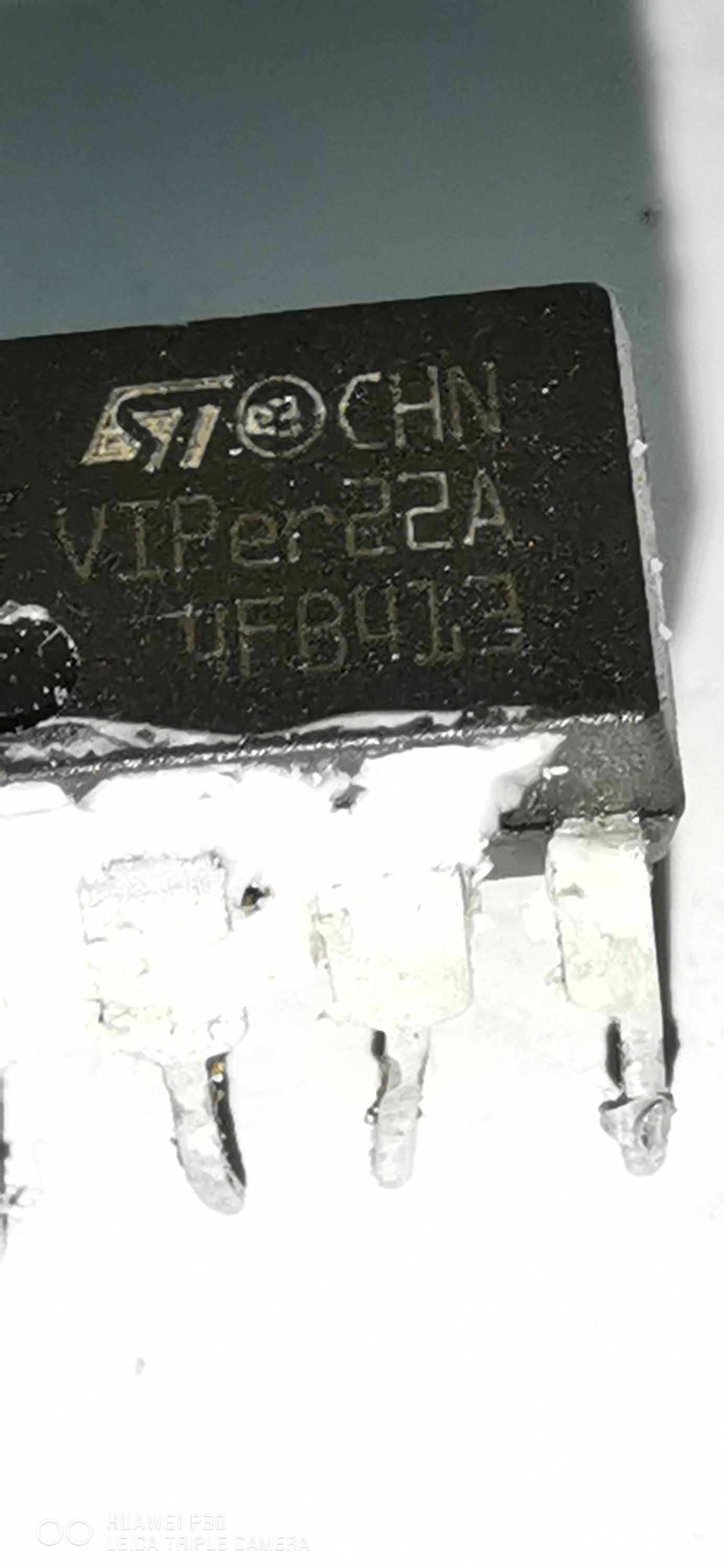

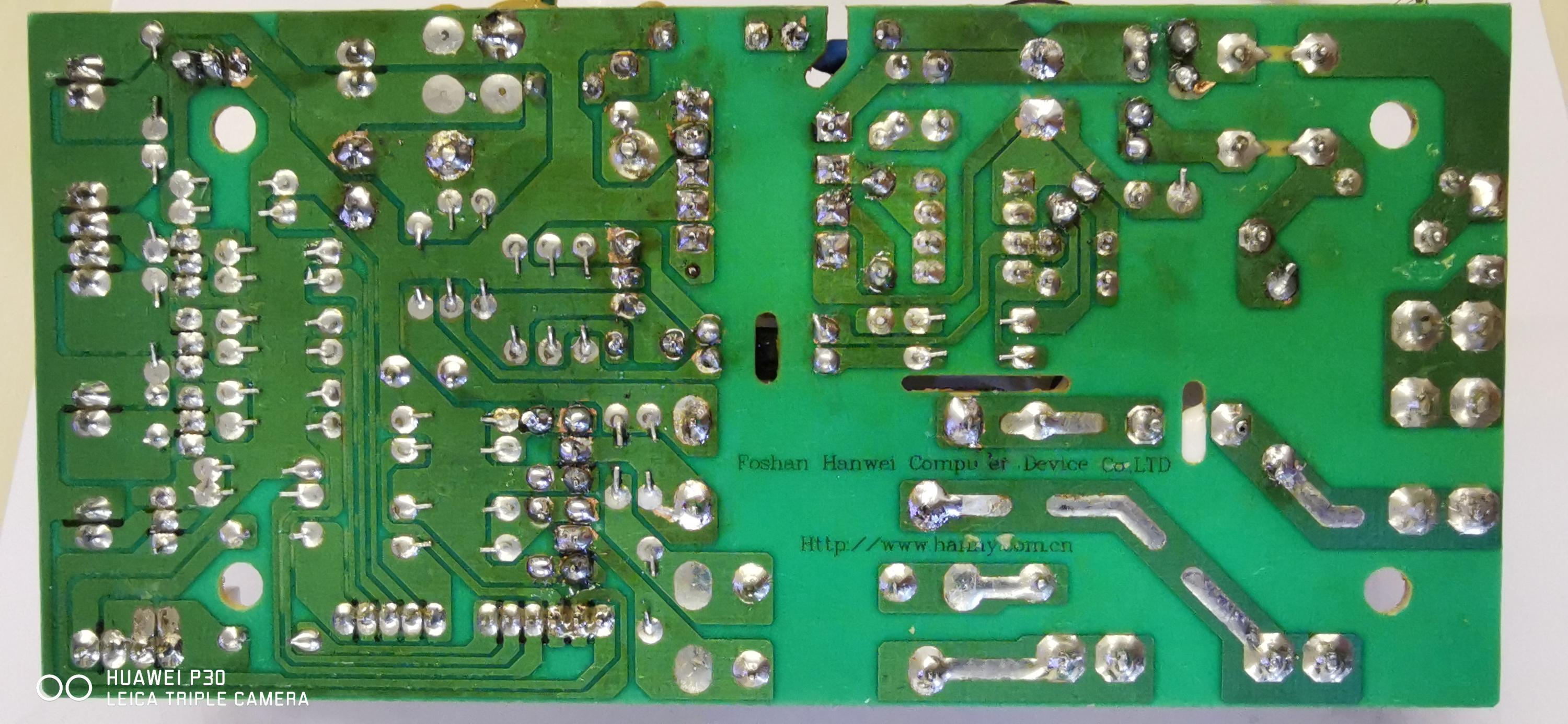

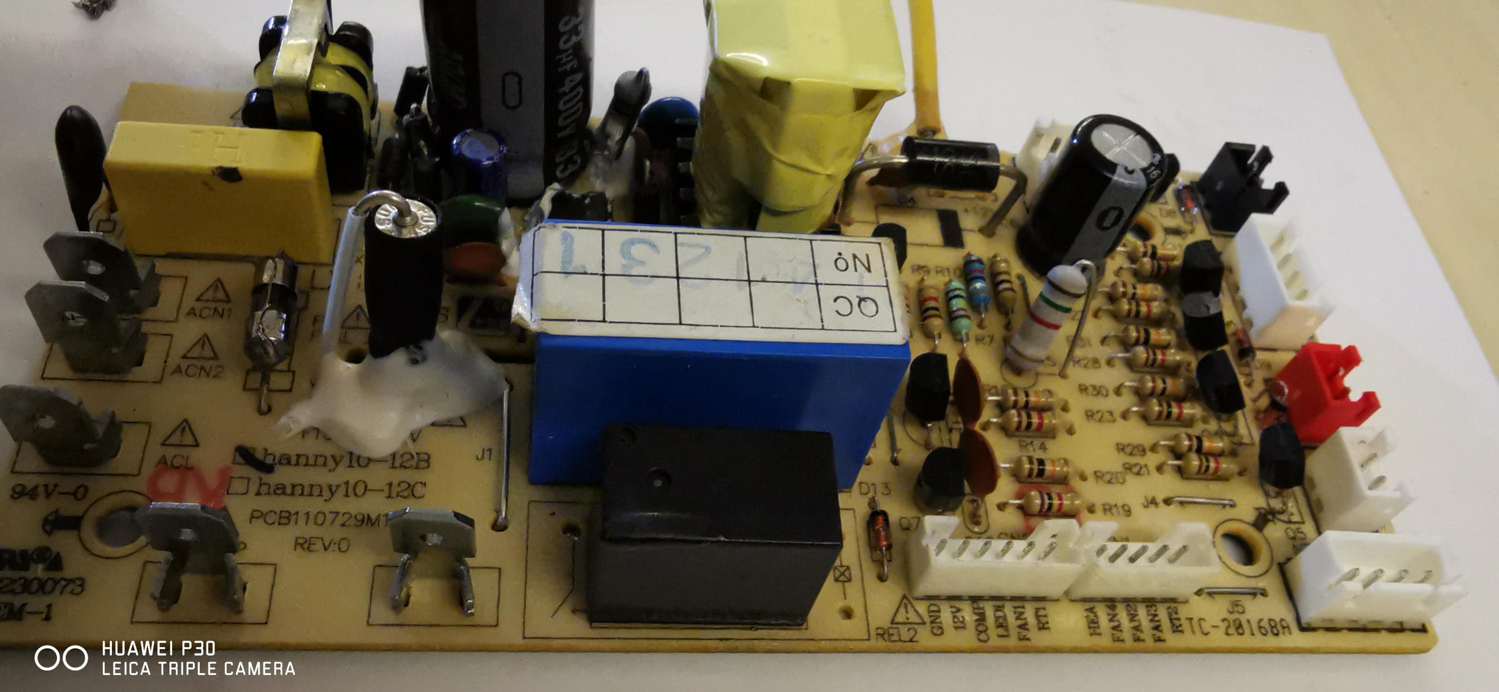

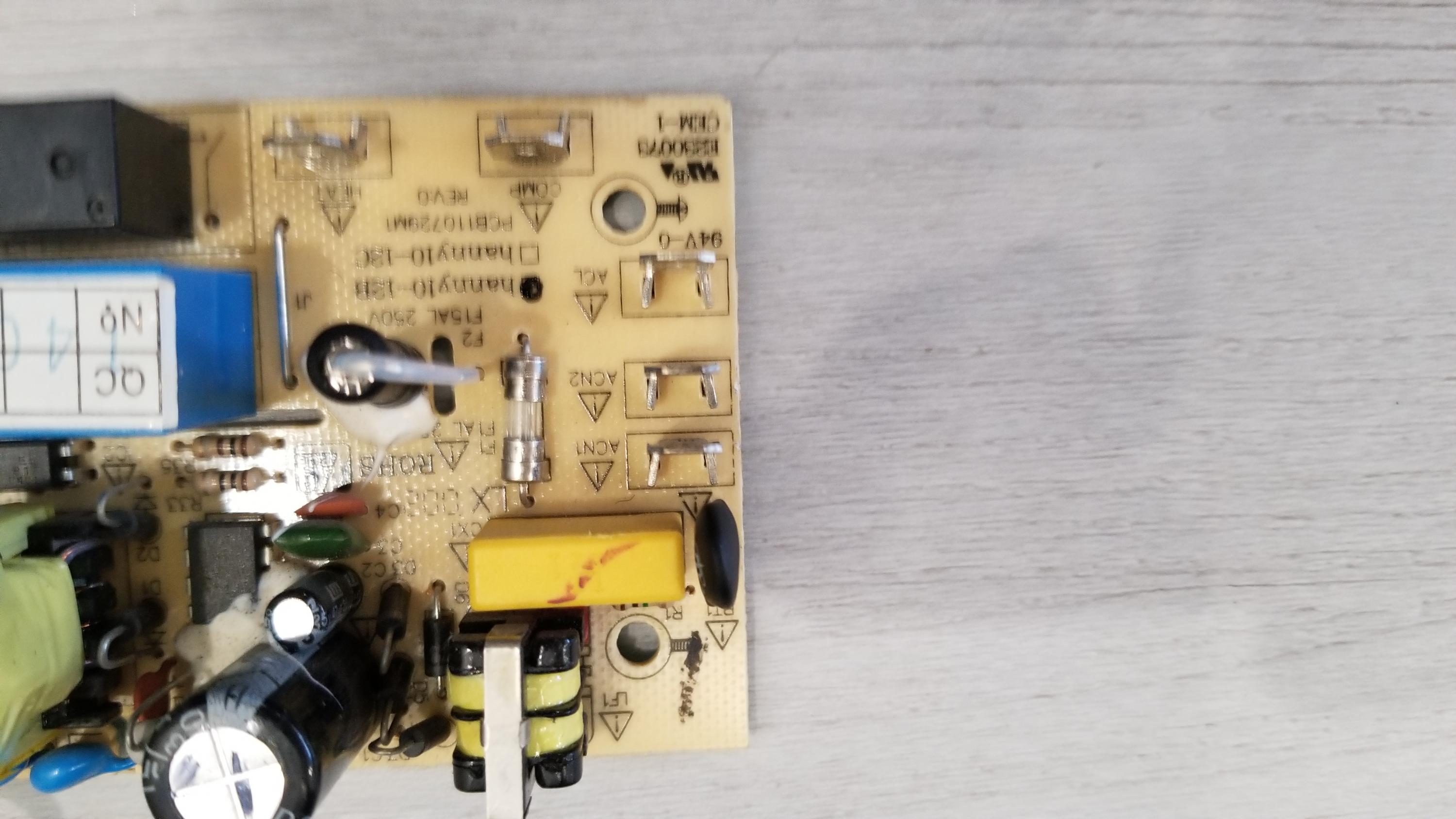

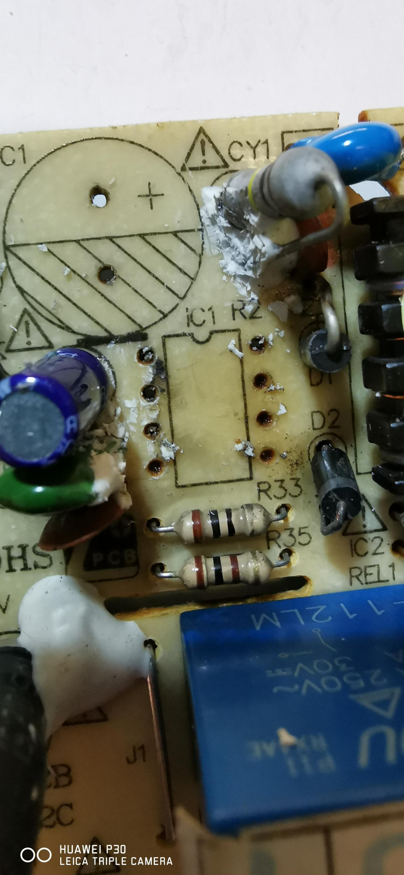

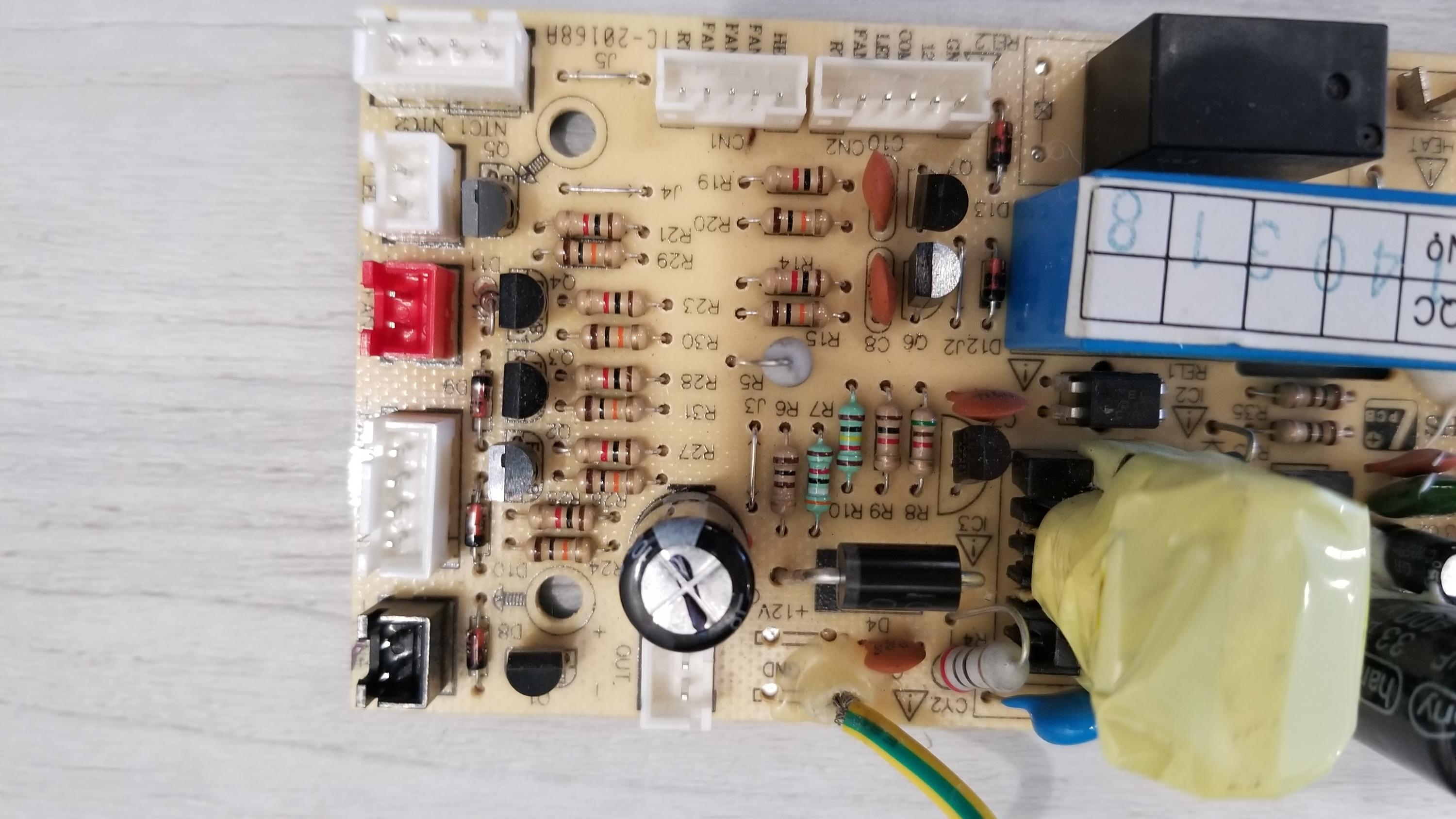

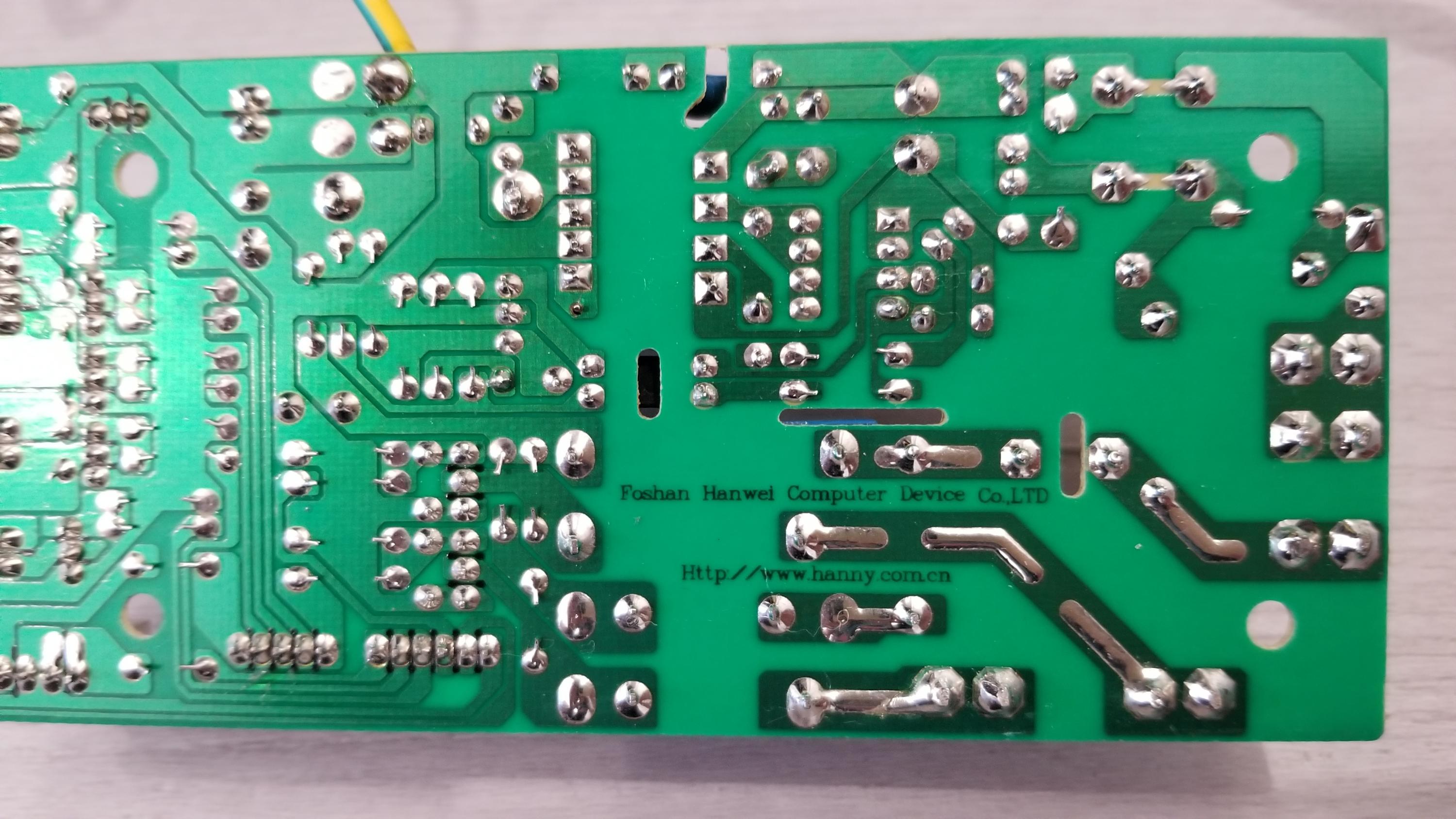

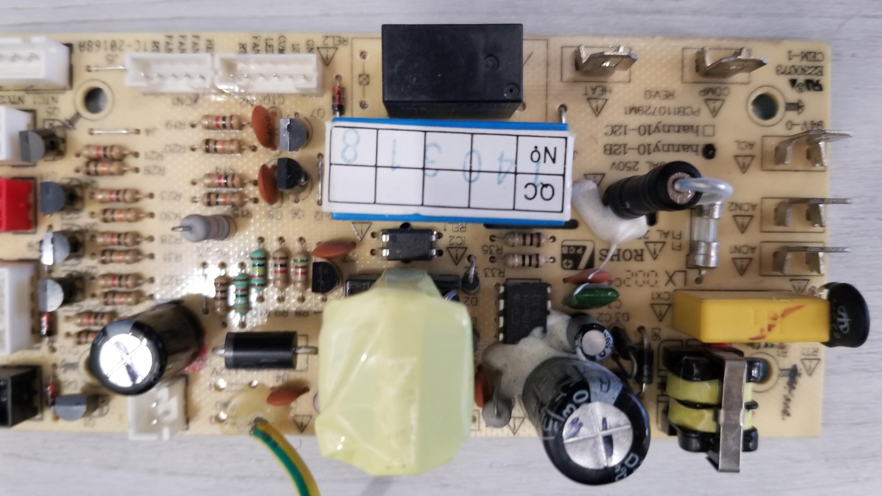

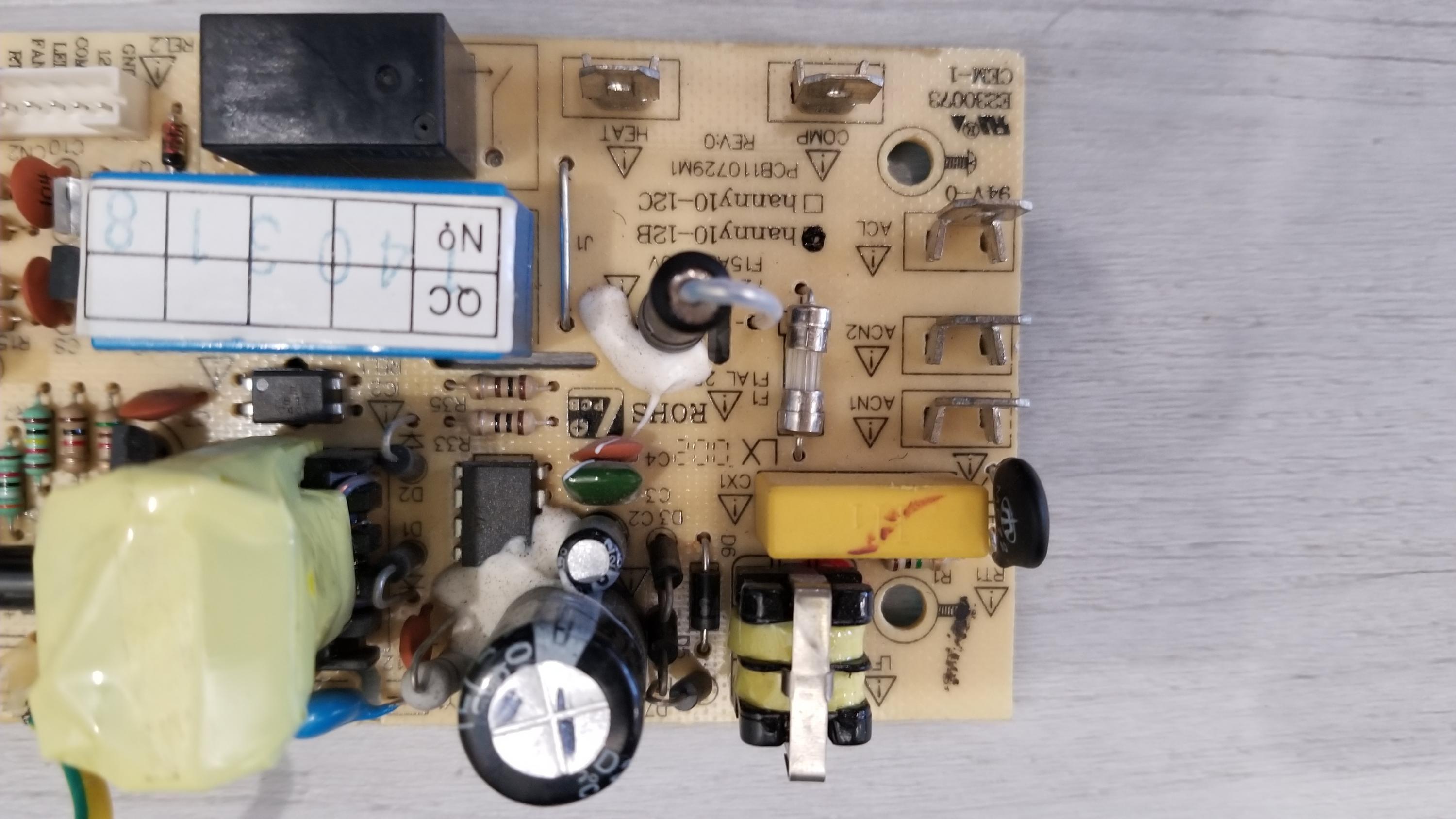

EuropAce EWC 913 Wine Cooler power board fuse blow /shorted
  • beetle1303
    • Jul 2019
    • 279
    • Singapore
    EuropAce EWC 913 Wine Cooler power board fuse blow /shorted
    I am a occasional hobbyist home electronic / electrical goods repairer without formal training in electronics/electricity. I learned from here and Youtube mostly.
    I was given a EuropAce wine cooler model EWC 913, with no power supply - totally dead.
    I opened up everything, and zoom into the power supply board (see attached pics), the board part# is Hanny10-12b, PCB110729M1, Rev0.
    There are 2 fuses, 1 is OK, 1 was burnt. I disconnected all the input and output cables, put the power board stand-alone on a table, and replaced the burnt fuse. I burnt immediately upon power-on.
    After reading some discussions in this forum, I followed 1 of the suggestions:
    - I wired 2x40w incandescent bulbs in series with the live wire going to the board, temporary soldered a thin wire across the blown fuse.
    - When power on, both the incandescent bulbs lights up and stayed lighted up until I power off. Based on what I read, this is a clear indication of a short-circuit somewhere.
    I do not know how to read / trace circuit board, so I practically did a process of eliminations by removing all the capacitors and diodes to test using a DMM, and when the tests appeared good, I soldered them back. I repeated this process with all the transistors. As for resistors I only tested then in circuit. I even removed the 2 big blue and black rectangle parts (presumably relays). But doing all this has no effects at all on the 2 bulbs - they always lighted when I power on. The last I tried was removing the transformer - then the 2 bulbs di not light up!
    While doing all these removing/restoring, I only occasionally checked the incoming voltage at the 2 input terminal - it's quite consistently at around 5V. I did not take any reading beyond this.
    Please kindly help with my journey to debug and find the short circuit.
    Thank you very much.
    Last edited by beetle1303; 04-06-2020, 09:21 AM.
  • beetle1303
    • Jul 2019
    • 279
    • Singapore
    Re: EuropAce EWC 913 Wine Cooler power board fuse blow /shorted
    While waiting for help, I went through the board once more thoroughly - and realized the only thing in the cluster of components that I didn't looked at was this IC1.
    So I de-soldered and pulled it out - and voila!!! The incandescent bulbs no longer light up .
    So I replaced the wired fuse with a proper spec fuse, removed the incandescent bulbs from the power source, and power on - no more blowing fuse!
    I will go source the IC and do some checks on the board, hopefuly nothing else is faulty caused by this IC.
      • Jul 2011
      • 6069
      Re: EuropAce EWC 913 Wine Cooler power board fuse blow /shorted
      When you get the new one before you put it in make sure that you do not have any other shorts
      Follow this after you install the new ic chip
      Also put the light bulb in place of the fuse again and make sure that the light is not full brightness otherwise you may still have problems with this device or with this switching power supply system
      Last edited by sam_sam_sam; 04-07-2020, 11:09 AM.
      • R_J
        • Jun 2012
        • 9592
        Re: EuropAce EWC 913 Wine Cooler power board fuse blow /shorted
        You can check the resistance on the internal fet in the ic, check the resistance between pins (5,6,7 or 8) and pins (1 or 2) I suspect it will show a short. There is a small electrolytic capacitor (C2?) next to the ic, replace it as well.
        Last edited by R_J; 04-07-2020, 11:50 AM.
          • 31214
          Re: EuropAce EWC 913 Wine Cooler power board fuse blow /shorted
          no point checking the chip, half the top is blown off!!!
          • beetle1303
            • Jul 2019
            • 279
            • Singapore
            Re: EuropAce EWC 913 Wine Cooler power board fuse blow /shorted
            Bought a new IC1 (VIPer22A), checked to compare with the bad one - yes, pin1 and pin2 is very low resistance at 50+ohm vs 2+Mohm on the new IC.
            So soldered in the new IC (I already replaced C1 & C2 previously), and put the 2 incandescent bulbs into the system.
            Power up - 1 of the 2 bulbs lighted up for a split second, then off. Subsequent power off and waited for like 10-15 secs and power up again - none of the bulbs lights up anymore.
            I now removed the bulbs, cycle the power a few times, the fuse is still good.
            I guess IC1 and/or the 2 capacitors (C1 & C2) were the culprits.
            Is there anything I should check now before putting it back onto the chiller to see if it works?
            • beetle1303
              • Jul 2019
              • 279
              • Singapore
              Re: EuropAce EWC 913 Wine Cooler power board fuse blow /shorted
              An update:
              I have since put the power board back to the chiller, and it works!
              I set the temperature to highest level, the compressor turns on and off in maintaining the set temperature, so far so good.
              However, I think there are some other underlying issue between the front panel controller and the power board:
              - when first power up, the front panel touch screen buttons all working well.
              - after running a for a while, except for the light button, all others are not responding anymore.
              - the display still showing current temperatures up and down accordingly.
              - recycling the power will clear this issue
              Could this be caused by power board component(s) damaged by the initial shorted IC?
              • CapLeaker
                Leaking Member
                • Dec 2014
                • 8330
                Re: EuropAce EWC 913 Wine Cooler power board fuse blow /shorted
                Take the front panel apart and clean it.
                • beetle1303
                  • Jul 2019
                  • 279
                  • Singapore
                  Re: EuropAce EWC 913 Wine Cooler power board fuse blow /shorted
                  The front panel is 'embedded' inside the door frame, and seems like a challenge to open it up, so I decided to give it a pass, and returned it to the donor who were delighted that it was fixed and doesn't mind the control panel issue.
                  So this will be a happy ending for me and the donor.
                  Thank you all for your guidance and support.
                  • R_J
                    • Jun 2012
                    • 9592
                    Re: EuropAce EWC 913 Wine Cooler power board fuse blow /shorted
                    Originally posted by stj
                    no point checking the chip, half the top is blown off!!!
                    It looks that way in the first post but, if you look at the photo in post #2, it does'nt look like the top is blown off
                    Last edited by R_J; 04-10-2020, 12:26 PM.
                    • calpolycrew
                      • Jul 2020
                      • 2
                      Re: EuropAce EWC 913 Wine Cooler power board fuse blow /shorted
                      Late reply! I'm having issues with this same board or at least my wine fridge where the compressor no longer turns on. I've changed the OL and the PTC but no luck.
                      I wanted to reply to the touch screen issue. Generally when the fridge starts up the controls are free to use, however after 5 minutes or so the temperature controls are locked automatically. There should be icons on the front control panel that show a lock, generally you have to hold down on or two of the buttons for 5 seconds and you'll hear a beep and you'll now be able to adjust the temperature.
                      I wish you were closer as I am in the US and would of been happy to send you my board for inspection as I cant think of anything else it could be. If power is applied to the compressor it kicks on and starts cooling. However if the board is hooked back on, when I turn on the fridge, theres a single clicking noise and the compressor fan comes and panel and the fans inside the fridge however the compressor does not turn on.
                      An interesting observation is that I noticed is that when the circuit board moves in its cases from side to side, the light in the room where its at flickers for a second as if power is being pulled to start the compressor but the compressor never comes on.
                      I can take pictures if maybe you'd like to take a quick look? I think one of the caps might have a tiny bulge but I don't know exactly what to look for.
                      i hope this message finds you well.
                        • 31214
                        Re: EuropAce EWC 913 Wine Cooler power board fuse blow /shorted
                        check the soldering, and suspect the relay - i assume the blue relay is for driving the compressor
                        infact your ealier pcb foto's show a LOT of cracked solder joints.
                        if you see a ring on a joint like a shadow or a scratch - it's cracked.
                        Last edited by stj; 07-10-2020, 11:22 AM.
                          • Jul 2011
                          • 6069
                          Re: EuropAce EWC 913 Wine Cooler power board fuse blow /shorted
                          These type of boards are notorious for this type failure where the pins go to the board to crack and separate them self from the board
                          If it has separated from the board you can take wire and rap it around the terminal pin and and use enough wire to get enough board trace to make the terminal blade solid to the board just make sure you use enough solder to make a good solid connection
                          I have had to do this type of repairs many times before in the past to keep using old circuit boards useable because replacement boards are not always available or cost to much money to replace
                          Where I work we have some saws that have hydraulic solenoid valve coil pins that go to a circuit board and these pins are notorious for this type of crap pins breaking loose from the board unfortunately this model have been discontinued and no longer found and to replace them can become expensive to do because you have to get the complete valve assembly a couple of hundreds of dollars each and there probably 10 valves on each saw
                          So of course I had to find a way to fix these circuit boards these repairs last a couple of years and from time to time I have to repair some of the same ones again until they become unrepairable but we just part out a saw that was sent to us from one of our other location and it has the same exact valves so I got lucky
                          Yes are location is considered a discard location we have part out equipment before sometime it good and sometimes it not
                          Yes a jack of all trades and master of none of them
                          Last edited by sam_sam_sam; 07-11-2020, 06:52 AM.
                          • calpolycrew
                            • Jul 2020
                            • 2
                            Re: EuropAce EWC 913 Wine Cooler power board fuse blow /shorted
                            Thanks for responding. I've attached some pictures of my particular board in hopes of maybe you guys spotting something. Thanks for your follow up posts and hopefully we can get this sorted.
                            Sorry for hijacking this thread but its the same board.
                              • Jul 2011
                              • 6069
                              Re: EuropAce EWC 913 Wine Cooler power board fuse blow /shorted
                              Yes you definitely have what looks like bad soldering joints around the terminal pins
                              Here is what I would recommend that you remove all of the solder from each pin with soldering wick and resolder all the joints that have missing solder and any that have ring around the part pins or terminal pins or dull looking soldering joint and go from there
                              But do this first thing before trying to powering the device up again
                              Last edited by sam_sam_sam; 07-17-2020, 04:42 AM.
                              • ismiligy
                                • Aug 2020
                                Re: EuropAce EWC 913 Wine Cooler power board fuse blow /shorted
                                I had the same issue with the fuse. After replacing it with a 5amp slow burn the IC burnt. So I bought a new board.
                                Out of stock everywhere...
                                https://ambientstores.com/whynter-bwr-33sd-main-pcb
                                I bought this one instead after comparing it conector by conector and it worked.
                                https://ambientstores.com/whynter-bw...nd-yellow-wire
                                It has been over a week and the wine cooler (BWR-33SD) is running fine.
                                • ykchu
                                  • Feb 2021
                                  Re: EuropAce EWC 913 Wine Cooler power board fuse blow /shorted
                                  I have Vinotemp VT-32TS-FE wine fridge. It has the same power supply board Hanny10-12C, PCB110729M1, Rev0. It had the exact same issue of blowing the fuse. I followed this thread and replacing the VIPer22A IC and all caps, and it fixed the issue. Thanks to all!
                                  • scimsabre
                                    • Apr 2021
                                    • United Kingdom
                                    Re: EuropAce EWC 913 Wine Cooler power board fuse blow /shorted
                                    Hi, and thanks to all who contributed to this thread I was able to repair the circuit board for a wine chiller belonging to a family member. When initially searching for information about the board Badcaps was the only site providing useful information. Cheers
                                    • SergeAuckland
                                      • Jan 2022
                                      • 10
                                      • United Kingdom
                                      Re: EuropAce EWC 913 Wine Cooler power board fuse blow /shorted
                                      Just found this forum and registered, and hoping members here can help me.
                                      A family friend just gave me their Wine Cooler to repair, and this thread has already greatly helped in identifying the VIPer 22A on the power board as faulty, so I have a replacement on order.
                                      However, the hanny10-12C power board had already been removed, so don't now have a record of where each of the wires go. I'm assuming that the red and black plugs go in their respective coloured sockets, but there are two two-pin white plugs, which could go into two different sockets, and then the Brown, Red and Blue cables on spade connectors.
                                      I would be very grateful if anyone has a photo or a description of what wire goes where.
                                      With thanks
                                      S.
                                        • 31214
                                        Re: EuropAce EWC 913 Wine Cooler power board fuse blow /shorted
                                        ask the owner,
                                        if they where smart then they took a picture or 2 before they removed it.
                                        • socketa
                                          Bestec ATX0300F5WA - fast,or slow blow, fuse?
                                          by socketa
                                          I bought a dead motherboard, and connected it to this PSU,
                                          Was checking the standby voltages on the motherboard, and, whilst doing so, the PSU made a loud bang with a flash of light.
                                          So now i truly got a bang for my bucks, and something else to try and fix.
                                          The fuse was blowen, and the top was blowen off of a TNY276PN chip
                                          The glass fuse didn't have any marking to say if it was fast or slow blow
                                          So i checked the marking on the PCB thinking that that would tell me,
                                          but it 's got a T/F8A printed on the board
                                          So should i get a fast blow fuse, or should...
                                          05-17-2022, 01:22 AM
                                        • edugimeno
                                          Wine cooler flickers at startup and doesn't cool enough
                                          by edugimeno
                                          Hi there!
                                          I have an old wine bottle cooler, it's a basic peltier cell system with a power supply built in with the controller board, with a simple display at the front door and 2 push buttons to select the desired temperatura.
                                          Symptoms are it doesn't barely cool down, and makes a chirping noise at the board.
                                          Both fans on each side of the peltier are (now, after much cleaning) running smooth and silent
                                          When you turn it on, the front 7-segment display flickers for a variable time, usually like 1 minute but sometimes nothing or 3 minutes... Then turn on solid (but still some...
                                          03-01-2025, 04:51 AM
                                        • KYBOSH
                                          Wine and Beverage Cooler Control Board Repair Attempt
                                          by KYBOSH
                                          Trying to a fancy Wine and Can Beverage Cooler which wasnt working.
                                          Model number AWBC242GGFD
                                          Previous owner states that it needs a new motor.
                                          When plugged up you hear a quick chime from the PCB alarm but it quickly dies away (trails off actually) and there is no sign of life from the unit at all.
                                          I pulled out the main control board to give a look.
                                          Fuses checked out okay. All diodes except one checked out. It was reading in both directions so I pulled it out of circuit and checked it again but this time it read good.
                                          07-18-2024, 11:52 PM
                                        • corrize
                                          by corrize
                                          10-19-2023, 09:58 AM
                                        • paulmars
                                          bad cap cause fuse to blow?
                                          by paulmars
                                          microwave oven Fuse blew, replacement blew too after 1\2 second.
                                          Following common resistance test procedures found on the web the magnetron and transformer are fine.
                                          The big capacitor tests open. The diode attached to it reads mostly open in one direction, although sometimes my dvm will jump down to several meg ohms for a fraction of a second. Testing in other directions reads a constantly changing value of 5xxMeg to 8xxMeg.
                                          Would these cause the fuse to blow?
                                          Emerson mld mw8987b
                                          Tks,
                                          Paul
                                          05-26-2022, 04:24 PM
