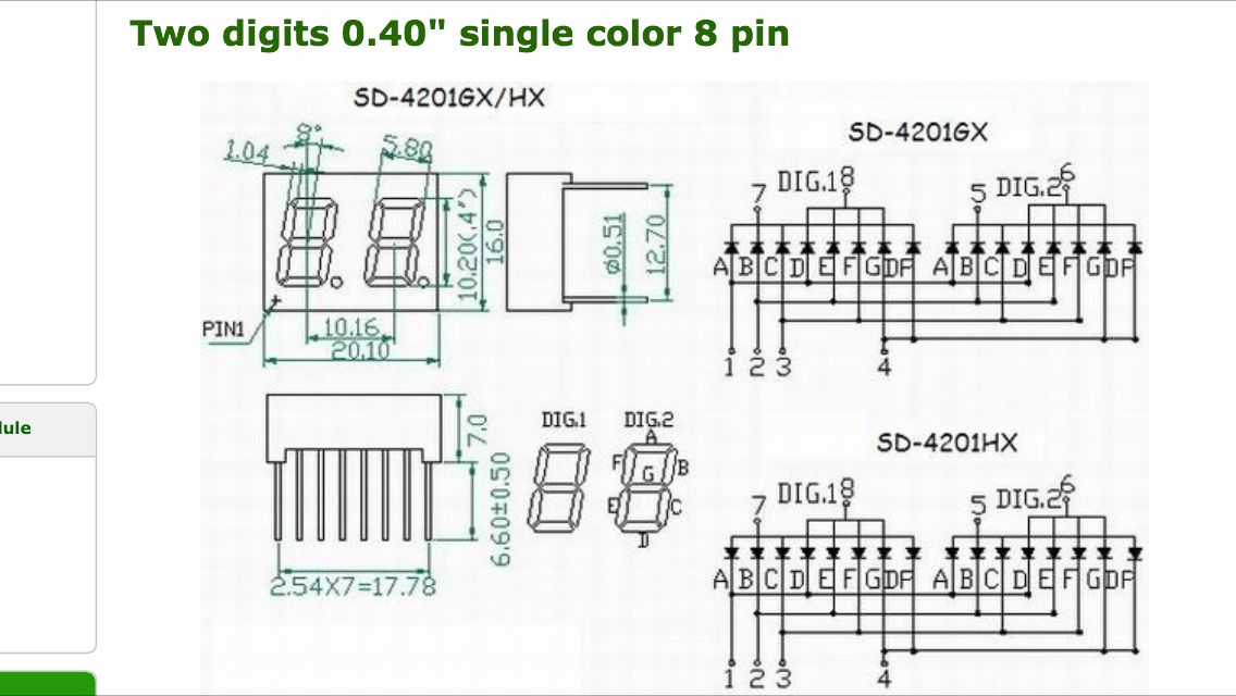

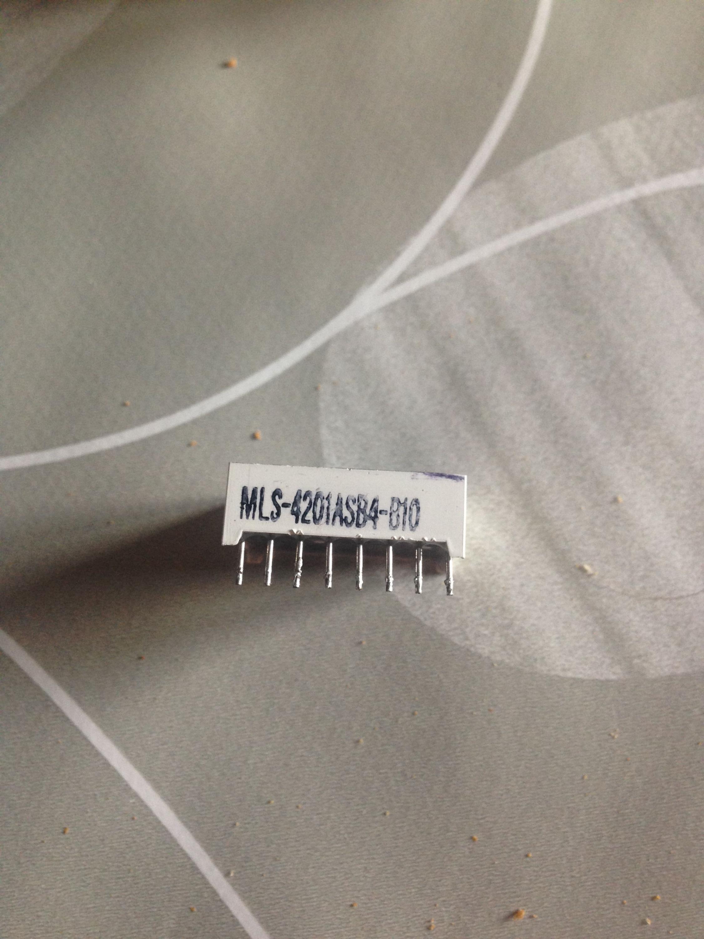

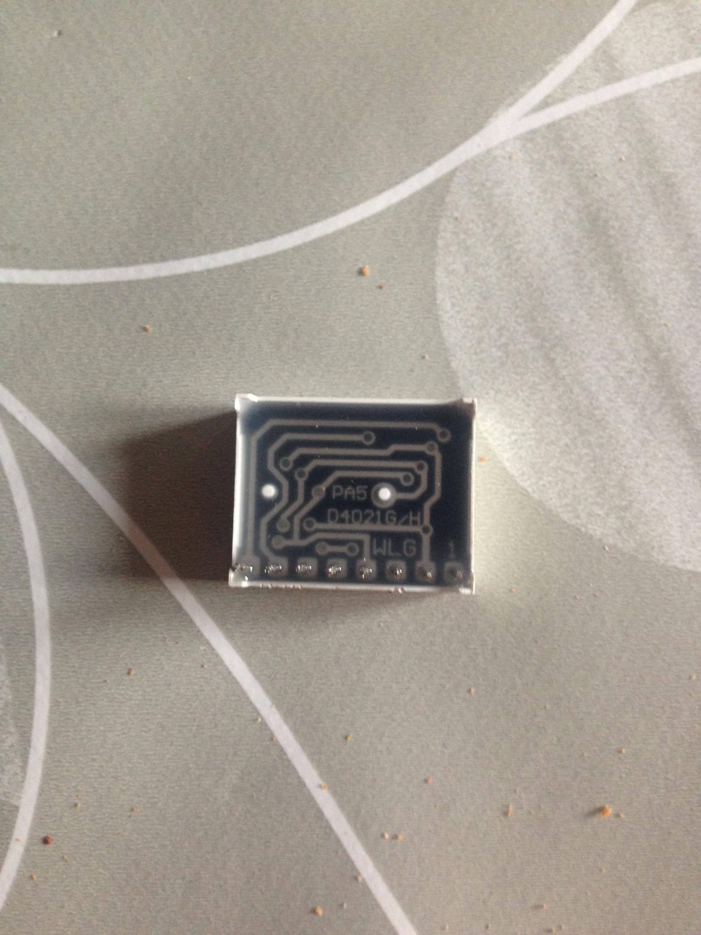

    Dear all,
    I try to repair a wine fridge (for fun reason) where the control board contains 2 7-segment displays with shorted circuits. Without them the control board doesn't work correctly and I can't control the fridge.
    These 2 digits 7-segment displays are special because they have only 8 pins. After some Internet browsing I found that they may be produced by a chinese firm. On their website I found the schematic of the multiplexing they used and was able to confirm it with my multi-meter. Unfortunately the price is too dissuasive to buy only two units from them.
    Does someone has any idea how I can replace them with some more traditional components? Otherwise I'll drop the fridge in my dustbin
    Thank you for your help.

    if your looking for fun, why not make your own display with 14 small rectangular led's and 2 small round led's and some stripboard?
    or a microcontroller and a regular 2 digit display or lcd panel?

      Unfortunately that LED looks custom and the "fun" work suggested by stj are your only options. Main problem being is that most 7-seg displays have only one common pin and yours have two common pins. Or if you want, you could hack up a light pipe doo-hickey with four standard 7-seg displays and use the segments of two 7-seg displays for each...
