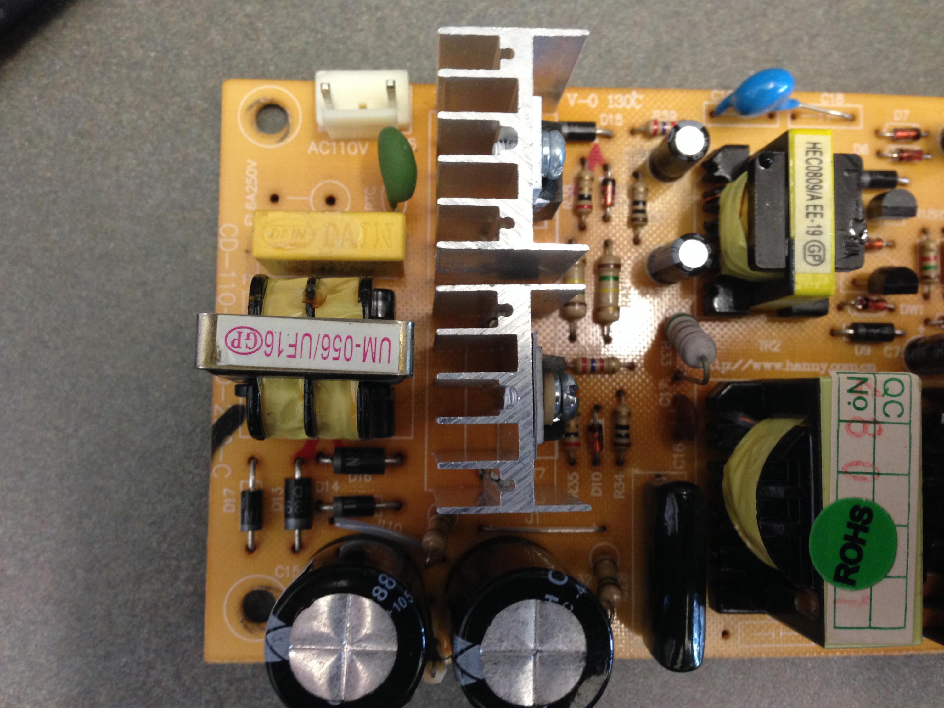

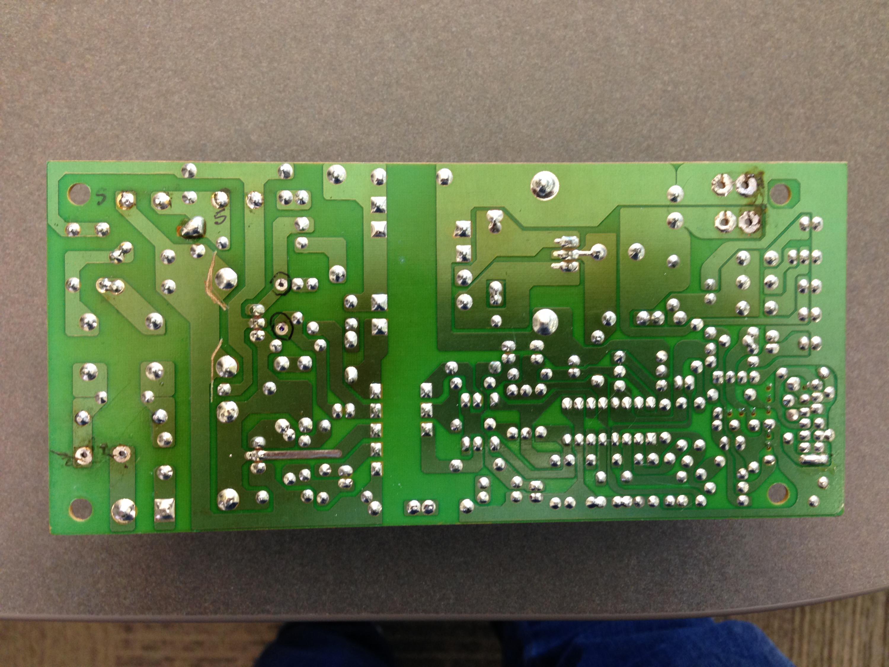

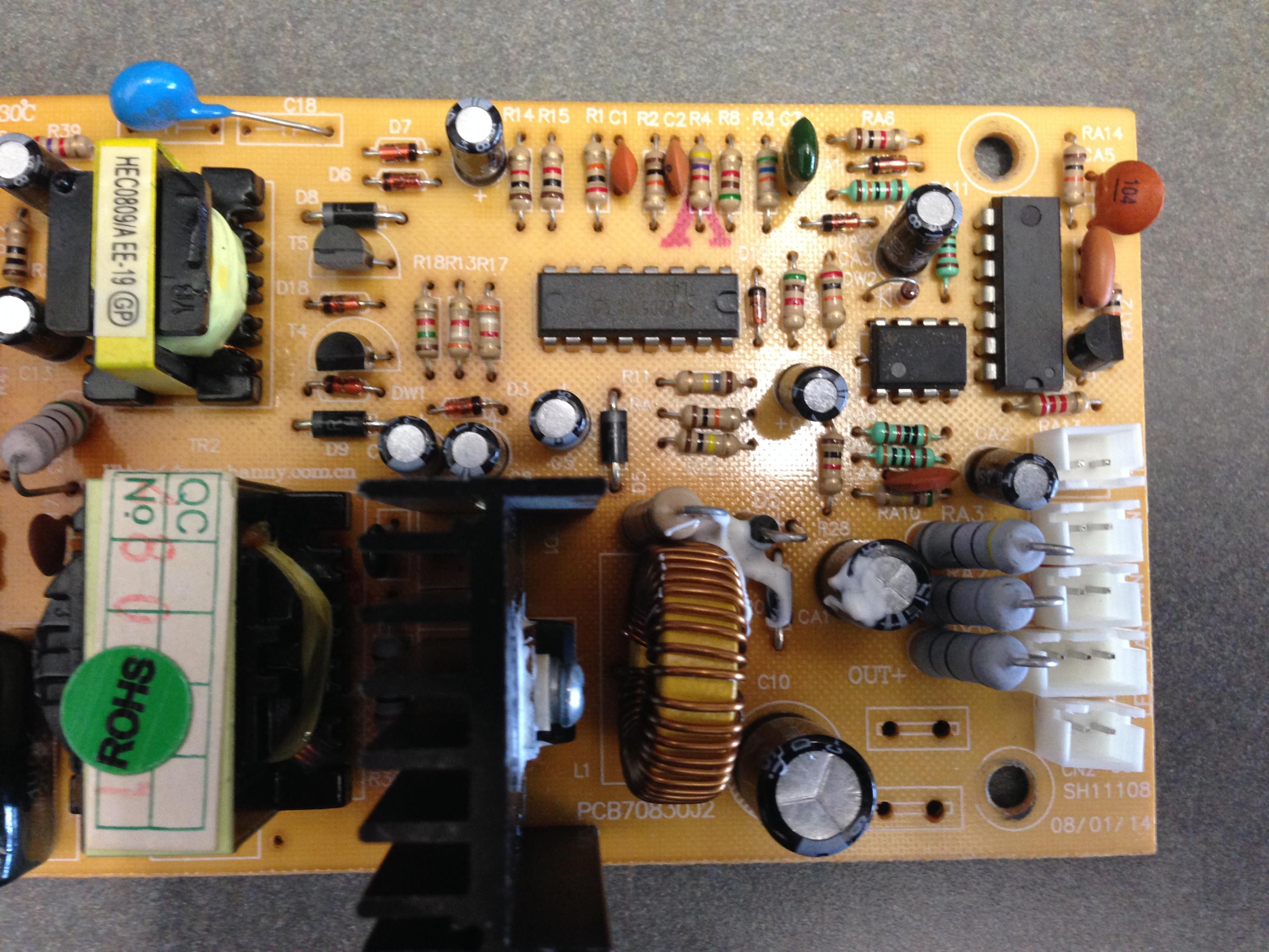

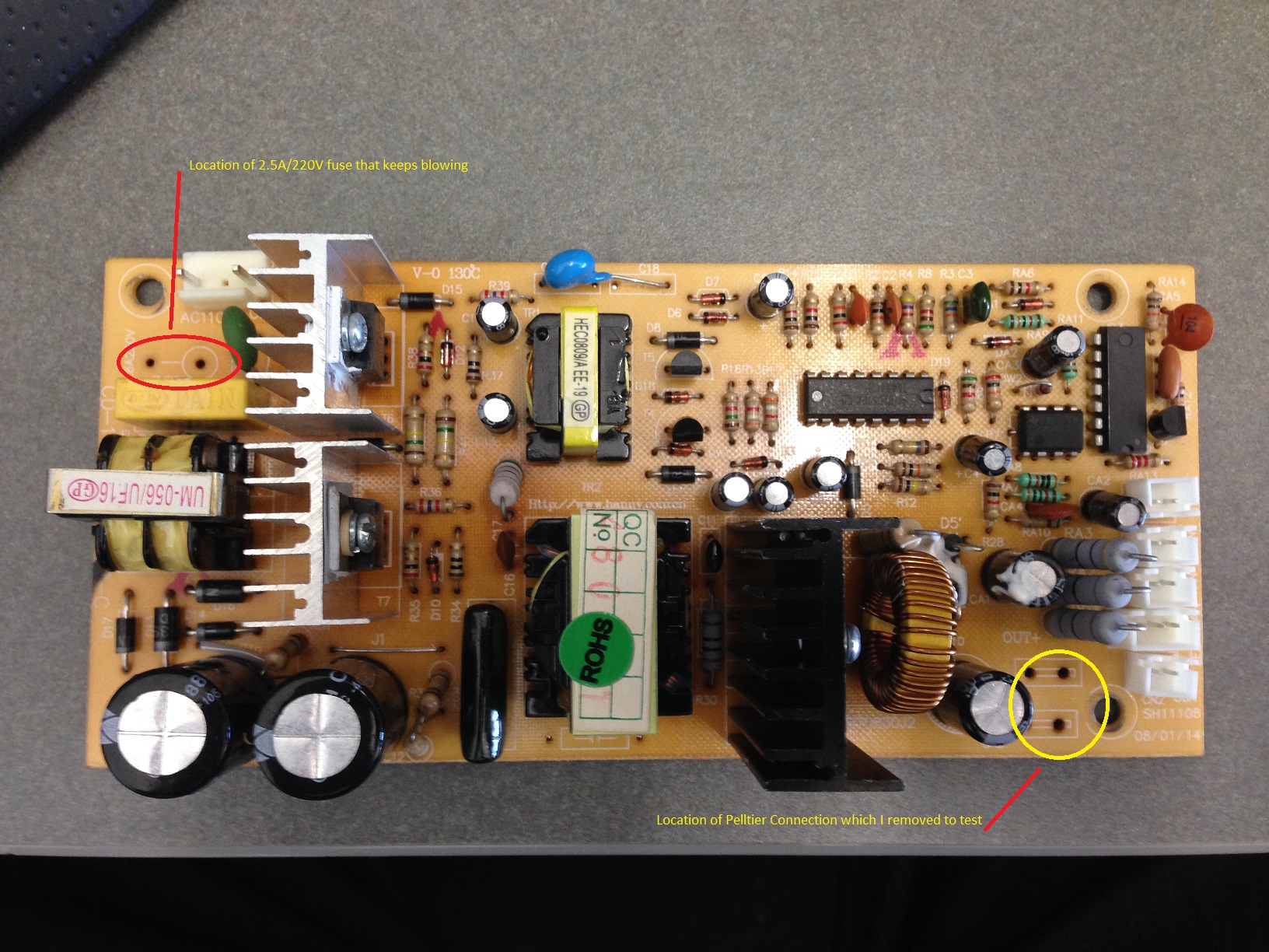

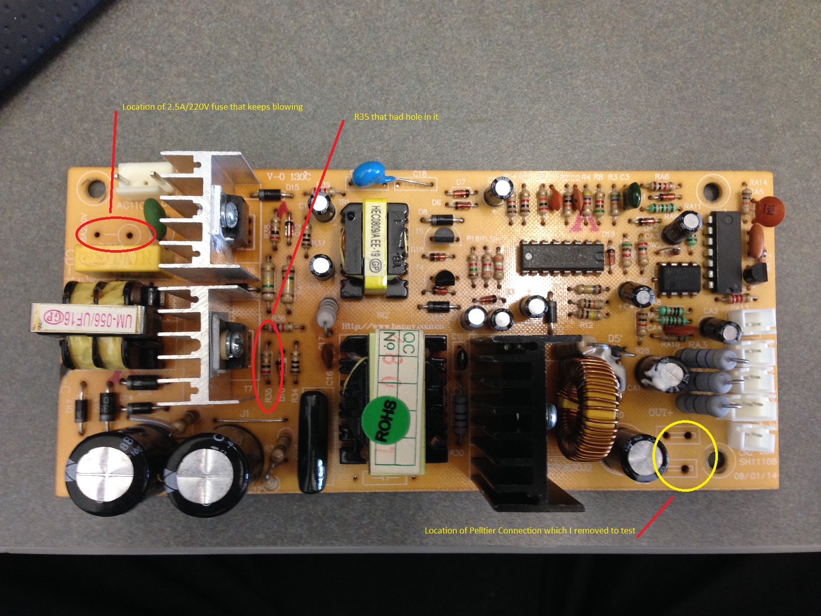

                      Hi there, If I could jump on this thread. I have a similar board to the one original shown (pic attached). When it came to me it was being used in a small Danby refrigerator and the most apparent problem was a dead fuse near where the 120V AC power supply came to the board. This was a 2.5A/220V fuse that I replaced.

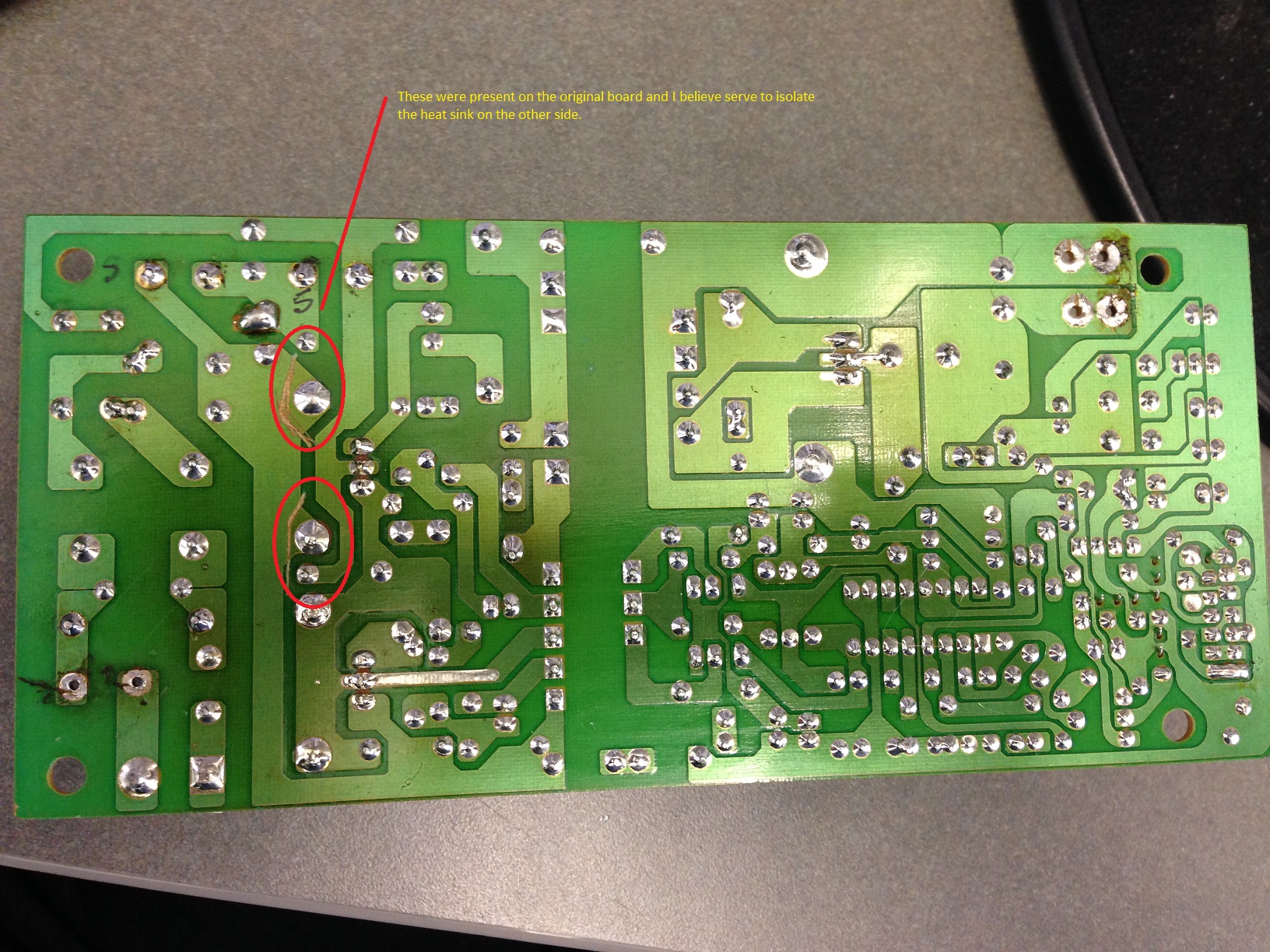

                      When I went to power the unit up again, the fuse once again blew indicating a deeper problem. So, after inspecting the board, testing caps, and scratching my head, I am a bit stuck. The components on the board look OK and I can't see anything other than the fuse that is damaged. But when powered up, the fuse just blows and I can't find the short. Even with the Peltier unit disconnected the fuse still pops
                      I have disconnect the board from the temp. controller, the fans and the Peltier unit to make it easier to work on, and have indicated where the Peltier unit was once connected.
                      I should also note that this is a Hanny PSB #HYS60-12-KD. I have emailed and requested a schematic, but not surprisingly I have heard nothing back.
                      Thanks in advance for any advice.
                      Anthony
                        I should also note that this is a Hanny PSB #HYS60-12-KD. I have emailed and requested a schematic, but not surprisingly I have heard nothing back. Sorry about that I did not read your story correct. So that being the case you will need a ohm meter to ohm out the input line as you have a short somewhere on the board.
                        Anthony
                        You have a short somewhere on the board that is causing the fuse to blow. A ohm meter will help you with this. Once you find what is shorted causing the input fuse to draw to much current then you will have to lift component legs on that line to narrow where the short is located. I would say the short is in the front AC section. If you look on T6 and T7 it looks like one transistor has a insulator on the screw that goes into the heat sink and the other has none. T7 has a heat sink pad and a insulator on the screw going through the transistor and T6 has no heat sink pad or insulator on the screw and in electrically connected to its heat sink. This may indeed be correct. It seems a diode is in-between the two heat sinks which ties the heat sink circuits together electrically . I believe on the back of the board someone cut these trying to troubleshoot the problem. This was unnecessary as the one side of the components legs can be desoldered and lifted to isolate the problem. It is obvious who ever cut the back of the board was unable to solve the problem. With all this said. I would just try to measure resistance on the AC input placing one probe on the back of the board where the fuse leg would go through at the lettering on the top of the board that say 2.5 Amp at 220 volts and the other lead on the AC connector leg that is closest to the heat sink. If you read a short here then it is just a matter of illuminating by tracing the runs and lifting the legs.
                          #52
                          Re: Wine Fridge Power Board
                          So those two 3-pin devices mounted on the heatsinks tested OK on all 3-pin combination testing? The four rectifier diode that form the bridge rectifier all tested OK?

                              #54
                              Keeney123, with respect to budm's comments, no, I am not sure what "3-pin combination testing" is. I believe the "devices" are transistors-part of the inverter stage of the power supply-but I will have to google how to test them. I have tested the diodes near the heat sinks and large caps and they appear fine
                              I did notice the "scratches" on the board, but assumed that they were there from production. I will follow through your advice and test for shorting on the AC part of the board. I did notice on Friday a "blown" resistor. R35, a 2 ohm resistor located "in the shadow" of one of the large heat sinks had a hole in it. I have indicated it's location on the attached photos. Although when tested this resistor had no continuity and as such didn't seem as a candidate for the short. I have not yet replaced it as I have not had a chance to pick up a new one.
                              Thanks again for the help.
                              A

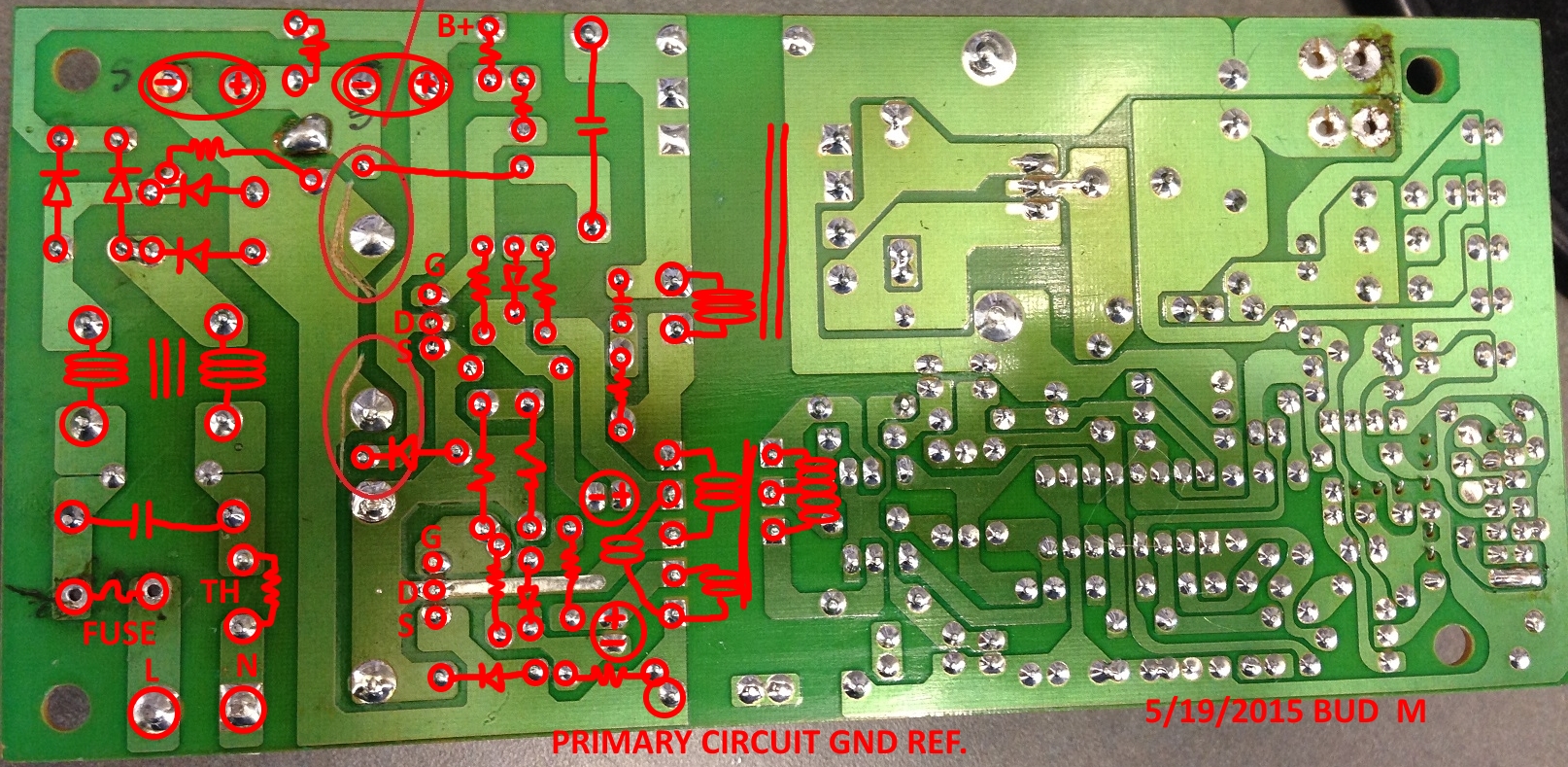

                                #55
                                Can you do straight shot of this picture? It is tilted, I need to make virtual PCB.
                                https://www.badcaps.net/forum/attach...4&d=1431638701
                                BTW, the devices (Power MOSFET or Transistor) mounted on the heatsink is shorted out so it burnt up the 2 Ohms resistor.
                                Looking at the device with big metal tab up:
                                Left pin =1
                                Center pin/tab) = 2
                                Right pin = 3
                                So check the RESISTANCE (3-pin combinations) between 1 & 2, 1 & 3, 2 & 3.
                                The drive circuit is the half bridge drive setup.

                                  Is this image better?
                                  Thanks-A
                                    #57
                                    OK, this is what I see based on the pictures (I cannot see ALL the parts clearly), it should be good enough to use for checking the parts.
                                    You should test all the components in the primary side.
