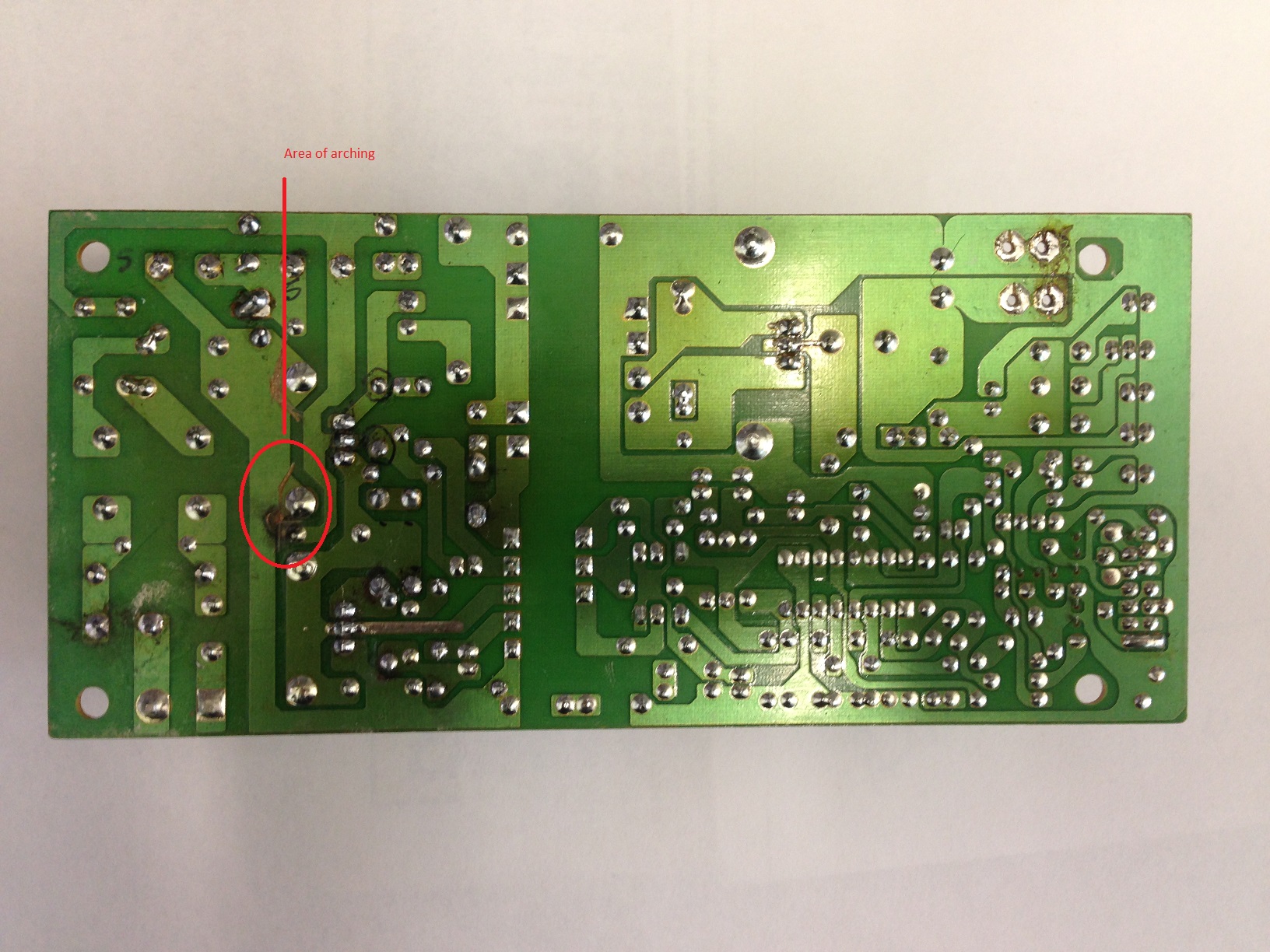

                Re: Wine Fridge Power Board
                So, the fun continues. After replacing the two 13005 transistors on the board, checking the caps and replacing the resistors, I plugged it in and almost immediately it shorted/arced in the back of the board (see photo-I have included photos of both sides of the board).
                It was mounted back into the fridge but WAS NOT in contact with the fridge itself-so that wasn't it. Of course, this blew the fuse and the 13005 transistors, which I have once again replaced, but now it is really dead when I try to power it up. The Caps still look OK no bulging or leaking. The diodes on the primary side of the board are still OK and the resistors appear fine and have not burned out, the transformer also appears fine.
                Things on the secondary side look OK, although the MOSFET there (I think its a MOSFET), #STP52045C may be cooked. I have a transistor tester on the way to be sure.
                Anyway, the arcing happened near the area where someone in the past isolated (or tried) to the heat sinks for the two 13005 transistors. Could that arching have been caused by this, either because it was incomplete or because it was done in the first place. That is, should I "repair" the etching done to isolate the heatsinks? In thinking about it, I don't think it should matter, but being a rookie, I might be missing something important.
                Again, thanks for the help. A

                  #68
                  those transistors need the mica/silicon rubber insulators and plastic washers.
                  mica types need compound too.
                  the upper one is missing the washer.

                    #69
                    kc8adu,
                    OK, I have added a rubber insulator, however the tab of the transformer is still electrically connected to the heat sink. Referring to my image of the back of the board, the lower transistor's collector is connected to the heat sink. This is not the case with the upper transistor, which is isolated due to the "scratches" put in the board. Again, these were there when the unit came to me.
                    Could the lack of connection between the heat sink and the emitter on the upper transistor be part of the problem?
                    Secondly, when the unit arced, could that have fried something on the secondary side that I should be checking?
                    Thanks again-

                          #72
                          Thanks again-I had wondered about that second transistor as it did appear connected to the board. I will continue looking for the short.

                                    #77
                                    keeney123
                                    Thanks. WRT to the short, it was rather my fault. When I replaced the transistors I used a conductive thermo-compound (a stupid rookie mistake). To get the board to "work" I re-replaced the transistors (all of them) as well as a number of diodes and resistors that were faulty. I picked up a specific transistor/diode tester to check these out and replaced the "burnt" one with identical parts. As well, I used a NON-conductive thermo-compound when I put it all back together, so no fireworks. It does sound like I have somehow managed to reduce the board's output by half as it should be able to generate 12 VDC (it is a Hanny HYS60-12-KD board).
                                    I will see what I can come up with for a schematic and post it when I can. With respect to an Oscilloscope, I do have one, but can't say that I am proficient with using it. I have mentioned in the past that I deal with a lot of "surplus" equipment and someone was getting rid of a Hitachi V-212 20 mHz 'scope, so I "recovered" it. I am still in the processes of learning how to use it. If I knew where to connect it to the board, it might provide some useful information.
                                    Could I somehow have damaged the switching transformer(s) (there appear to be two) when things shorted out?
                                    Thanks again for the help-A
