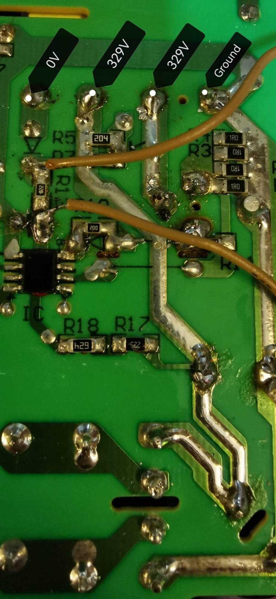

    I am curious about this primary side of transformer pin - +329V from bridge rectifier to middle 2 pins, and -ve to ground pin on the right.
    The left most pin has 0V - is this correct, and why if this is so?
    • R_J
      • Jun 2012
      • 9638
      Re: Wine Chiller - SMPS issue - fluctuating voltages
      Look at the schematic in post #17, the connections in your picture are from left to right:
      feedback winding
      Primary B+ supply
      Primary mosfet Drain
      Primary hot ground for feedback winding
      You MUST HAVE about 30v VIN before the ic will operate, Once it starts it will produce its own 16v vcc from the feedback winding. The ic's internal vcc clamping circuit is likely damaged or shorted.
        feedback winding
        Primary B+ supply
        Thank you for these information, it super helpful for my education.
        And for my further education:
        1) B+ and Drain both read 329v from the bridge rectifier. If the IC is working, how does the feedback winding gets its 16v?
        2) Vin must be 30v: but the only feed I see is from B+ through R17 & R18, and reads 3.6v, is the 30v generated internally to get started?
        In fact, I would extremely thankful if you could briefly describe the sequence of events leading to the startup and normal operations of this IC, so that I can see the complete big picture.
        Thank you.
          R17, R18 are the startup resistors that power the IC on pin 3 only until it starts oscillating. Then only a few blips the transformer takes over powering the IC. The aux winding generates around 16VDC from D4/R13 to run the IC.
          But pulling the SBD20C rectifier out, a BAD idea because the PSU would go to max. (PW) output, because it was getting no feedback voltage. OUCH! This would burn R13 and must have damaged the IC now.

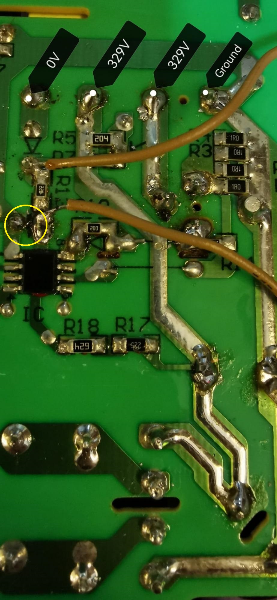

                  I had a closer look at your picture and it looks like the vcc pin (solder splash) may be shorting to ground, or is that just a reflection of the light?
                    It is the reflection of camera light. To be sure I just tested with DMM and there's no short.

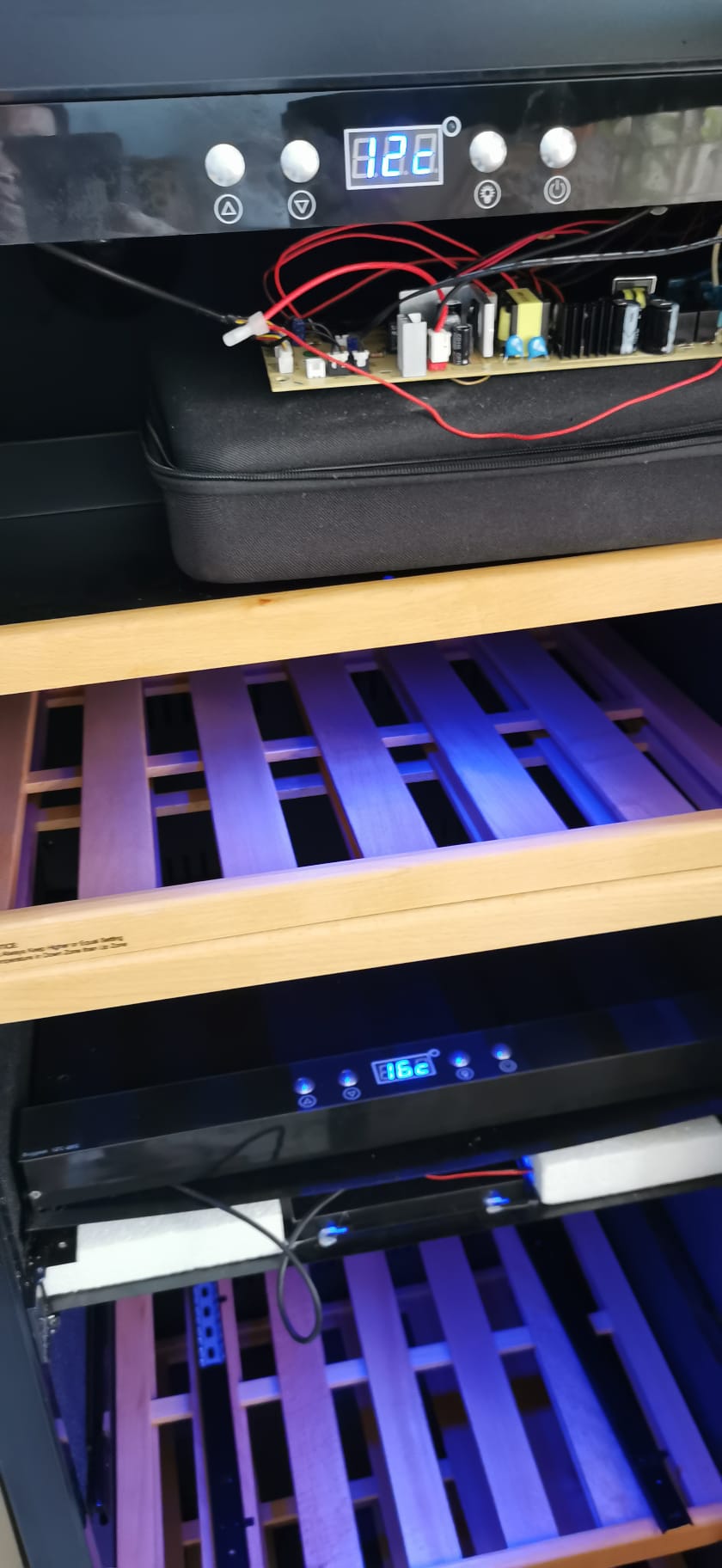

                    This chiller has dual zone. In its original operating condition:
                    - 5V supply to both zone control panel are good, but light button is not functional, and internal fans are not spinning either.
                    - Lights and Fans are all connected to 12v sockets on this board.
                    I am not knowledgeable about fluctuating voltages is the reason lights and fans are not functioning. Guess now it's no point to install it back to the chiller to check since there's no output completely..

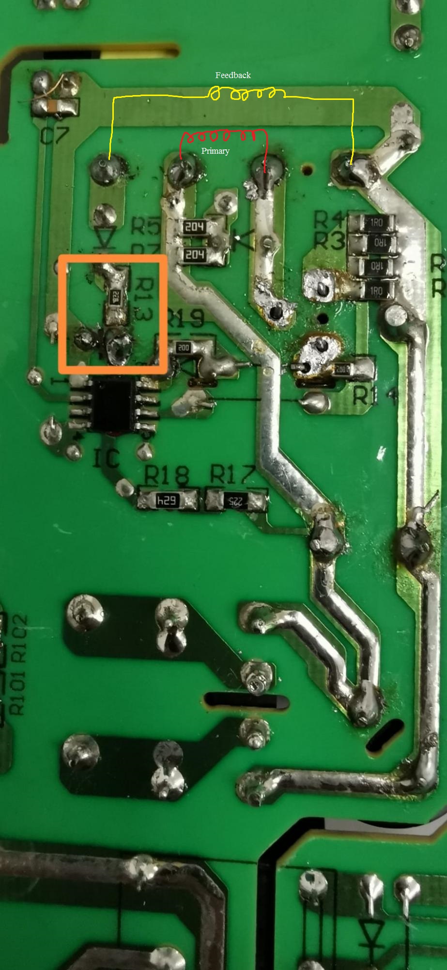

                                Here' the summary of this project:
                                1) Original fluctuating voltages must be due to 1 or more of the electrolytic capacitors bad/weak as mentioned by R_J. Replaced all of them works well now.
                                2) Removing the SBD20 Schottky Rectifier probably killed the R13 resistor and the pwm ic AP8269 as mentioned by Redwire. Lesson well learnt.
                                3) Replaced AP8269 and R13 resistor, everything in working order.
                                A big thank you to everyone shared your experience and advised the next steps. A great learning journey for me.
                                Thank you, thank you.
