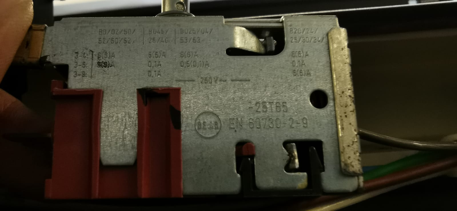

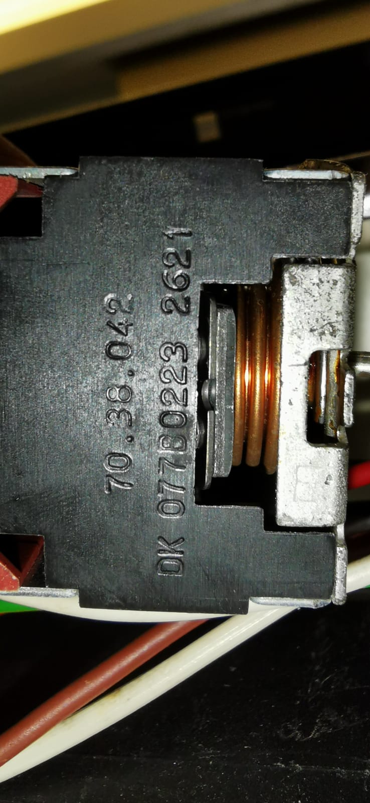

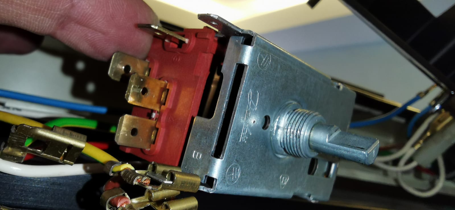

    My vintage wine chiller, Vintec model# S160SGB, mechanical thermostat failed (not cutting off compressor at set temperature anymore).
    After some initial research, this is a Dasfoss 25T65 EN 60730-2 part number.
    While this part is generally still available in some online portal, it is fairly expensive. There are many digital thermostat available with some simple rewiring, but I am hoping to preserve it with a with a less expensive mechanical equivalent part.
    Anyone familiar can recommend some less expensive equivalent?
