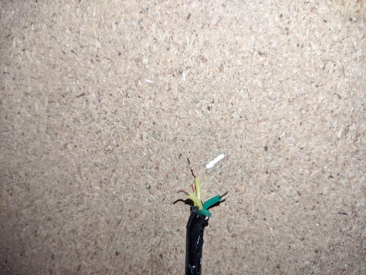

Pinout of TV antenna cable
  • spleenharvester
    • Mar 2010
    • 913
    Pinout of TV antenna cable
    Trying to bring the antenna cable down from my roof to my living room, it's currently not wired to anything. But instead of a coax cable, I found two of these 4-core monstrosities. I'm guessing the two light green wires are common to eachother, as are the two dark green wires - and each 'pair' is either signal or shield. Any ideas?
    Dell E7450 | i5-5300U | 16GB DDR3 | 256GB SSD
    • 31151
    Re: Pinout of TV antenna cable
    thats strange - was any coax with it?
    old sattelite dishes had extra control cables.
    • spleenharvester
      • Mar 2010
      • 913
      Re: Pinout of TV antenna cable
      Originally posted by stj
      thats strange - was any coax with it?
      old sattelite dishes had extra control cables.
      The house has coax cables hanging out of the ceiling in various rooms (we just bought it) so they were clearly connected to the antenna somehow at some point, but they're not connected to anything now. So I'm not sure quite how they worked with it.
      Dell E7450 | i5-5300U | 16GB DDR3 | 256GB SSD
      • petehall347
        • Jan 2015
        • 4431
        • United Kingdom
        Re: Pinout of TV antenna cable
        control cable ..maybe for a rotator .
        • redwire
          • Dec 2010
          • 3912
          Re: Pinout of TV antenna cable
          They might be balanced pairs, like 300Ω twin-lead but I'm not sure what the UK used for antenna feed-ins. One pair for one antenna i.e. VHF, the other for UHF.
          There should be a balun or two on the roof.
          • CapLeaker
            Leaking Member
            • Dec 2014
            • 8289
            Re: Pinout of TV antenna cable
            Last edited by CapLeaker; 09-30-2022, 05:29 PM.
            • CapLeaker
              Leaking Member
              • Dec 2014
              • 8289
              Re: Pinout of TV antenna cable
              Originally posted by redwire
              They might be balanced pairs, like 300Ω twin-lead but I'm not sure what the UK used for antenna feed-ins. One pair for one antenna i.e. VHF, the other for UHF.
              There should be a balun or two on the roof.
              The spacing isn't right for 300 ohm twin lead. It almost looks more like a control cable for an old c-band dish to me. Or maybe an lnb with skew control? Or a 4 wire thermostat? Dunno.
              • redwire
                • Dec 2010
                • 3912
                Re: Pinout of TV antenna cable
                It's got the the fat insulation on the conductors, solid wire- I've seen on some outdoor 300Ω cables.
                Did they even use rotators in the UK? I've never seen it here for TV, only ham use. Satellite could use that cable for DC power but the signal still needs to come into the house somehow.
                • eccerr0r
                  Solder Sloth
                  • Nov 2012
                  • 8701
                  Re: Pinout of TV antenna cable
                  I was thinking rotator wire too, and indeed they do make rotators for broadcast... so much that I thought hams decided to repurpose broadcast rotators for amateur use...
                    • 31151
                    Re: Pinout of TV antenna cable
                    the u.k. never used pairs for RF, always been coax.
                    a sattelite jack is unlikely, those use a screened feedback if done right.
                    a polariser is possible.
                    or could it have been power for a masthead amplifier??
                    • redwire
                      • Dec 2010
                      • 3912
                      Re: Pinout of TV antenna cable
                      Antenna rotators I worked with had a reversible AC motor, brake solenoid, and potentiometer for position feedback. So a few conductors required 3-5 flat 20awg outdoor ribbon cable was commonplace.
                      Masthead amp power is usually bias-T fed in the coax or two conductor DC power.
                      You wouldn't use solid copper because of the flex in the wind. It looks thick as if for a higher current load.
                      OP has got some martian cable.
                      • ChaosLegionnaire
                        HC Overclocker
                        • Jul 2012
                        • 3264
                        • Singapore
                        Re: Pinout of TV antenna cable
                        so what and where exactly was the other end of the cable connected to? i dont understand. it wasnt very clear in the first post and subsequent posts. so if both ends werent "wired to anything" like u said then the cable was just lying around or hanging around somewhere in the house. so where exactly in the house was it when u found it? and if the other end was connected to something, try to trace where the cable goes to then. it might offer some clue as to what it was for.
                        i just need to ask more questions about this and know more things about this light and dark green cabling before we really declare it "alien cabling" or "green martian cabling". or worse, get power and data/signal cables mixed up. mixing up power and signal cables is the fastest way to release the magic smoke from ic chips and stopping them from working anymore.
                        • petehall347
                          • Jan 2015
                          • 4431
                          • United Kingdom
                          Re: Pinout of TV antenna cable
                          looks like pairs of green and yellows to me .. not 2 shades of green
                          • redwire
                            • Dec 2010
                            • 3912
                            Re: Pinout of TV antenna cable
                            Maybe it's old BT Telephone Cable. What does rural telephone cable look like in the UK? I could find modern cable as a "single quad" but it's thin copper.
                              • 31151
                              Re: Pinout of TV antenna cable
                              not telephone,
                              wrong colours and phone cable uses 2 thin twisted pairs
                              one thing i noticed in that picture is the thick teflon looking insulation!
                              • CapLeaker
                                Leaking Member
                                • Dec 2014
                                • 8289
                                Re: Pinout of TV antenna cable
                                Originally posted by stj
                                not telephone,
                                wrong colours and phone cable uses 2 thin twisted pairs
                                one thing i noticed in that picture is the thick teflon looking insulation!
                                me too. Also why are there 2 identical wire pairs? It's not really twisted to be suited for phone. But then it doesn't matter if only one pair is used, because nothing is on the other pair to cross talk into.
                                I rather think it was a low voltage supply of some sort or a control cable. Small rotators don't have a brake. So a 4 wire cable would be a perfect fit.
                                The balanced twin lead idea is not right for me as the spacing is way too narrow to be 300 Ohm. What gives?
                                • redwire
                                  • Dec 2010
                                  • 3912
                                  Re: Pinout of TV antenna cable
                                  When I worked at an electronics distibutor, there was always odds and ends of the wrong cable someone had ordered, sitting in reels collecting dust.
                                  There was cheapo customers that didn't care- "4 conductor" is all they wanted and we'd sell it cheap to get rid of it.
                                  OP might just have some oddball cable that was cheap. Look for any writing on the jacket, it should have something there.
                                  • spleenharvester
                                    • Mar 2010
                                    • 913
                                    Re: Pinout of TV antenna cable
                                    Cheers everyone - still no idea what it is but I eventually found the right cable in the loft!
                                    Dell E7450 | i5-5300U | 16GB DDR3 | 256GB SSD
                                    • howardc64
                                      Samsung UN55JU650DF network/streaming problem
                                      by howardc64
                                      Fixed a 9 year old UN55JU650 by replacing backlight. Original backlight LED was still working after 27k! hours but terrible picture of course. Few LEDs were out, 5-6 lens fell off (bright white spots) and another few popped off with slightest force. Surviving LEDs were all slightly blue so picture has a blue tint.
                                      This TV runs older Tizen OS (updated to latest version, see pic) and have problems with network (wifi or ethernet) connection. The Tizen UI frequently switch to coax input source while changing content sources. . If no good signal (coax not connected, no prior antenna/cable...
                                      07-09-2025, 12:44 PM
                                    • wolf1976
                                      samsung 46c8000 i didnt find adapter cable BN39-01154P Cable-Accessory-Antenna G
                                      by wolf1976
                                      hi
                                      can anybody tells me if there is an adapter like the title
                                      in every link tells is discontinue
                                      or is there some other way to replace it ?
                                      i cannot find the special male coaxial plug 7,5 mm that is connected on pcb board
                                      thanks on advance...
                                      02-29-2024, 02:02 PM
                                    • Chaks
                                      Ground Plane For 5dBi ISM Band 865-870Mhz Embedded Ceramic Antenna
                                      by Chaks
                                      TAOGLAS ANTENNA MODEL: ISPC.86A.09.0092E
                                      The specs says ...
                                      High antenna efficiency 868MHz ISM Band
                                      5dBi Peak (when placed on 30cm x30cm ground plane) - Broadside to Zenith Radiation Pattern
                                      The antenna is 50x50 mm square and How do I fix it on the Ground Plane of 300 x 300 mm (aluminium sheet 3mm thick).
                                      1. Should I Fix it with a glue.
                                      2. Should I fix it with a double side adhesive tape
                                      3. Should I fix it with Screws (the screw head may just clamp the antenna to the aluminium...
                                      12-09-2024, 11:06 AM
                                    • eccerr0r
                                      Log periodic antenna to Coaxial cable... balun right?
                                      by eccerr0r
                                      I acquired a (large) used rooftop log periodic broadcast reception antenna and it didn't come with wiring. I figure I could use it for parts if nothing else but first I'd like to see if this thing actually works for receiving distant stations.
                                      From passing from amateur knowledge, these log periodic antennas need to be matched to the impedance of coaxial cable, nevermind the balanced nature to the unbalanced nature of co-ax. So I'll need to locate a balun.
                                      So I was wondering about people who worked on rooftop terrestrial broadcast antennas...are these log periodic...
                                      05-14-2022, 06:42 PM
                                    • SolomonMan
                                      Antenna...
                                      by SolomonMan
                                      All,
                                      I recently moved to a very rural area. I am about 25 miles from the nearest urban settings (2 separate College Towns). 45-50 miles from a Urban City (Toledo Ohio)
                                      There was a Omni-directional Wineguard Antenna (amplified) that was mounted on the house originally. Came with the house. Center of the top of Roof a few feet from Chimney on a 4 foot pole. The 75 ohm line went from the roof down 2-3 stories to the small Wineguard amplifier and then it split to the living room and master bedroom. Currently a Very simple setup.
                                      Since we moved in, 8 years ago,...
                                      10-05-2023, 02:37 PM
