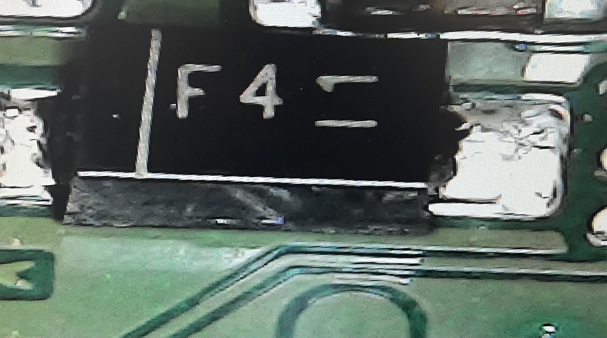

    hard drive logic board Diode identification
    I need to replace this small diode that is found on the logic board of a hard drive. What type of diode is this so I know I buy the correct one.
  • R_J
    • Jun 2012
    • 9633
    Re: Diode identification
    What type of drive? there are different types.
    Where is the diode in the circuit? is it across the supply voltage? if it is it is likely a zener or TVS diode

      Re: hard drive logic board Diode identification
      It looks like this BZX585-C3V3
        If its a protection diode,remove it and recover data.Dont use furter without diode !
          The hdd should turn on without that TVS / zener diode installed, but you loose over voltage protection. The new PSUs where you can disconnect unused cables aren’t standardized. So a Thermaltake cable.will fit in an EVGA PSU, but it reverses the voltages on the sata end. And then exact this will happen when you turn the computer on the first time. Guess how I found out.
          I’ve replaced the diode and kept the HDD running. Got over 8000 hrs on it, no problem.
