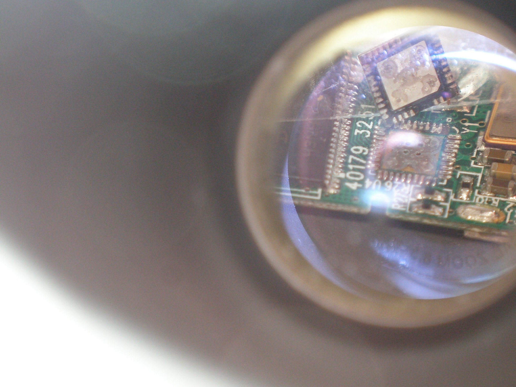

    so. A lady came in today with a broken flash drive. she just needs the data off it.
    the USB controller chip broke off (with some of the legs too), but if I can grip it down hard enough, it contacts enough to detect and see ONE flash chip (the one without the FAT)
    so, what I need is a replacement controller chip so I can clamp it down and get her data off the chips, which from what I can tell, are still good
    Its a SM3251L-BB. I get almost no luck with google searches, and apart from asking silicon motion myself for one freaking chip, which they will probably charge me up the 4$$ for, maybe one of you can help me get a working one?

      I don't need to 'resolder' it. the legs are bottom contacted, so all I have to do is keep the chip held down tight, keeping them contacted, and I can probably pull the data off it. Its easy to do, if 5 of the legs weren't torn off the chip

          I don't know if pics are possible, this is tiiiny. i'll try, but no guarantee

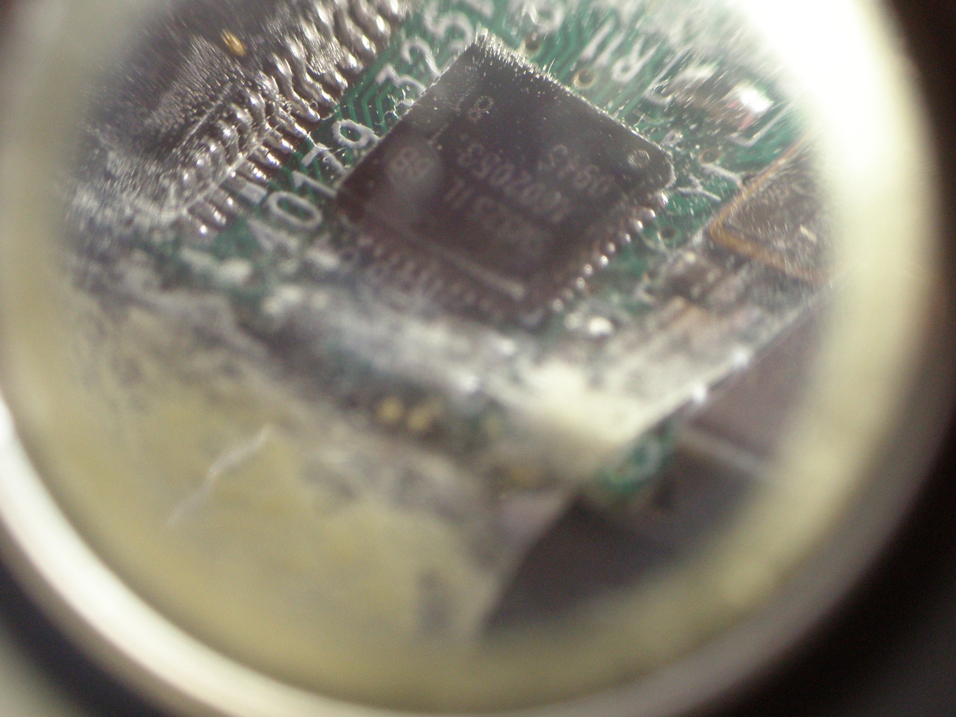

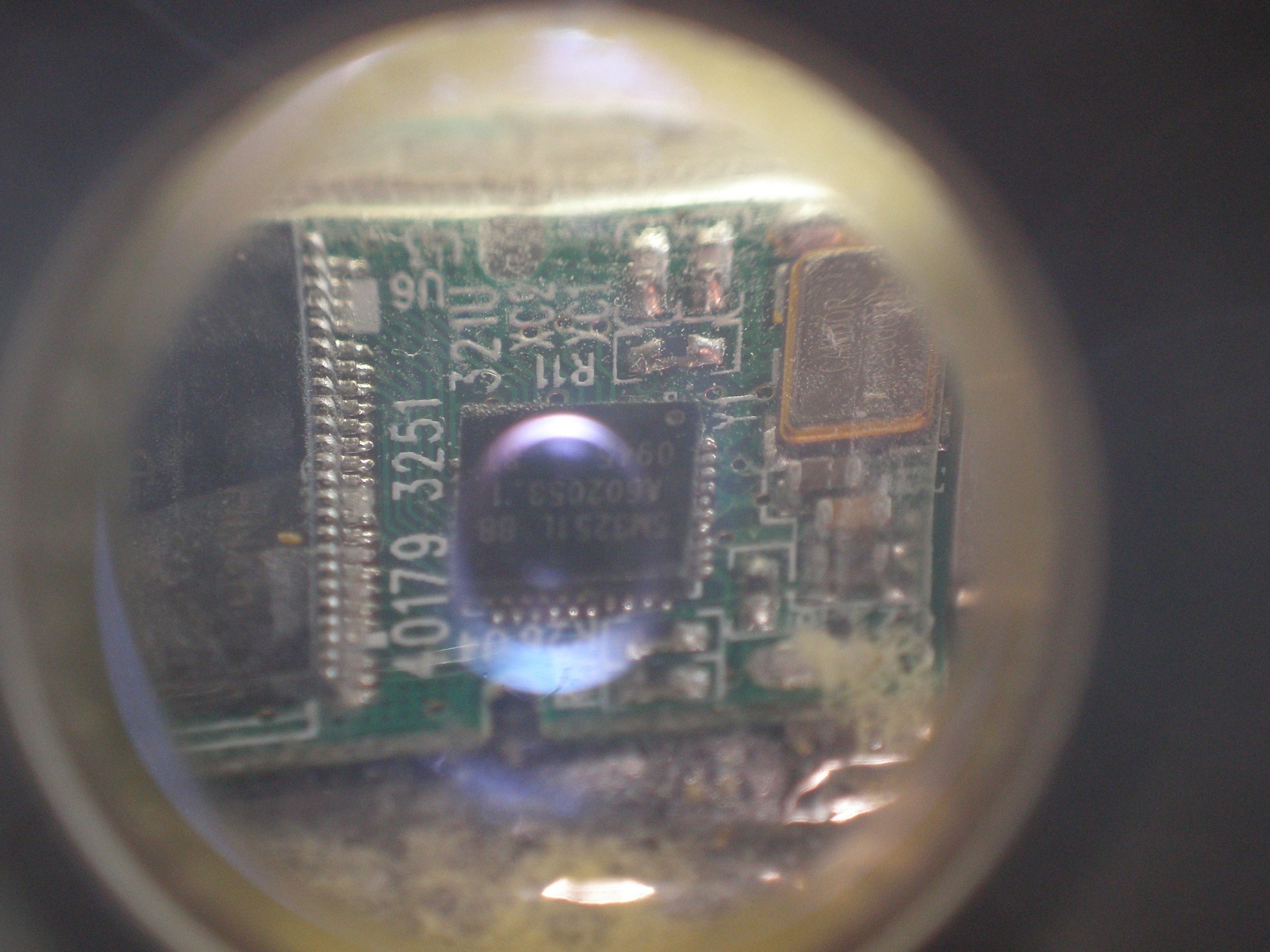

            well I used my camera behind my magnifier, here it is. it came with the chip detached, then she took it to our electronics guy who took it off the rest of the way before discovering some of the legs were broken off

                easiest solution would be to get the same stick from ebay, confirm its working and then swap the flash-chips..
                i did that before when i accidentally walked on my own stick.. bent PCB with ripped-off traces.. argh..
                just dont mix up the chips... upper side chip has to go in the same place on the "new-old" stick..

                        there are like 5 legs that are broken off too far to even hold it down

                          Its probably easier to get a donor drive and swap the flash chips with a hot air gun.
                          *Just looked at your pics. Some of the pads are torn off, a new chip will do squat.

                            I'm pretty sure all I have to do is take my Iron and push some solder over where those pads were

                                  Swap the memory chips, they are not BGA so it should be easy.

                                    Yup, i even did that without a hot air station a few times. Cover all pins on one side in solder, prop a thin screwdriver under that side, and push on it while heating the mass of solder. Repeat for the other side, use braid to get the solder off afterwards.
