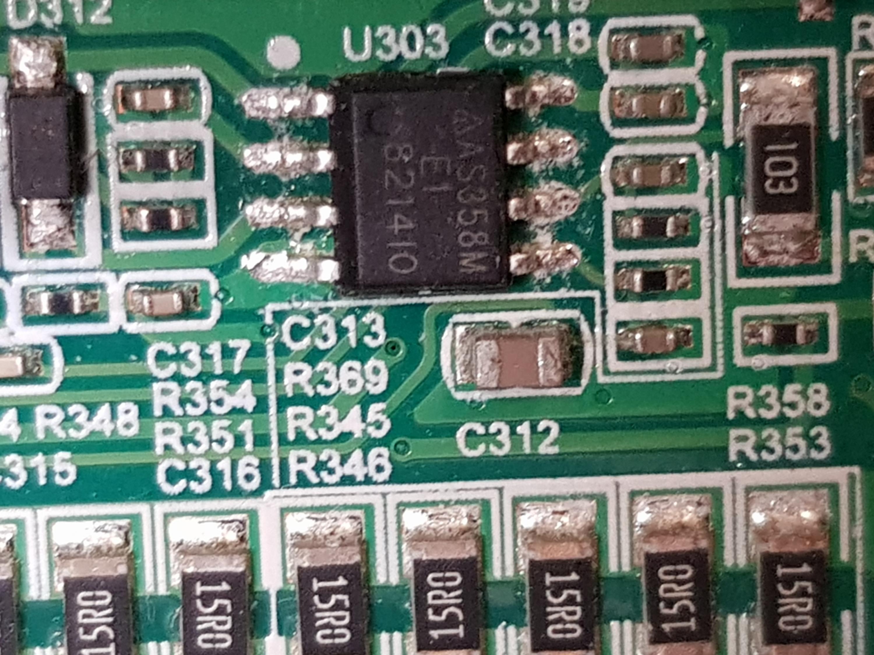

    does anyone have this IC: as358m?
    since there are other signs on the 821410 and the ones i find have different signs +a month wait time for delivery. very grateful if anyone has it and wants to help

    Re: do you have this: AS358M-E1
    maybe it's an LM358 using a manufacturers prefix
      how to know ?
        • 31012
        https://www.diodes.com/part/view/AS358/
        looks like a match
          please which of them would fit? They don't have the same ending? maybe it doesn't matter? https://www.diodes.com/part/view/AS3...product-option
          Do you have one for me?These are in Honk Kong at least a month wait time
            It is the part number in the first line plus the second line is what you are interested nothing else would else is need because the rest of it is date code and or plant location
            Which the data shows what you have it is the first one on the list
            AS358M-E1 The only thing that is not on the ic chip is the “-“ which does not make a difference
            The “E1” just means that it lead free
            You are just going to have to wait there is a global ic chip shortage and there is no cure for this type crap issue but just wait
            This company you are lucky that you were able to find the data sheet for this part number because a lot of there ic chip are not on the internet and find somewhere to find there chips are extremely hard to find
              That's an SO-8 package, so you want the AS358MTR-G1. You could probably substitute an LM358 or BA10358 in the same package if they're easier to find.
                  The only question I have will this ic chip operated the same exact way or would have to modify the circuit for it work correctly
                    if it can be replaced with one of the ones you mentioned then maybe it will be easier to find in those circuit boards that I have
                      Is charger something special or is it that you just like it features
                        it's a very common chip, if you have scrap boards of any type you will probably find a few.
                          No it's an ic in a power supply to a tv Voxicon K550WDC2 for which I've opened a thread here in tv repair but no one wanted to help and as I think this part is broken
                            that's exactly what i was thinking when lti said:
                            It's an SO-8 package, so you want the AS358MTR-G1. You could probably substitute an LM358 or BA10358 in the same package if they're easier to find.
                              I do not go to the tv repair section very often so that is why I did not see it
                                Probably any company's __358 in the correct package should be OK. The LM356 has been around since the 1970s. There may also be an LM358A still on the market, an improved version, but the original is good enough that the improved version didn't displace it.
                                  please how will I know the "right package" if you could enlighten? so a LM 358A would fit?
