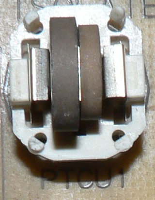

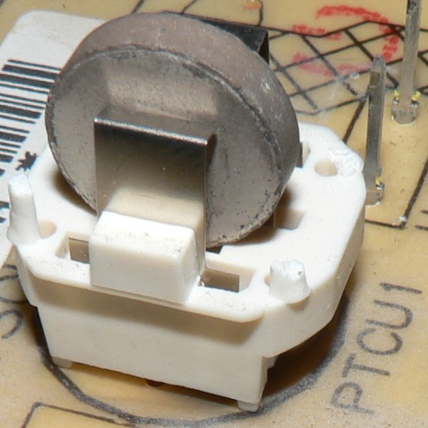

      Another interesting component labeled PTCU. There are two coin-like pieces of metal inside...
      What's that?

          Malmal's answer is funny, but not quite correct, electronically speaking. The component you have is a positive temperature coefficient resistor/thermistor unit, and these are used for current limiting tasks.

              Re: SG - what does it stand for?
              lol
              it's called a ptc, it's used to power the degausing coil for a few seconds at power up.
              after a few seconds the thing is so hot that the resistance increases & cuts power to the coil.
              heres a tip - they do fail.
              if you desolder one and it rattles - it's fucked.
                It's supposed to have a cover.
                    Yeah I have it somewhere...
                    Thanks for the answers...
