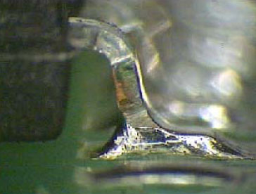

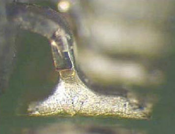

                      Re: Lead-Free (RoHS) and Reliability
                      i was curious why goot talk so much about the tips in their lead free RX-802AS.
                      Well the most popular lead free solder is SnAgCu otherwise known as SAC. This melts at about 217oC which is about 34oC higher than good old 60/40 tin/lead solder at 183oC. It is recommended to heat it to 40oC above the melting point. Other lead free range from 215-217oC
                      actual tip temperatures are about 343oC for lead free and 315oC for leaded. you might be wondering why we remove caps around 450oC, well the large ground planes in the motherboards, particularly p4 and later draw heat away from what you are trying to heat. ideally you should turn the iron down when you solder the new caps in but high temp with minimal dwell time doesnt seem to damage the new caps.
                      anyway one of the factors with lead free is increased temperature affecting tip life. that wont really affect us because we are soldering at higher temps already. it will be interesting to see if lead free soldering will not be possible at 450oC because more emphasis is placed on the flux.
                      unfortunately lead free solders have slower wetting so will require more active and corrosive fluxes and more amounts of them in the solder. this will also increase solder and flux spattering. they also require cleaner surfaces and longer dwell time.
                      tips for soldering are copper (high thermal conductivity) with iron plating (maintains the shape and prevents copper dissolution) but iron has poor thermal conductivity so is thin and all plating has defects. with the higher tin content of the lead free solder, the tip has shorter life because iron leaches or migrates to tin.
                      as regards to the person using the lead free solder, will it be more healthy? well actually the more agressive flux used will increase the requirement for fume extraction. there is actually no lead in fumes anyway, but it is not good at all to breathe flux.
                      will good old 60/40 continue to be available : yes
                      how do lead free joints look like?
                      lead
                      lead free
                      basically they look like cold solder joints need more info on how to spot bad lead free joints.
                      also apparently lead free solder is unforgiving and it is important to keep the iron tip very clean.
