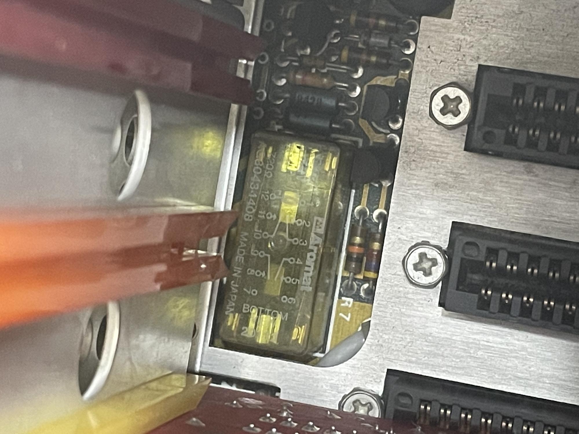

    I've got an old Motorola R2200 service monitor which gotten wonky, because the previous owner had it sit in a damp basement. Almost all basements are damp around here. Of course it uses an unobtainable relay. Most of the 80s stuff doesn't use sealed relays, rather have a see through plastic on top that pops off.
    Problem is that this relay needs to be cleaned. However the relay is so small that my burnishing tools do not fit. Same problem with other old gear that use these small miniature relays with the clear top cover.
    What's everyone's mini relay cleaning secret?

            pictures or part numbers would help
              Re: What is the best way to clean old relays?
              Aromat AC8043.1408

                  i cant find any reference to that relay other than search hits on this thread!
                  got any pictures?
                    The dilemma is that this relay is under the card slots. Couldn't be any worse than that.
                      it looks similar to this one, but I cant make out the coil voltage on yours. https://www.ebay.com/itm/AROMAT-S-SE...-/131730385563
                      The coil resistance of 720Ω seems to be 12v coil, the 5v one has a 130Ω coil

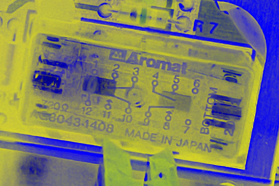

                        My relay is 720Ω... There are 2 relays in there I noticed in the service manual. I guess, I have to find now the other one. The AG number on the relay is different on ebay. Anyway if I could find a sealed relay replacement, that would be the best idea.
                          I would say you have read the numbers wrong and it says something like Aromat AQ3043.1408
                          The drawing on the relay shows a "4 form A" configuration, the last two terminals are empty.
                          Panasonic S4EB-12V would be a replacement example if the pin spacing is correct:
                          https://eu.mouser.com/ProductDetail/...uUfO%2Fw%3D%3D
                            Thanks Per! The first 2 letters AC was wrong, but it’s an AG as far as I can see. The second letter is not a Q and not a C.
