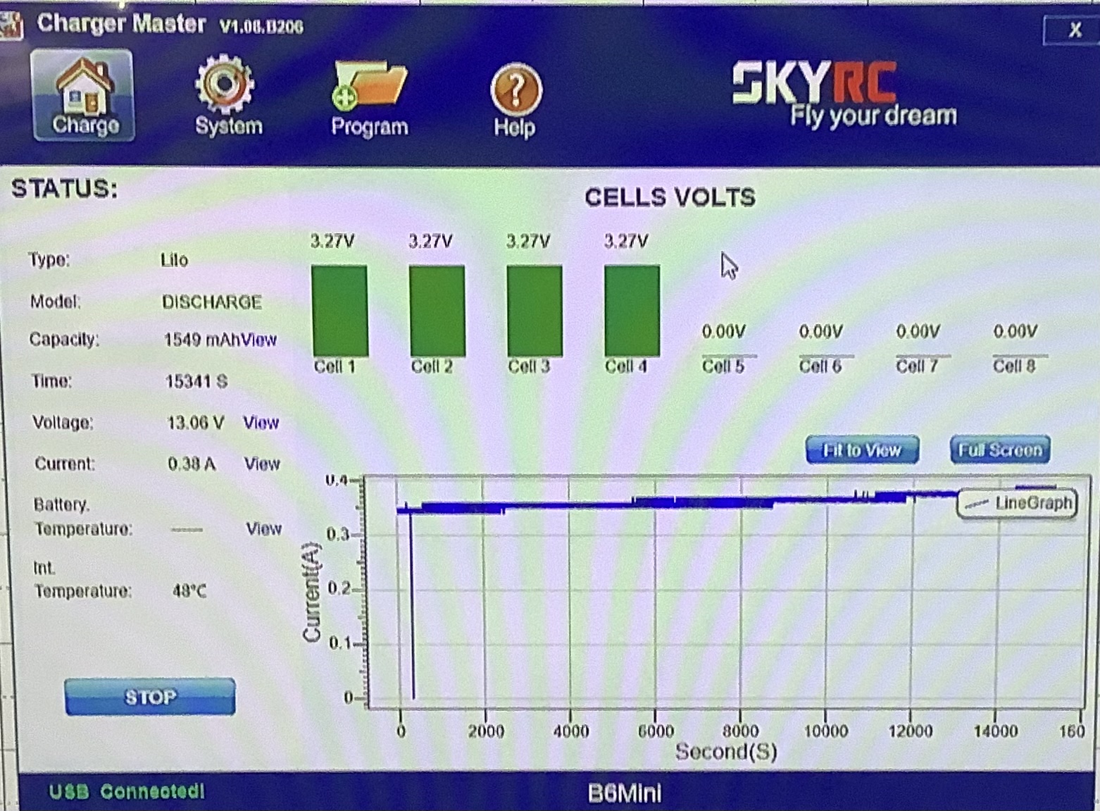

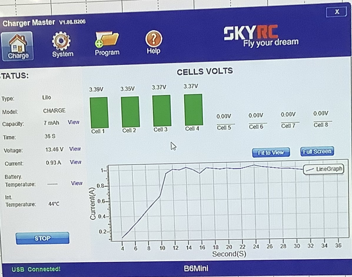

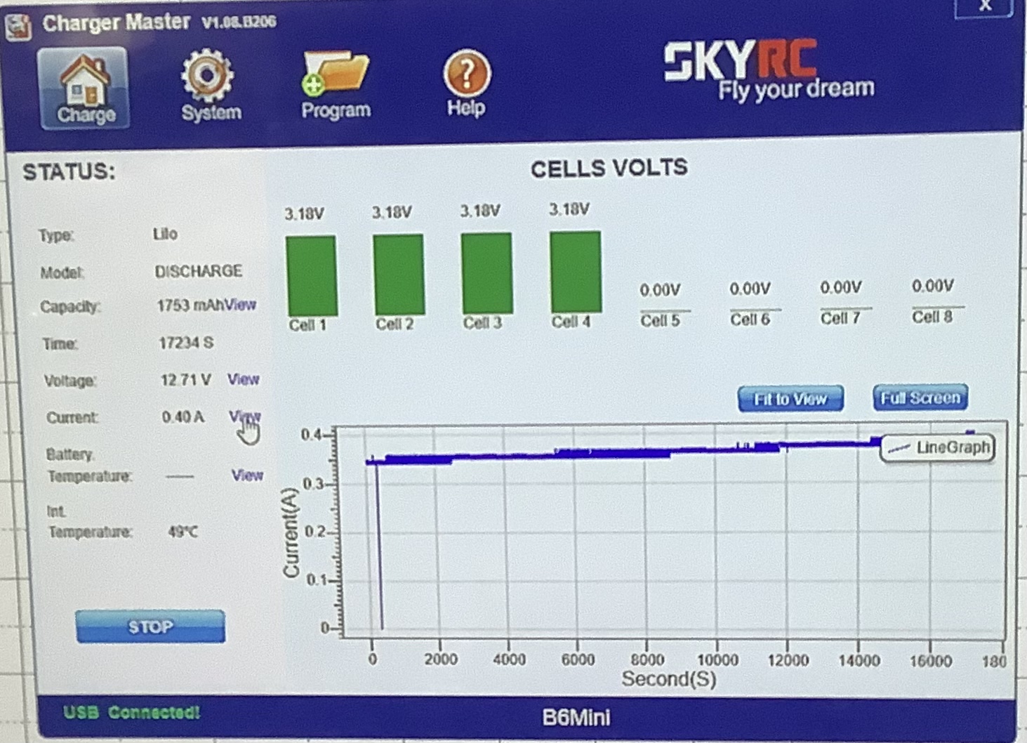

                                  • 6070
                                  #36
                                  Re: Is there a way to modify a IMAX b6 battery tester version 2 to only monitor volta
                                  Here is a battery on test right now
                                  You might have noticed that the battery temperature sensor is not hooked up you are correct when I make a testing jig for this charger I will be using it I know that there is nothing wrong with this battery pack
                                  I am just testing the battery voltage monitoring capacity of this battery charger it seems that the voltage monitoring system is constant with the battery voltage reading that I took with a volt meter before I put it on this battery charger the voltage between battery cells was very close to each other
                                  I am also checking the BMS balancing protection board that is on this battery pack this is the only battery pack that has the balancing protection the other 3 boards are only protection boards only but the size and shape are exactly the same and used these same exact battery cell but this board that I am testing had some different types of batteries on it three batteries were leaking and all of them the CDI had been tripped
                                  Now I changed it to the charging mode and let see how well it does over time I had checked for a little while when I first started with hooked up to the battery voltage monitoring system and seems to work ok but I did for about 10 minutes or so
                                  This is one of the battery packs that I got from Battery Hookup unfortunately they are sold out of them after I had done some testing of them I want to buy some more of them but I will not be able to but I did send them an email to see if they would be getting anymore of them back in stock
