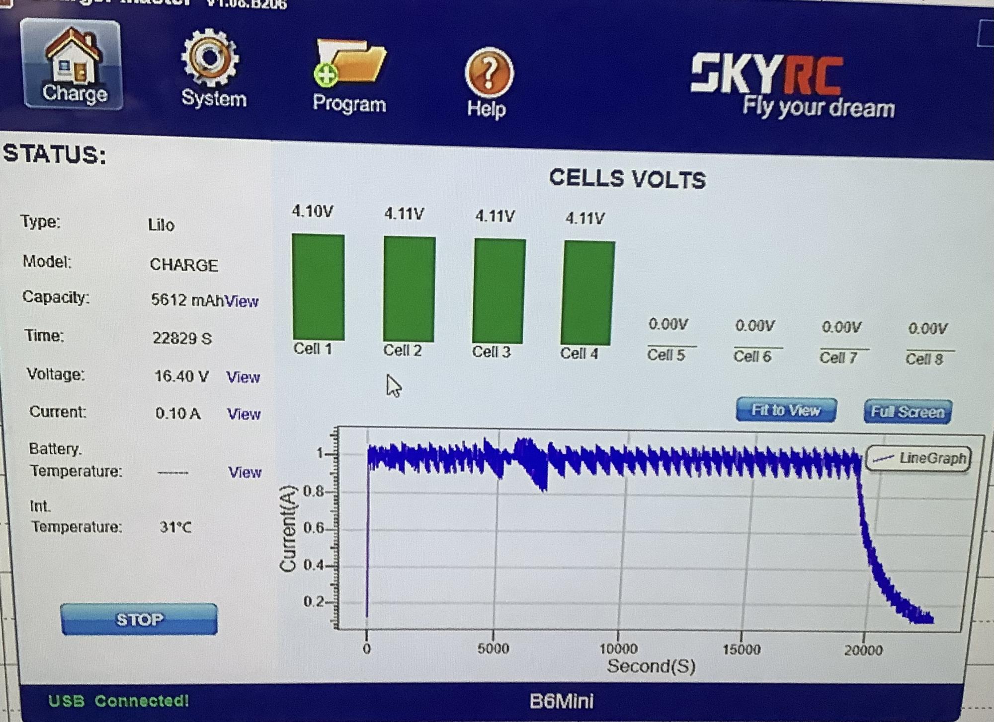

    Here is the results when it got done with charging the batteries

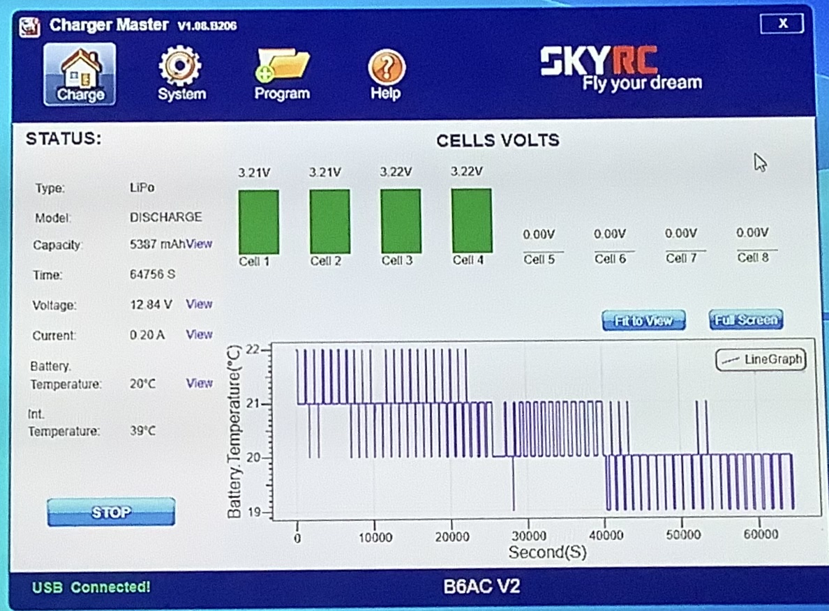

          Here are the results from the battery testing that was done on this battery pack
          The conclusion about the use of this charger to monitor battery cell voltages is that it doable but the actual balancing protection function you do have watch the screen to see how well it manages the voltage you do not have a way to see over a period of time because the software does not have this function which is a shame if does not have
          This is something that would be very useful to me if it had it but I am not a software writer but if I was this would be a function I would have included and might have given up the temperature graph maybe even the overall voltage graph which to dose not do much for me overall
          One note the only useful thing about the temperature sensor capability is very useful for when you are doing single battery cells for multiple battery cells to me is not very useful
          Anyone have any thoughts about the function of this battery charger used for BMS balancing protection monitoring battery voltage on each individual cell
