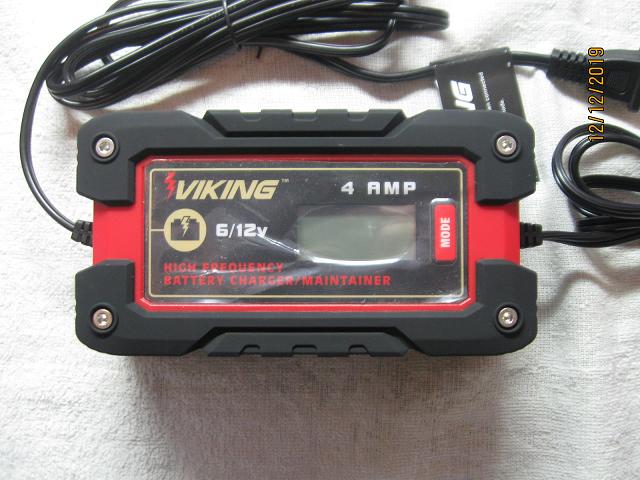

                    The HF 63350 charger/maintainer seams to be hit or miss on quality control.
                    Purchased one on sale in 2019 that was an open box (returned ) charger and it would not stop charging. After 48 hours it was charging with 15 volts so I returned it.
                    This year they put them on sale again and I picked up a sealed new box and this charger has worked fine.

                        Originally posted by ron350
                        Purchased one on sale in 2019 that was an open box (returned ) charger and it would not stop charging. After 48 hours it was charging with 15 volts so I returned it..
                        If the box was already opened and the charger was returned, don't you think that there might be a reason for this?
                        You complain that opened and used item was faulty.

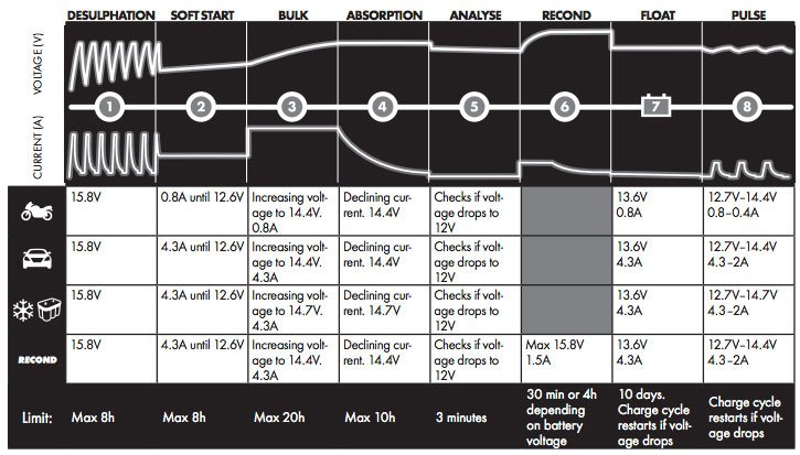

                          I just returned an Energizer 2A car battery 6V/12V maintainer charger - 5 yr warranty and the electronics were good quality but the firmware is crap.
                          It would look for several volts before turning on the output relay. So a really discharged battery esp. 6V it would not do anything. So I used a lab power supply to fool that.
                          Then, it would send a full current pulse and if the voltage went high i.e. 14.4V it would go into ERROR thinking the battery had an open cell or something. Instead of restoration.
                          Problem is these microprocessor chargers are too complicated to actually work properly. Pic is an 8 stage charger!
                          Example, it's charged your car battery and it's sitting at 13.8VDC float and life is good. Then the parked car does a canister purge, draws a few amps for 30 seconds so the voltage sags. Or the RV fridge runs etc. The case of a load appearing for a short time.
                          "Smart" chargers get confused and either restart the bulk charge/top up/equalize routine again, while other chargers do nothing and just stay in the float state.
                          Both are wrong - the first will overcharge and the battery uses water, the second method the battery sulfates.

                              Originally posted by redwire
                              "Smart" chargers get confused and either restart the bulk charge/top up/equalize routine again, while other chargers do nothing and just stay in the float state. Both are wrong - the first will overcharge and the battery uses water, the second method the battery sulfates.
                              You can't expect 15EUR charger to be very smart. They fulfil they function, but have some shortcomings or flaws. The situations you mentioned are complex and lets be honest, most of the people need charger to occasionally charge their batteries, not use them in complex scenarios.
                              You want 15EUR charger to fulfil the function of device which is at least several magnitudes more expensive.
                              The MCU inside the charger gets confused because the device was never meant to be used in such environments and scenarios.

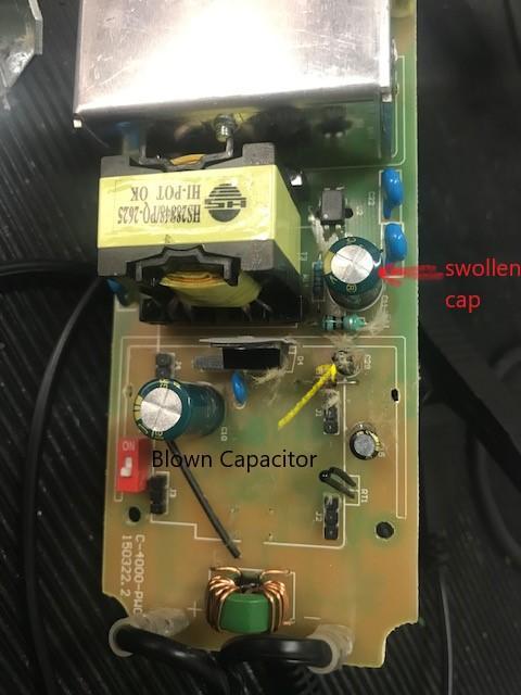

                                    One review had blown capacitors, another said it's actually 12V 2A and 6V 4A so around 25W. The "4A" label is misleading.
                                    That's the problem - a low battery will overload any charger and chinese stuff is already pushing parts too hard and poof.
