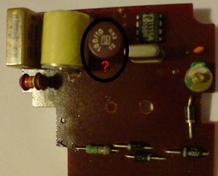

    This quartz clock is increasingly slowing. The capacitors (one removed in picture), resistors and diodes tests OK. I'm suspecting the 4194.304 kHz quartz crystal, but don't have any tools to test it. The clock is about 20 years old, and the oscillation might be failing.
    I'm wondering if anyone can identify the component I've ringed on the picture. There are no markings on the board.
    I'll probably order a new crystal at DigiKey next time I've got something more to order. Does anyone know how much importance the Load Capacitance has on a crystal? I can't find a datasheet on the original ITT 1385 part.

    that looks a lot like a fuse.
      • 31208
      Re: Honeywell quartz clock component
      btw, the green ajuster on the right is a variable capacitor to fine-tune the crystal - maybe it's contaminated (fucked)

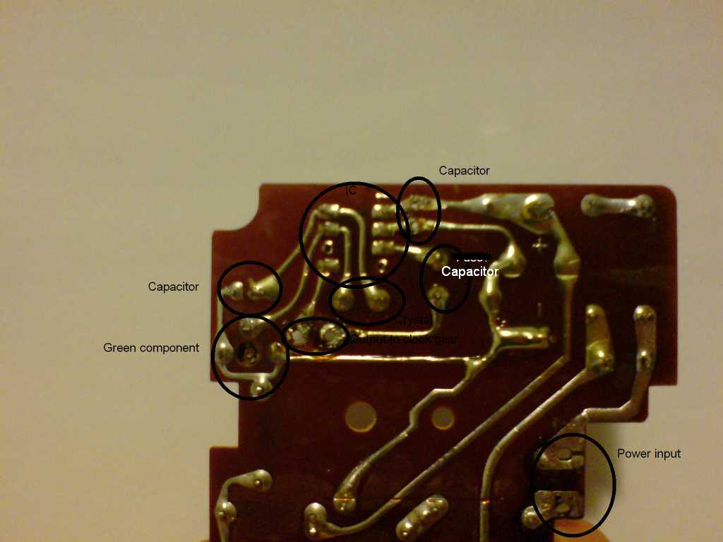

        I've enclosed a picture of the trace side of the board. If the brown component were on the power input, I would have thought it was a fuse also. Also there is no continuity across the legs of the component. The clock does work (slowly), so I knew there was no broken fuse. So I just did something I didn't think of before, measured the capacitance. Bingo, 122.2 uF. So, the brown component is some kind of 100 uF 10v capacitor (ESR 0.75).
        I thought the green component was a variable resistor, but wouldn't bet on it. I can measure resistance, but no capacitance, in circuit.

          is the thing in the yellow paper sleeve a backup battery?
          the brown thing looks like a fuse 2a if the foto was better i'd bet it had a voltage printed too.
          the green variable capacitor wont show on most meters - it's in the pf range.

                    Looking at the tracks on the back of the board, that component is in series with the clock mechanism, so if it was a blown fuse, the clock wouldn't be working at all.

                      The yellow thing might be a battery, but dead now. No markings on it. Just a metal can under the yellow paper. There are +/- markings on the trace side of the board for it. Could a failed battery cause this? The circuit doesn't seem to depend on it.
                      As I said in my last post, the brown thing is a capacitor of some type.
                      Among the ranges my meter do, is 0-500 nF, lowest 0.01 nF, so it should measure from 10pF and up.

                            how wide & deep is that brown thing?
                            it's either a 100uf 10v electrolytic - ancient type.
                            or a fuse like this:
                            http://www.littelfuse.com/products/F...831200000.html

                                It's definitely a capacitor, as it got a capacitance of 122.2 uF. 11 mm wide x 13 mm high.
                                The weird thing, is that there is a modern type electrolytic of 16v 10uF there (removed on the picture).
