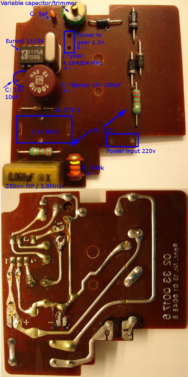

      Yes, I found that the clock can run without the battery. But since the the clock normally is only monitored once a week, I find it best to have a backup battery in, in case of power outages.
      Info 1 -> Google translation
      Info 2 -> Google translation
      Anyway, due to the unknown handling of charging (overcharging) in the clock, I find it most safe to replace with a NiCd. I found a source for a 110 mAh NiCD, but it's not stocked, so there is some delivery time.
      I'm enclosing a new picture of the board, with annotations.
      Thanks for now. I'll report back when I know more.

            The circuit is a very basic design. The zener diode, electrolytic smoothing capacitor, and battery are all connected in parallel across the supply pins of the IC. If the battery was a dead short, the clock would stop.
            It seems to me that the battery is acting like a resistor, drawing current & pulling down the supply volts. This could be causing the IC to operate erratically, perhaps causing it to "miss a beat" every now & again, slowing the clock down.
              I would agree with that.

                IMO, there is one most likely fault, the trimmer capacitor. It is unlikely the crystal itself would drift this much, at so high a rate.
                You might try turning that capacitor through it's full range several times, but first marking what position it had and counting turns so you can return it to the original position, and do some comparitive testing for how much changing it's position one direction or the other changes the time rate of change.
                  #48
                  Re: Honeywell quartz clock component

                              I drew a schematic from the photos sofTest posted.

                                    Trimming resistors do fail. But I'm not sure if trimming capacitors do the same as well since there isn't any direct electrical contact.
                                      #58
                                      variable capacitors get contaminated or tarnished and it creates a resistive path and effects overall capacitance.
