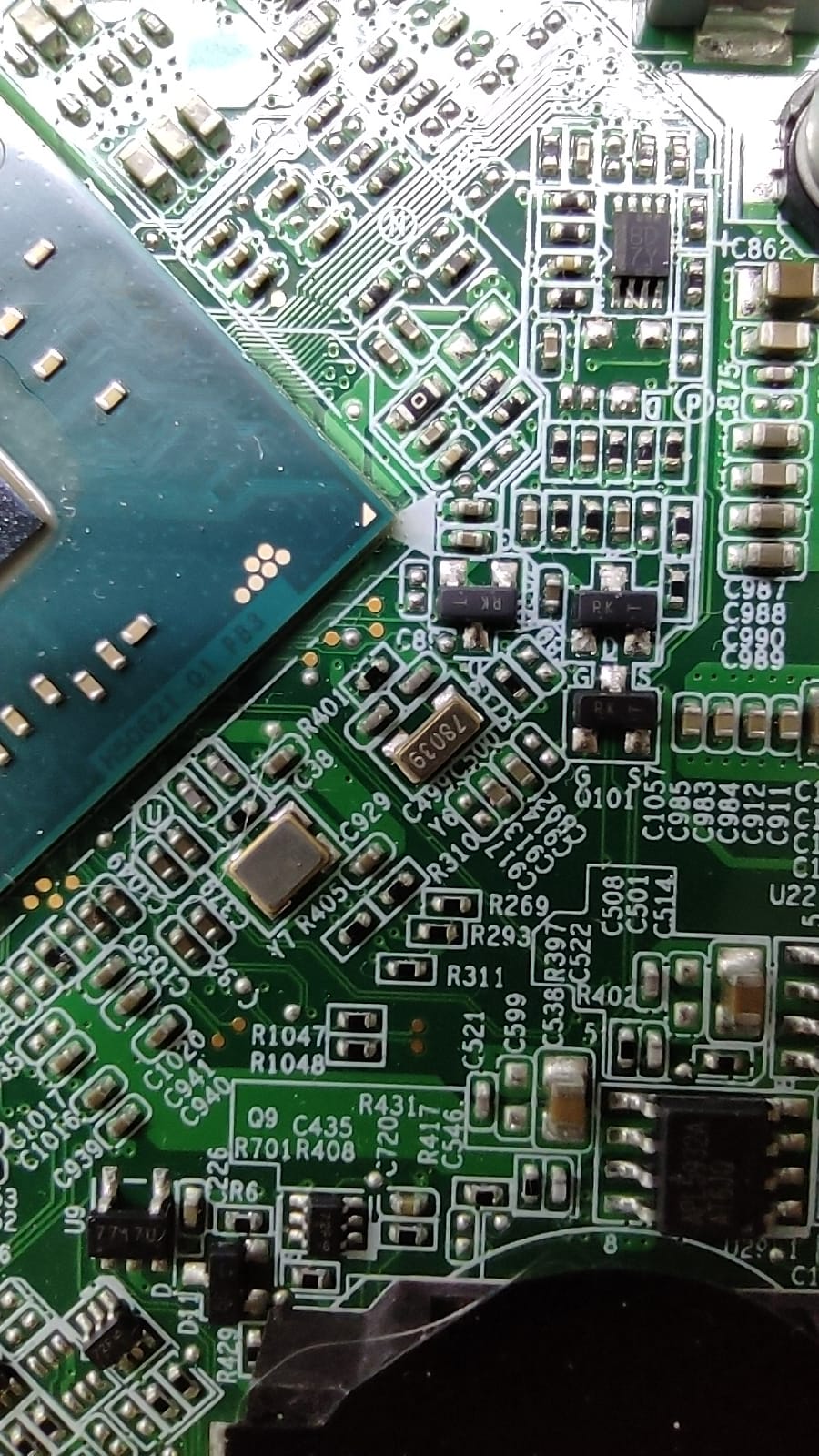

    Hi!
    Funny problem. I have a board, model 71r-h14bw6-t830, it's a shuttle board used commonly on a lot of cheap laptops/AIOs.
    The clock (RTC) is not working when the machine is turned off. Doesn't matter if it is connected to dc power or not. When the PC is powered on, the clock works fine.
    I tried replacing Y6 and Y7 (picture below), but it doesn't seem to be an oscillator problem.
    I don't have the exact schematic for this board, but I'll provide one that is similar (a variation of the same board).
    Any suggestions?
    OBS: when the pc is off, the clock STOPS, it doesn't reset. When turned on again, it starts counting time normally (with the clock now starting from where it was when it was turned off). I thought of just setting up a script to resync time on logon but I rather use that as a last resort.

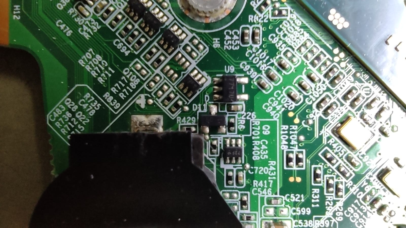

    Check the voltage at D11, pin #3 (+3.3VA_RTC).
    What is the voltage when powered ON?
    What is the voltage when powered OFF?
    This is a dual common cathode diode that will select the higher of the 2 input voltages.
    When the power supply is OFF, the RTC should be powered from the diode leg #1 connected to the battery.

      Re: 71R-H14BW6-T830, clock stops when shutdown
      DC plugged, machine turned off, 2.87V (3.08V on pin2)
      DC off, 2.85V (2.98V on pin1)
      Sorry, forgot to mention I had tested the diode already.
      Also, SRTC_RST# after R407 is 2.8V

        Is the crystal @ Y6 a known good crystal ? Should be 32.768khz which are very common for RTC circuits.

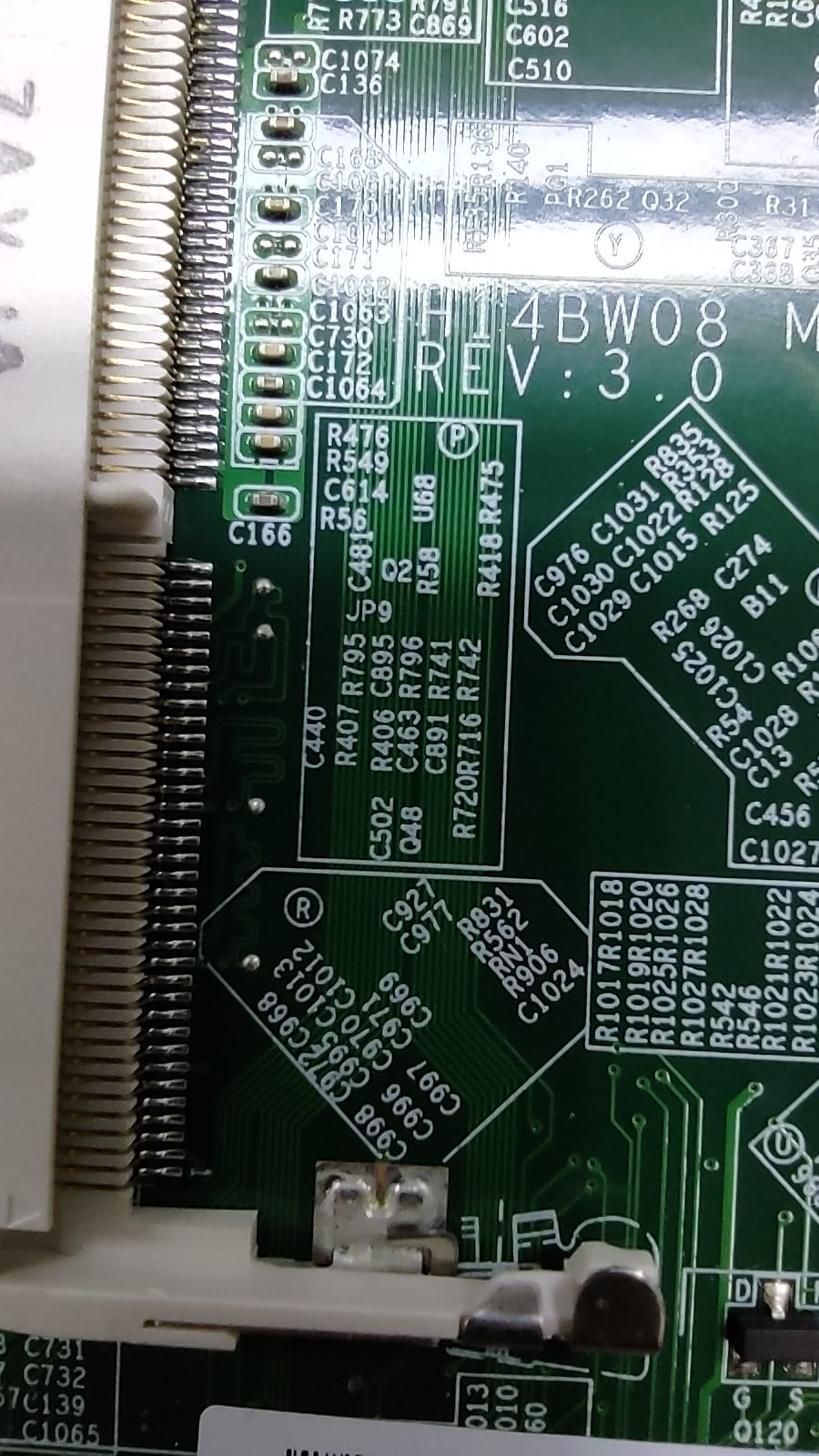

            What is the voltage @ RTC_TEST# ? (C463 & R406)
            Remove all power -> meter in resistance mode. Check the resistance to ground on each side of the same crystal (Y6).
            This clock crystal is not very critical and can be tested with the same frequency of component from other boards - even different packages.
              2.8V
              more than the meter can measure, but this is also the case in a known good board that I have. in diode mode .9V drop
