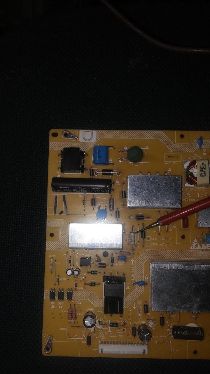

                  Re: 4.7 ohm fuse resistor?
                  The power supply board and the probe points to the fusing resistor that's bad.

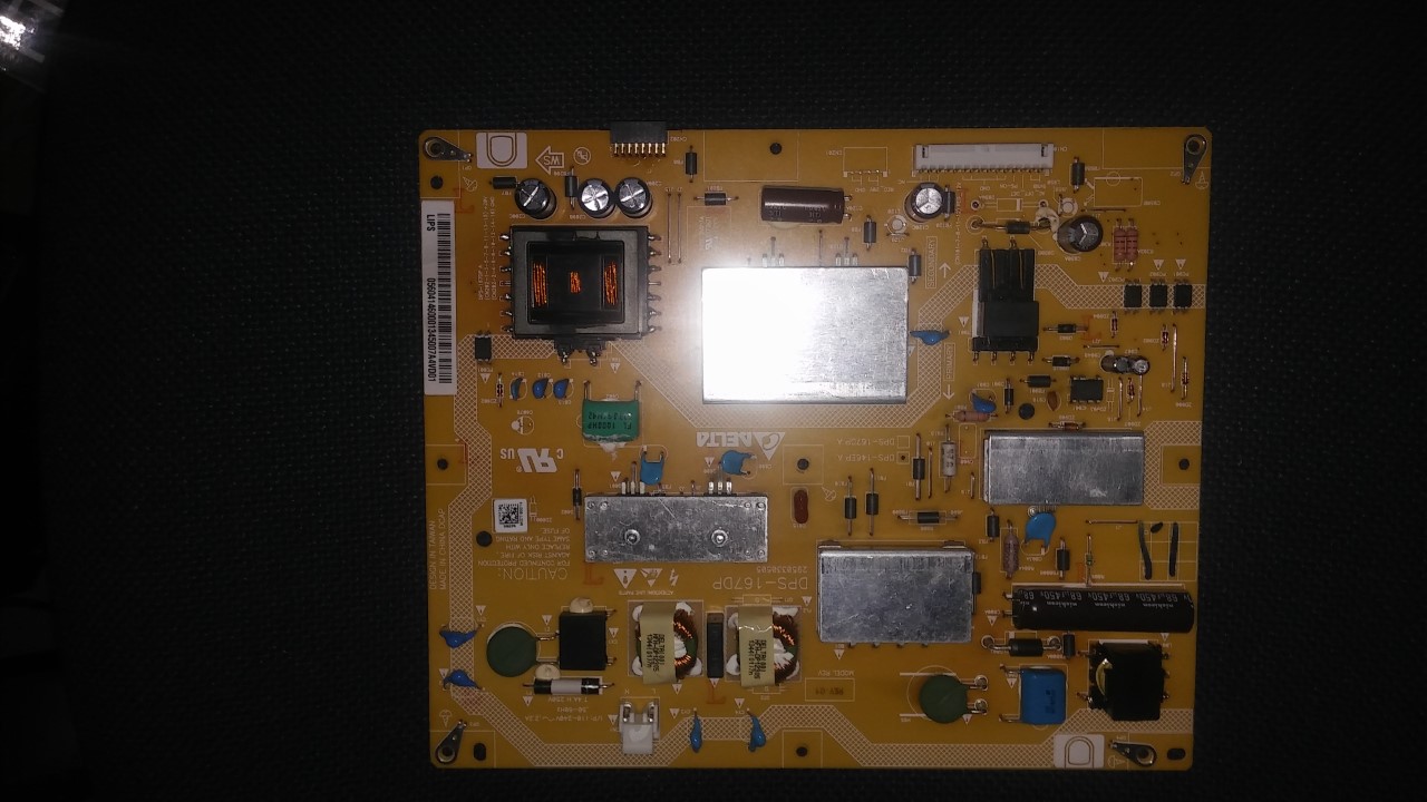

                    other pic
                      The pictures are too out of focus for me to read the prints on the board, it looks like that fusible resistor is for the Standby power supply, so you need to look up the spec sheet of the 7-PIN SMPS IC and the check the pins to see if it has shorted out or has very low resistance between S and D pins of that IC.
                      You should also check the resistance between the negative leg of the main filter cap (big black cap laying on its side) against each solder pad of the blown fusible resistor.

                        I replaced the 7-pin ic, the old one was blown. I also replaced one zener diode and the shottky diode. I get no reading between negative side of main filter cap to either side of blown resistor.

                          [QUOTE=stinger;1010157I replaced the 7-pin ic, the old one was blown. I also replaced one zener diode and the shottky diode. I get no reading between negative side of main filter cap to either side of blown resistor.[/QUOTE]
                          Ah the BIG missing information about that blown SMPS IC in post #1, now we know why that fusible resistor is blown since now we know what that fusible resistor being use for what section of the circuit using the requested pictures.
                          It always good to give us details info.
                          You can use flame proof MOX resistor for replacement, just match the Resistance/Wattage. For testing right now you can use 1/2W resistor and use the setup below to perform the test.
                          You can test the power supply board by itself to see if the standby power supply is working now or not by installing 75W incandescent in place of the main fuse, you should see the lamp comes on bright for second then it should dim down and then you can check the output of the standby power supply, if the lamp stays on bright then you still have issue on the board.
