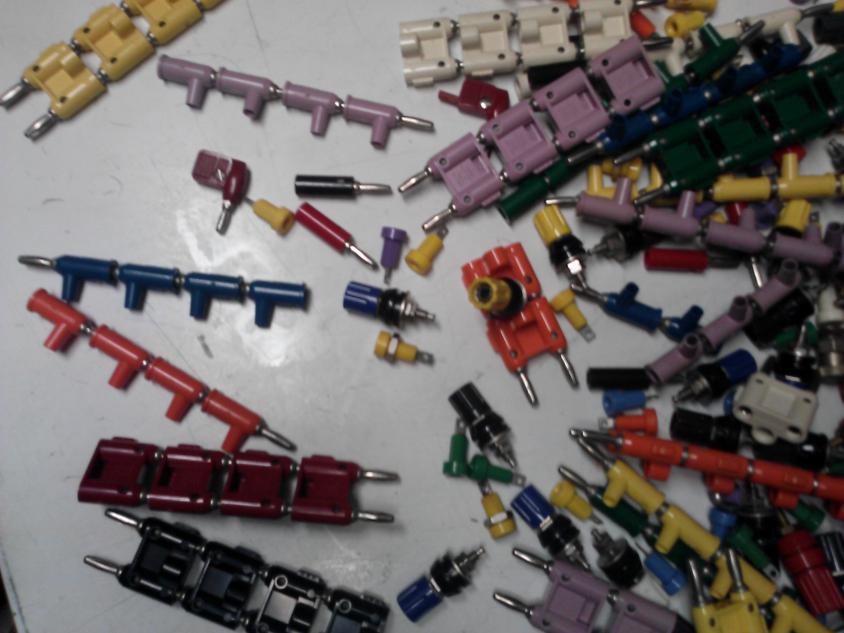

                                I'd snapped a pic of some binding posts to give you an idea as to what you (and sam) might want to consider, going forward. The smallest JACKS that I have are illustrated near the center of the image (I can't take pictures with this phone worth a damn; but, its more convenient than my iPhone or any of my "digital cameras")
                                Note the yellow one in the center adjacent to a blue "binding post". I've aligned the two of them based on their "seating surface" (front of enclosure). You can see that they protrude roughly the same amount into the case. I was prepared to argue that you might want to opt for the binding posts, going forward.
                                But, I stumbled on the OTHER photos (scroll right) and see that your "cheapest smallest available on ebay" are a fair bit smaller than mine. So, disregard.
                                You may, however, consider the spacing of the jacks. I'm not sure you've ever seen dual banana PLUGS (see pic)? This would allow you to mate a specific cable to the box -- instead of two individual "test leads".
                                Finally, with your off-board pot (Vadj), consider tying the wiper to the "unused" end of the pot. In this way, if the wiper ever loses electrical contact INSIDE the pot, there will still be a fixed resistance between the two leads running off to your brick. I.e., it will be as if you'd suddenly turned the pot to one extreme (instead of the pot appearing to be removed from the circuit).

                                  I have some binding posts enroute from china, they actually look compatible with the current banana jack plugs. We'll see how they work.
                                  https://www.ebay.com/itm/5-Pair-4mm-...d/372171948616
                                  Do the dual banana plugs have a standard spacing? I searched and found one that was 14mm on center. That's an easy one to implement (I think)
                                  Interesting idea. I think I'd rather the pot fail than be locked on high voltage, I'd have to see if that makes the buck converter go high or low.

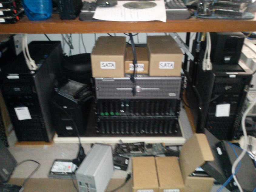

                                    As for as relocating the brick, I wanted it in the power supply to give it some weight.
                                    Ah! That's a good point! And a good realization (instead of discovering it AFTER the fact!) I put rubber feet on things that "don't weigh enough" to keep them from sliding across the table as I push on their buttons or try to mate with their connectors. I put FELT feet on heavy things so I can drag them off of <whatever> as I prepare to lift them. (e.g., my disk shelfs have felt feet which means they will slide backwards as I engage disk sleds in them. So, I am constantly pulling them back into place)
                                    I also can't stand cords everywhere.
                                    Understandable. There are ~60 power cords plugged into the underside of my workbench. Of those, only four are for "bricks" (a pair of HP t620's and a pair of Surface Pro 3's). The alternative is to plug/unplug devices as I need them (which is a PITA).
