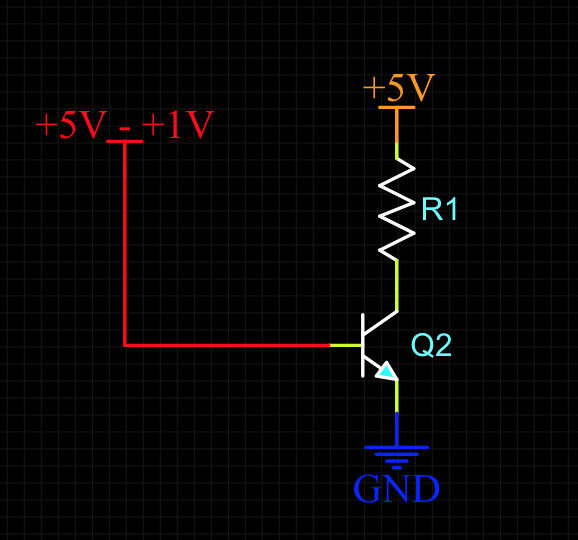

Need a circuit that switches ON when a 5 volt source drops to 4 volts or less
  • EasyGoing1
    Shock Therapist
    • Sep 2016
    • 977
    I don't know the first thing about where to even start looking for the result I'm looking for ... but what I want, is a circuit ... or maybe a certain transistor ... that will remain "closed" when the voltage at the base is 5 volts, but when that voltage gets to 4 volts or less, I need that transistor to turn on - preferably with maximum saturation. I would prefer that it also does not even turn on a little as the voltage approaches 4 volts, but remains closed until that voltage hits 4 volts.
    Now, it would be OK if it had some kind of marginal transition from zero saturation to fully saturated once it hits that 4-volt threshold ... like say for example at 4 volts, it starts to turn on but is not fully saturated until it reaches 3.9 volts or whatever ... a 1-volt margin in that characteristic would be acceptable.
    I hope my question makes sense and that it's clear what I'm looking for. If not, please let me know.
    Thank you,
    See attachment for a simple visual.

    you could start with something like this then adapt it .. maybe long way round though . https://www.homemade-circuits.com/lo...uit-using-two/
      Re: Need a circuit that switches ON when a 5 volt source drops to 4 volts or less
      You need to study and understand how Transistor work and how to bias it. You will blow-up that E-B junction, if you understand Transistor then you would not have the BASE CONNECTED DIRECTLY TO 5V source like that. How did you come up with the connection like that?
      https://www.badcaps.net/forum/attach...5&d=1578528302
      You SHOULD to this thread: https://www.badcaps.net/forum/showthread.php?t=81784
      You lack basic understanding of electronics.
      Do the experiment by hooking up the high current 5V power supply directly to the E-B junction of that NPN Transistor and see what will happen.

        go back to your original thread,
        and learn about schmitt-triggers and the difference between transistors and mosfets.
                  If you study the theory then you would not have made this kind of connections.
                  Heck, I study from books older than 1960 and I never stop learning.
                  How can you gain knowledge if you think it is insulting?
                  It is obvious that you did not do any studying.
                    Connecting a transistor as you have drawn will make smoke
                    People want help - but "give me the answer" instead of "I'm trying to learn more about electronics".
                    The difference is a person will learn the basics about a transistor, it only has 3 leads.
                    We can't do much if you withhold a part number or details etc. even after people ask for more info.
                          What about using a STM1061 series (STM1061N38) to drive one transistor (which would turn OFF when under 3.8 volts) and it could turn ON the output transistor.
                          There are theres like the ON NCP304A
                            A LM311 with a resistor circuit will make a level sensor like a sync seperator .
                            Used one in my diode radiation detector I made last year.

                                  The cirucuit I drew was a pseudo-circuit to illustrate the general effect of what I was looking for ... it never was a literal circuit.
                                      1) So far you did not provide the spec of the IR receiver.
                                      2) The screen shot of wave form of the IR output.
                                      3) The real circuit that you actually made.
                                      4) Did you actually run the simulation of the circuit you made?
                                        If you are working with voltage detections above 2.5V and need a quick and easy way to accomplish this use:
                                        431 current shunt
                                        (i.e. TL431, KA431, AS431... and etc.)
                                        It's the easiest (IMO) 3-terminal "voltage detection" device to use for that function. If you have Anode connected to ground (how these 431 shunts are often used in PSUs) and the voltage on the reference pin goes above 2.5V, then the Cathode pin will short to ground. You can use the Cathode pin to drive a transistor circuit or whatever it is you are trying to drive (just mind the limitations on maximum current you can drive through the 431 shunt.)
                                        Now, to detect a voltage that is different (and above) 2.5V, use a simple resistor divider between your threshold voltage and the reference pin.
