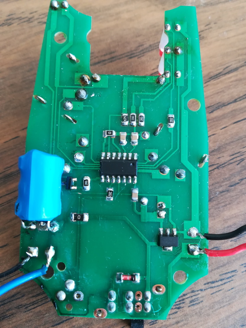

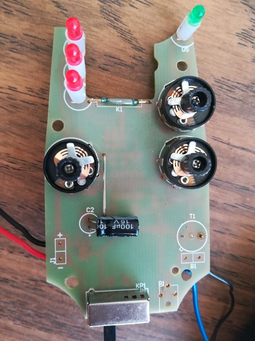

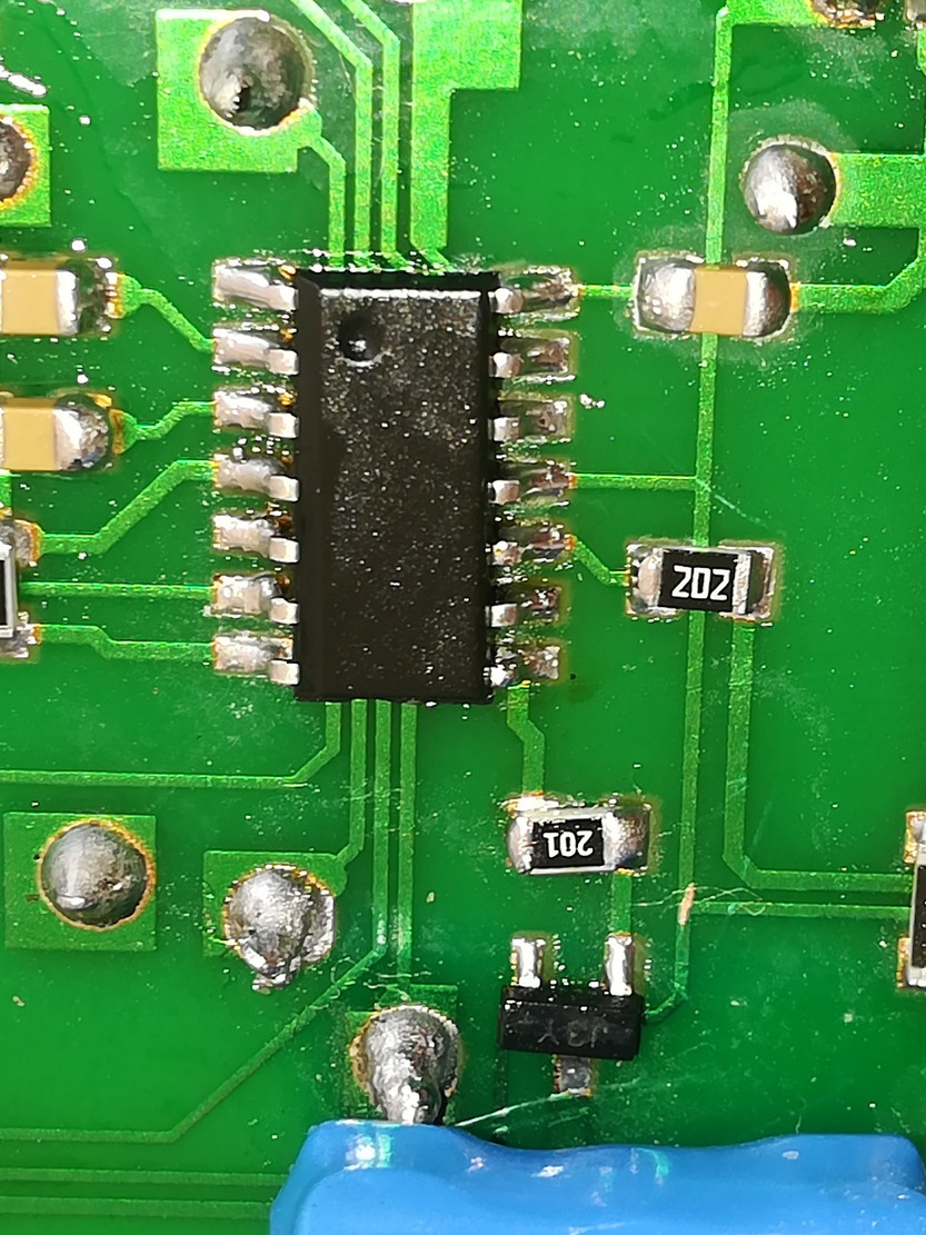

    Good day to all. The bite alarm drains 9-volt Krona batteries. Current consumption when switched on is about 50 mA. I wiped the board from oxides, I will attach a photo (on the board there is a j3y transistor and a 7533 stabilizer, the microcircuit is erased = (the 3.3-volt stabilizer heats up weakly. I replaced it, nothing changed. I unsoldered the microcircuit, the consumption disappeared. The resistance on the pins of the unsoldered microcircuit from the point clockwise is more than 2 megaohms, the 11th leg is presumably ground. I warmed up the microcircuit, the consumption does not change. Voltage in standby mode - pin 1-0
    2-0
    3-0
    4-3.3 volts
    5-0
    6-2.3 volts
    7-3.3 volts
    8-0
    9-0
    10-0
    11-0
    12-3.3 volts
    13-0
    14-0
    when it beeps
    1-2.2 volts
    2-2.6 volts
    3-2.1 volts
    4-3.3 volts
    5-2.8 volts
    6-2.3 volts
    7-3.3 volts
    8-0
    9-2.1 volts
    10-3.3 volts
    11-0
    12-3.3 volts
    13-0
    14-2.1 volts
    please help me what kind of microcircuit is this to replace

      Put a 2S LiPo in or 6 x AA(A) and you got all kinda of power. Hardly anybody makes anything that uses a 9V block anymore, besides smoke detectors and gas alarm. Even garage remotes use a CR2025 and a smaller controller.
      The only thing you didn’t check are the MLCC. For a 10 Bucks fish alarm it’s not worth friggin around with too much.
