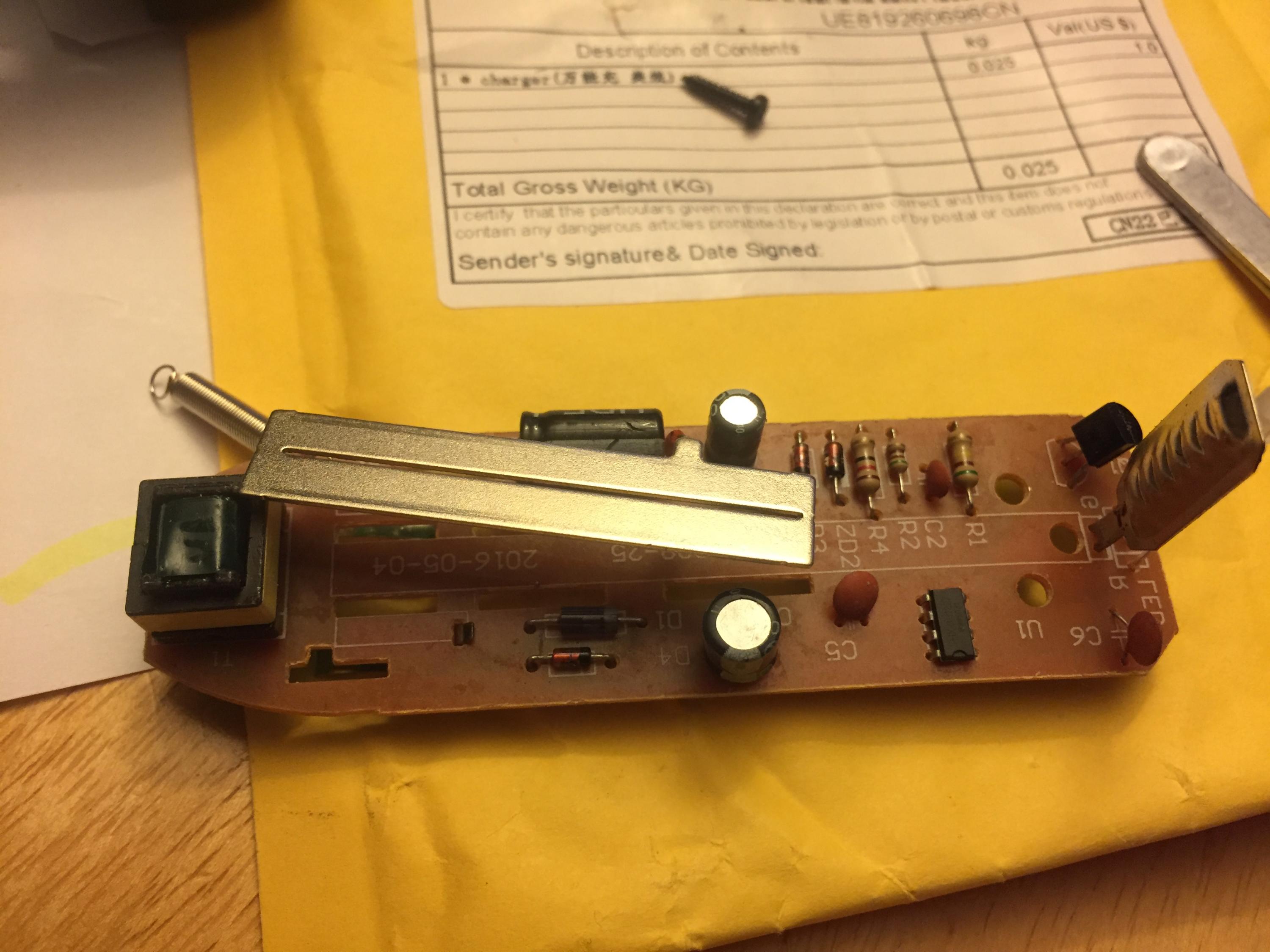

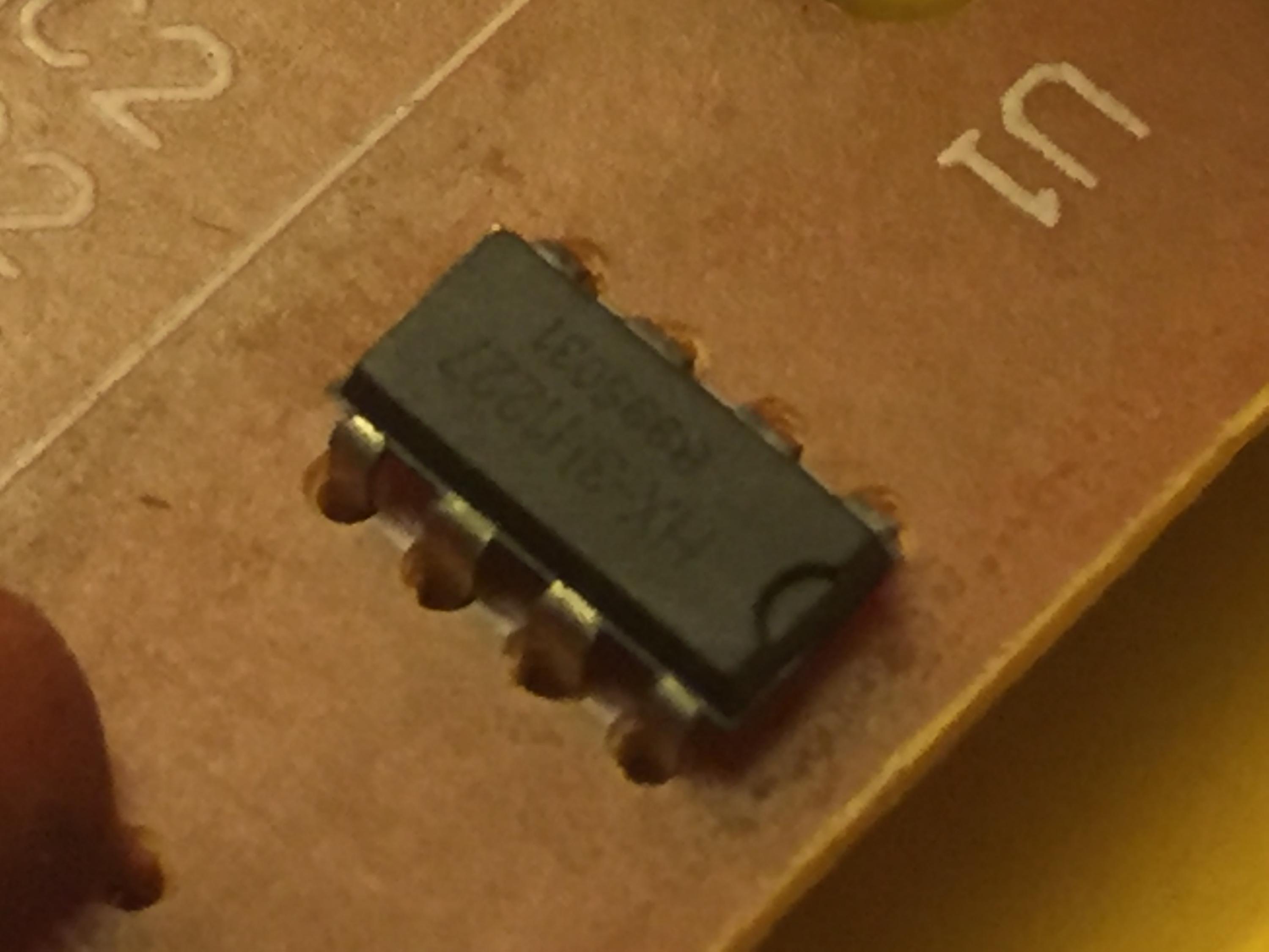

    I would like to modify this simple charger (for lithium ion cells) so that it will stop charging at a lower voltage.
    The IC used is HX-3H1227. I could not find the datasheet from the internet. I have send e-mail to the manufacturer or factory asking for the datasheet and got a reply saying that they also could not find it.
    I would like to know if somebody can help me on getting the datasheet and/or how to lower the stop charging voltage.

    A couple of things what is the input voltage
    The second thing what is the two diodes that are Zener diodes what are the are the part numbers or the voltage on the output of diodes

        Input voltage to the charger can be 110-220 AC, and I use 110V AC.
        It is hard to see the no. on the diodes so I better measure the voltages across them.
        When the charger is not charging:
        ZD2: 163.4V
        D3: 5.78V
        D4: 3.58V
        When the charger is charging a cell:
        ZD2: 150.4V
        D3: 7.3V
        D4: 4.32V

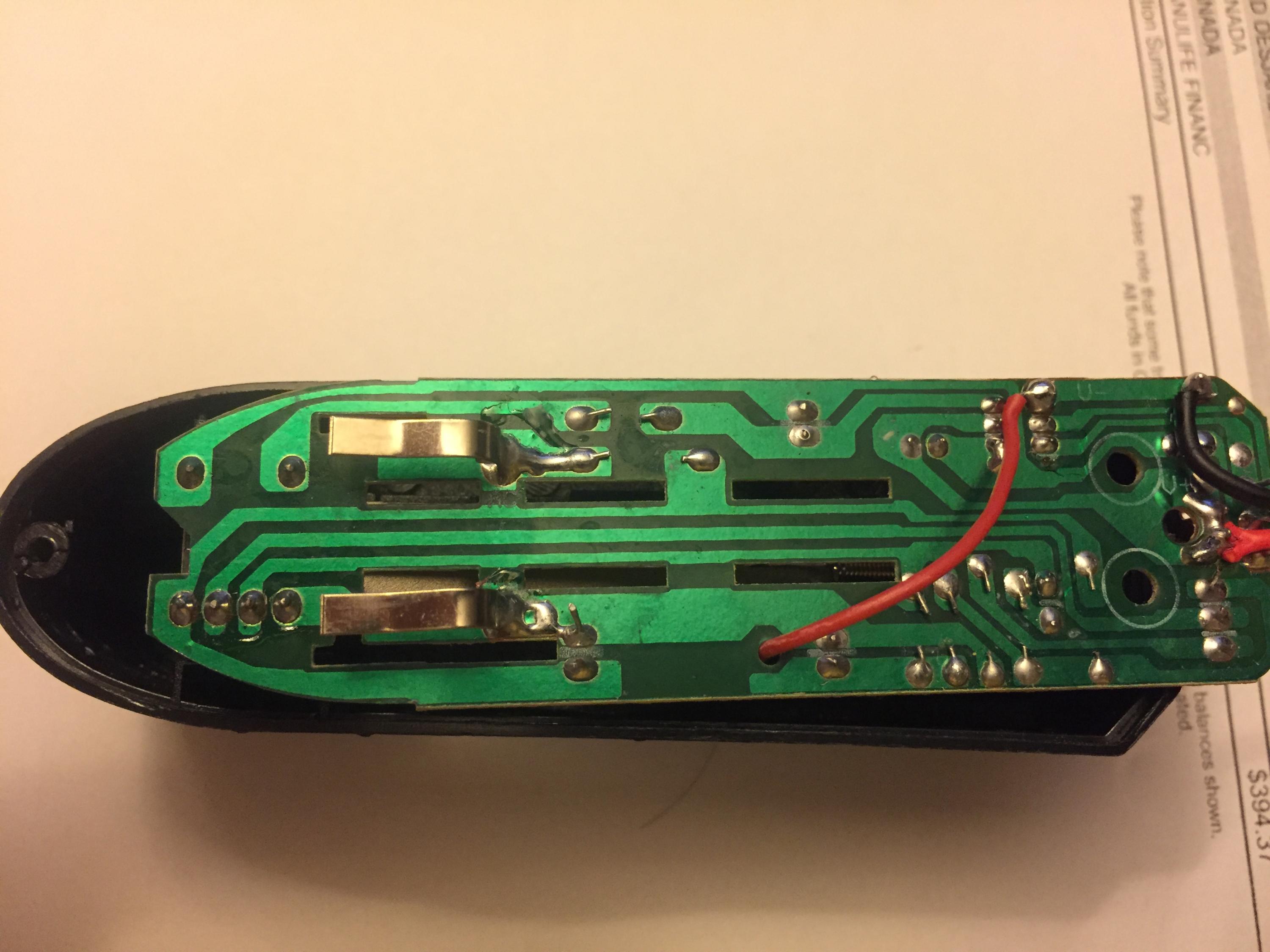

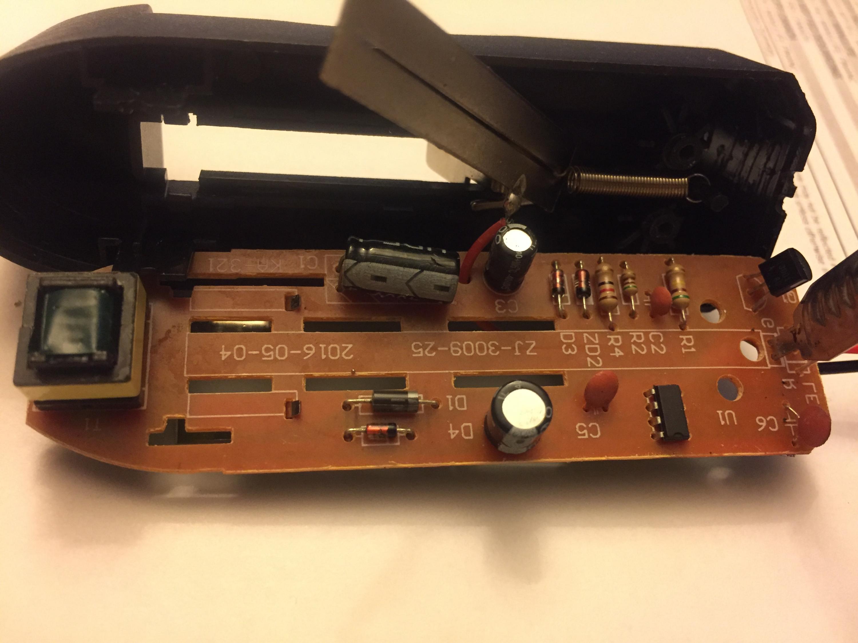

            I can trace that D3 is connected to the positive battery terminal.
            I want to lower the stop charging voltage to 4.1V.
            Attached please find 2 more photos on the circuit board for your reference.

              Ok
              now you have to get the part number off of the diode and put a second one in series
              But depending on what type of diode it is it might need more than one
              The easiest way is to unsolder it from the board but make sure you know which end has the band end

                  I'd say forget about changing the voltage. I think that zener will not affect the voltage at all, and the charger voltage reference and control is within the IC. Thus it will be quite difficult to be influenced externally unless you lie to the chip, but then you lose charge capabilities.
                  After studying my Baofeng's charger, I feel this charger is likewise a crap linear lithium ion charger...
                  ... but don't take my word for it until we find a datasheet.
                            Yes, but without knowing the circuit topology, you can't determine if this is "hard-wired" in the controller, or not. E.g., the reference in an LM317 is "inside the chip" yet you can make a '317 act in all sorts of "adjustable" ways!
                            Of course, given that it's a ONE LAYER board, the OP could have taken the initiative to trace the foils and hacked together a crude schematic (even if he doesn't know what the components are and just draws each as a "two terminal box"). From that, it would be relatively easy to determine how much of the control is provided by "component selection" vs. hard-wired.
                            It depends on how you "lie". E.g., putting a PN junction in series with the battery offsets the cell voltage without interfering with charging. But, you really only get a couple of possible "offsets" with that approach. (a more "active" solution could get you a greater adjustment range)
                            Again, a crude schematic would tell you a lot...

                                Re: Charger circuit questions
                                Look here for info about your charger using PCB ZJ-3009-25
                                https://raspiblog.noblogs.org/post/2...ttery-charger/
                                IC: HT3582DM (HX-3H1227)
                                https://www.alldatasheet.com/view.jsp?Searchword=HT3582
                                The datasheet of the HOTCHIP HT3582DM is on Chinese and I have to use a Chinese to English Translator.
                                Here are some useful information from the datasheet:
                                - The HT3582DM is an internal reference voltage control chip universal charger with automatic battery polarity, short circuit protection, over temperature protection (of the chip).
                                -- Maximum charge current is 300~350 mA
                                -- Support for 0V rechargeable battery
                                -- Normal mode for three lights' and two lights mode or colorful lights mode.
                                -- No Load Voltage Minimum 4.15V, Typical 4.23V and Maximum is 4.30V
                                -- Saturation Voltage, Minimum 4.17V, Typical 4.25V and Max 4.32V
                                Pin 1 is the Battery Negative
                                Pin 2 is the Light 3
                                Pin 3 is the Light 2
                                Pin 4 is the Light 1
                                Pin 5 is the SW pin, function selection
                                Pin 6 is the GND
                                Pin 7 is the Battery Positive
                                Pin 8 is the Vdd (5~8 +Vin)

                                    If it's something like the Baofeng charger, it's like green when idle, red when charging. Probably will light or blink if over temperature or shorted. It's all chinese to me, no clue...
                                    But I think this pretty much proves it, it will be very hard to change the voltage of this chip. Any takers? I would almost bet no takers here, even with the reference design circuit shown in that data sheet.
                                    IMHO the only way to change the voltage is replace the chip, pretty much... If someone forced me to modify the design to lower the voltage, I would require minimally one or two MOSFETs, few op amps maybe, another zener, and resistors to make an external reference to fake the voltage to the chip.
