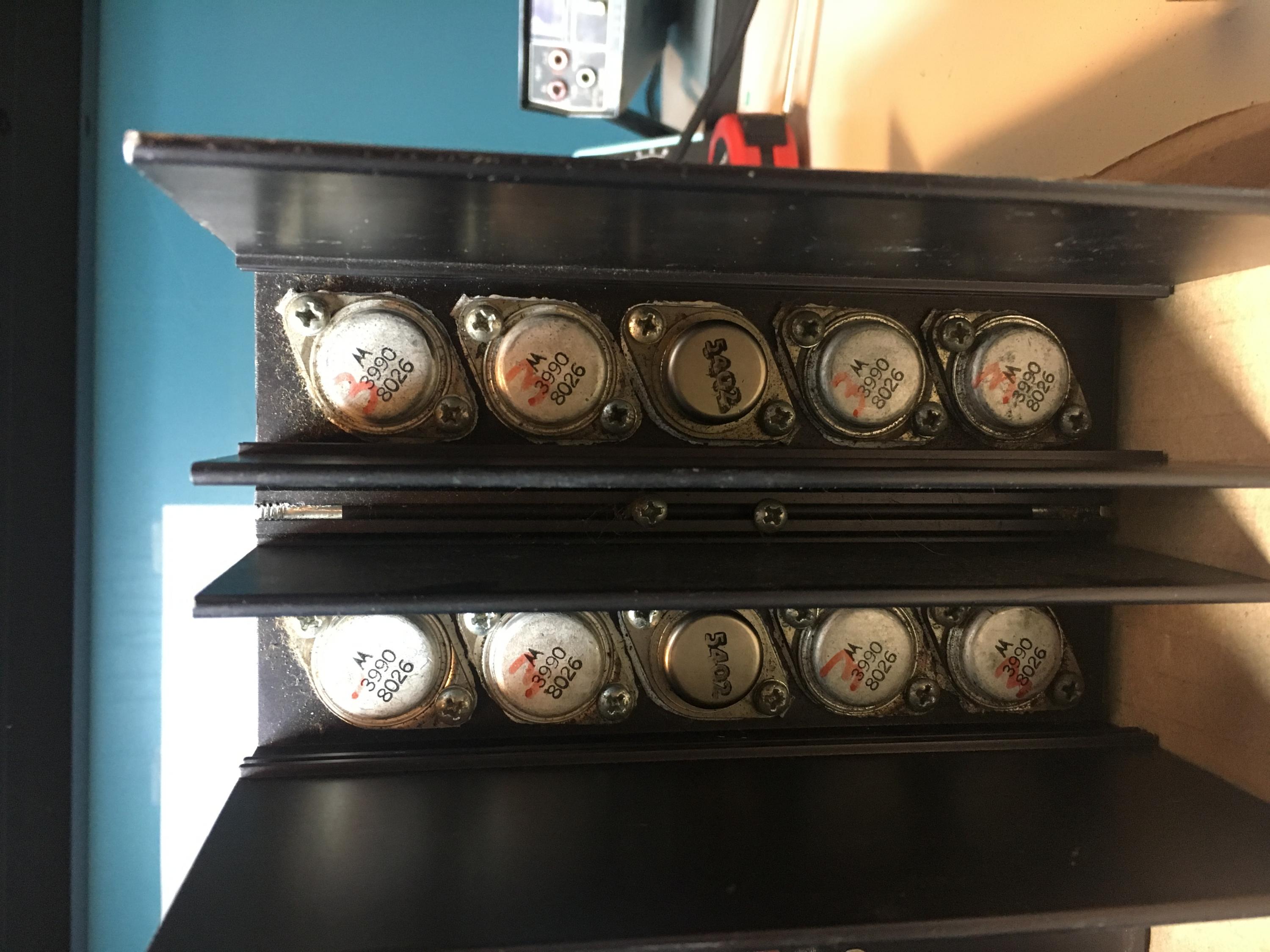

    continuing to do checks on transistors that have been remove. There are ones that appear to check "well" with the transistor checker in terms of the output data shown BUT when measured with resistance to the collector (case) have differences... some resistance as opposed to "infinite" which I take as some form of "leakage". i would think that means they are not good.
    However, the thing that appears to get me now is that some transistors have the plastic insulator sleeve in the screw hole areas of transistor while two out of the 5 that I have removed, have none.... seems rather weird. Looking closer at the heat sink mount area (beyond all the thermal grease), the transistors that don't sleeves have a "full insulating gasket" (ie. that full shape of the base of the transistor). Why the difference? should they all have "gaskets"?

      Re: Matching output transistors on an audio amp?
      maybe the screw insulators are broken ? they are top hat shape
        There may not be an insulating sleeve if the bolt is the used for the connection of the collector of the transistor to the pc board.
        Take some pictures so you know how to reassemble them.
        All the pictures I have seen (of a Crown DC300A) do not use the white plastic bolt insulators, If you insulate the bolt head, there is no connection for the collector to the foil. and all transistors have insulators between them and the heatsink and the bolts should all have star washers to make a good connection
          whoops 2 posts broken ...
          the screw insulators are top hat shaped or ought to be so they might be broken .
          are the heat sinks connected to ground ?
            MY eyes are not that good... :-( closer inspection shows that I need better glasses.
            Two of the 5 transistors that I pulled supposedly had no screw "insert".... BUT what it was is that the plastic "insulator gasket" (of the shape of the base of transistor) stayed stuck on the heat sink... oops :-) Looking at the transistors with the "insert"... after clenaing the silcon better, has the gasket still stuck to their base. So all transistors have this "full size gasket" insulator.
            sorry for the confusion... I need to do better inspections.

                  still more questions about output transistors. I got some mj15024 to replace crown original 2n5631.
                  My question is around c-e resistance testing. On existing transistors (most) the resistance, is infinite. On ones that appear to have "issue", the resistance is very low and some case higher (ie. in the megaohms). Testing the replacement transistors, the same way, indicates most with megaohm c-e resistance. I kind of expect them all to be infinite but is this expectation wrong. Does the c-e junction need to be infinite or is some form of high resistance OK? Checking the transistors, with a capitance / transistor checker appears to show things as "good".
                    C-E resistance rating when B is unconnected is basically its leakage. Silicon transistors should not leak and the resistance should be very high. Depending on your multimeter, most of them should show up as infinite. Germanium transistors leak more.
                    There are some transistors with built in freewheel diodes, these will show up a low resistance short if you connect the meter one way, but should be open circuit the other direction.
                    Likely it will still work even if the resistance is very high though I'd suspect some QC issues there. All of my low frequency silicon transistors show up as infinite. My germanium transistors leak and do not show up as infinite. I don't have any uncommitted silicon RF transistors to test but I suspect they may leak some.
                      thanks... makes me feel a bit better about them as "off shore sources" don't always give the most confidence. I can see what you are saying about an unconnected B having a possible "influence". The ones that I tested "in circuit" had only the C and E isolated as I would have had to demount them totally to isolate the B. The failed ones that I measured as "partially isolated in-circuit" had obvious issues with c-e near zero. However, a couple on the "distorted channel" had some "few mega ohms" resistance compared to others in the channel (same type) that all measured open / infinite resistance... that's why I was somewhat concerned about the replacements having "similar" characteristics.... albeit higher megaohm resistance but certainly not open / infinite.
