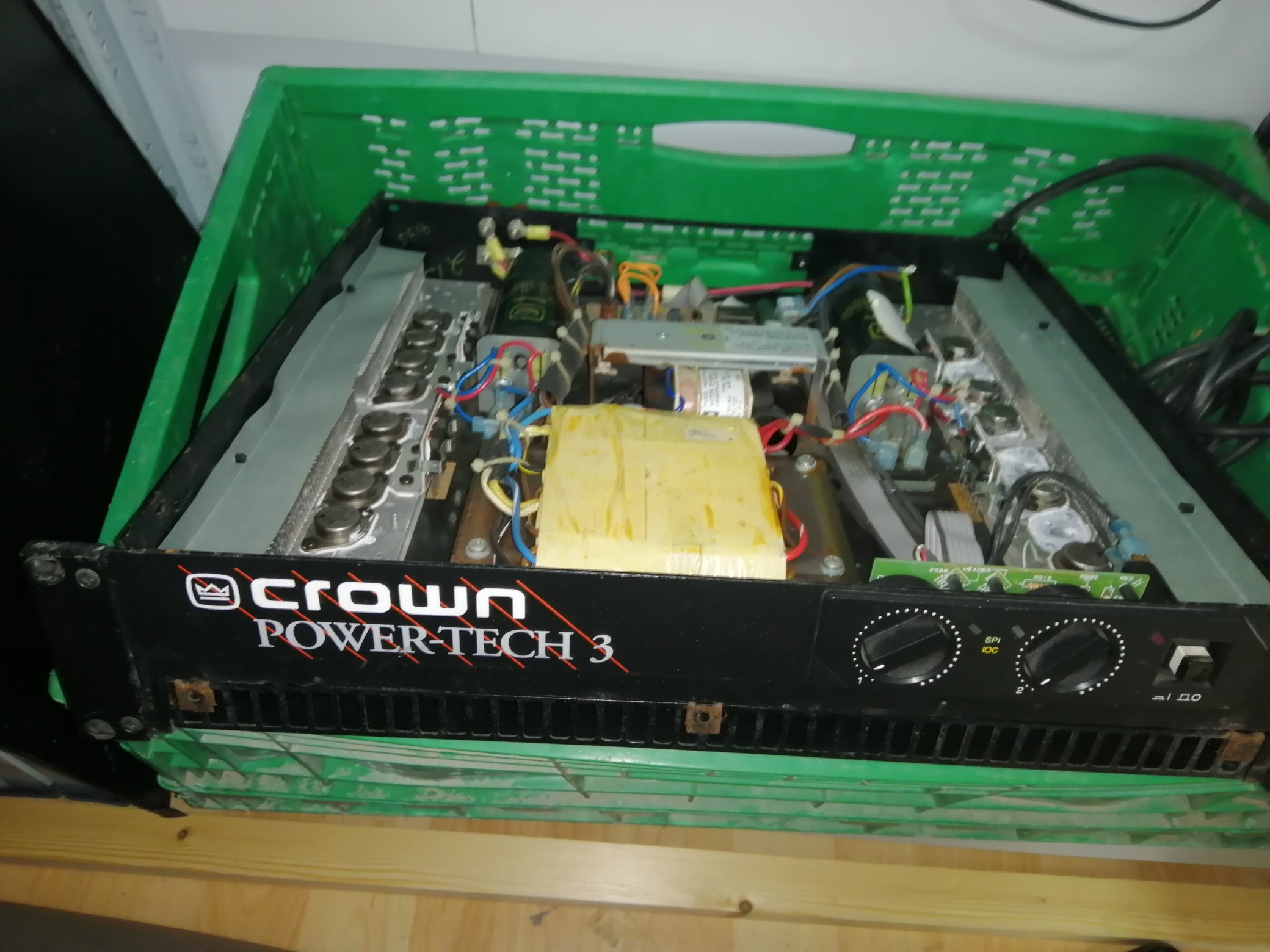

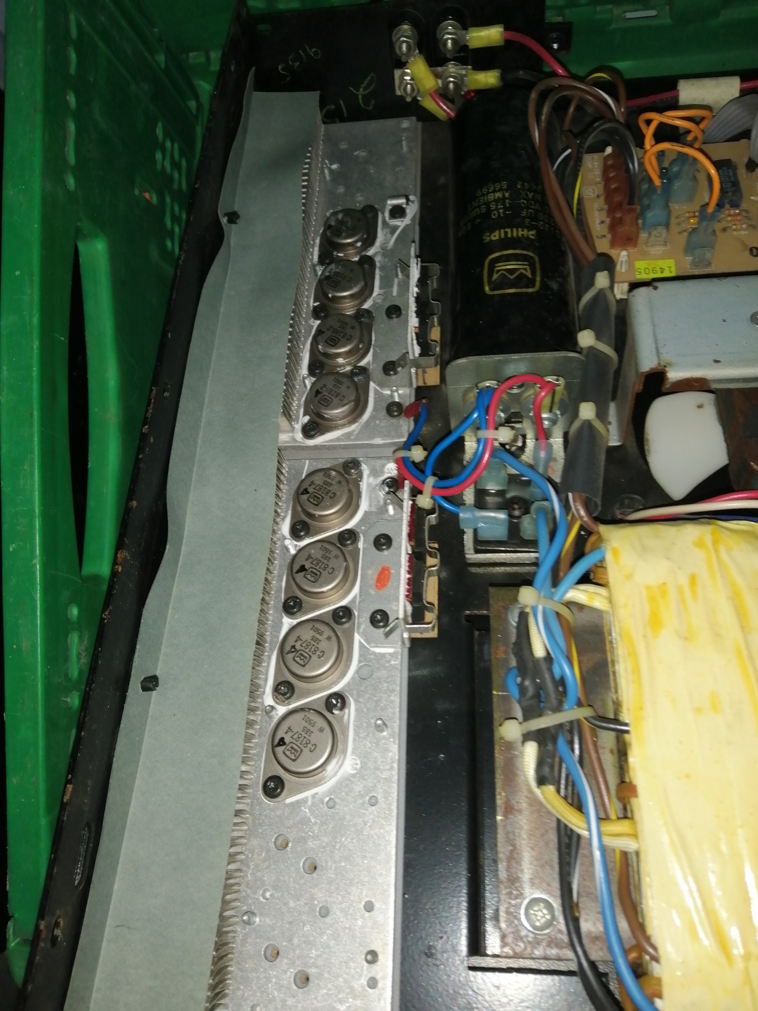

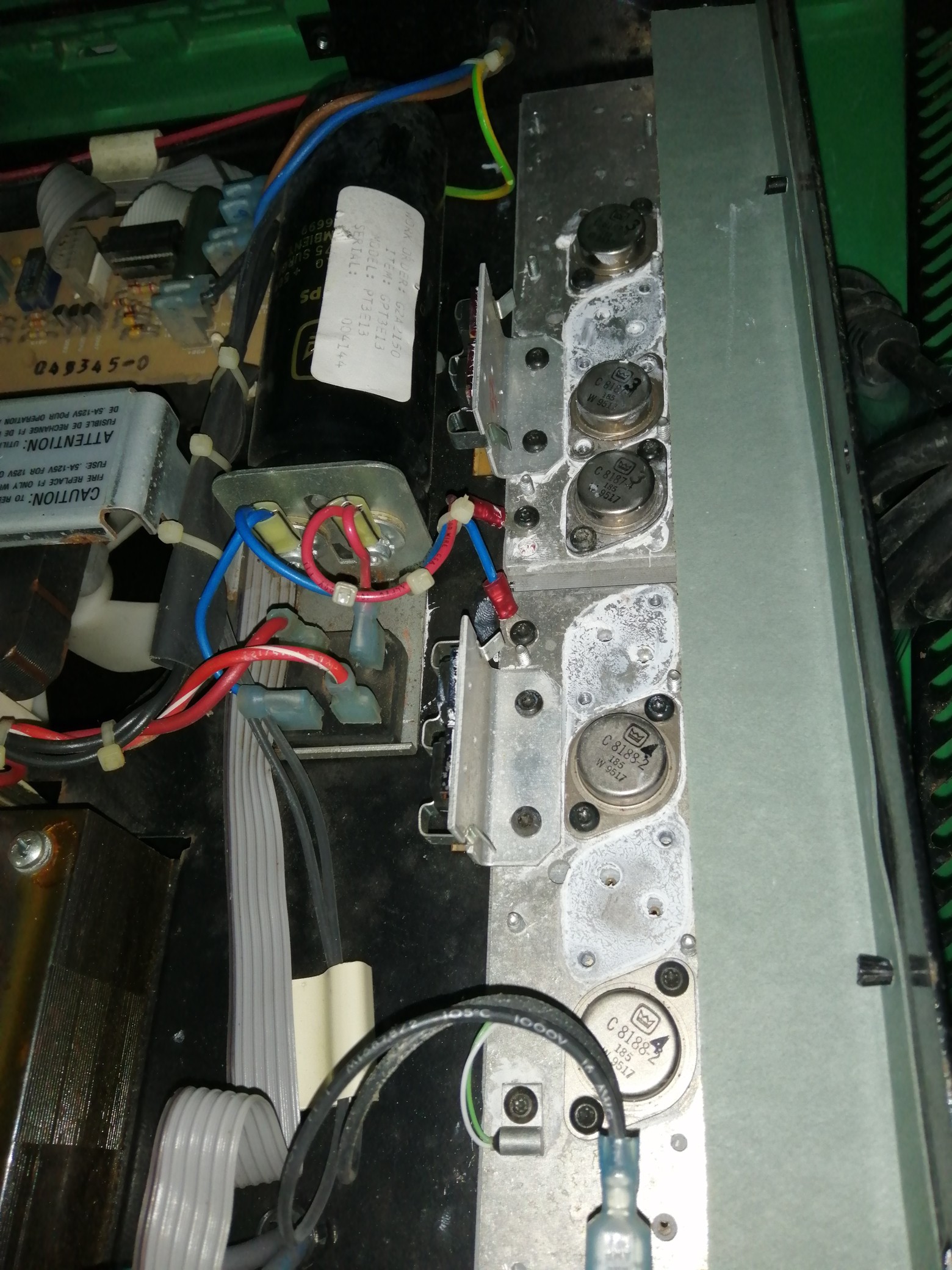

              Re: Matching output transistors on an audio amp?
              I'm also interested in this topic.
              I have a Crown Amp with Output transistors that are in groups of 4 and they are marked with a little factory stamp 1,2,3 or 4 on each device, along with the part number.
              Apparently they were selected to have the same gain in each batch and when I find the same original devices on ebay (they are obsolete) the listings say I can't just stick any transistor in, and if the 'gain' number does not match the others in the Amp they they will fail, probably with a bang knowing my luck!
              Some of them in the amp are short circuit but I've never tried to fix it as I couldn't find the same gain transistors as replacements.
              This contradicts the advice given here. Why is that?
                  Added some pics.
                  Output devices C8188-2 and C8187-4, with batch numbers stamped on them
                  Crown Power-tech 3 amplifier
                  Why did they go to the effort of doing that?
