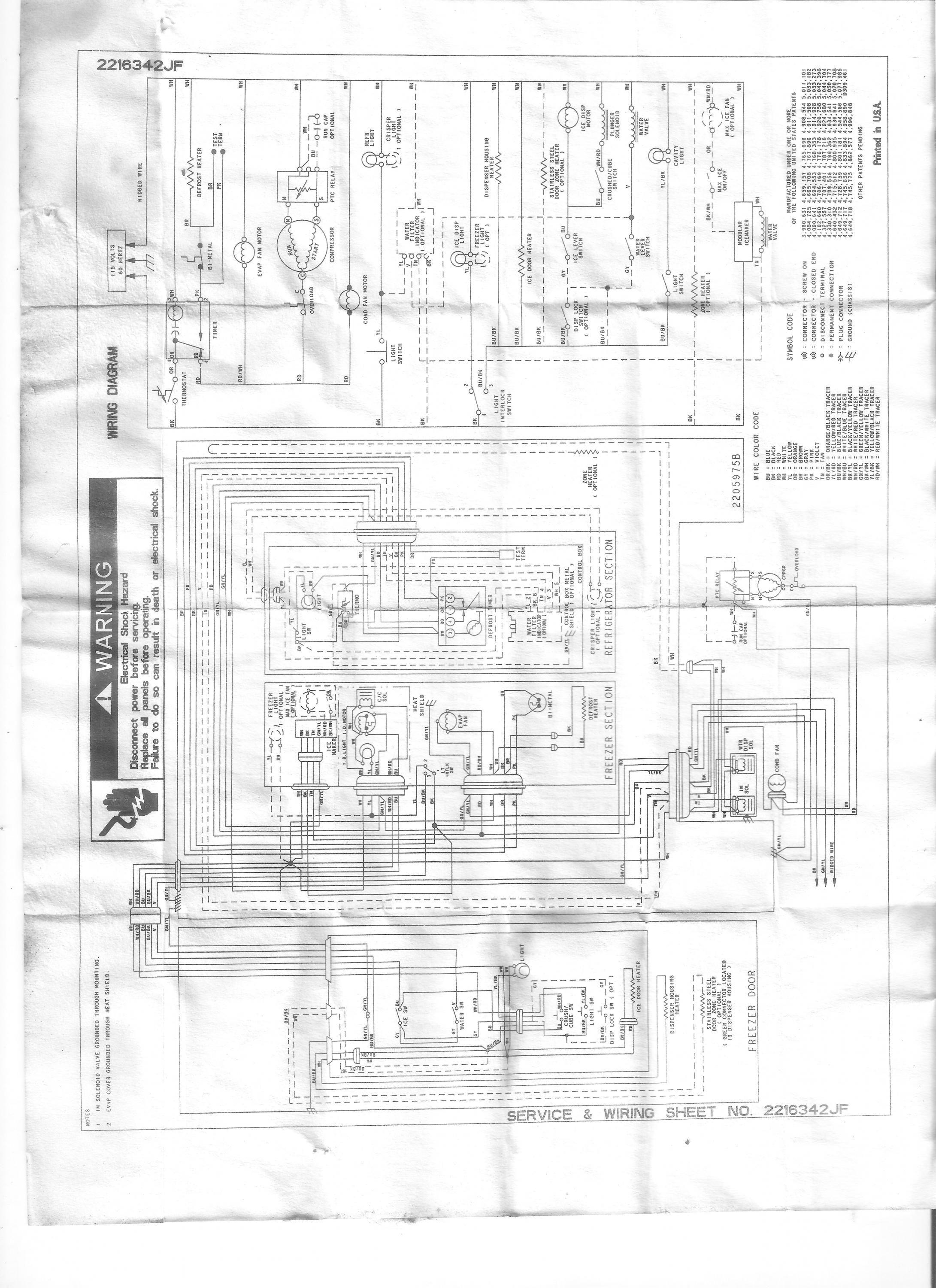

    Scenario is this:
    Refrigerator.
    Low water pressure.
    Ice cube maker will not fill the cups entirely, so it makes hollow cubes.
    It takes 1 full minute to fill a 1/2 liter glass through the water dispenser.
    Refrigerator is OK, problem is the pressure on the pipes.
    So I want to add a 12VDC pump which I already have and have tested and works beautifully.
    The fridge has two coils, one for the water dispenser, one for the ice maker.
    I want the pump to start when either coil activates.
    I'm planning to add one 12V power supply in parallel with each 110V coil, with their outputs also in parallel, connected to the pump.
    I know this will likely work, but is it possible to drive this with a single power supply and few components instead? Any lights on this would be awesome

    Re: Need an idea to connect a pump
    try a pressure vessel first . all it needs is pumping up .
      Are you sure- it's such low pressure 500mL/min is pretty poor.
      Or is the piping/line blocked or kinked?
        the filter is probably gunked up.
          Easy enough to check -- disconnect the flex line to the refrigerator (AT the supply, not at the refrigerator) and see how long it takes to fill that half liter bottle.
          The line TO the refrigerator is likely a very small I.D. and easily clogged -- as is the line INSIDE the refrigerator. A blast of air can help, there (back flushed).
            The "coils" are the actuator solenoids for the water valves -- one to the dispenser and the other to the tray filler?
            What "switches" power to these coils? I.e., can you, instead, take those signals? Or, are they just mechanical switches? (e.g., our ice maker is just driven from a clockwork timer)
            Less than ideal as it adds the power supply (including any inrush current) as a load to be carried by "whatever" is switching power to those solenoid coils.
            You could select two small relays, each with 110V coils, and drive each of them in parallel with a corresponding coil in the refrigerator. (Take care to consider the switching capabilities of whatever is driving those coils). Then, run mains power to the contacts (form A) of the relays so that either of them can call for power for the power supply.
            Or, find a 110V pump and skip the power supply, entirely.
              Thanks guys.
              In the wall there's a 1/2 inch pipe, which takes about 5 seconds to fill up a 1/2 liter glass. The fridge doesn't have any problems or clogs on the pipes or hoses. The filter is brand new, installed at the time of first post. It's just the pressure on the building that is poor, and that, added to the reduction of the hoses inside the fridge to 1/4, reduces the pressure even more.
              Yeah, the mechanical switch you push with the glass to get water from the dispenser activates one solenoid, and the ice maker activates the other using a timer, for 6-8 seconds, every about 20~30 minutes until the ice container is full.
              Less than ideal, that for sure. But the power supplies output 12V 2A, so that won't hurt anything I guess even if I wire them directly to the coil's lugs. Plus it will be very unlikely for them to run at the same time.
              I'm attaching the schematic of the fridge, which I found folded and hidden in the lower front bezel and scanned it right away. +1 Whirlpool for this!
                If I were doing this —> this is how I would do this
                I would put a fan relay ( 4 pole relay) switch where the water valve is just make sure that it is has a 120 volt relay coil in place of the water valve the way it is hook now two pole are for your water valve the other two are for your pump
                Just make sure that the water valve and pump are powered separately from the power that use to be the for the water valve
                Also make sure that your pump has a pressure switch that works otherwise your pump will not last very long
                I understand this problem that you are having my wife is from Trinidad ( and yes I visit the country many times in last 25 years ) and most of the time there water pressure is very low or hardly any water at all—> and ice maker can not cope with very low water pressure
                Do you have a 50 / 100 or bigger gallon tank how far off the ground is it
                How often do you go with very low water pressure or no water at all and for how long
                  I am not sure how to connect your idea, @sam_sam_sam.
                  How would your scheme work to activate the 4-pole relay when either solenoid activates?
                  The pump doesn't have a pressure switch. It would simply stop when the solenoids doesn't receive any power so no worries about over-pressuring, I believe.
                          I will try to draw one either later today or tomorrow when I get some time to do it
