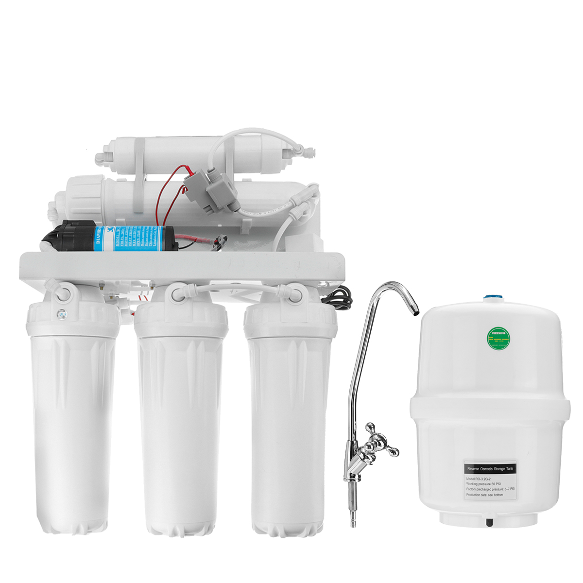

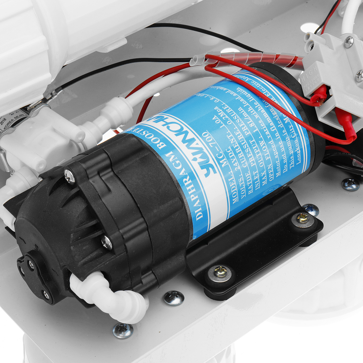

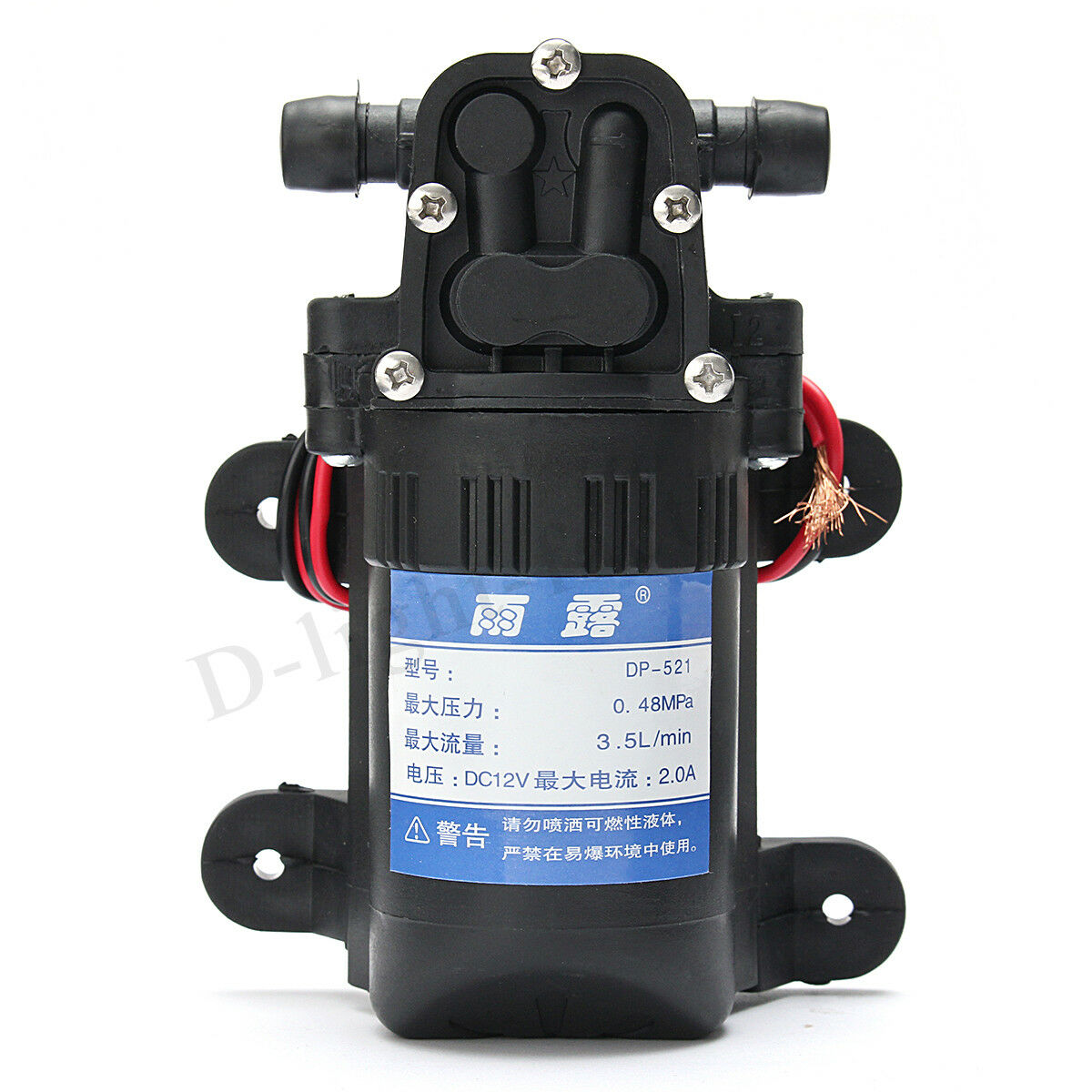

            Thanks for the thoughts, guys!
            I haven't assembled it entirely yet because I need to get some time to open Blender and draw a case for 3D printing for the two 12V2A power supplies to add to the fridge along with the pump.
            The pressure on the house is about right, it is enough for everything and stable. Only problem is the fridge.
            If I disconnect the filter output from the fridge and put it into a bucket and open the valve, I can get 1/2 liter in like 6-8 seconds. I added the pump temporarily (right before the water filter) just to check if it would work and lo and behold, it takes only 10 seconds to fill a full 1/2 liter glass from the water dispenser in the fridge. I don't really need more than that!!
            Now @Curious.George : You got me thinking with the one you mentioned about lead and chinese plastics etc!
            I attached 3 pictures, the first two are of a reverse osmosis filter that has one pump pretty much like mine (3rd picture).
            So I guess it should be all right to drink the water from this, right??

                your pump looks similar to a pump i use .. its a shurflo . very good it is .only problem i have had is the micro-switch corroding but thats my fault letting it get damp
                seem to remember to set the pressure vessel pressure about 2psi less than pump cut off pressure
                  You can't visually tell whether a device will leech lead (or other toxins) into the water passing through it. Nor can you tell by the part number, country of origin or any other detail visible to the end consumer.
                  Two ball valves:
                  https://www.desco.ca/en/products/pip...potable-water/
                  https://www.amazon.com/Apollo-77CLF-.../dp/B006G1RWP8
                  If they were mislabeled, do you think you could figure out which was which?
                  You have to rely on the supply chain's integrity/honesty in portraying TRULY "suitable for potable water" products as such. Ever bought a "Rolex" watch for "a great price" (cuz it isn't a real Rolex! WTF? "That's illegal!!" :> )
