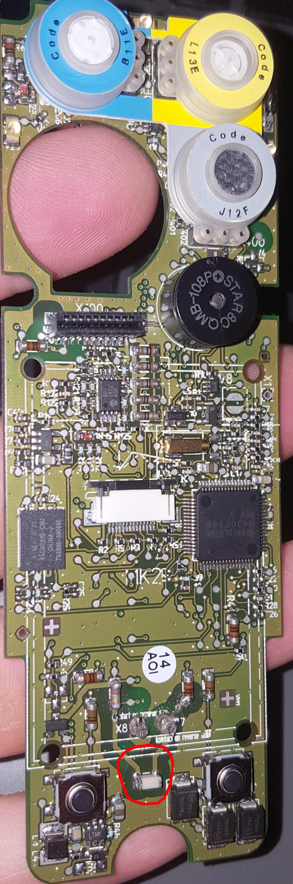

    Can anyone identify the yellow component S1. It has two legs, one of which is connected to the component's body and has no writings on it.
    When the board is shaken, something in the component rattles.
    The board is RTI t2-c smart remote control ( I could not find a service manual ).

    Re: Help identify component
    Tilt ball switch.
    https://www.adafruit.com/product/173...BoC4UAQAvD_BwE

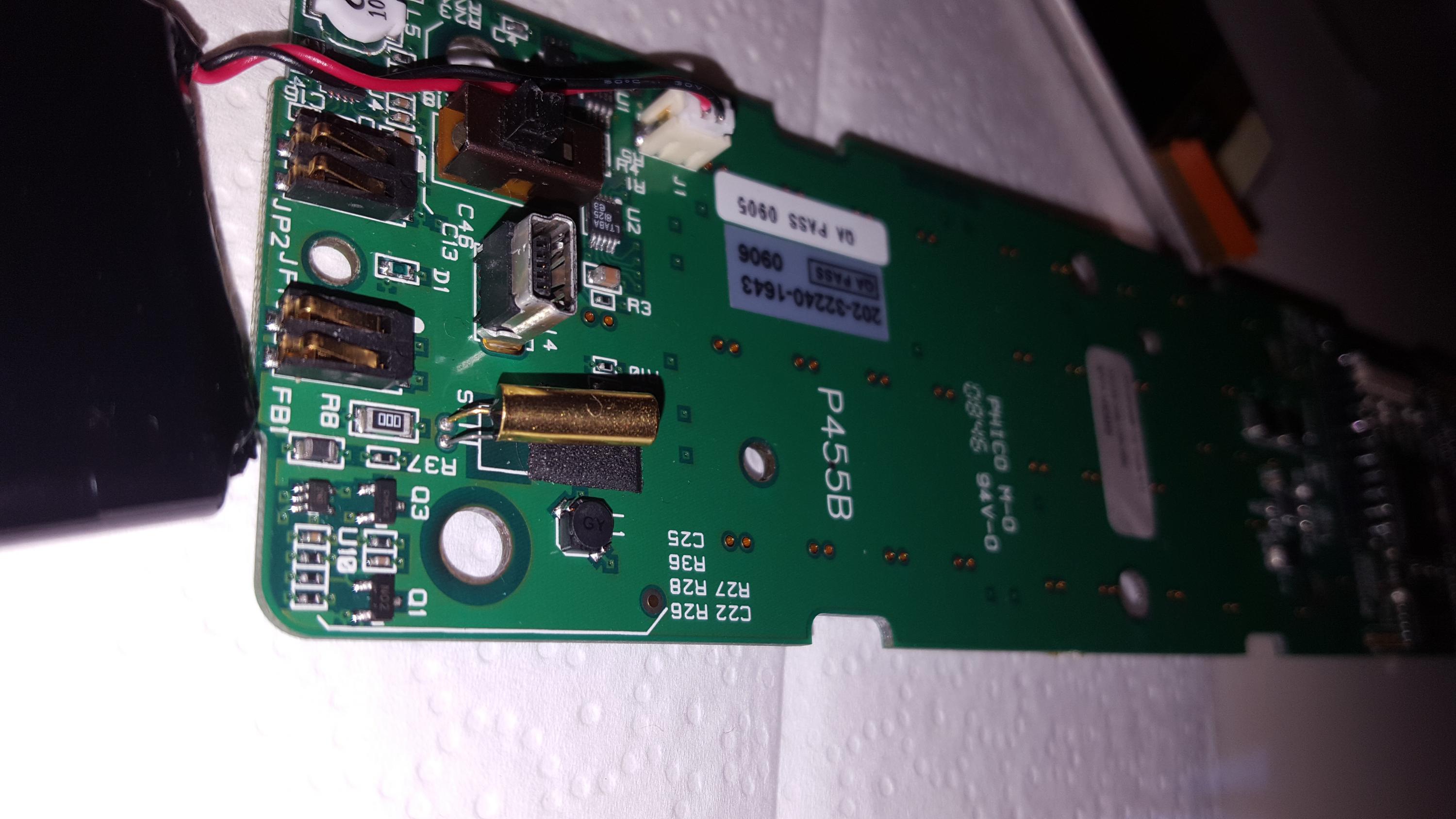

          Here is another one - the thingy in the red circle.
          It measures ~7700 ohms resistance.
          It is on the main battery voltage rail and when shunted, the device starts fine.
          Don't mind the lousy solder job above the thingy.. it was just for testing purposes and already has been fixed.
          p.s. the thingy was measured out of the circuit.
            It is likely a fuse, any letters on the ends (ie: bel) or maybe a number under it. digikey etc. carry them
              Originally posted by R_J
              It looks like it could be a fuse
              That was my first thought... but don't the fuses fail by breaking the internal connection?
              This one still has some resistance.. that's why I'm confused.
              For now I have installed a 0 ohm smd resistor and the device works works fine ( kinda... looks like it needs a professional calibration or/and new sensors ). I do not see any excessive current drain or hot components.
              edit: no markings at all - not on the component, not on the board.
                It depends on what the fuse element is made from, since there is no short on the board, it might just be fuse fatigue, the fuse element over time got weak and finally opened, but there is still a small amount of resistance 7.7k
                  • 31140
                  not a fuse, not one i'v ever seen.
                  it may be a ptc or polyfuse of some type.

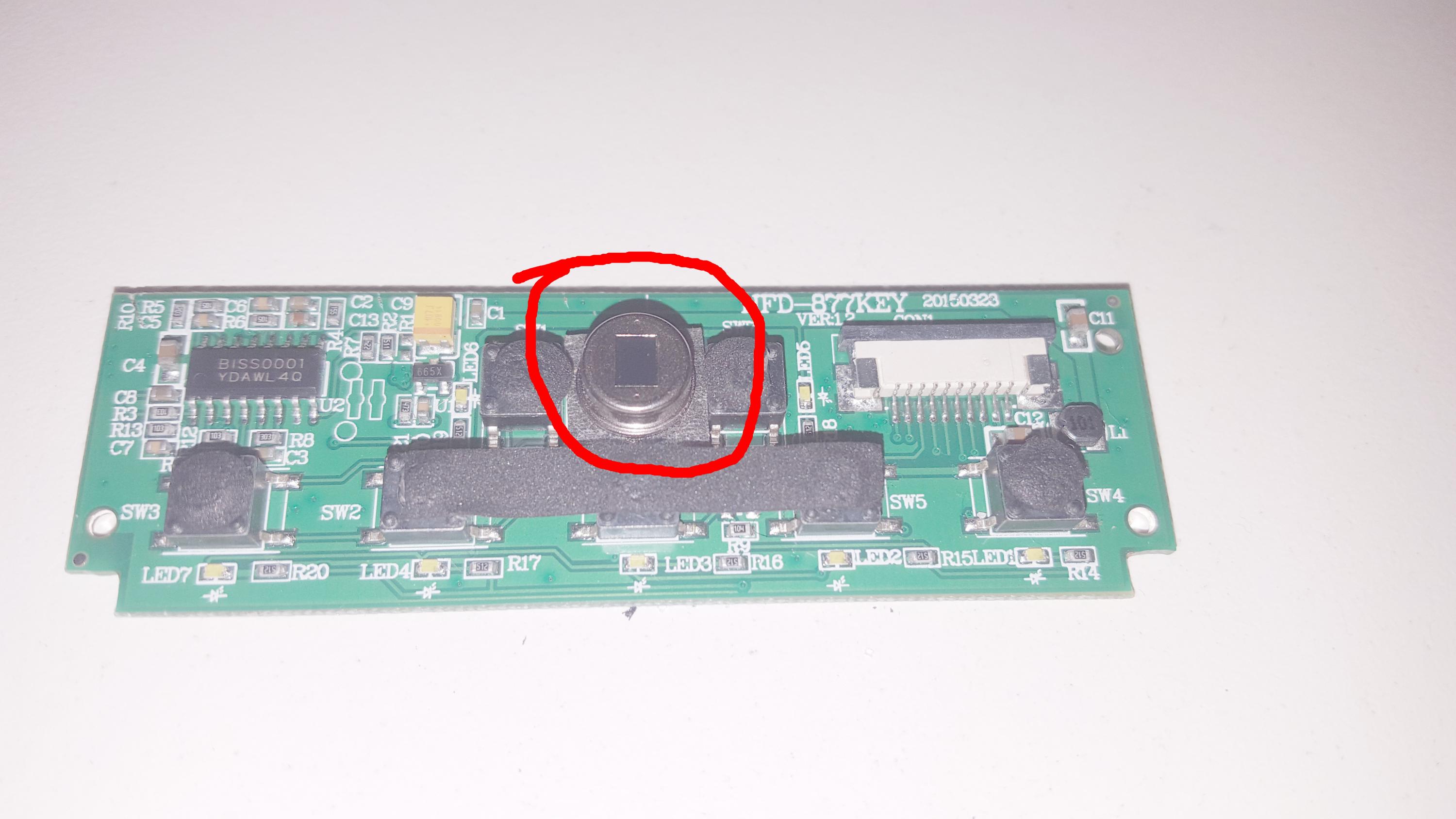

                    Can anyone tell me something about the Q1 component?
                    It looks like a transistor, but what the bleep is that black part on its top?
                    P.S. I do not need any part number or something.. just some basic info about the part
                        Originally posted by budm
                        Q1? Where?
                        next to q3

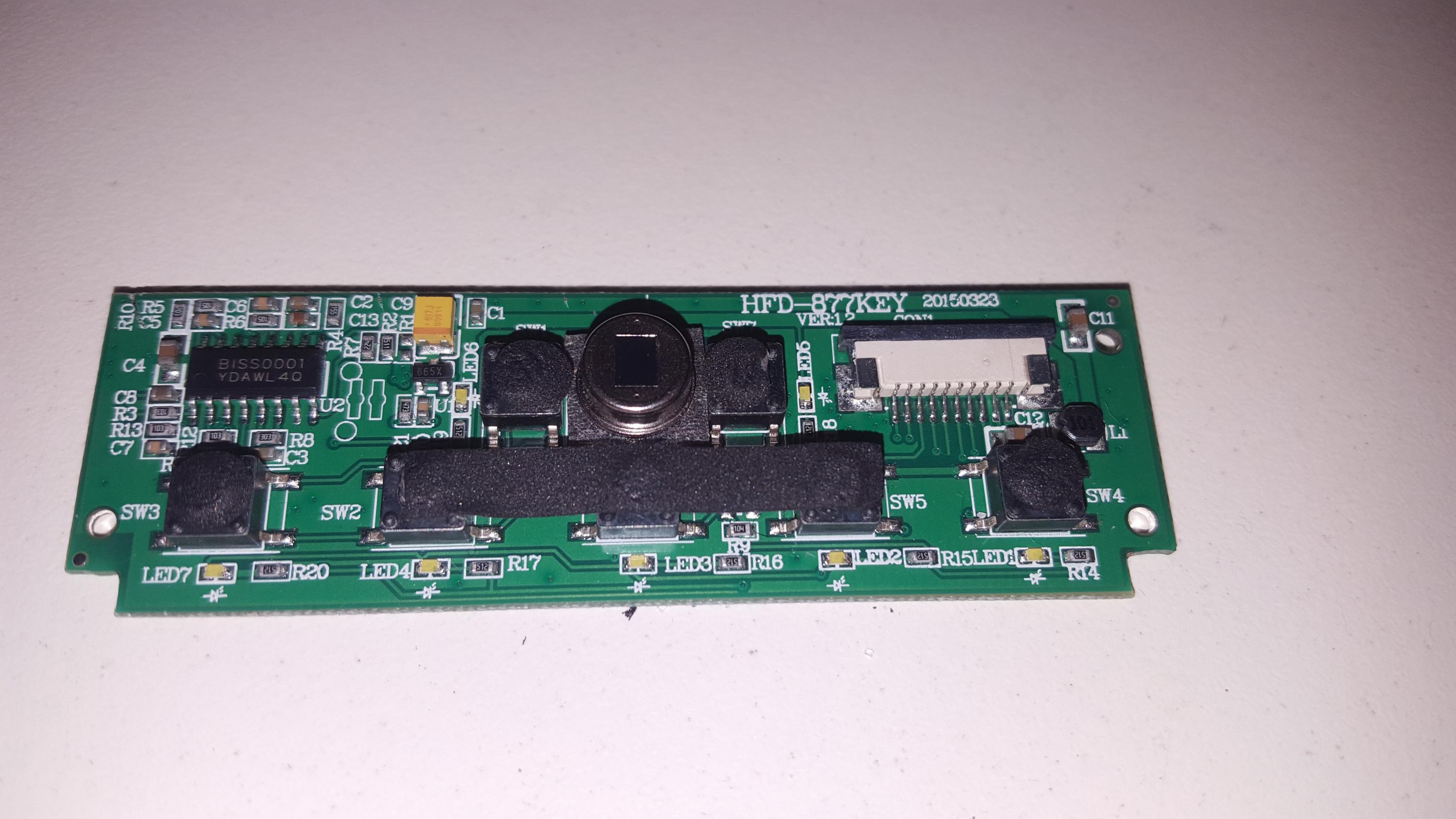

                          Q1? Where?
                          Good question... really forgot to check the images I uploaded
                          Here is the same image but brightened and with circled Q1 ( my office monitor has crappy brightness, thus I'm not sure how "visible" are the images ).
                            • 31140
                            looks like a pyroelectric sensor.
                            same thing you find in a PIR switch.
                            the real question is what the hell is it doing in a button assembly?
                            • madan1
                              • Nov 2016
                              • 698
                              • Bulgaria
                              I believe you are totally correct!
                              If I remember correctly, the board came out from a scrapped bluetooth speaker ( "sharkk true wireless speaker" ) and I have absolutely no idea what a PIR sensor has to do with such an item... I guess it's time for a tin-foil hat...
                                  It's a PIR motion sensor, IC is BISS0001. Shark: "Thermal heat sensor automatically activates frosted LED backlighting for the buttons on the speaker"
