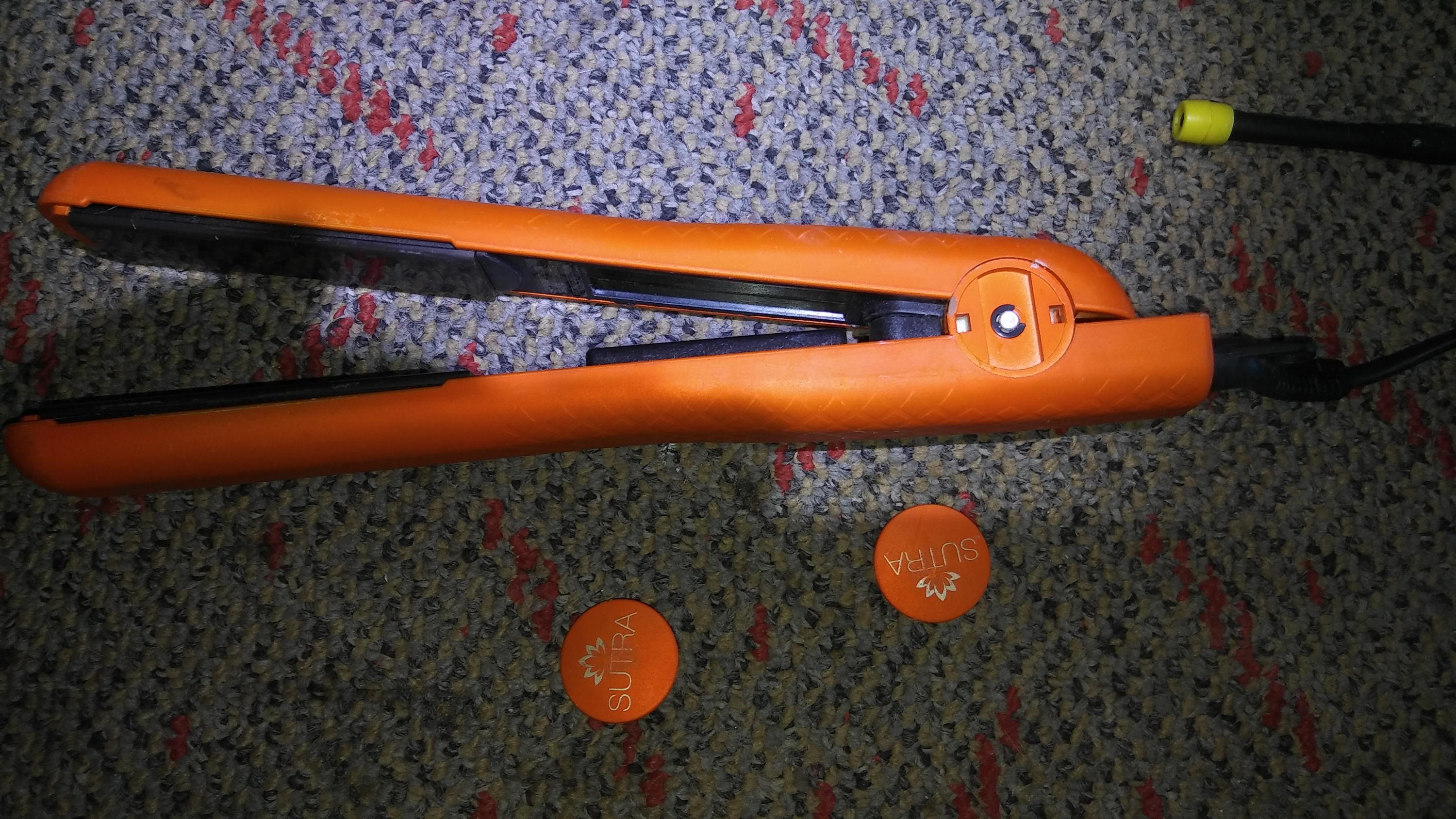

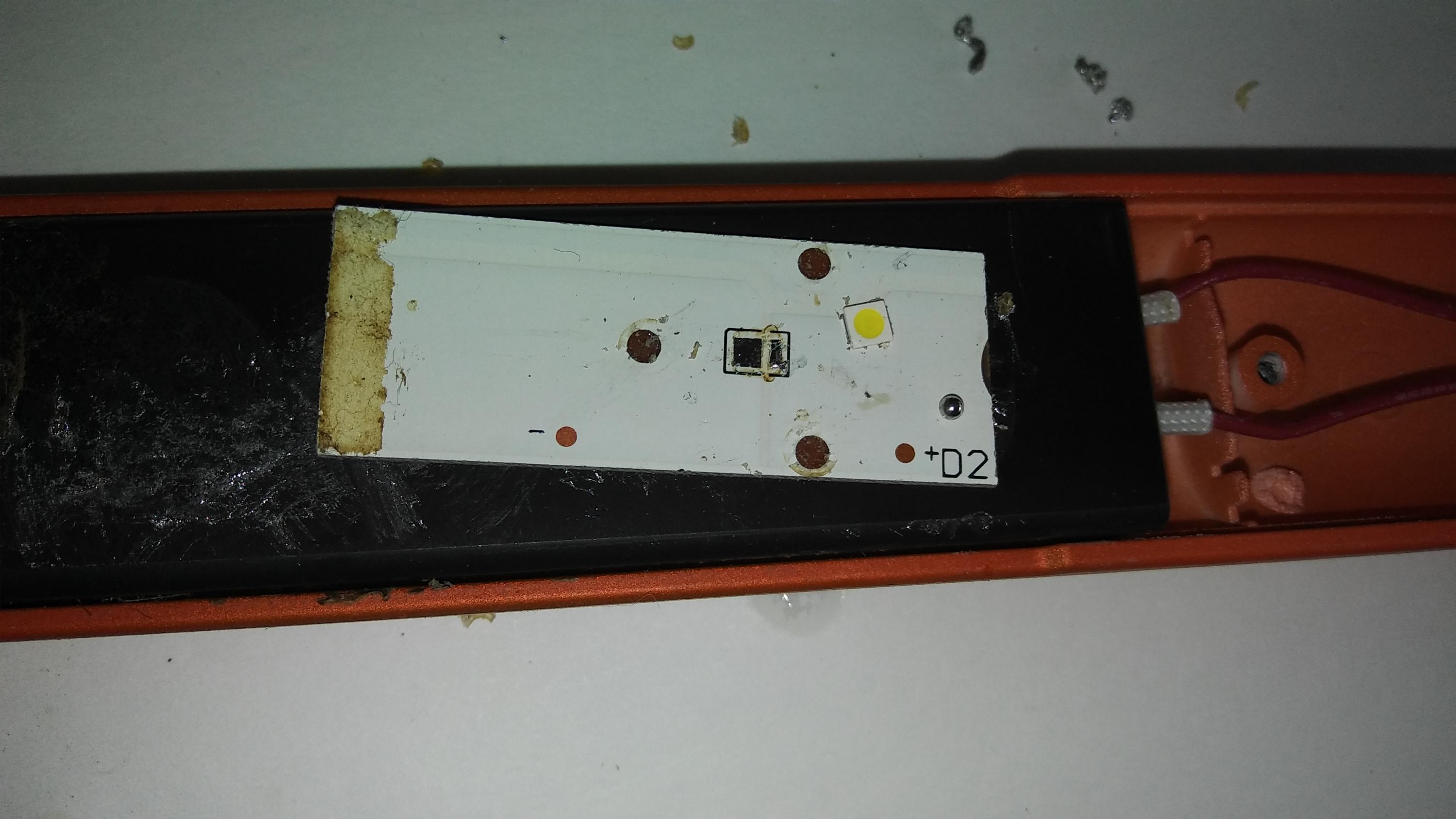

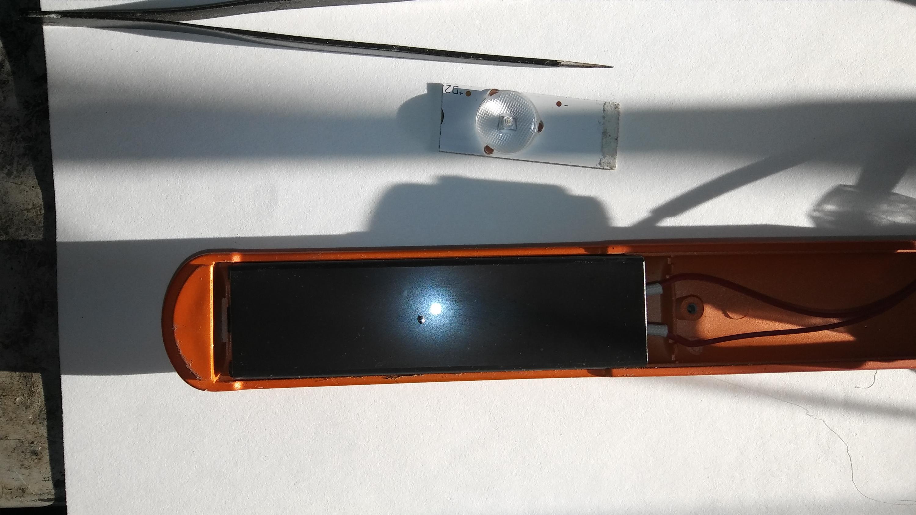

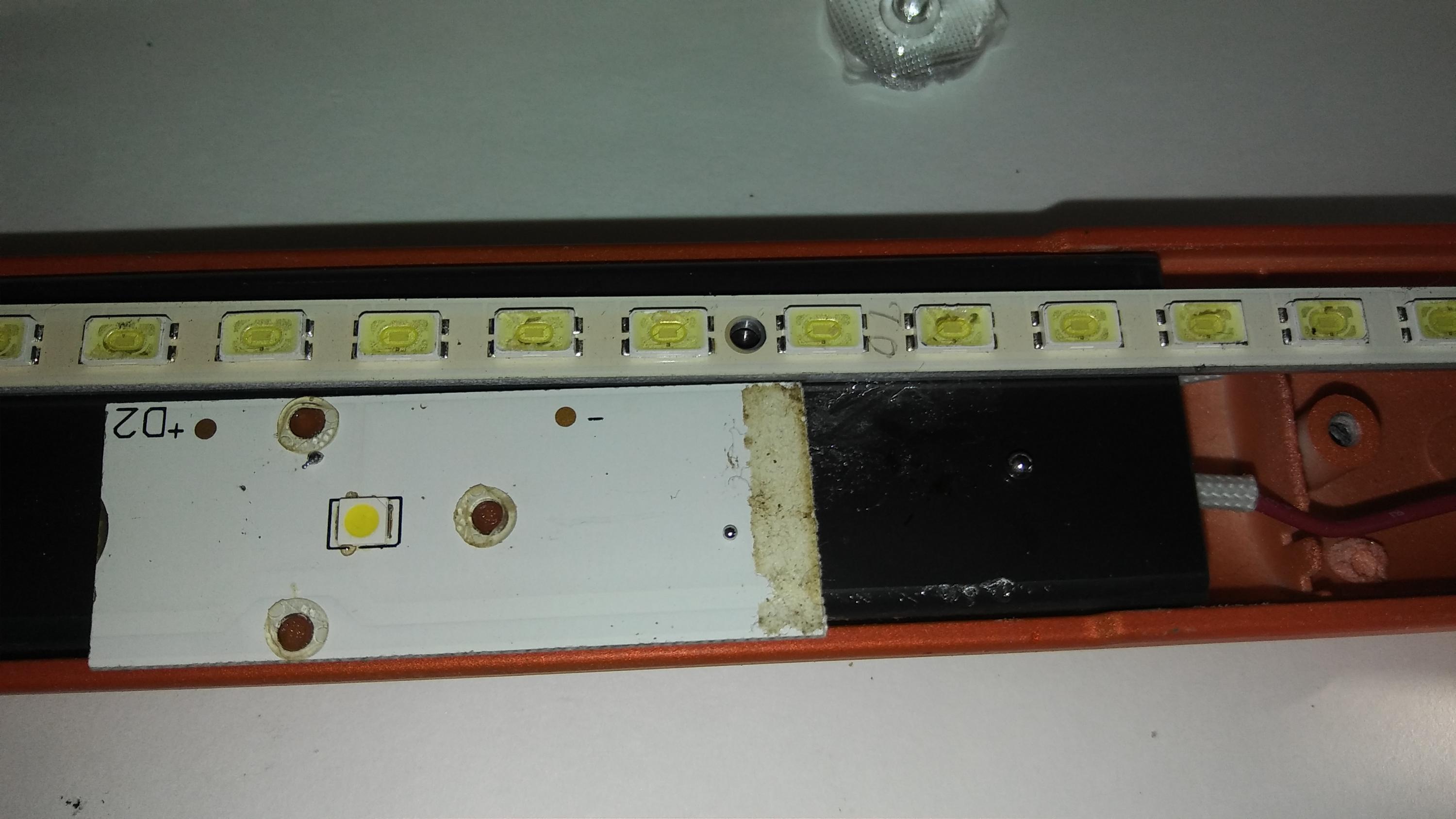

    Adjustable temperature, 140F-450F, hair straightener can it be a LED desoldering hotplate?
    I found this hair straightener can turn up to 450F, can it be use for LED strips desoldering hotplate? more Green than clothes iron, smaller and more convenient and looks better.

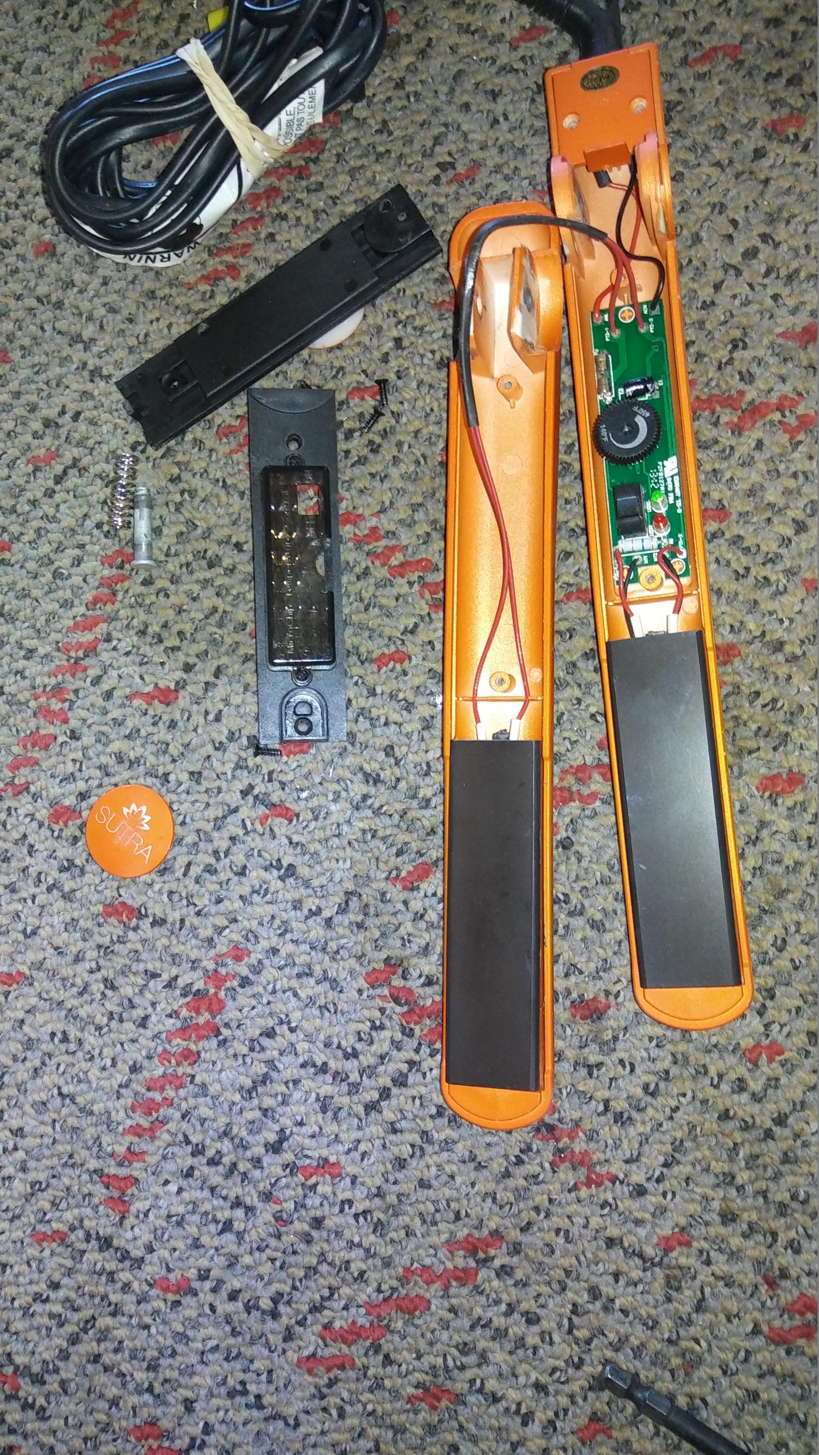

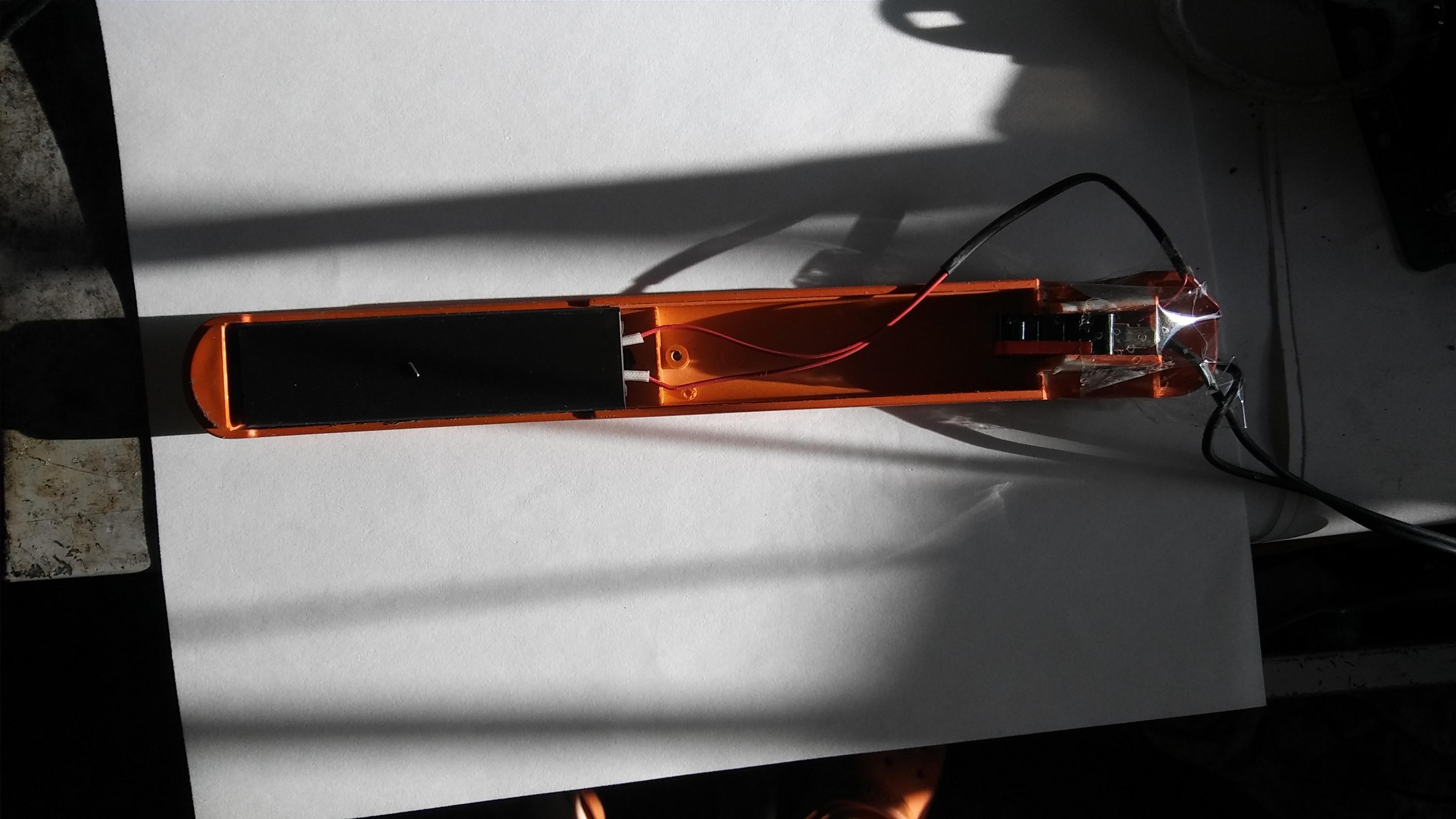

    I tried it and it could melt down the solder (picture 5), but it couldn't thermal separated the LED on the strip.
    Does anyone know how can I increase the hair straightener temperature?

    As you know about the LED strip construction, most of them just use double-side PCB (Copper on top and copper on the bottom with fiberglass sandwiched between), to heat transfer between to the top and bottom is very poor since they cannot use Thermal Vias, that is why I have been saying for a long time about thermal management for these TV with LED backlights, The heat transfer from the top layer to the bottom layer is very bad.
    So if you check the temperature of the bottom and the top side you will see what the actual temperature of the top side of the board is compared to the bottom.

      Re: hair straightener Soldering hotplate
      What is on the other side of this board
      Please post pictures
      Also is there a part number on the heater elements
      But from the looks of the photo it has heater element
      some type of temperature sensor to some type of temperature controller ( you might be able to play around with the resistance that controls the temperature but you would need to how this device works and how it is used to know what to do with it )
      Depending on what type of temperature sensor it has would determines what type of temperature sensor you can use and use a better temperature controller

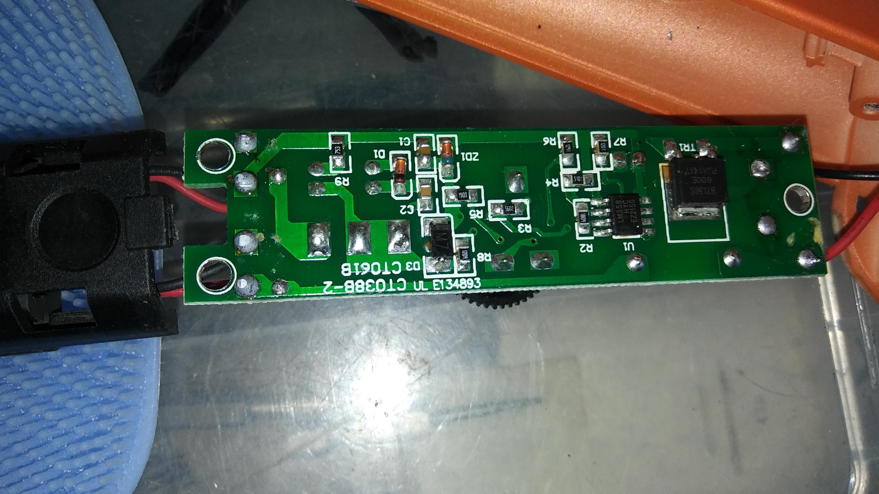

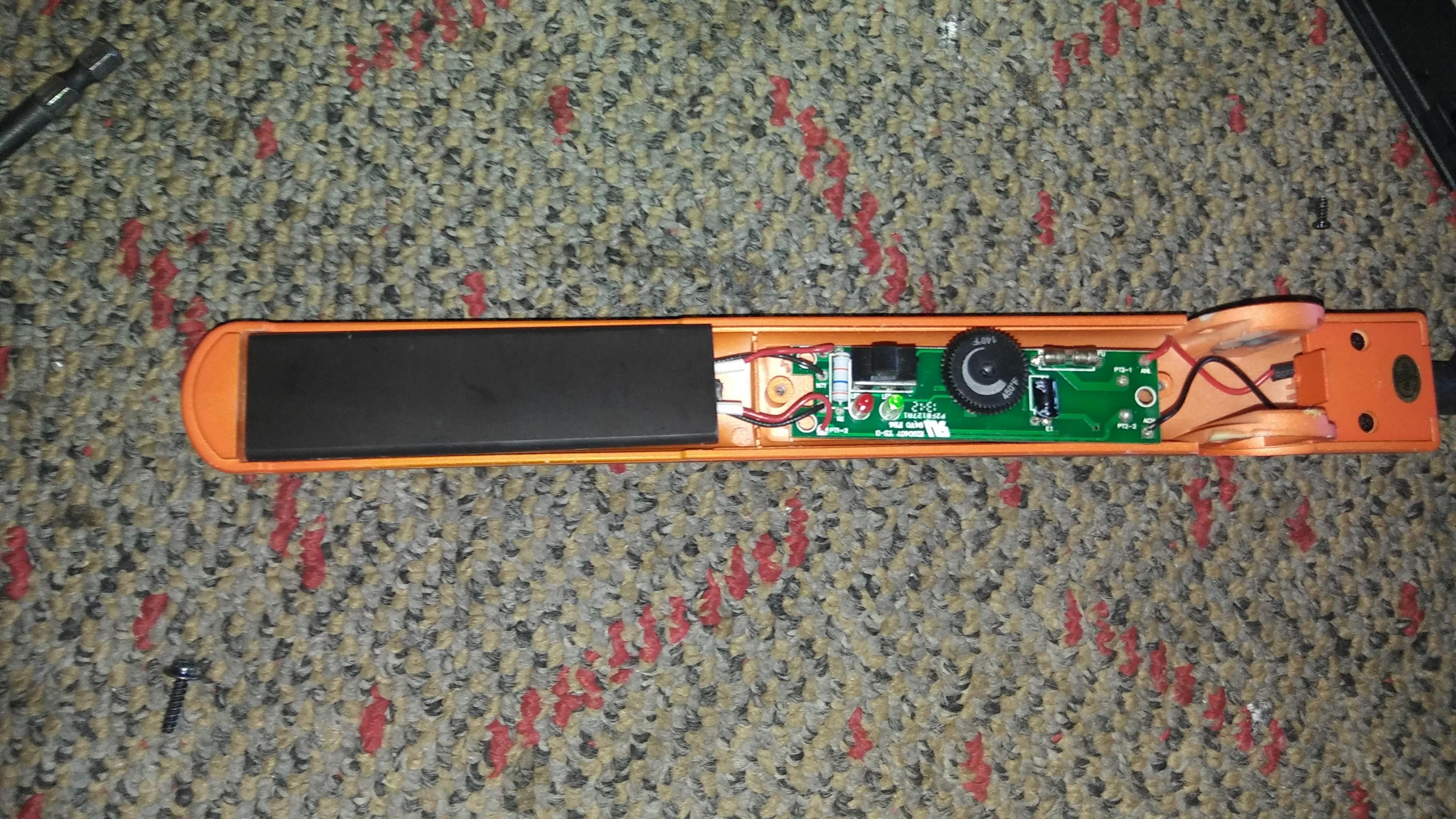

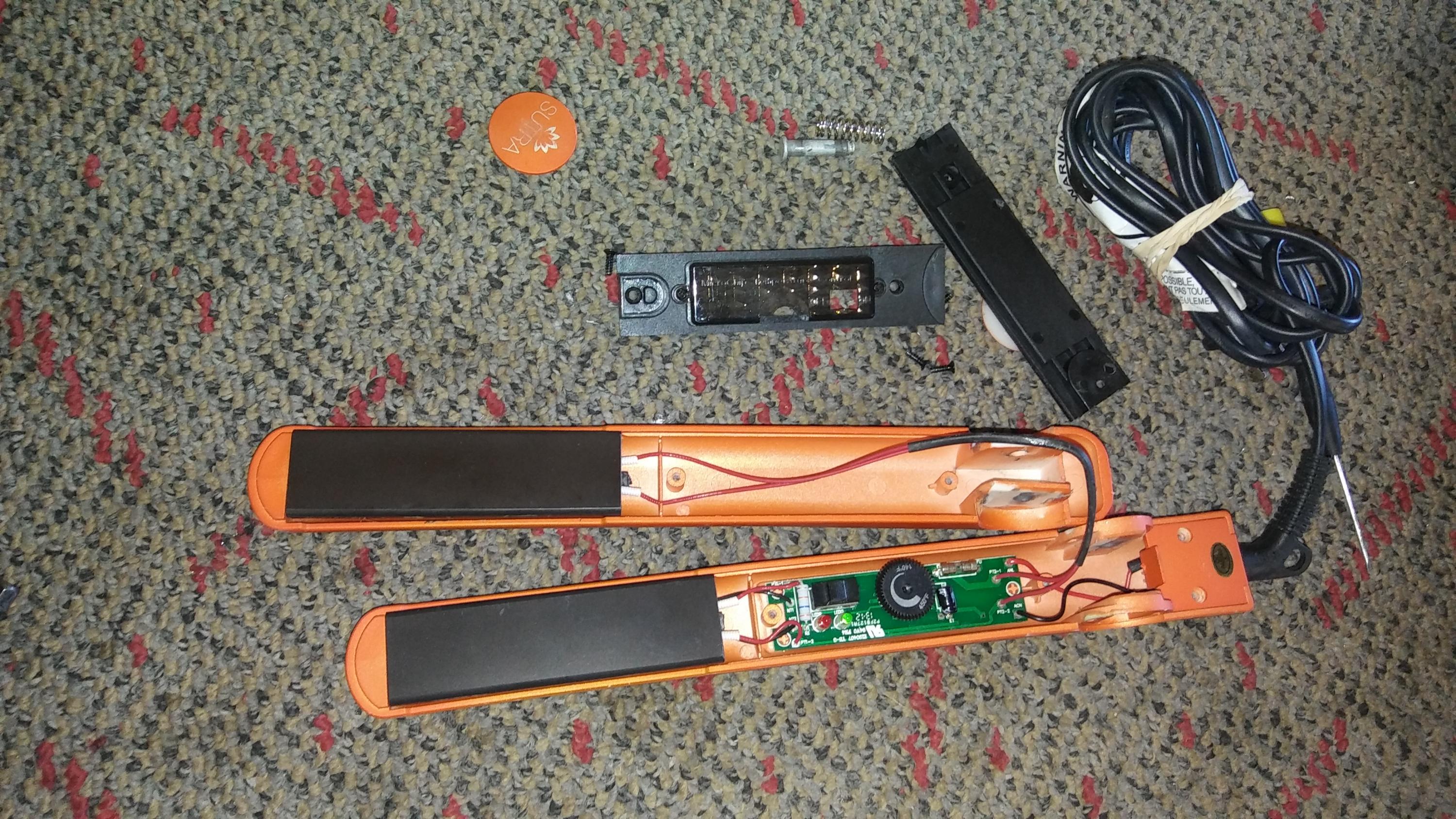

        Over here: LM358 and a TRIAC, two black wires is thermistor, two red wires is PTC heating element.
        hair straightener control circuit principle is as same as this (picture 2).

          By the way what brand name is unit I might have a use for something like this

            brand is SUTRA, I bought it for $3 over Goodwill.

              You might be able to play with U1 PIN number 2 with VR 1 and the resistance of the resistance divider but you will have find which the VR 1 side it is close to 0 ohms at full temperature setting

                my friend, This is exactly what I want to do.
                The goal I want to achieve is to change a SMD resistor then I can turn this hair straightener into Edge LED Strip Desoldering Mini Hotplate with PTC Heating Element. (The other side of PTC heater can be use as a spare part)

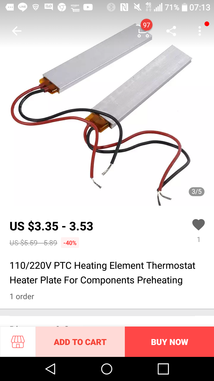

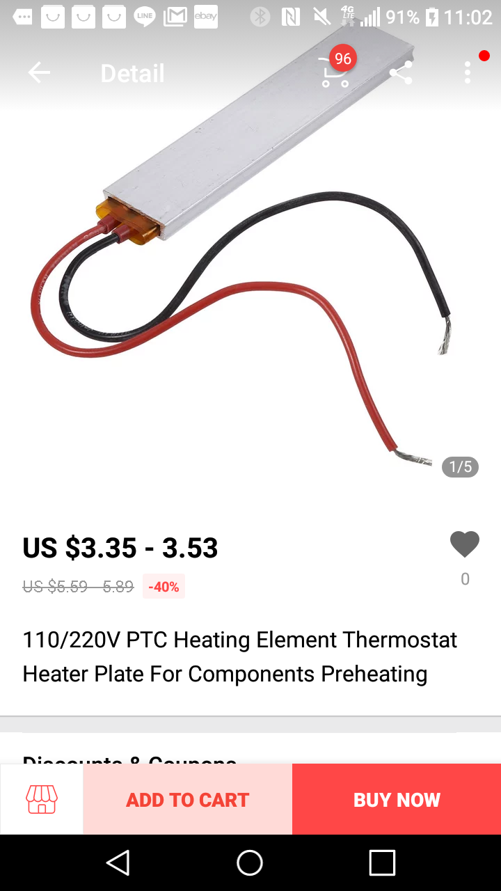

                      Those PTC elements come in all different temperatures. I'm pretty sure there is a reason the one ShopJimmy uses in its LED hotplate is 480F/250C.
                        You can get them felbay and price is reasonable

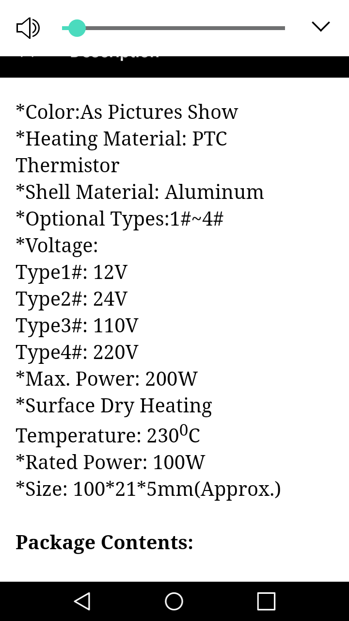

                          I got mine from Aliexpress for £2.50/$3 delivered.
                          It's 200V AC, I just need to wire it up with a switch and fuse.

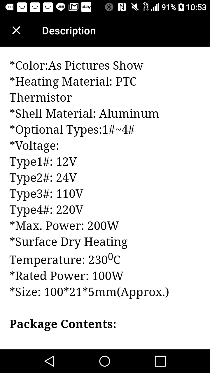

                            Thank you. I changed it to DC by adding one bridge rectifier it works if you want to use AC, yes you can, like diif said Aliexpress sale 230 Celsius element @ ac110v
                            110/220V PTC heating thermistors because of their unique characteristics you don't even need a switch, you can connect directly to the power outlet and they will always maintain the temperature range set by the manufacturer. This new technology makes the temperature control circuit very simple I mean none.

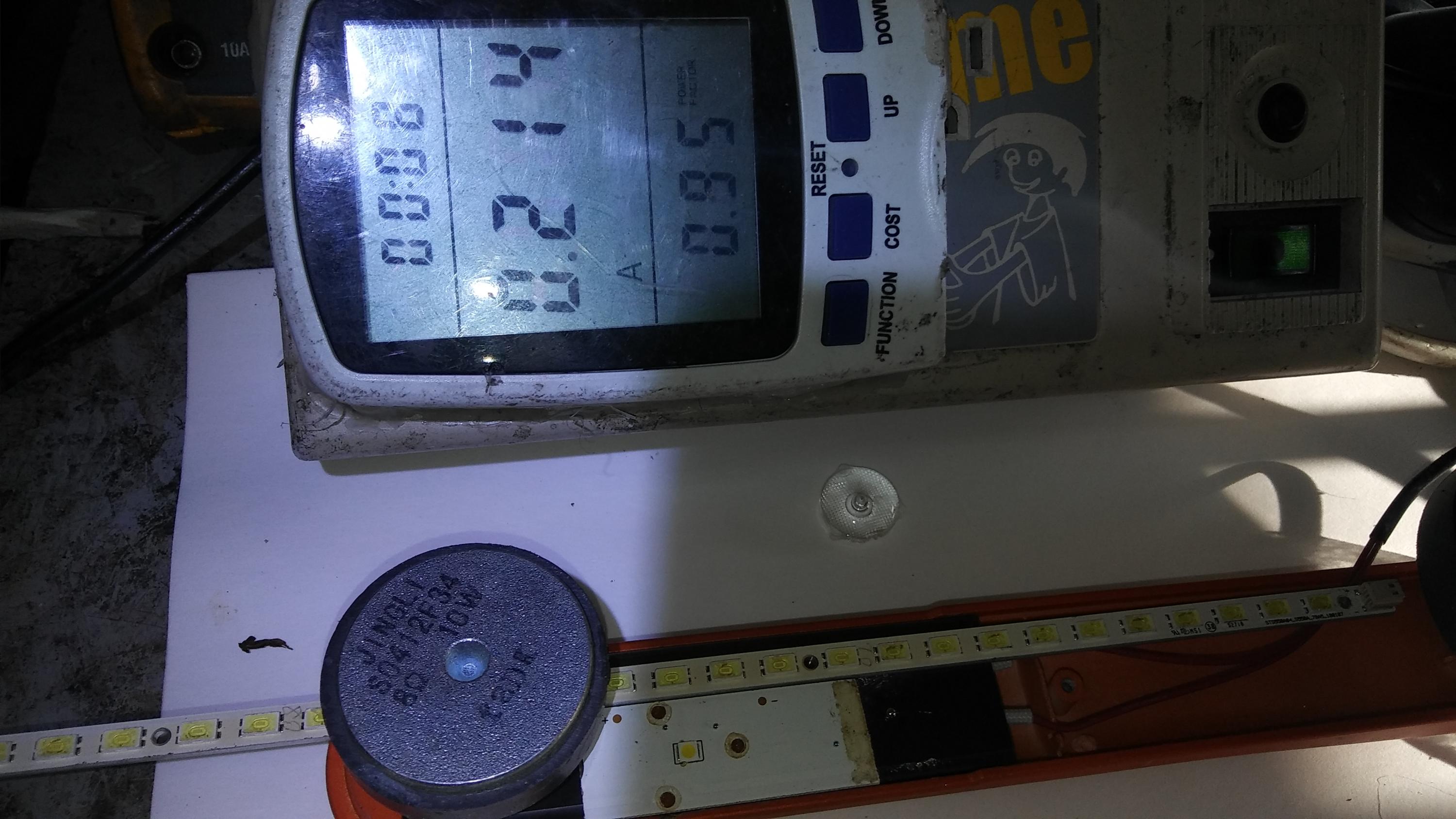

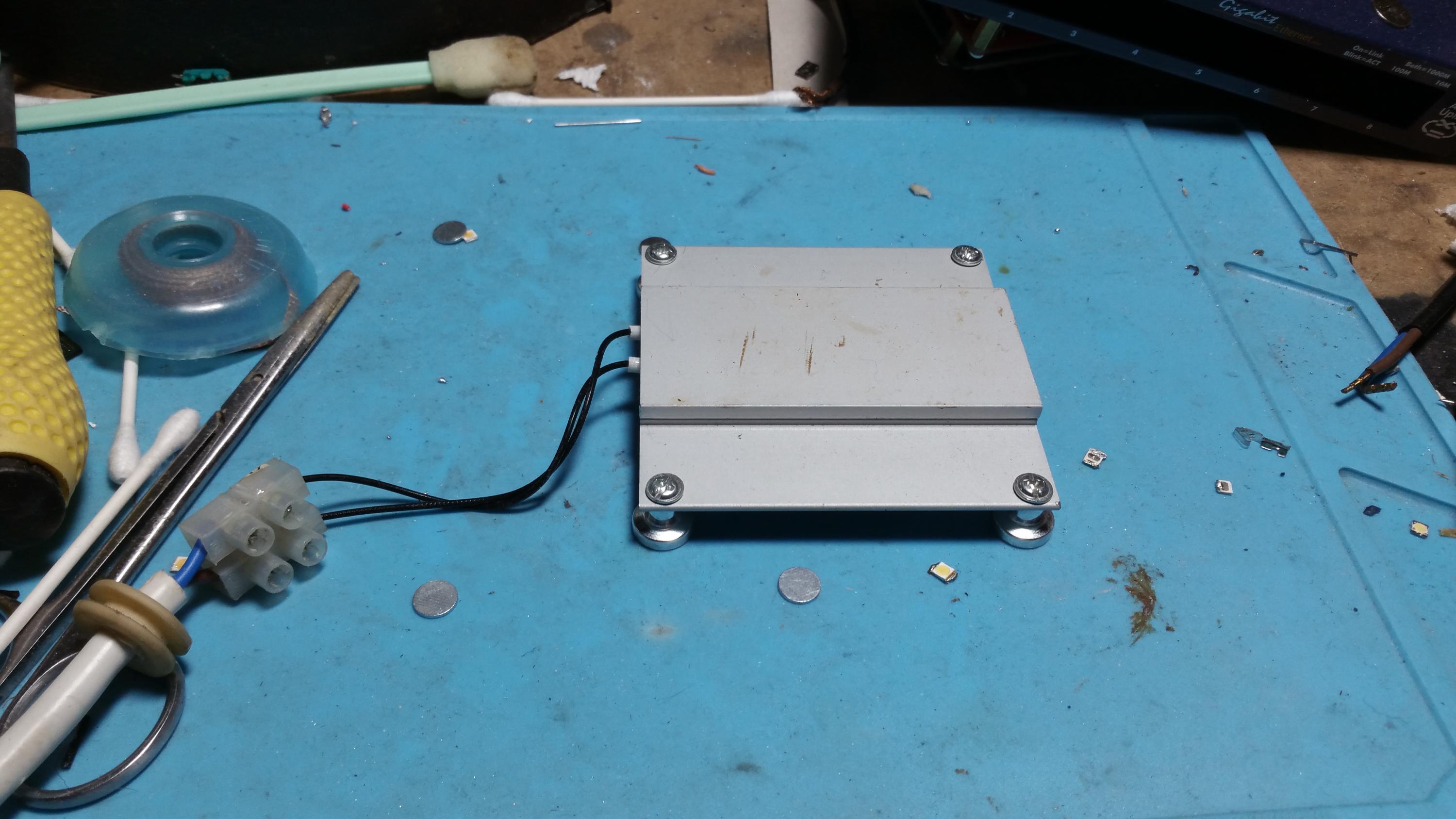

                                I've done some testing this week with mine from Ali.
                                Takes a couple of minutes to warm up but one up to temperature takes a couple of seconds to remove LEDs. I was surprised how well it works on the single sided FR4 strips as seen in some LGs. No burning or damage.

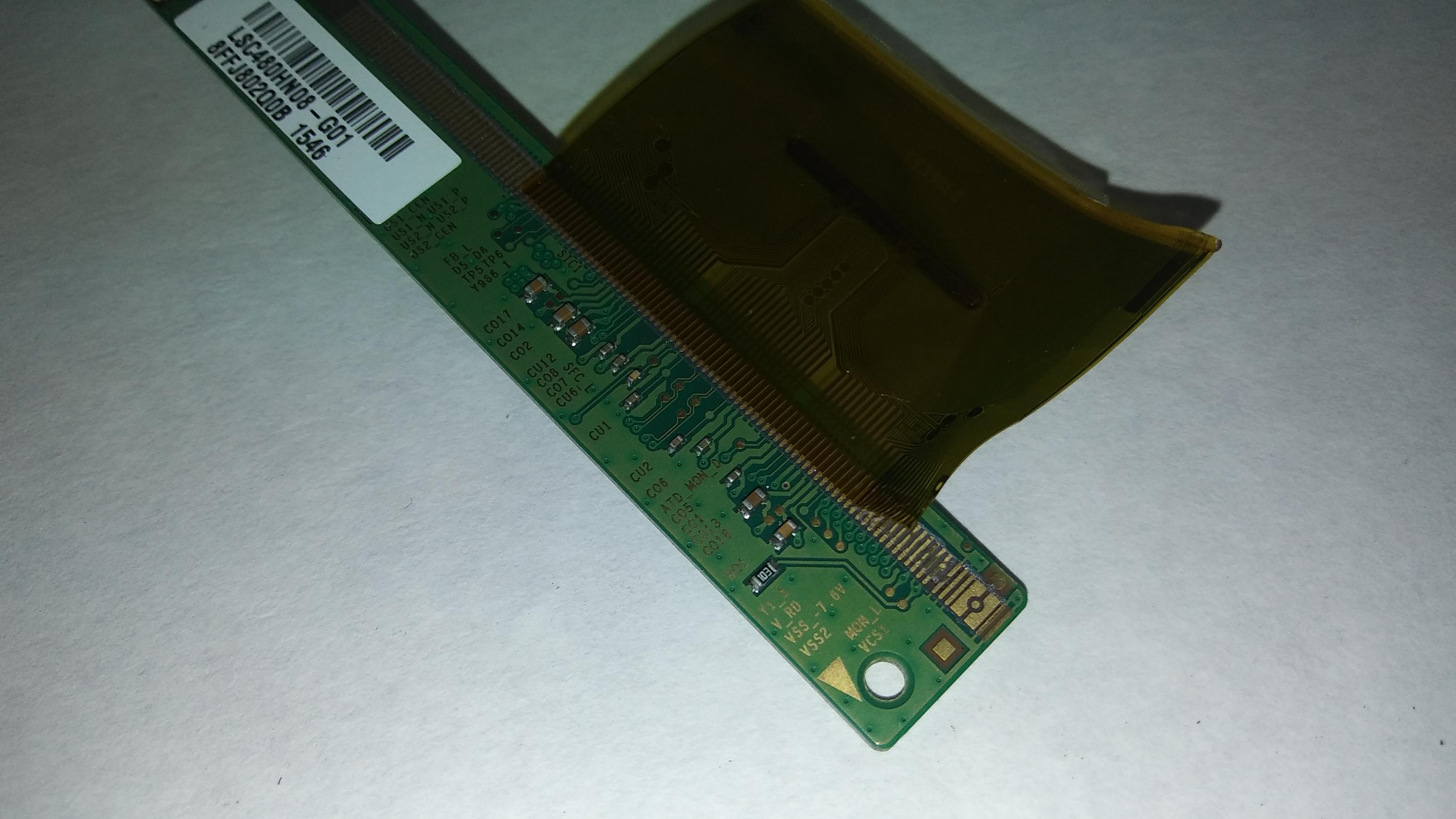

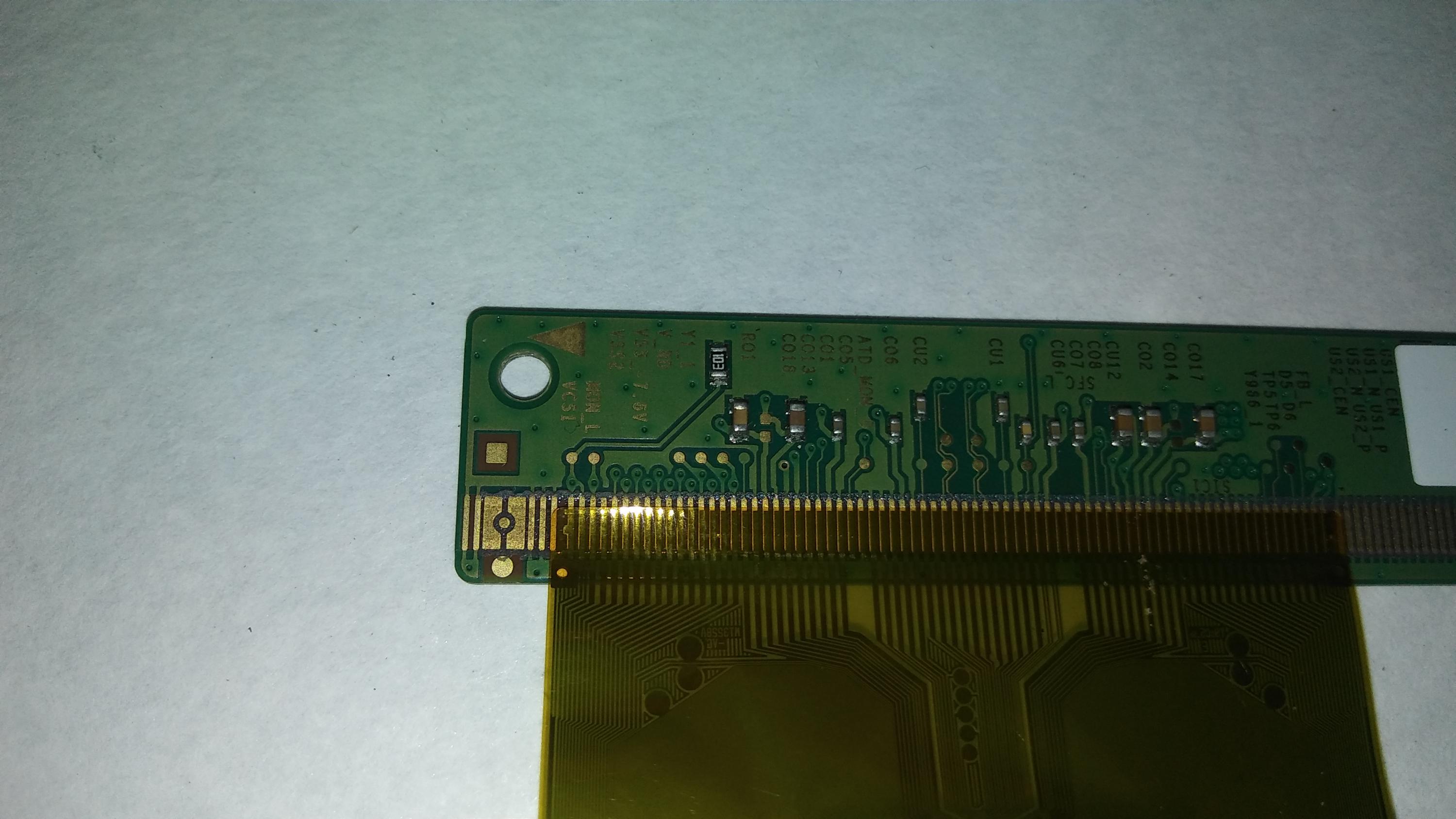

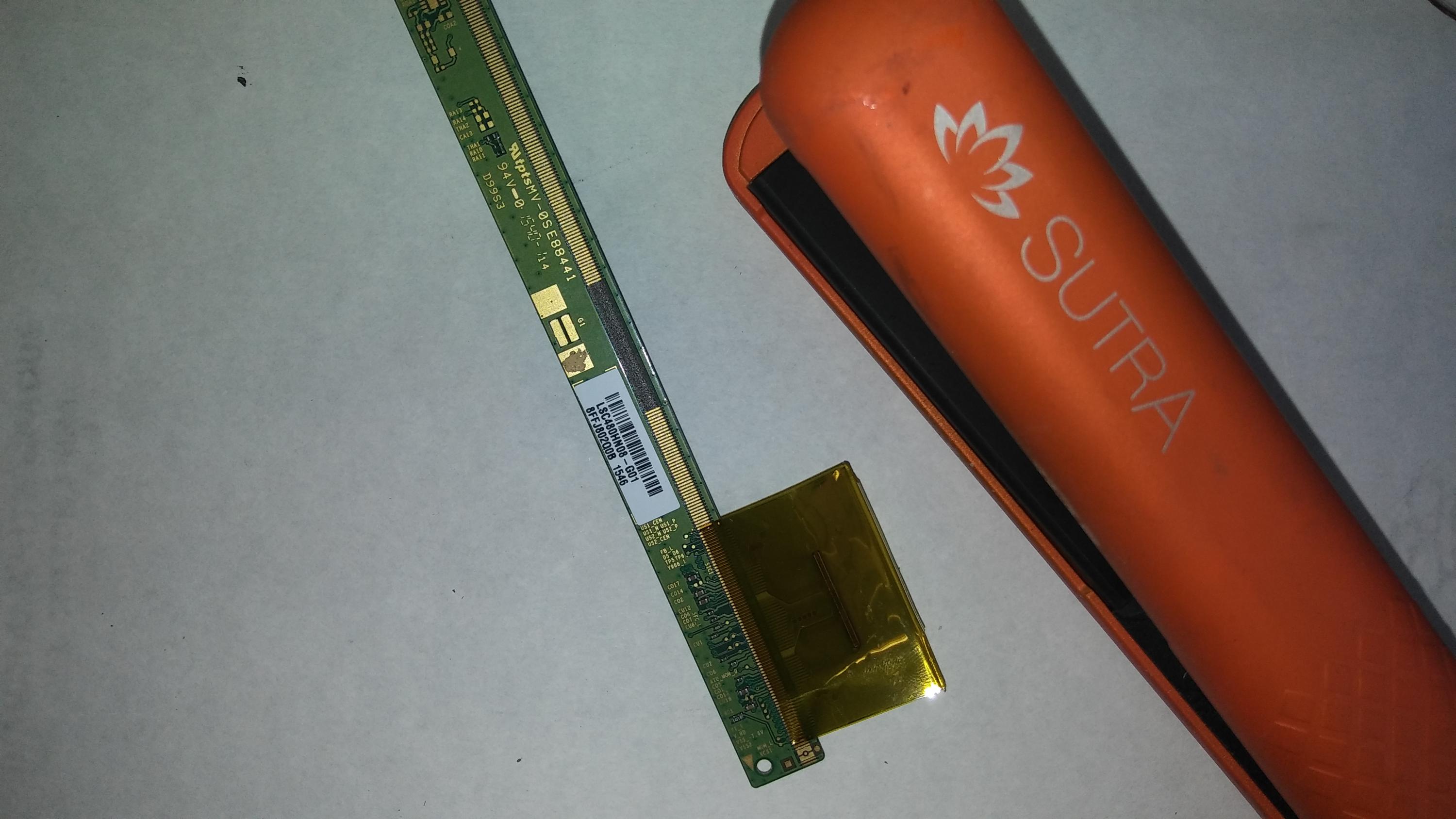

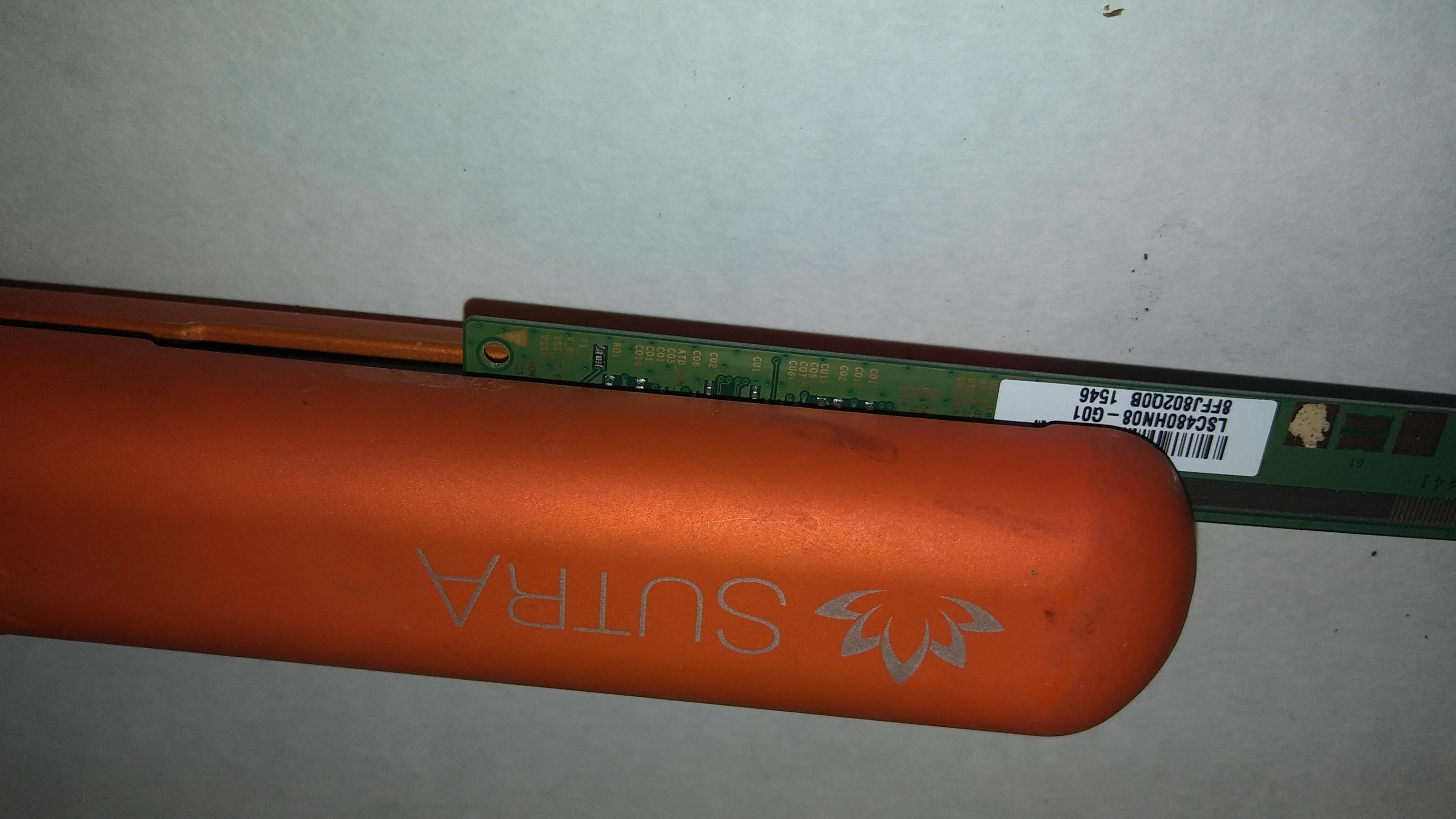

                                  Breaking news...... I used this hair straightener, successfully repaired LCD screen COF bouncing that I deliberately tore it open 1cm.
                                  The next progression is on working TV.
                                  The COF section connected to the screen is relatively close, more compact but the principle is basically the same.
                                  .... so hair straightener portable COF bonding machine is in the future.

                                    The same principle can be proved Mr. diif's PTC heating thermistor will work on COF bonding also.
                                    That's why I had ordered two small and narrow PTC thermistors for COF machine.
                                    If someone uses PTC thermistor to make a soldering iron that will be wonderful you would not need any temperature controller and it will be as simplified as my sixth sense soldering iron.
                                    One question for diif is what kind of temperature PTC thermistor did you order? 250c or 200c
                                      It's 260c. I have another that is listed as 250-260c.
                                      • capwizard
                                        • Jun 2016
                                        • 1991
                                        I bought 2 x PTC @ 230 C. Actually 200 C is enough.
