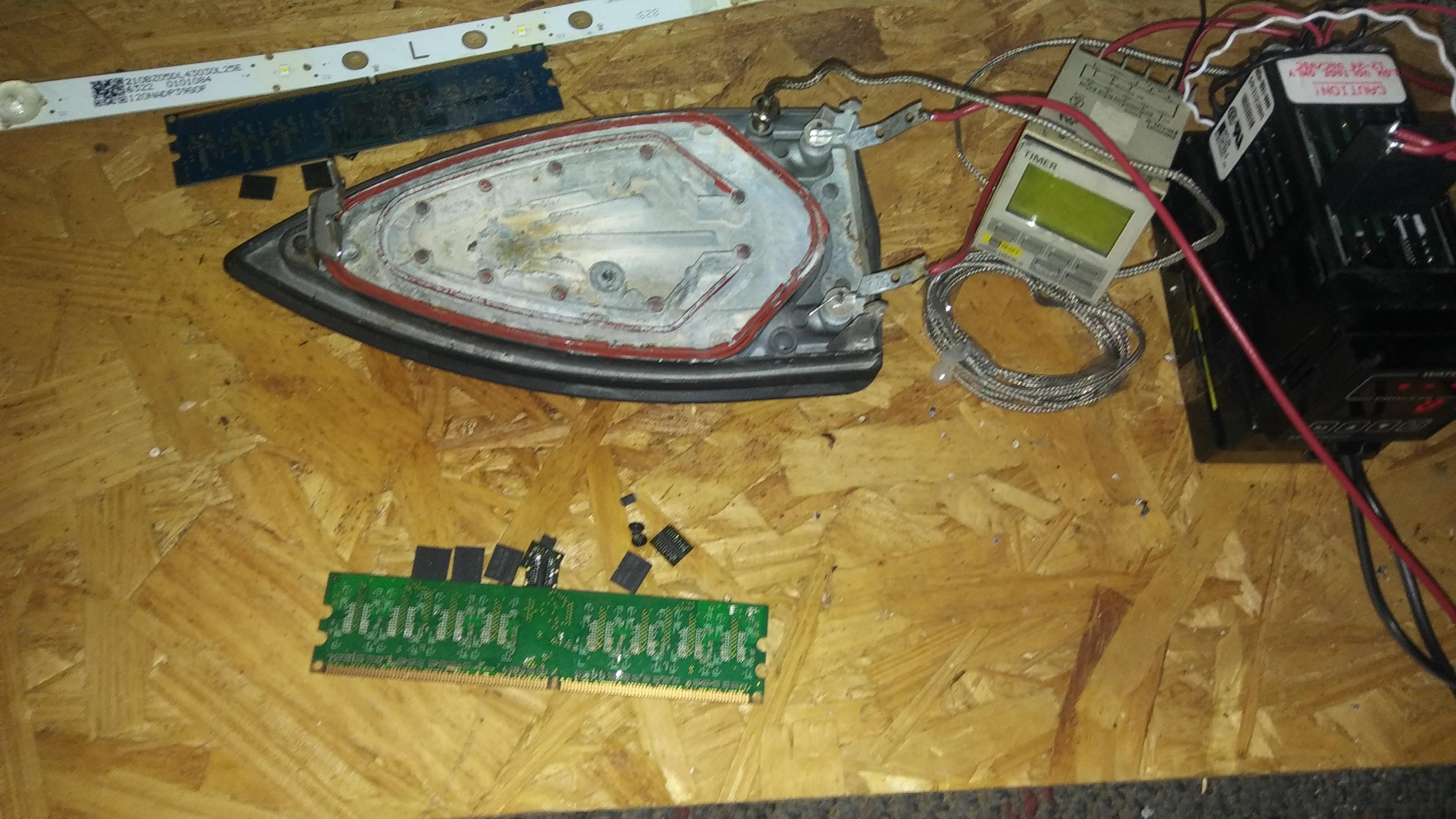

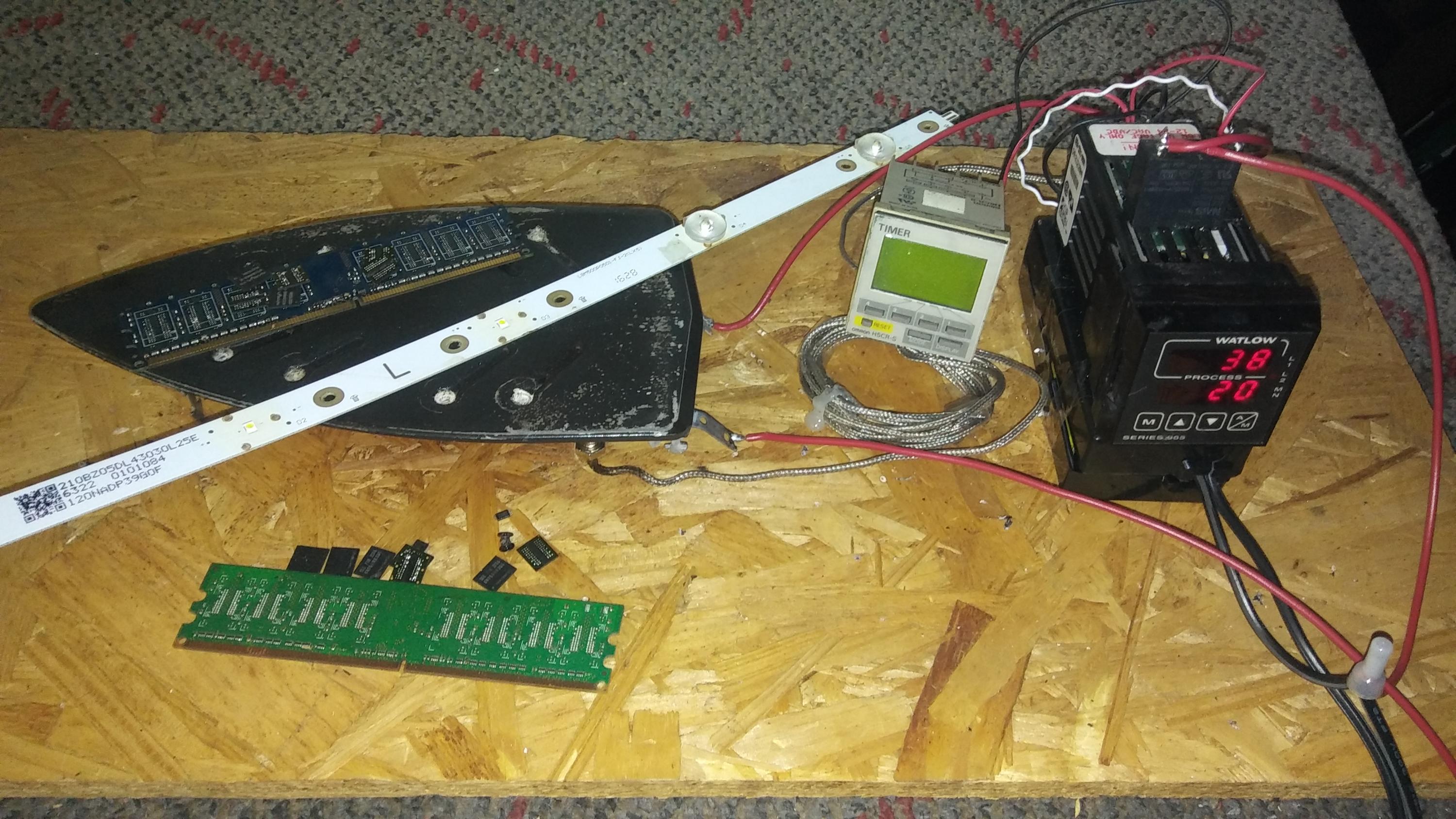

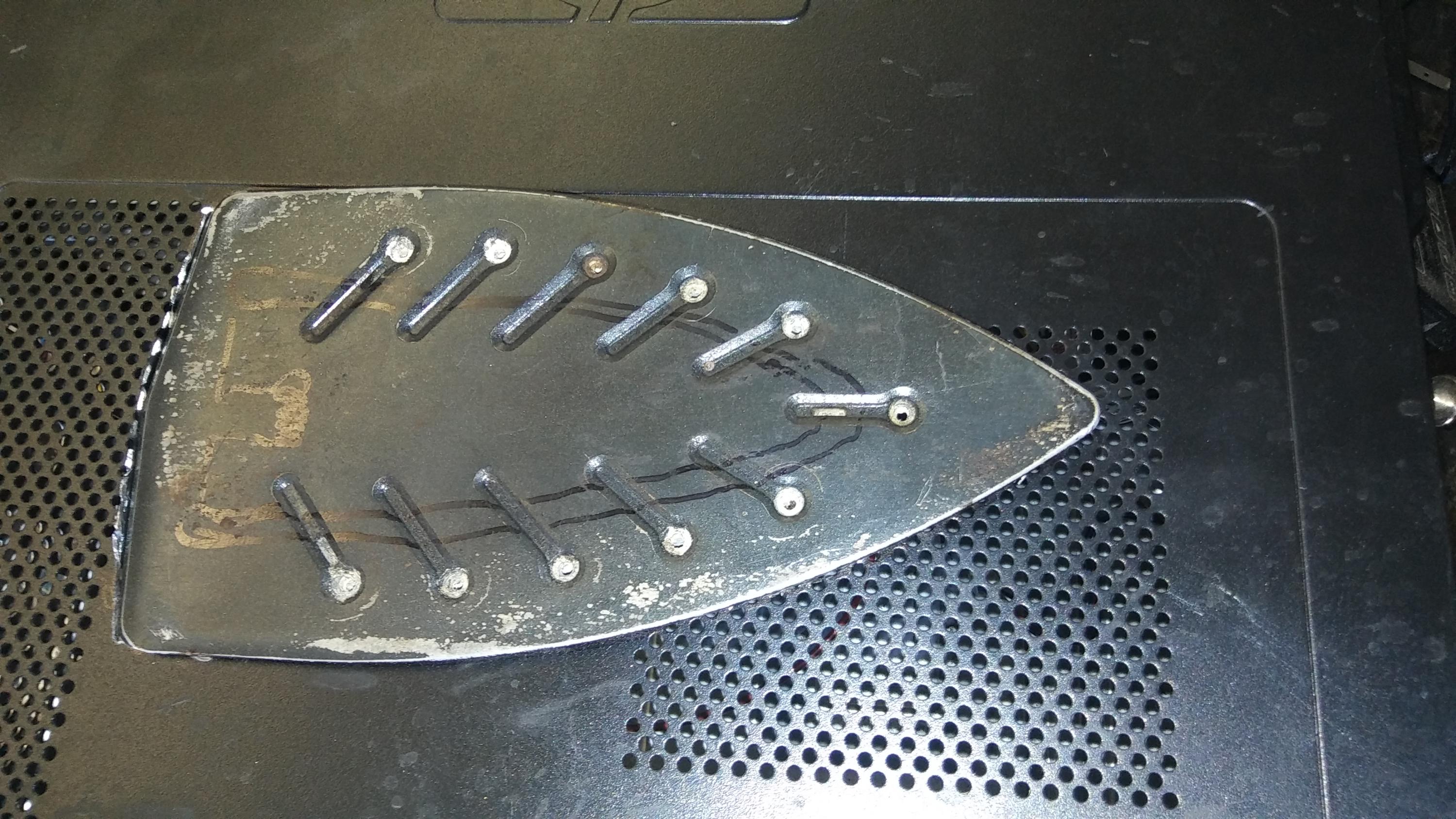

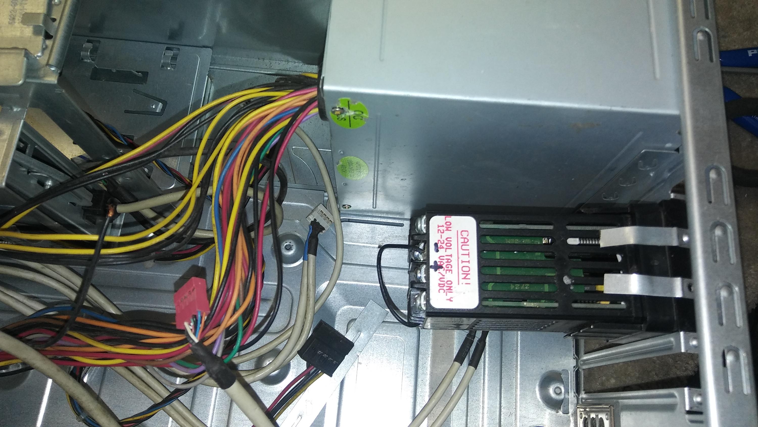

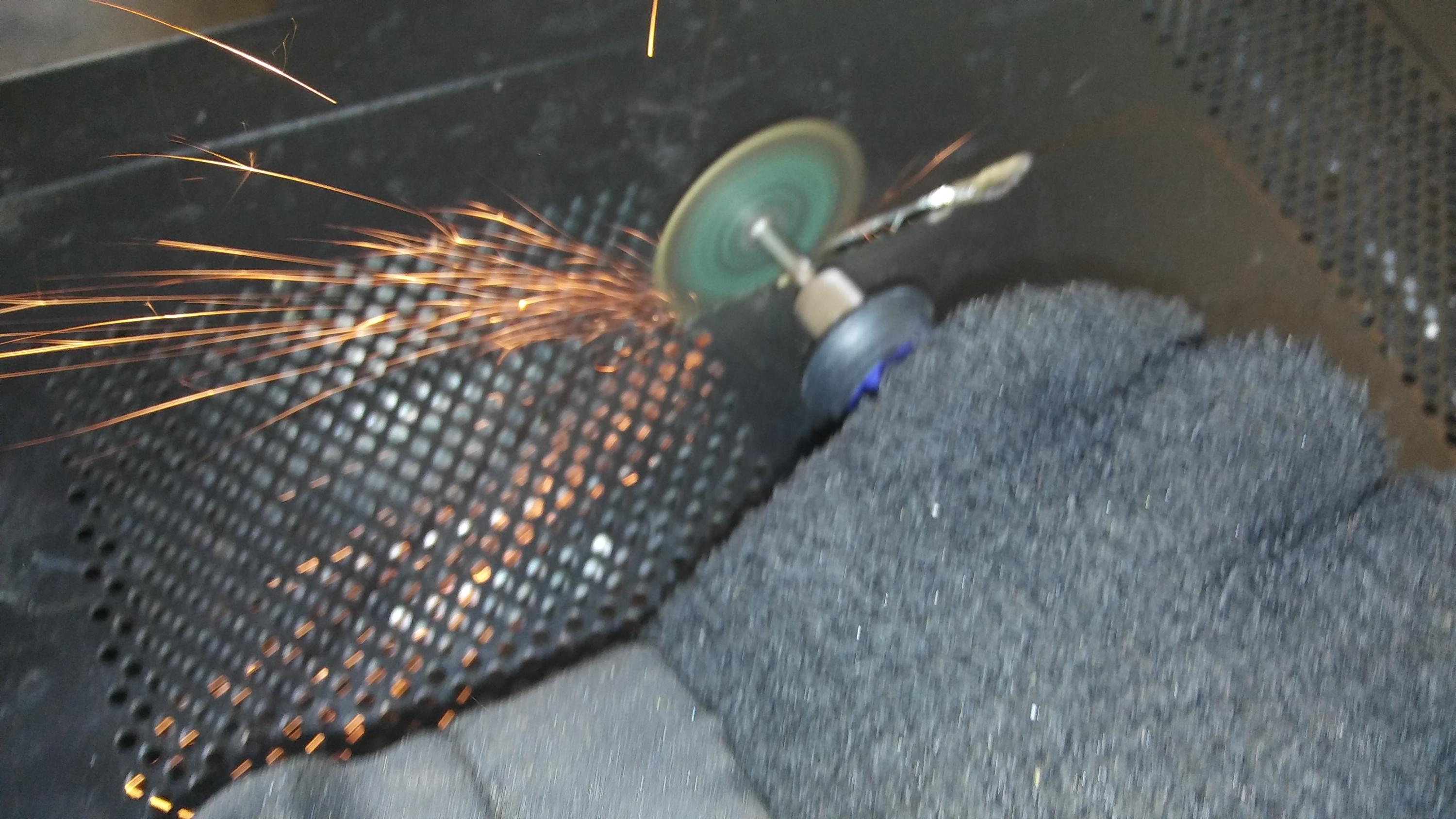

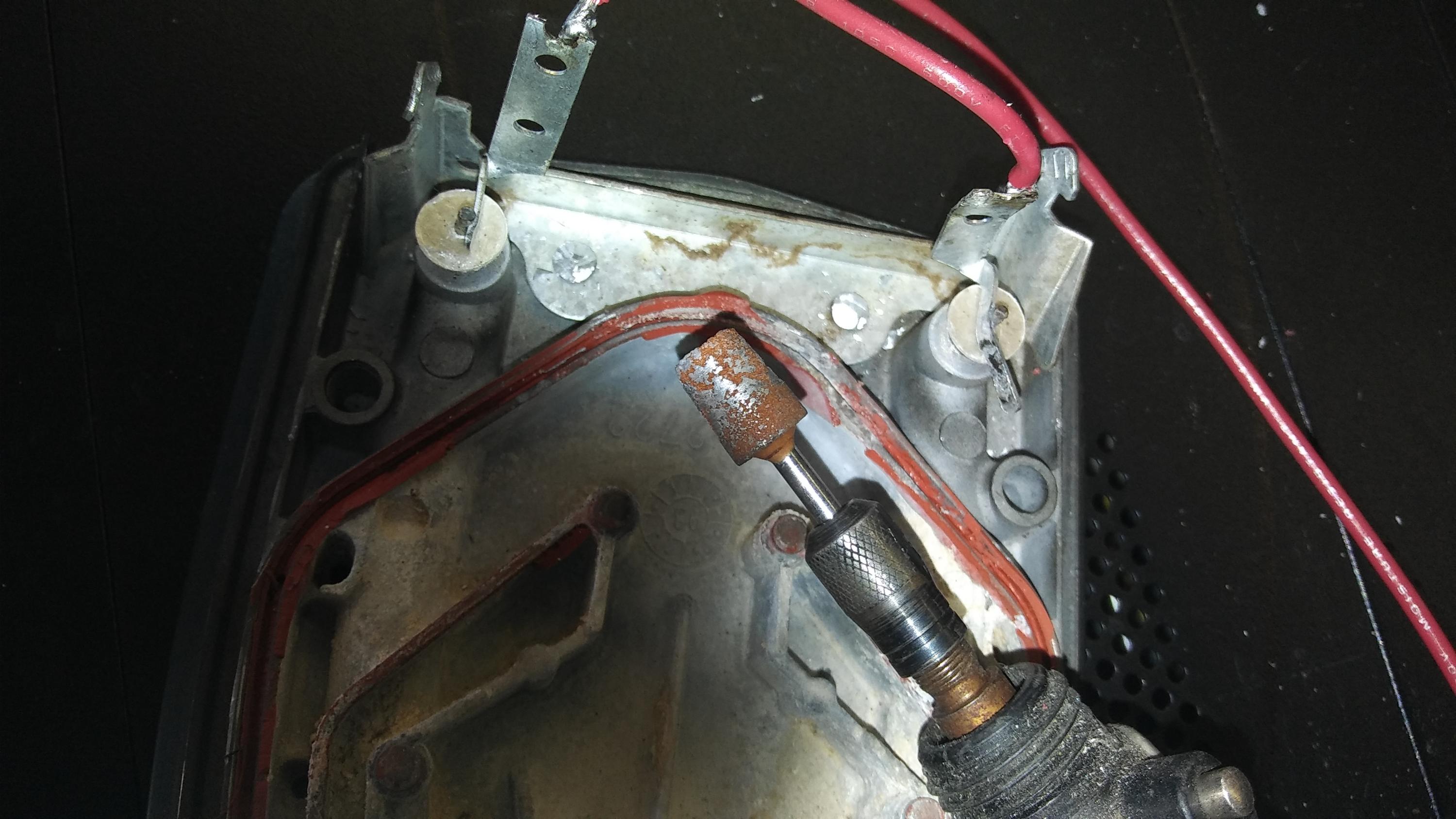

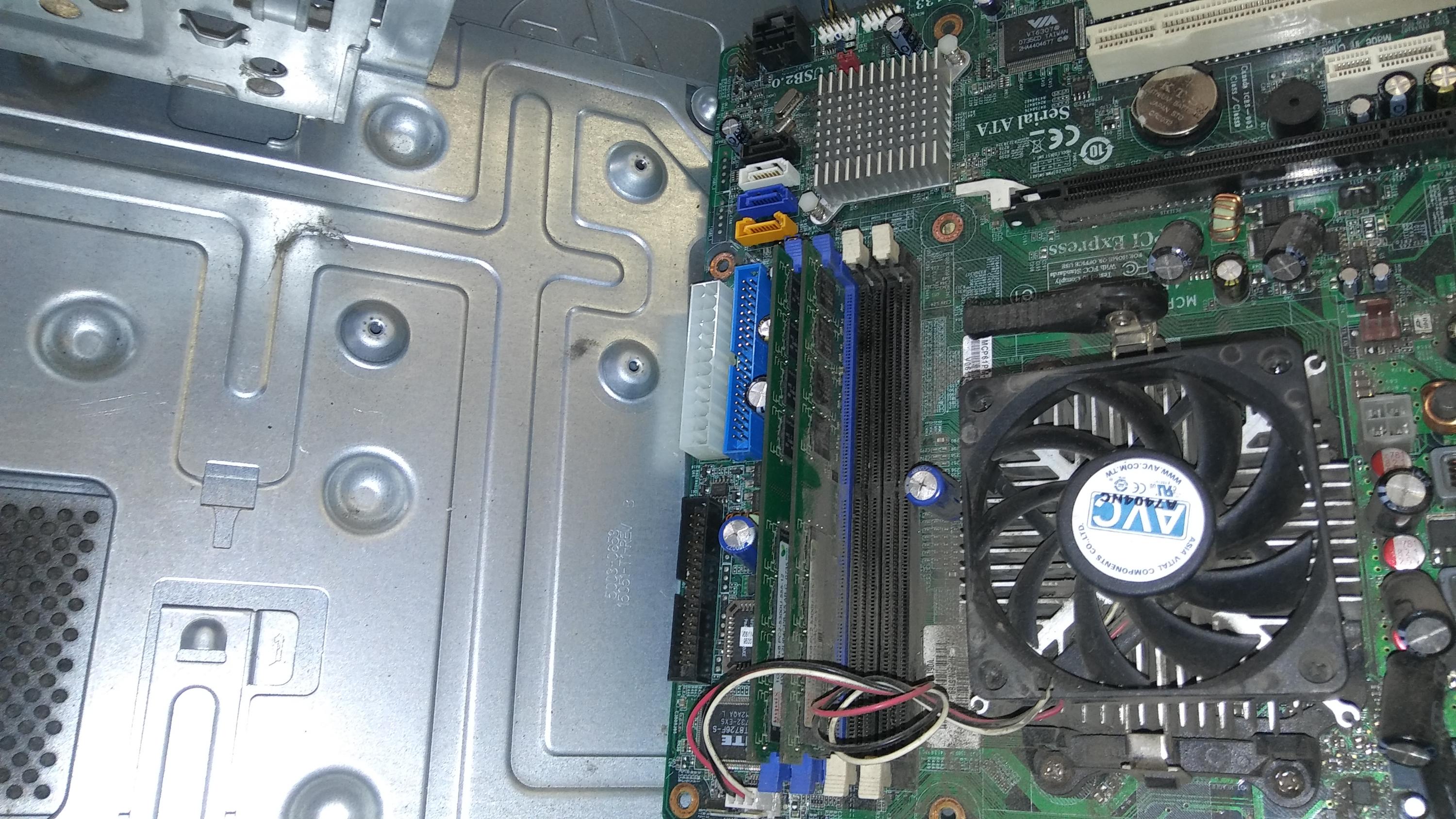

    Re: Soldering hotplate

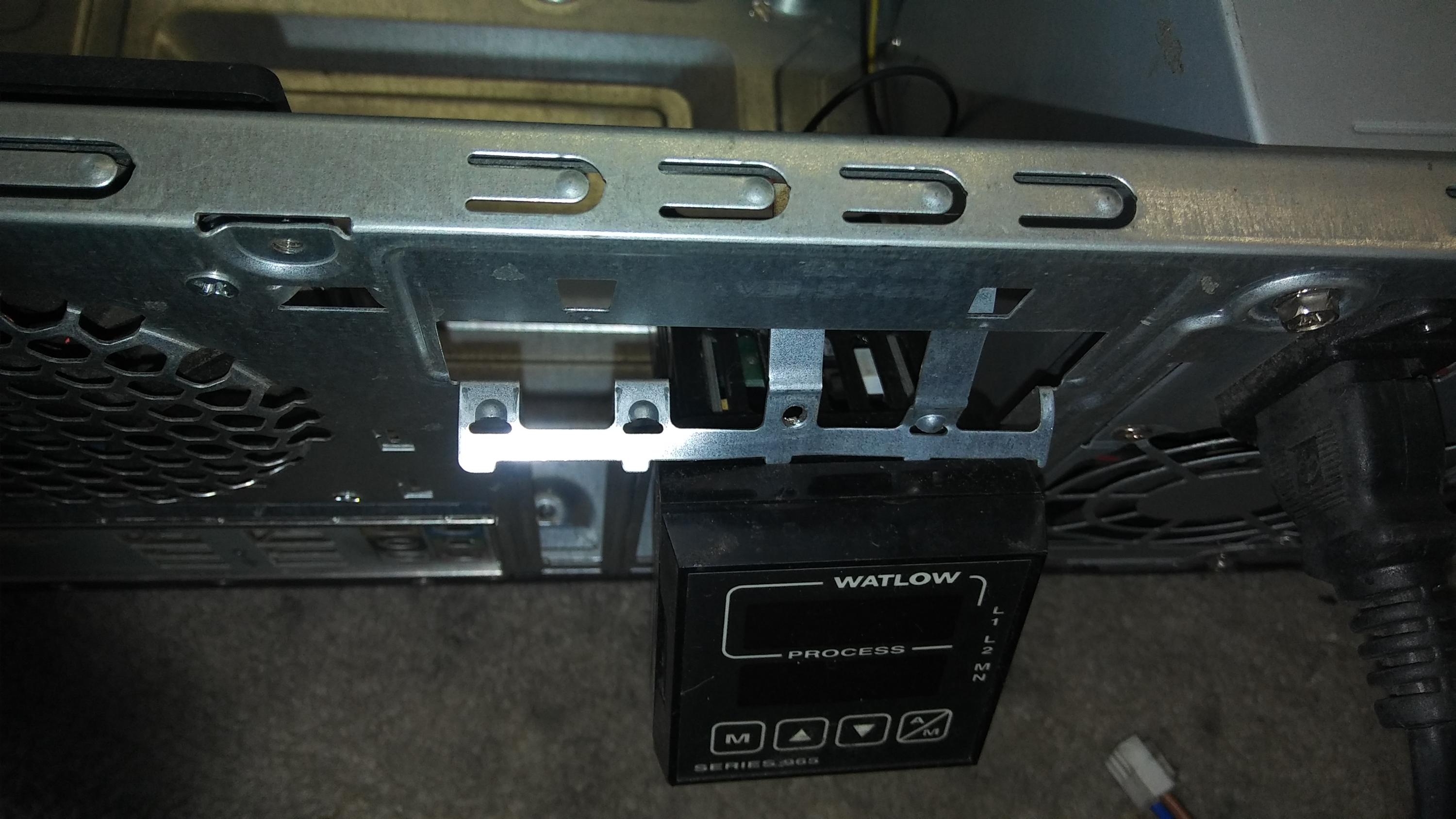

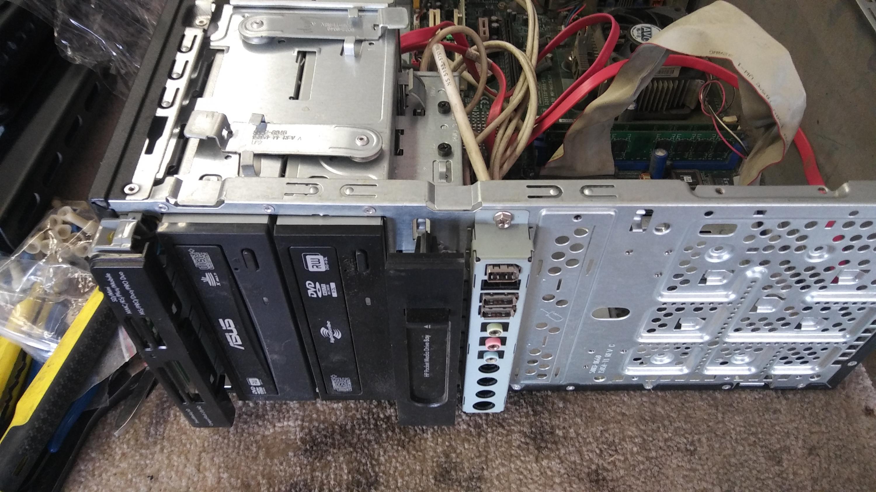

    Improvements to HP Visa PC, PID Controlled, Clothes Iron Hotplate.
    HP Visa PC motherboard caps pop, it is perfect for a hotplate.
    • capwizard
      • Jun 2016
      • 1991

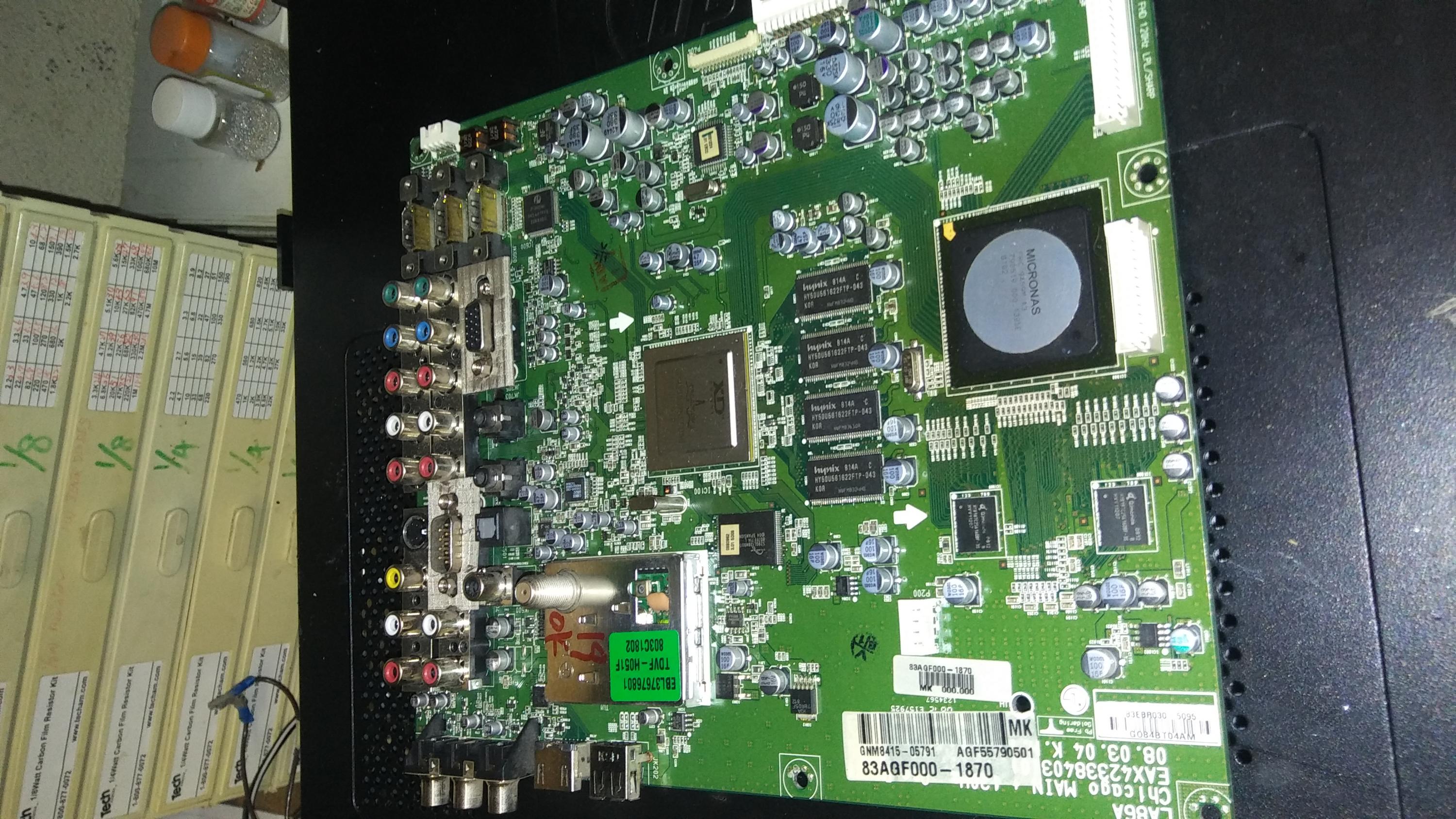

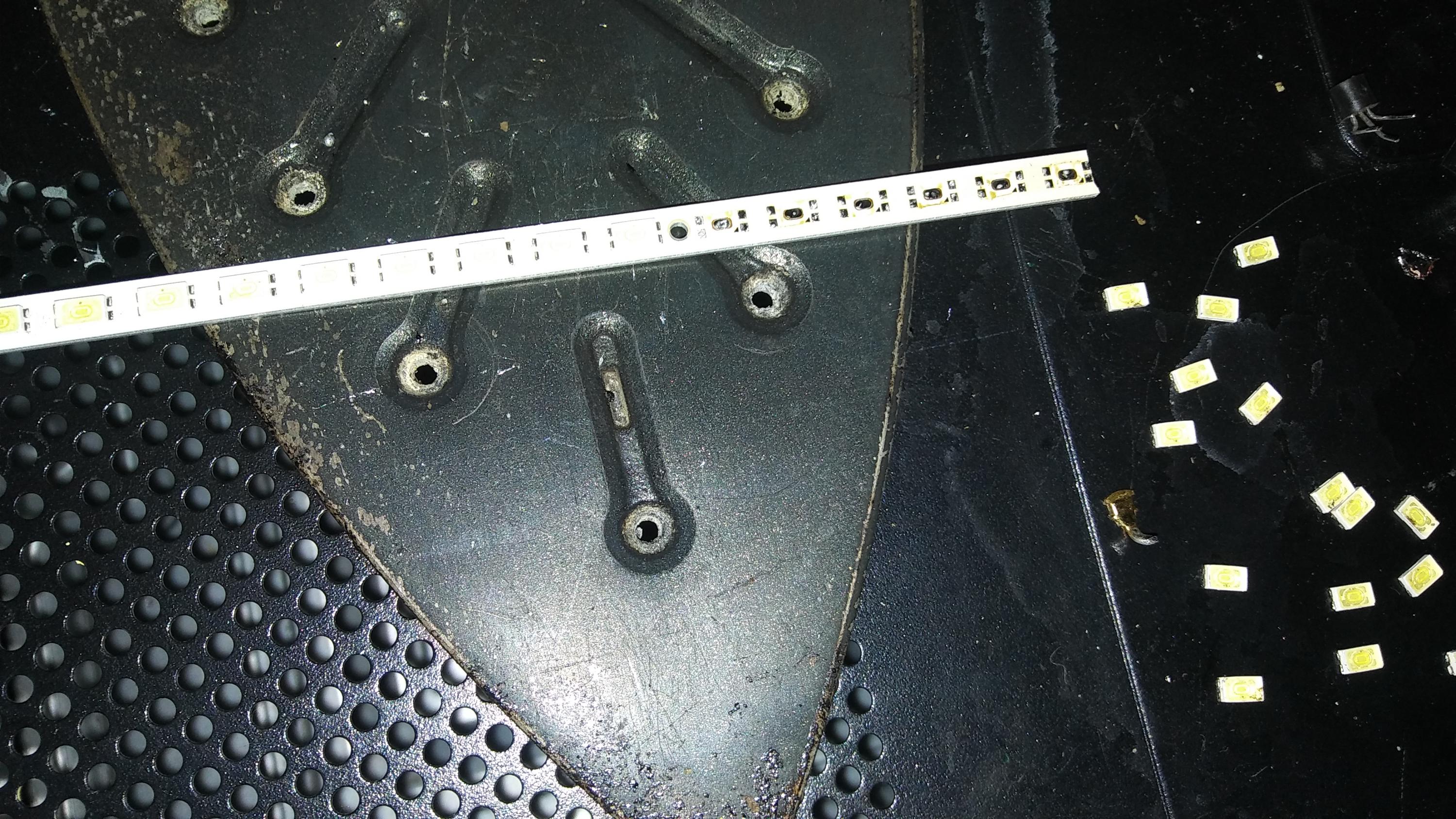

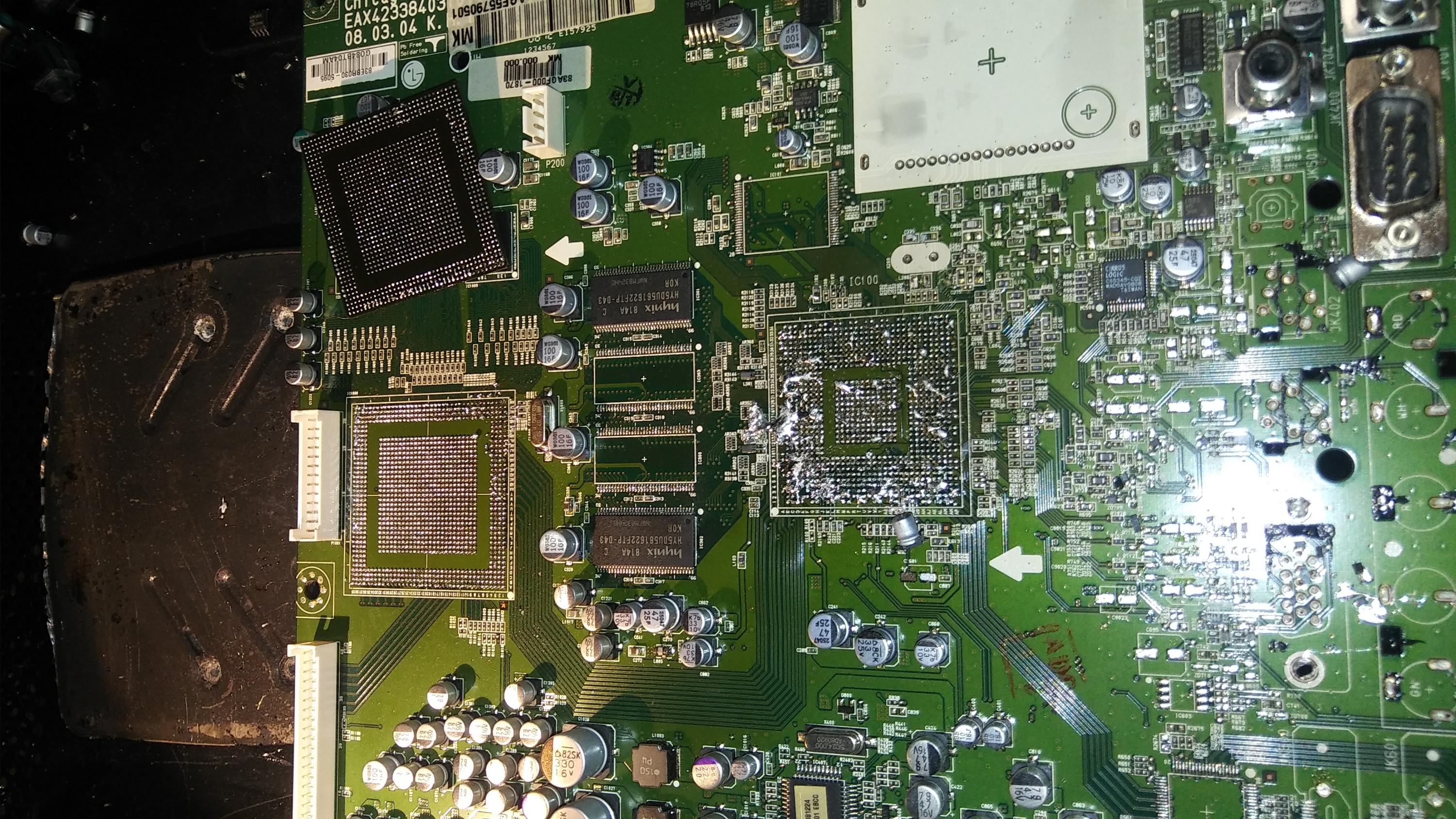

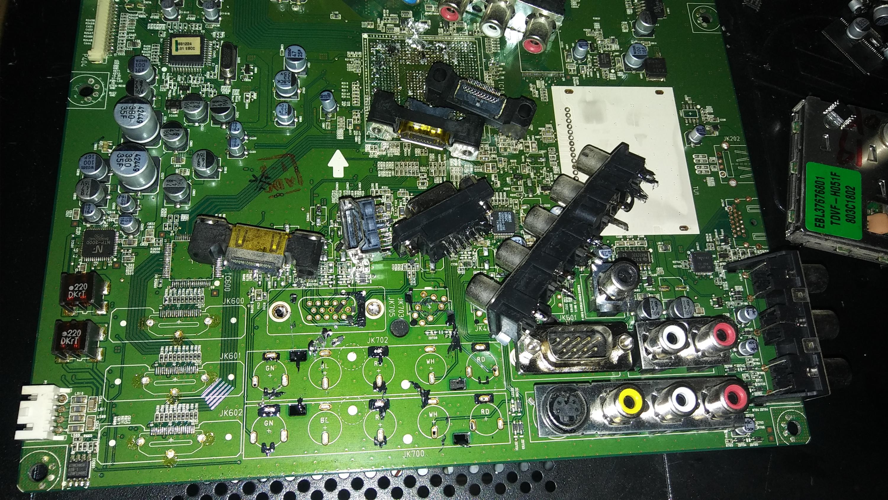

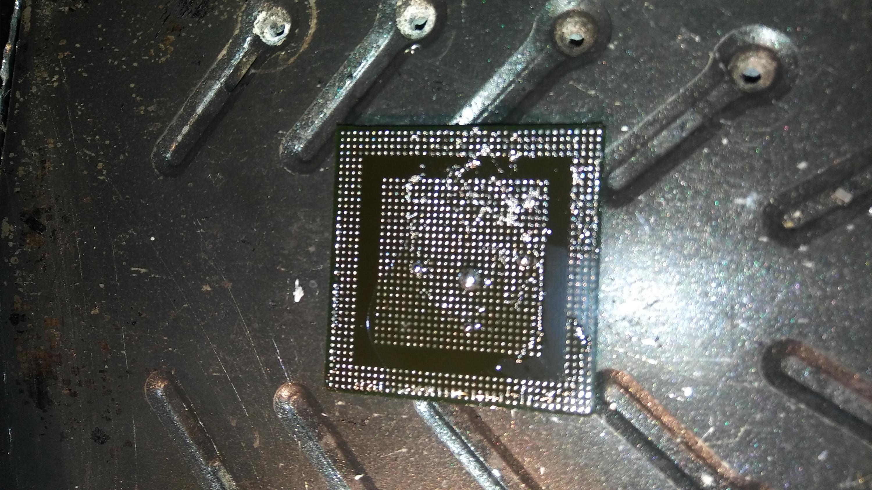

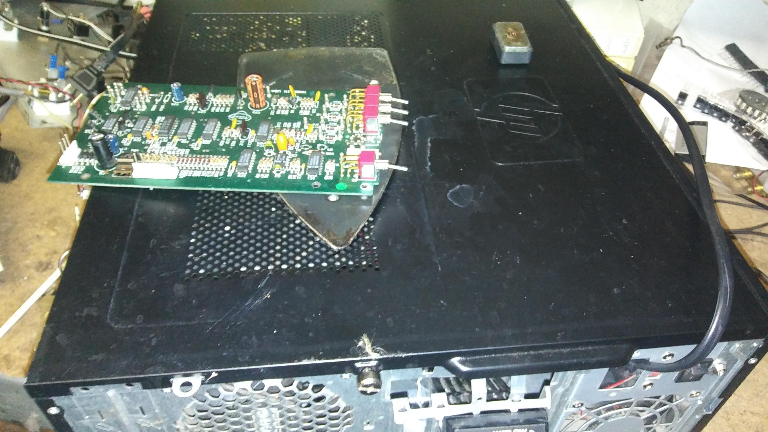

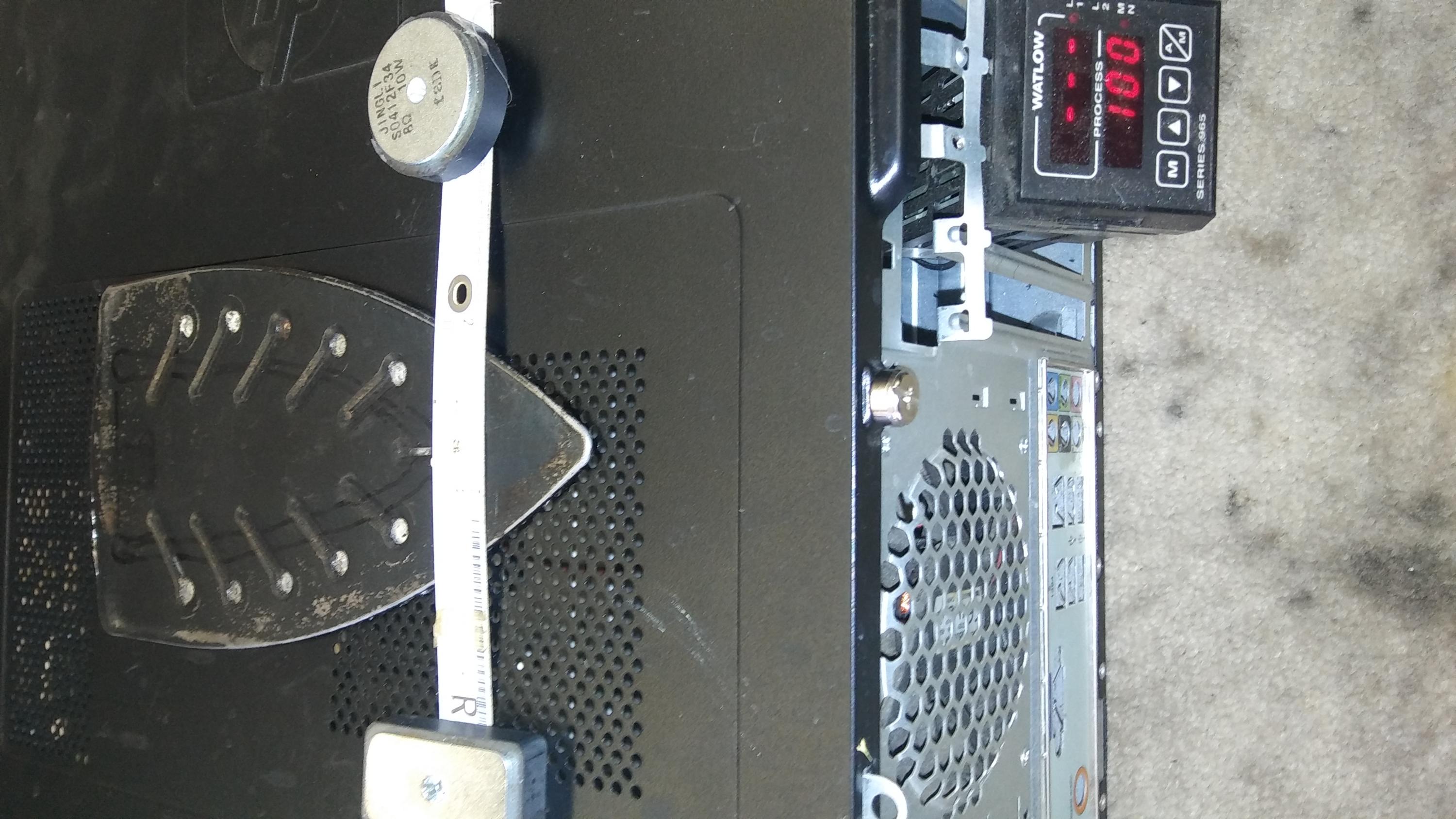

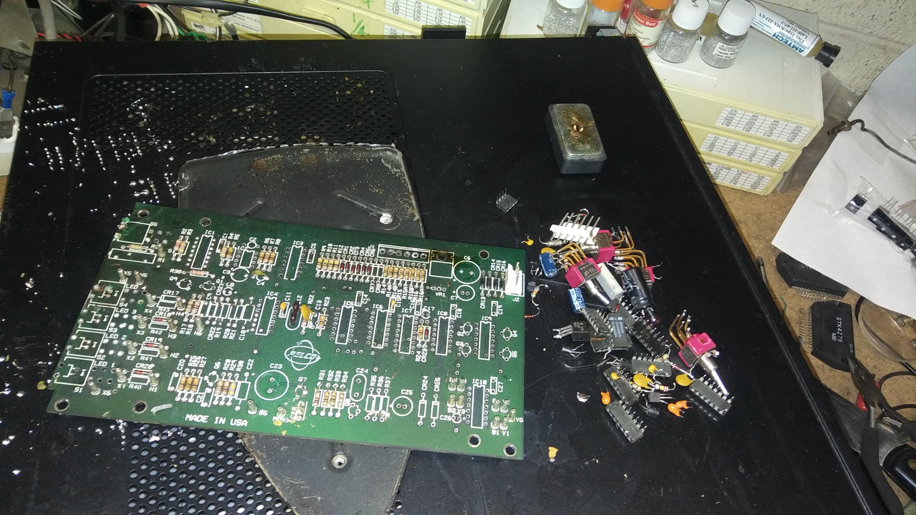

      My wife will be proud of me if she knows that her clothes iron has so many functions.

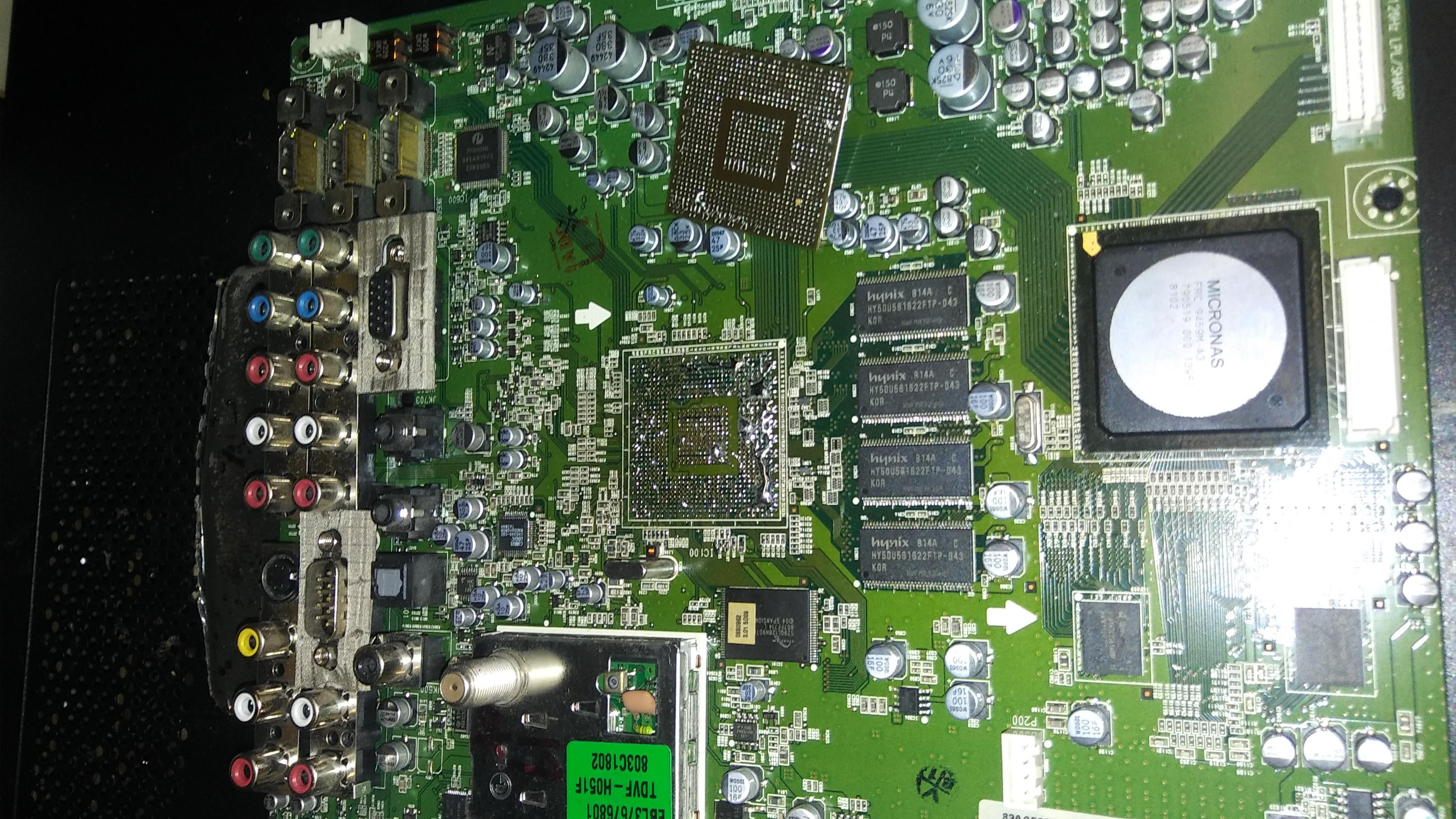

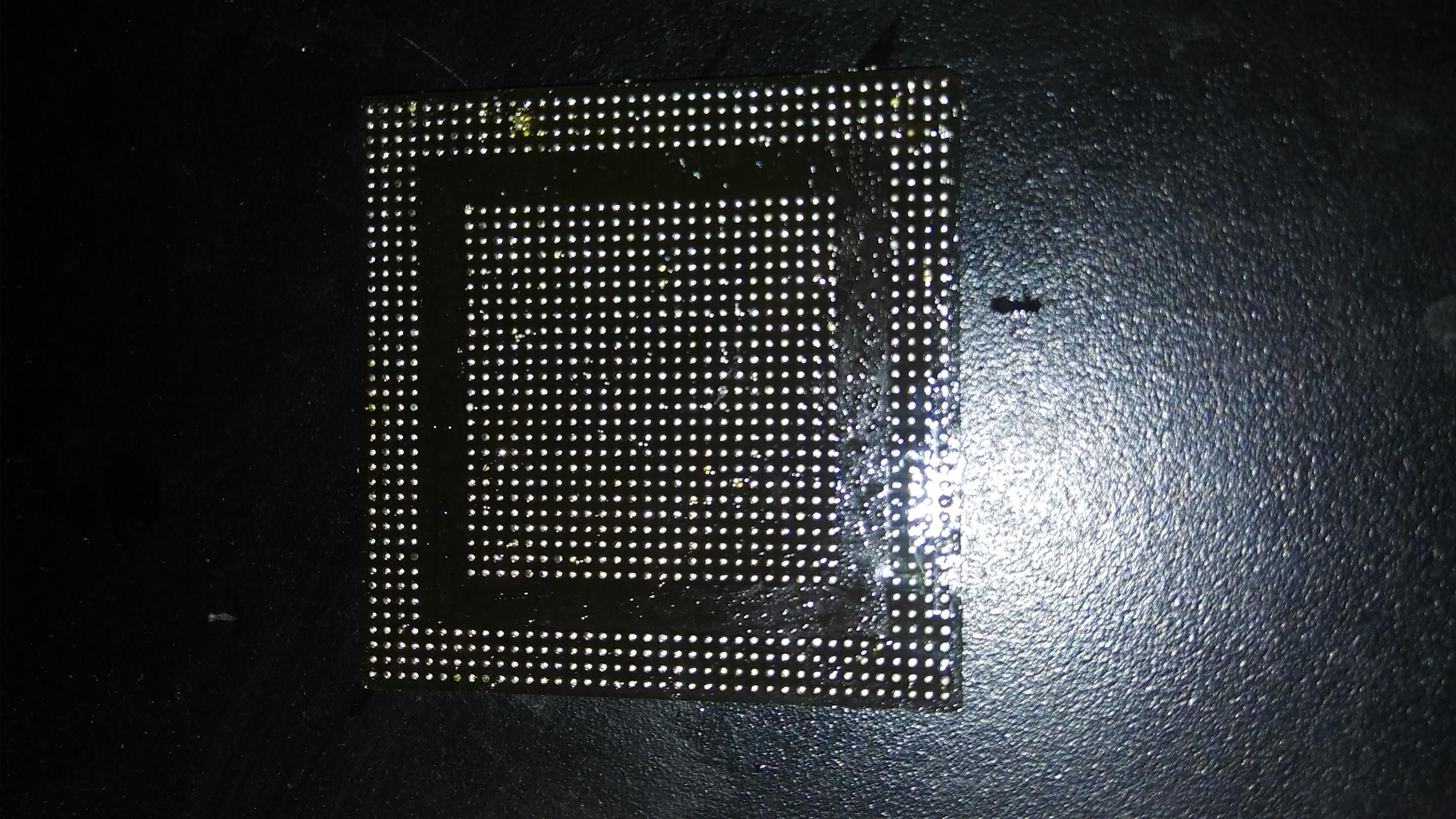

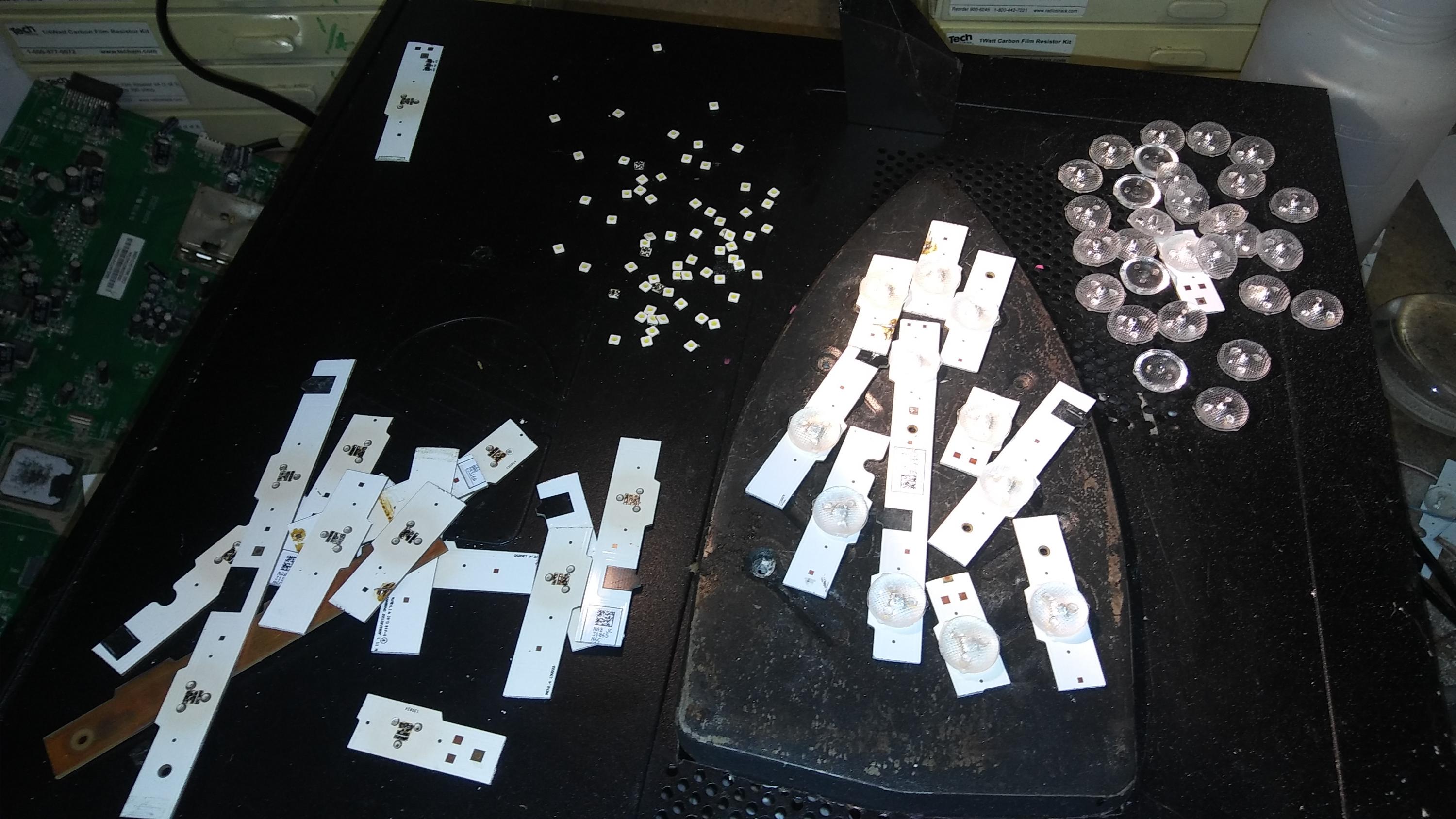

      Picture:
      1) I need one lm555 to do PWM experiment.
      2) I bit off more than I can chew on this old security camera board.
      3) how about the edge LED stripe, no problem at all.
      4)Burning orange peels will have a fragrant taste.
      5)how about bag chips on tv logic board.
      6, 7) it's a piece of cake.
      8,9) I tried to reball the bag chip under 250c temperature.
      10) I might need HDMI connectors in the future.
