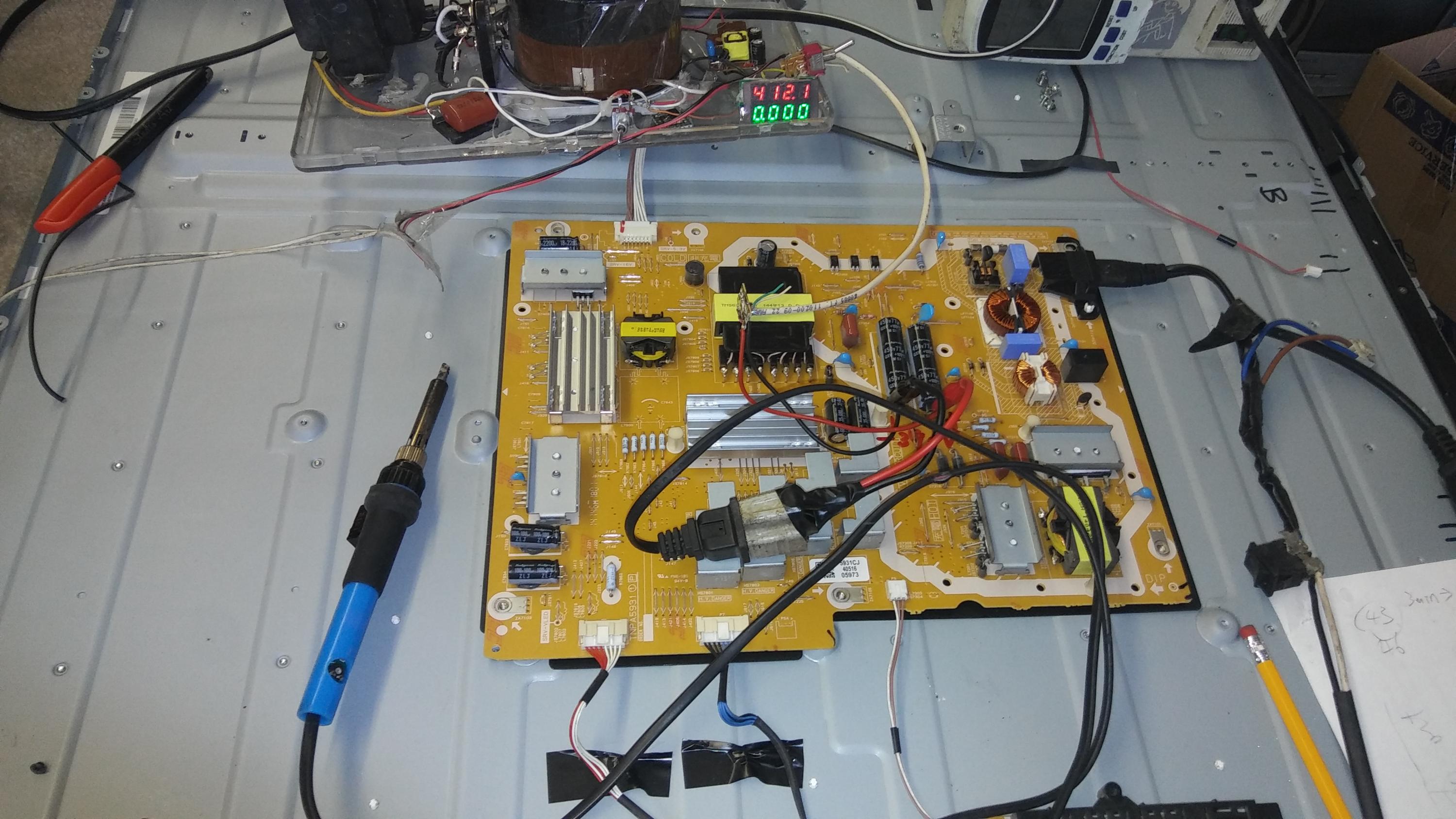

    I have already read this and this. I don’t know why they have to use such a high voltage after I have been shocked frequently. So now I have a few questions?
    (1) They use 375v is because of the input voltage AC 80 to 240v, So all the world can use this PFC?
    (2) How do we discharge the power board when we are repairing the TV? what kind resistance value of the resistor should be used to discharge from the biggest capacitor?
    (3)Is it suitable for LED tester applications after adding an isolation transformer?

    1: The higher the voltage the higher the stored charge in the bulk capacitor.
    The ATX spec says you need 16ms holdup time, with a 1000uF 400v capacitor charged to 325v you have 53 joules, however if instead you charge it to 400v you have 80 joules.
    Or looked at another way: it's enough with a 660uF capacitor charged to 400v to get 53 jolues.
    When you have that info you can calculate the holdup time, as you understand the lower the capacitance the cheaper the capacitor is.
    So it's s way to keep the size & cost of the capacitor down, while still attaining good holdup time.
    2: A decent sized resistor is fine, at two or three kilo-ohms
    If you want something more decent have a look here, it also shows what would happen with a low resistance resistor
    https://www.badcaps.net/forum/showpo...6&postcount=86
    3: Don't understand what you are asking here?

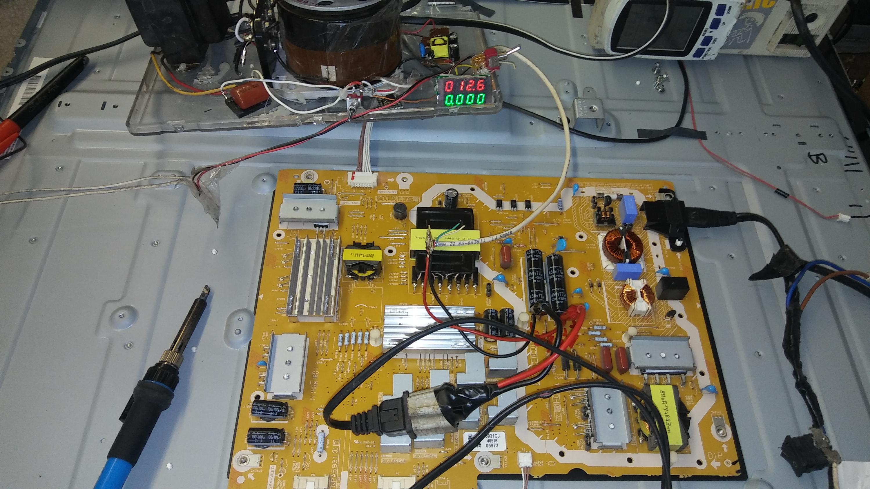

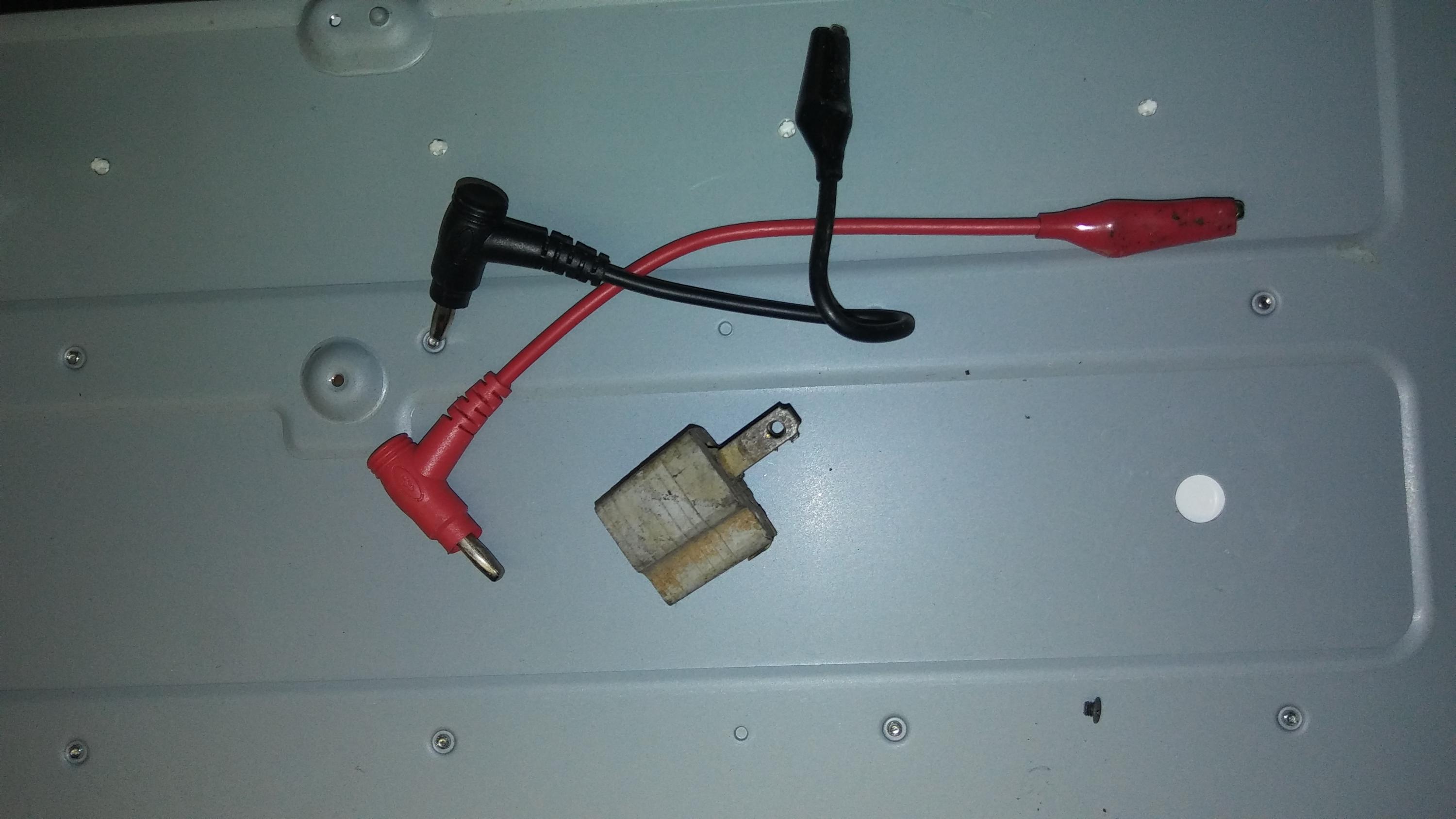

        Re: Boost PFC Converter
        Thank you for your advice.

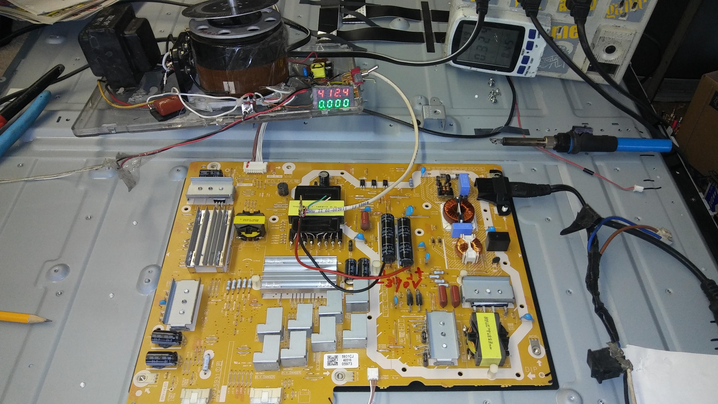

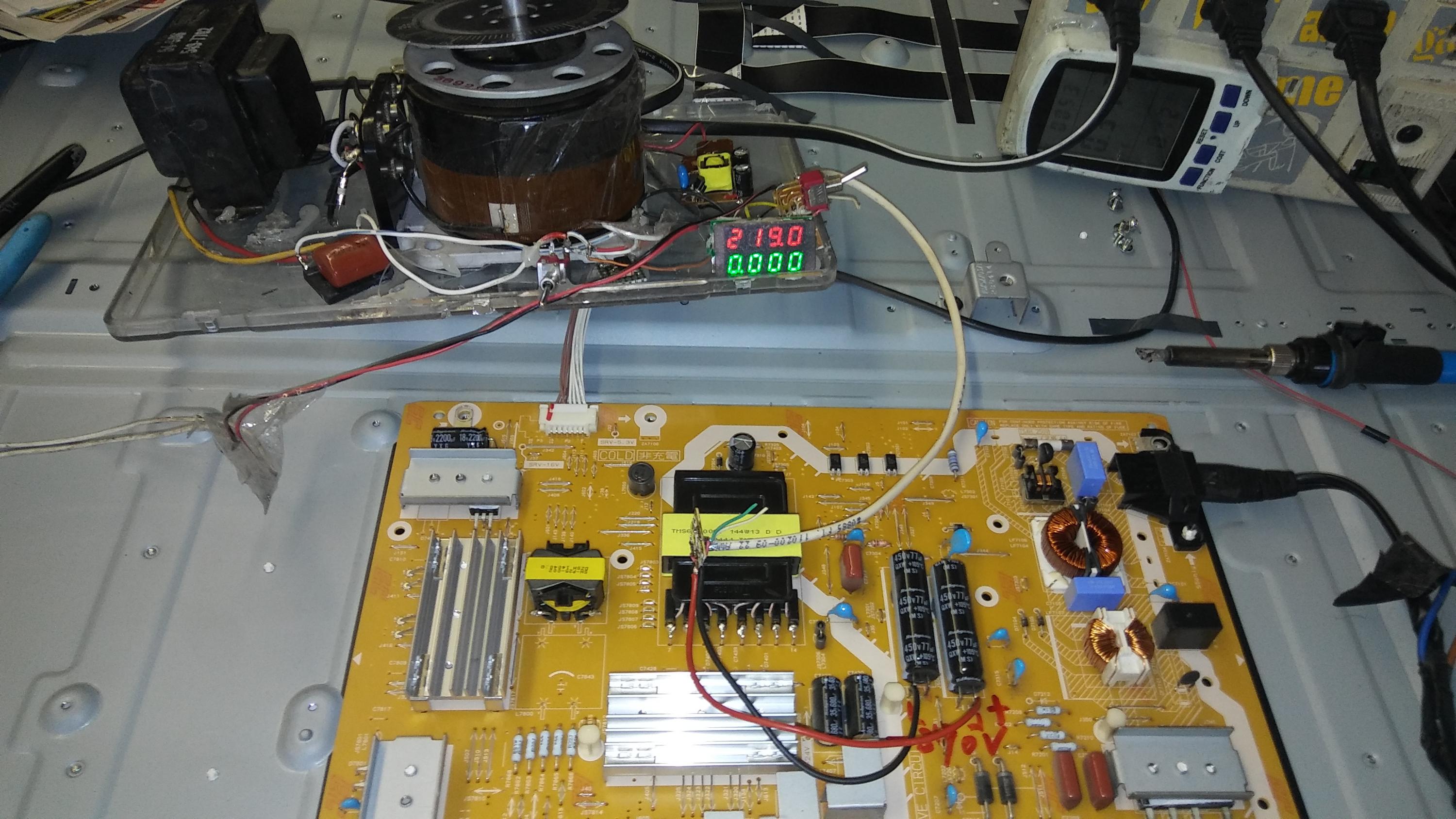

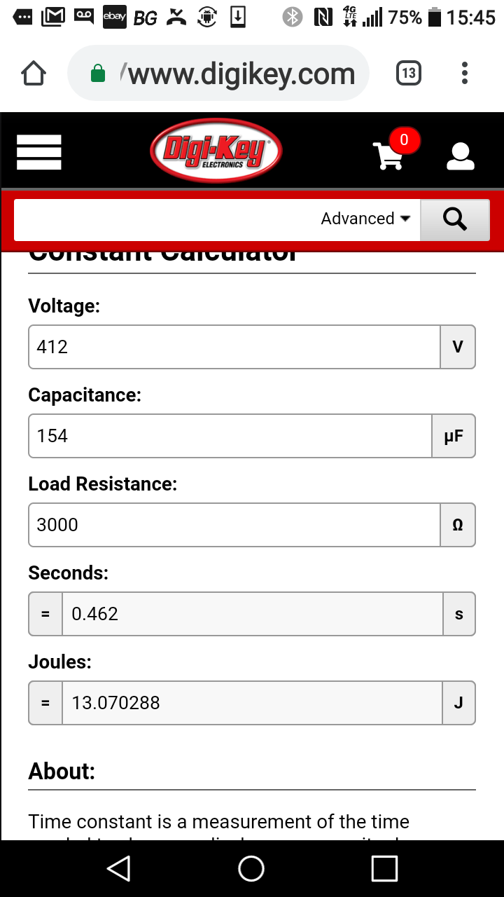

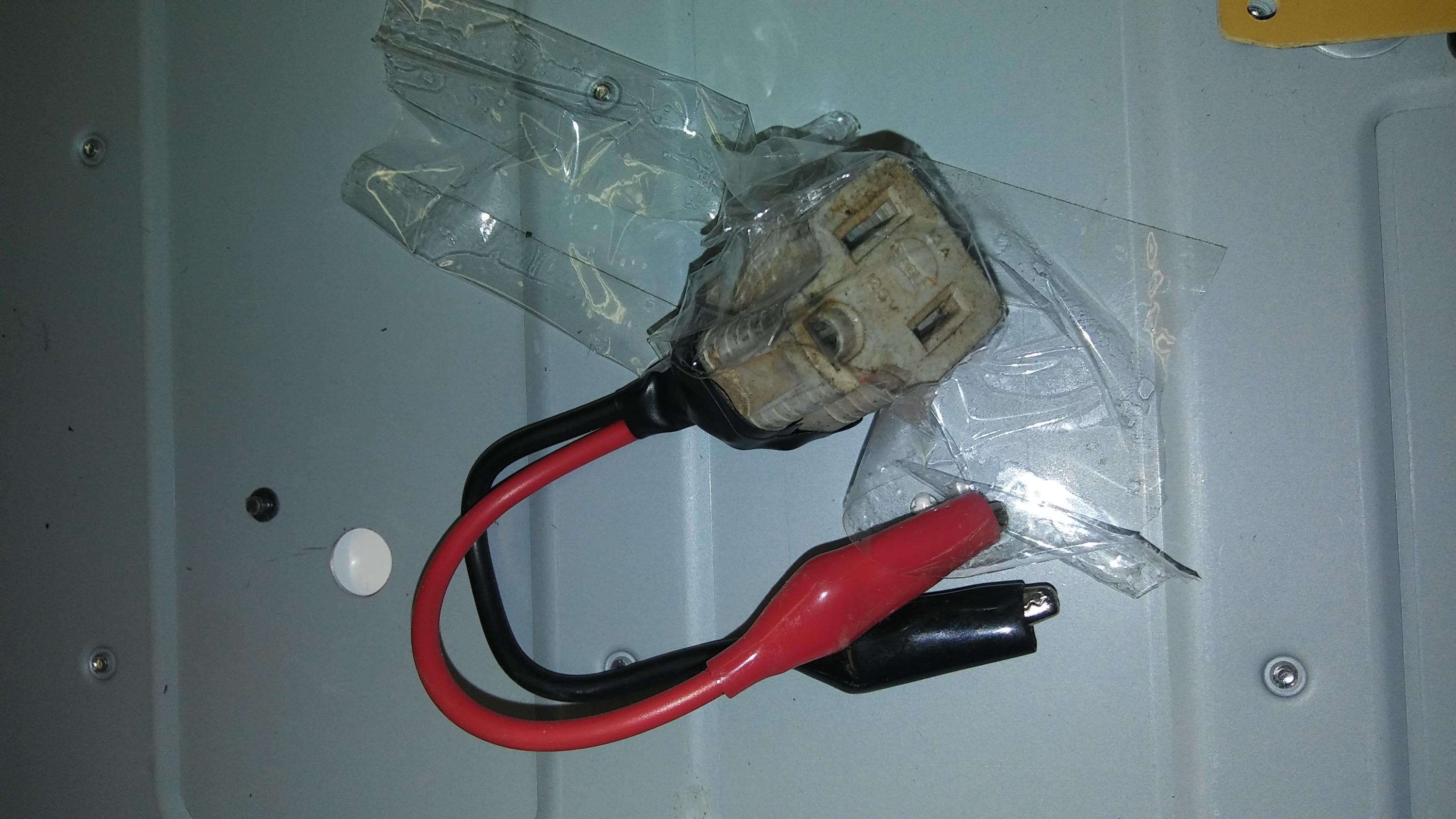

        375*375/3000=46.875W if we use 3K resistor will be P= 46 watt. unfortunately, I do not have this big resistor. I was thinking use PFC circuits as an LED tester circuits.
        Picture 1,2 shows PFC is 412v after 3-minute still has 219v, that's why I was charged.
        Picture 3,4,5,6 shows, I used a soldering iron with the adapter to the capacitor, in one second, it drops down to 12.6v.
        Thank you for saving my life.
          https://www.digikey.com/en/resources...-time-constant
          https://www.electronics-tutorials.ws/rc/rc_1.html
          It will not be constant 46 Watts of power dissipation when you discharge the cap with the resistor. I.E. the cap is 100uf charge up to 375VDC so when you hook up the 3K resistor to the cap, at first time constant the Voltage will drop down to 375v x 0.37 = 138V after 1 TC which is 0.30 second.

            You are right! because it (PFC circuit) has no more power. Maybe it will only need a 1w resistor.
            This PFC has two 77uf capacitors parallel together. The capacitance value will be 154uf. With budm's formula to calculate is 13.07 joules.
            my question is, it did not has a lot of power is that (be discharged)13.07 joules good for my health? Just a little tingling in my hand.

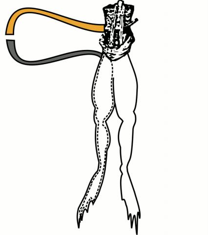

                      For a frog leg, since it's alive, .....N0...it was dead frog legs...
                      In 1780, he discovered that the muscles of dead frogs' legs twitched when struck by an electrical spark.
                      How Luigi Galvani's Frog Leg Experiment Made a Dead Frog Jump & Invented the Battery
                      https://www.youtube.com/watch?v=xG6W8A3JYFA
                      How Volta Invented the First Battery Because He Was Jealous of Galvani's Frog
                      https://www.youtube.com/watch?v=f6wJfx0VYRY

                        I was aware of his experiment: In this case the frog cells are still alive. If you cooked the frog and tried the experiment again, it would not work.

                          • Per Hansson
                            • Jul 2005
                            • 5895
                            • Sweden
                            If you read the post I linked in my previous post above I mentioned two things there.
                            The Fluke SV225 LoZ adapter is pretty nice, it uses a 1k resistor and two 1k PTC's.
                            This way it's protected from large energy dissipation.
                            That said it's very expensive, you can probably buy a Fluke 113 that has 3K input impedance to begin with, but it gives you the idea if you want to make a DIY device...
                            There was also Mr Carlsons capacitor discharger linked in the same post if you want to build something more fancy.
                            However for me the SV225 is nice because it's small so fits my toolbag well but I digress...
