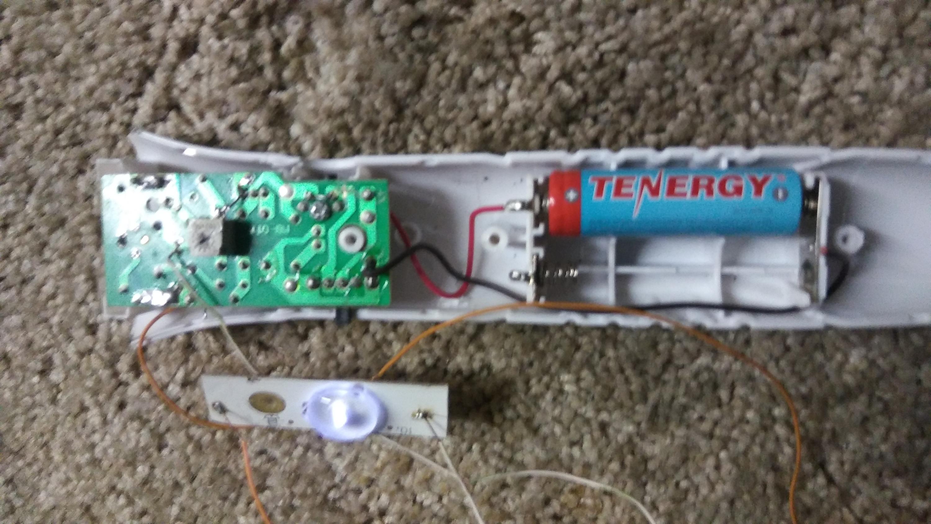

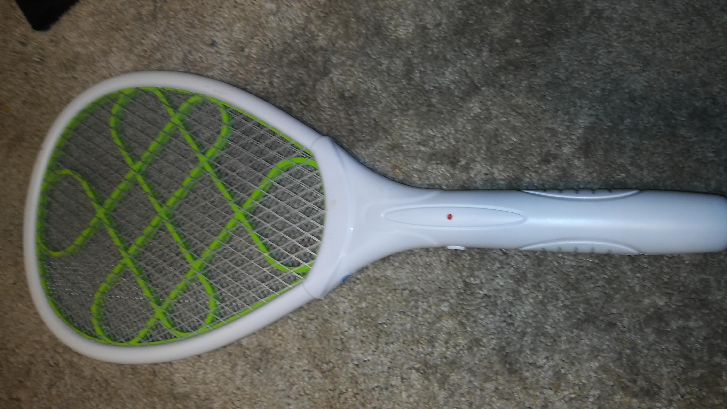

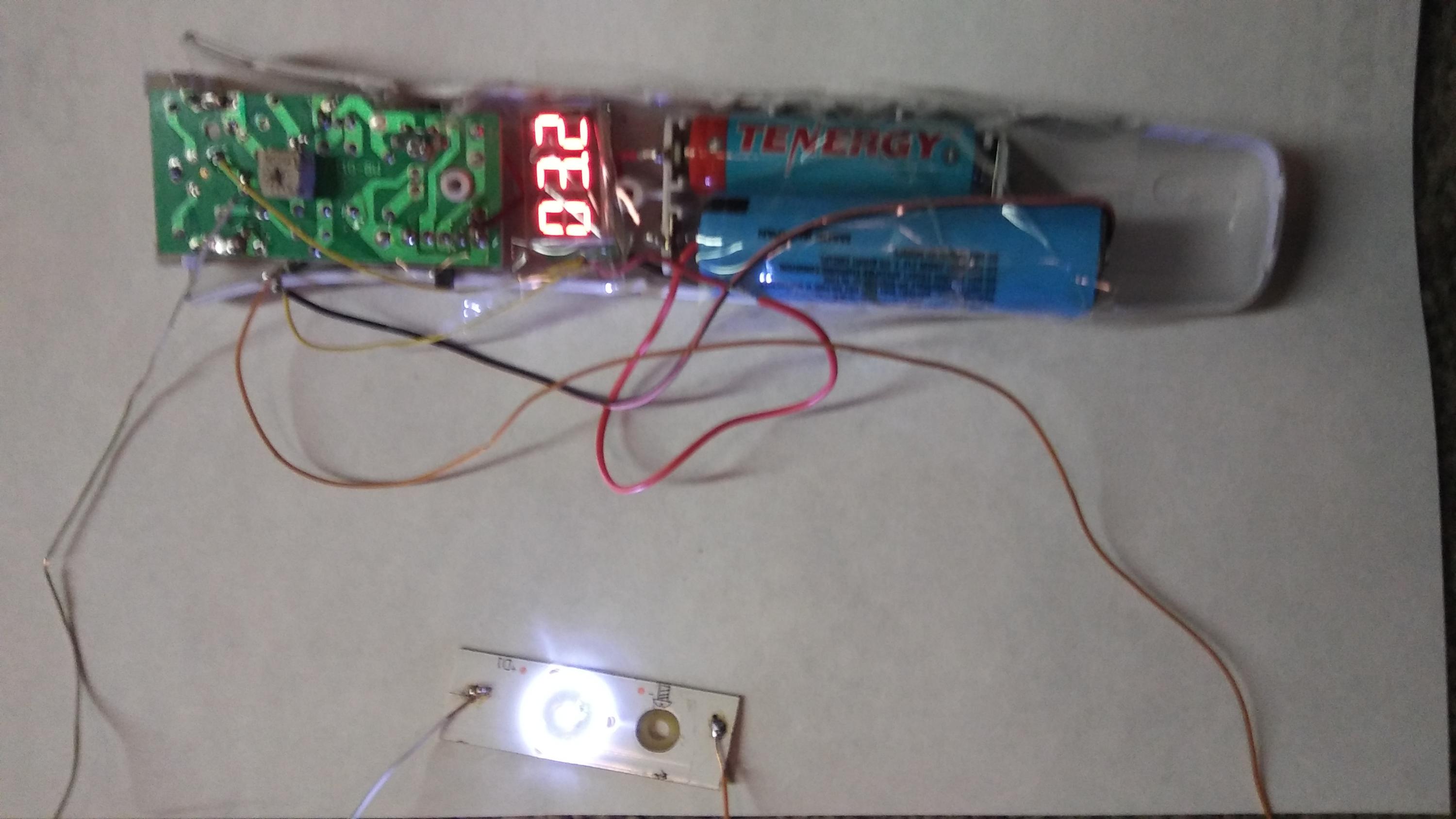

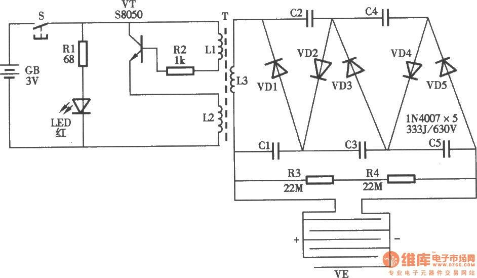

    LED Backlight Tester model A : The world's first battery TV LED Backlight tester.
    LED Backlight Tester is nothing but a high voltage power supply.

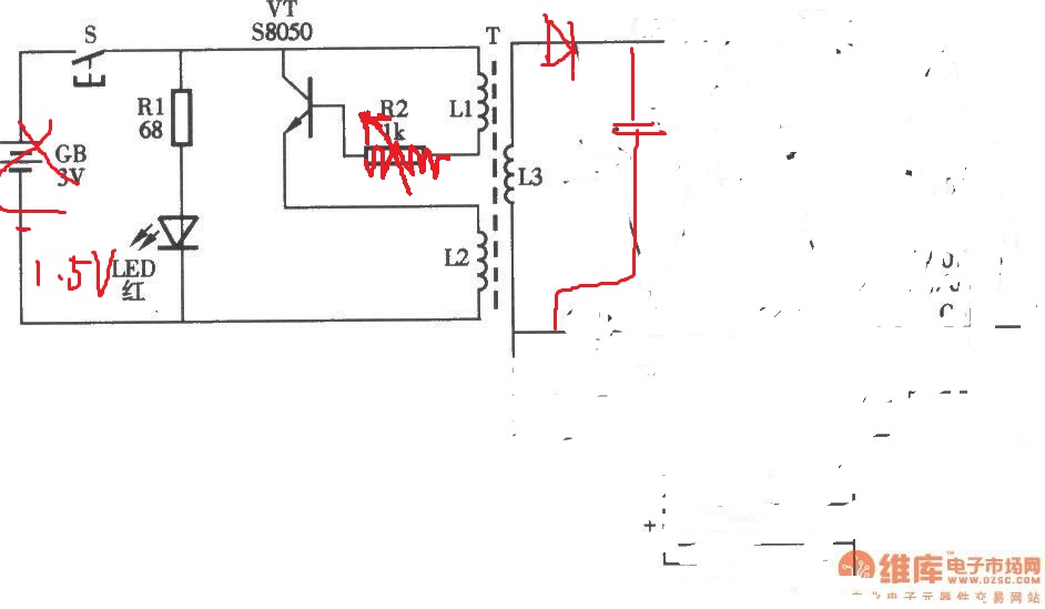

    We are going to make battery LED TV Backlight Tester, basically, circuit is one transistor oscillator to a HV DC to DC Inverter.
    Inside a bug zapper racket / racquet , with schematic.

    If you take out parts from CCFL lamp make your own coil then you can limited output voltage by turns of coil. if you use a bug zapper racket which has about DC 3000v, how can we do it?
    to be continued

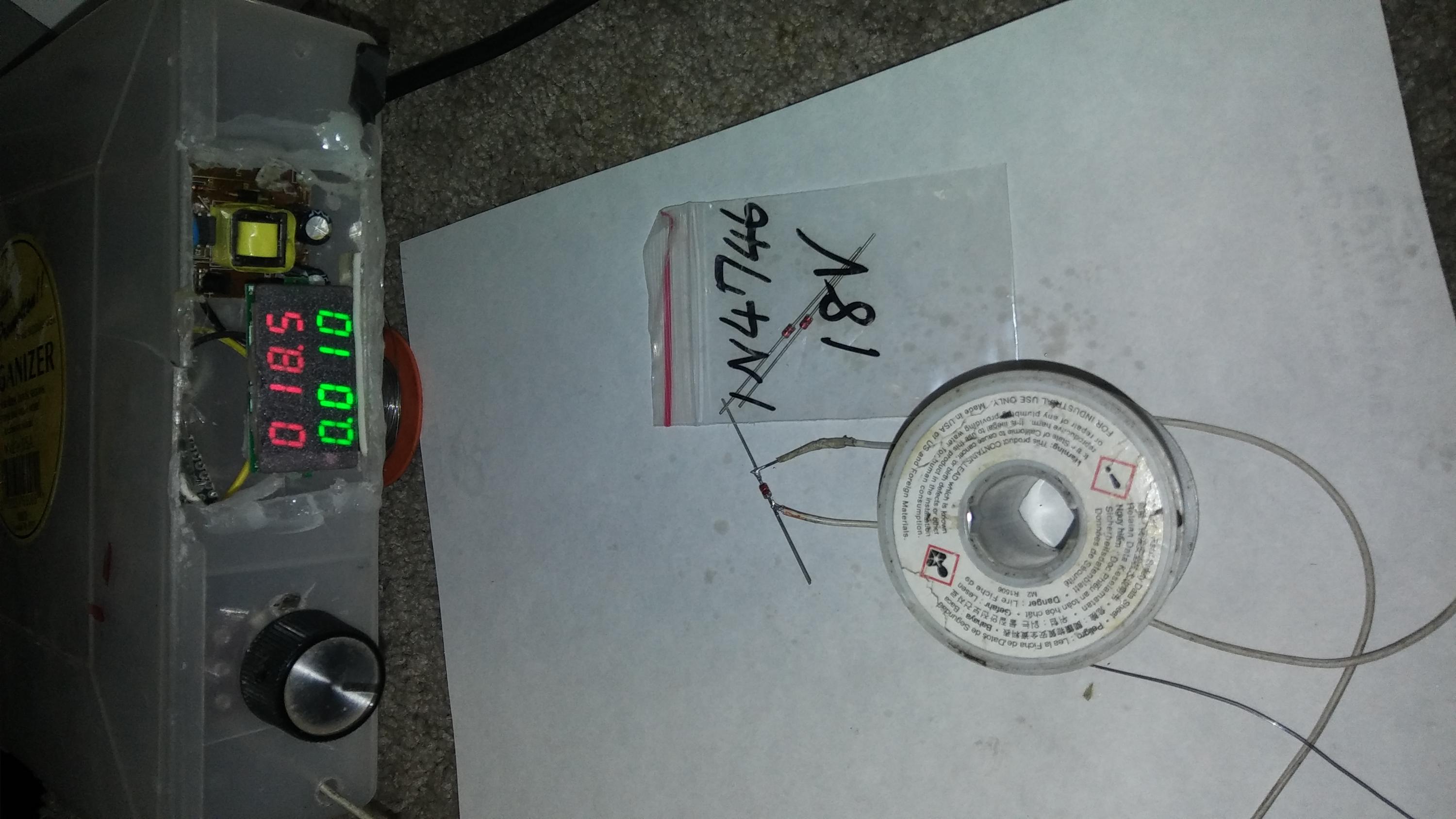

    Re: LED Backlight Tester model A : The world first battery TV led tester

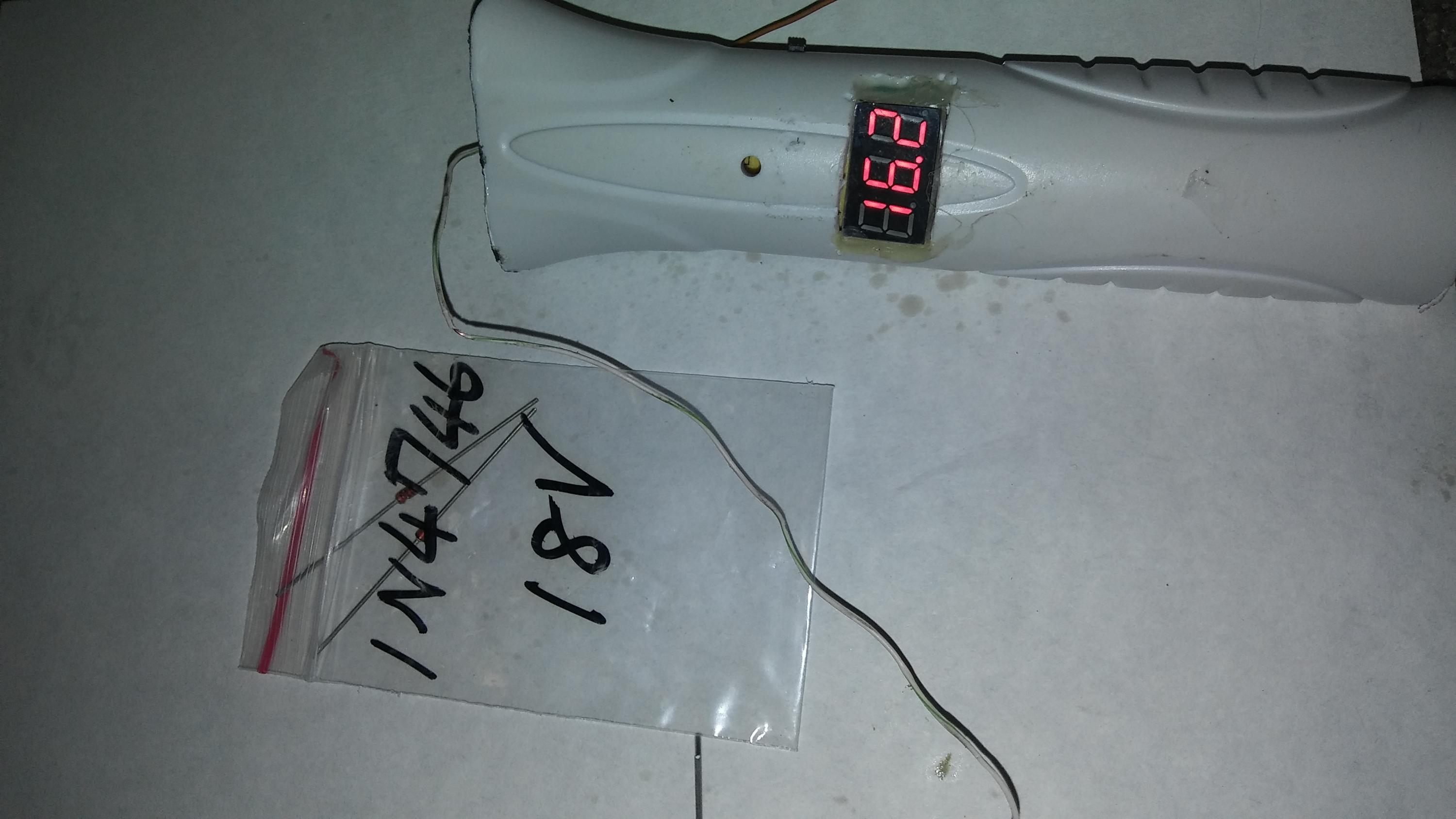

    First step we take out voltage tripler circus and then we low down the voltage to 1.5 volt and we put a potentiometer on the base of the transistor so right now we can adjust the output voltage to 320 volt.
    Now you have the world's first adjustable TV LED backlight tester.
    Next time we gonna put a voltage meter on it....to be continued....

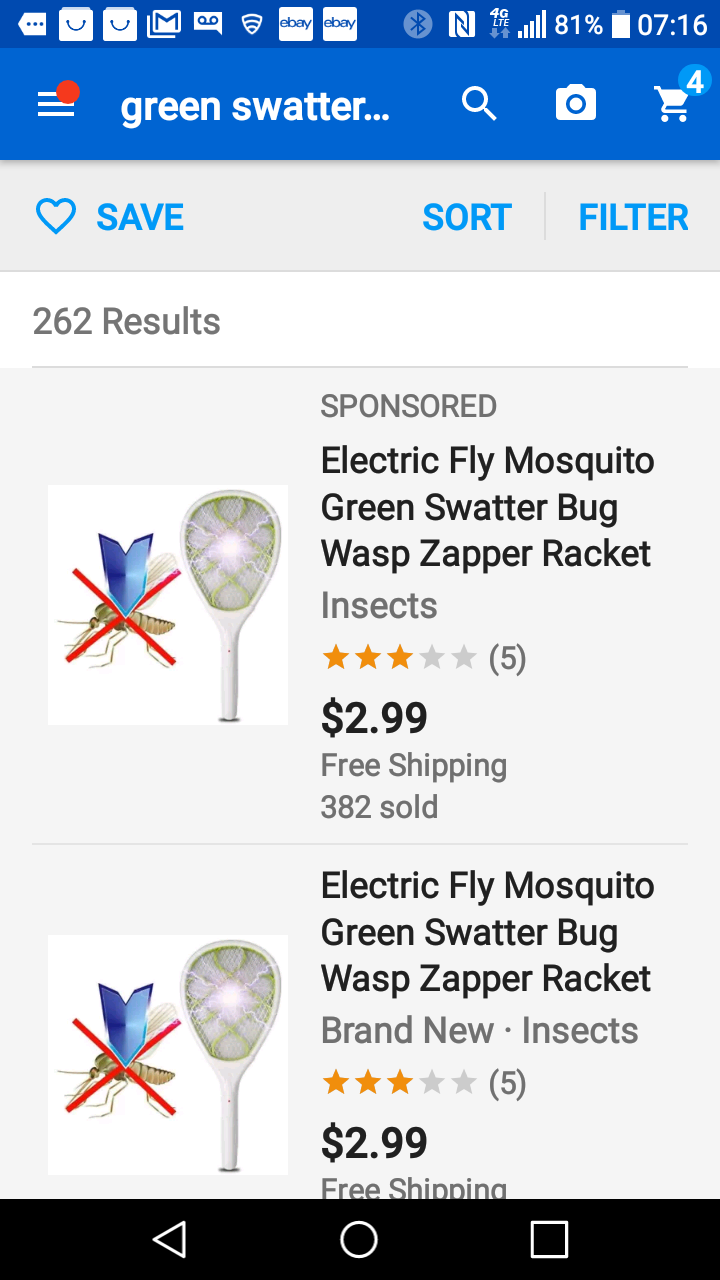

      • 30934
      i need that for something else,
      where do you get the bug zapper things?
      can you show the other side of the pcb?

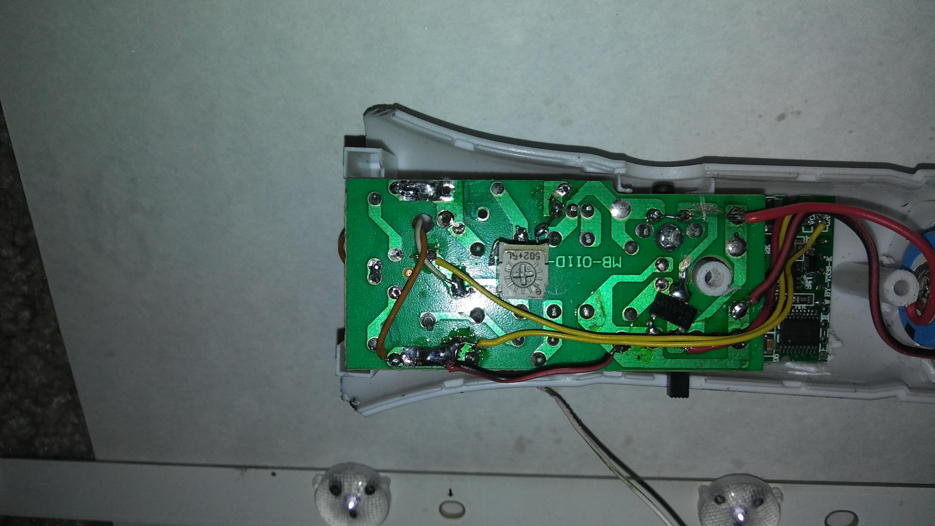

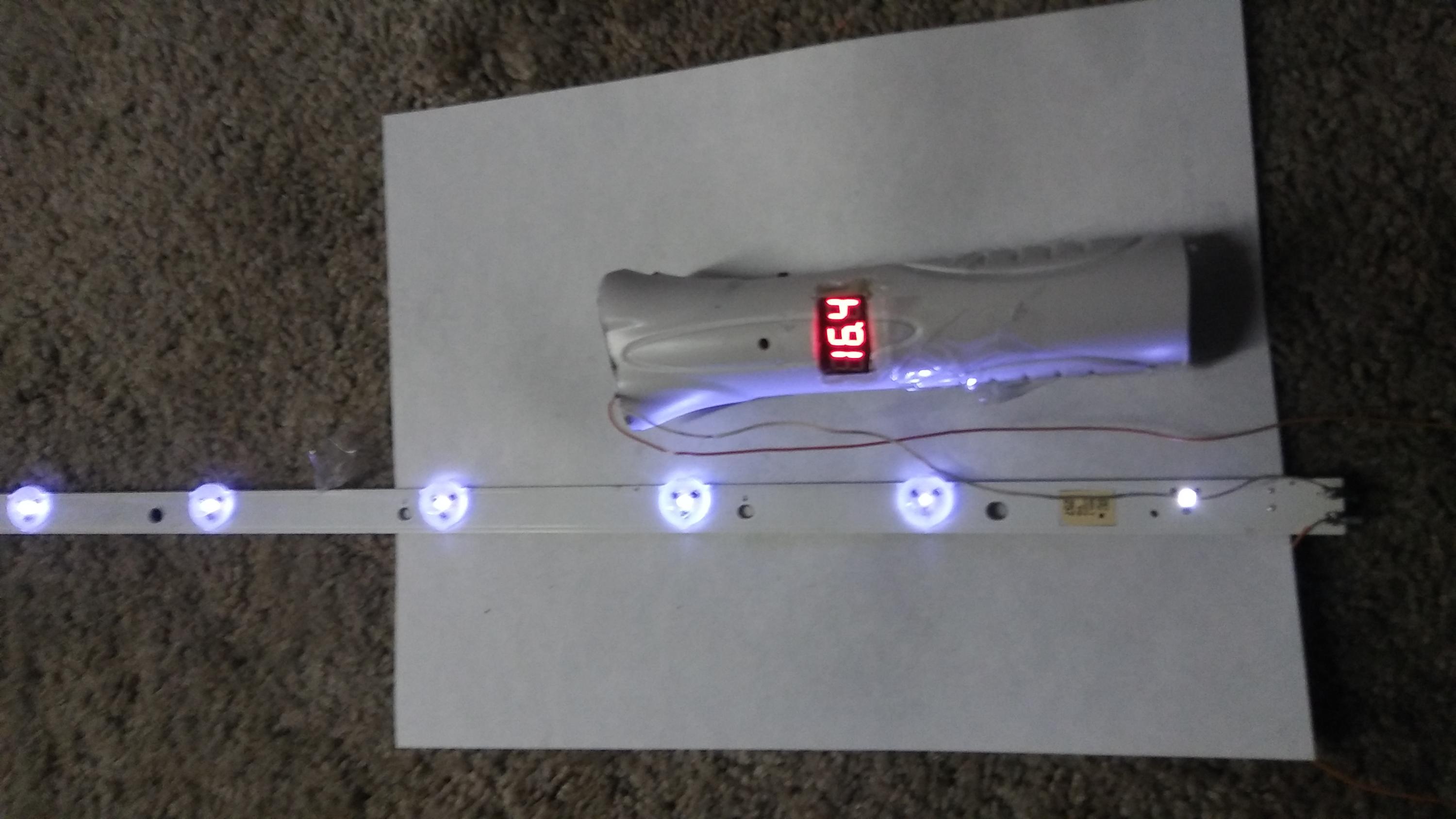

        Come on .....that's put a meter on it. 1.5v AAA battery really can't drive digital meter...so.... what we're going to do is useing 18650 battery. Now we know how much is the voltage LED used.
        Next time we're going to do is use lm1117 1.5 volt to limit just use one 18650 battery.
        You could put A dual voltage meter with the current display now you have the world's first battery powered LED TV backlight tester...... only over here ...........badcaps.net
        If you think this is helpfully for you.
        Please consider a donation at the bottom of this page. Thank you.

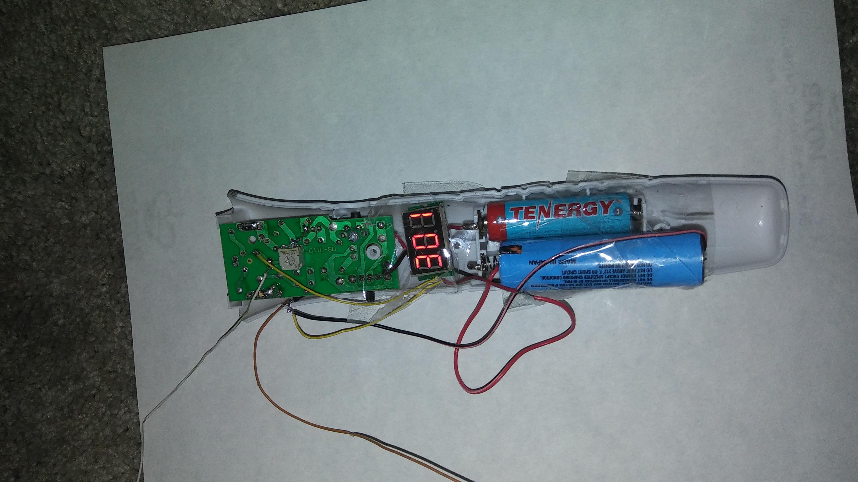

        • capwizard
          • Jun 2016
          • 1991

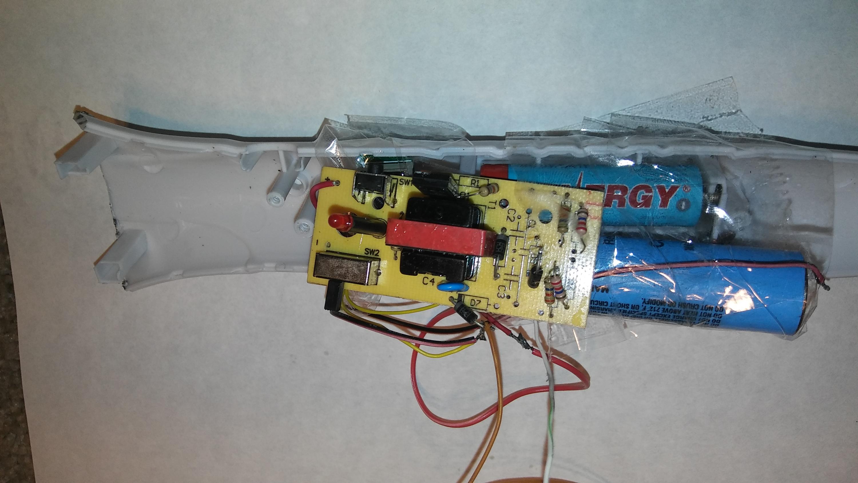

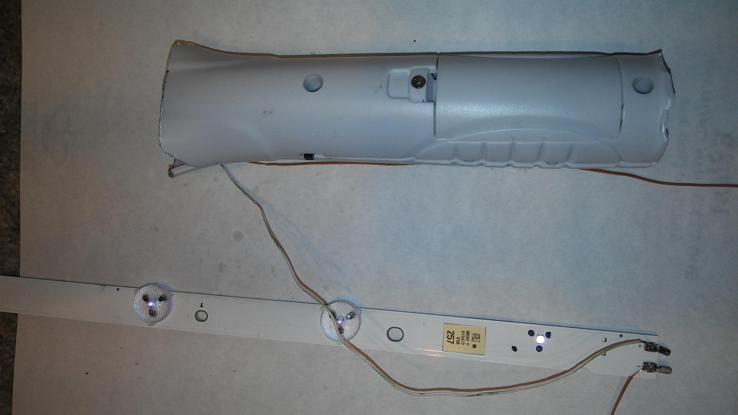

          Ebay....here you are.
          Stj:.....i need that for something else,....are you gonna make a ozone generator?
          Picture 2.... I'm too lazy to take parts out I just leave one leg up.

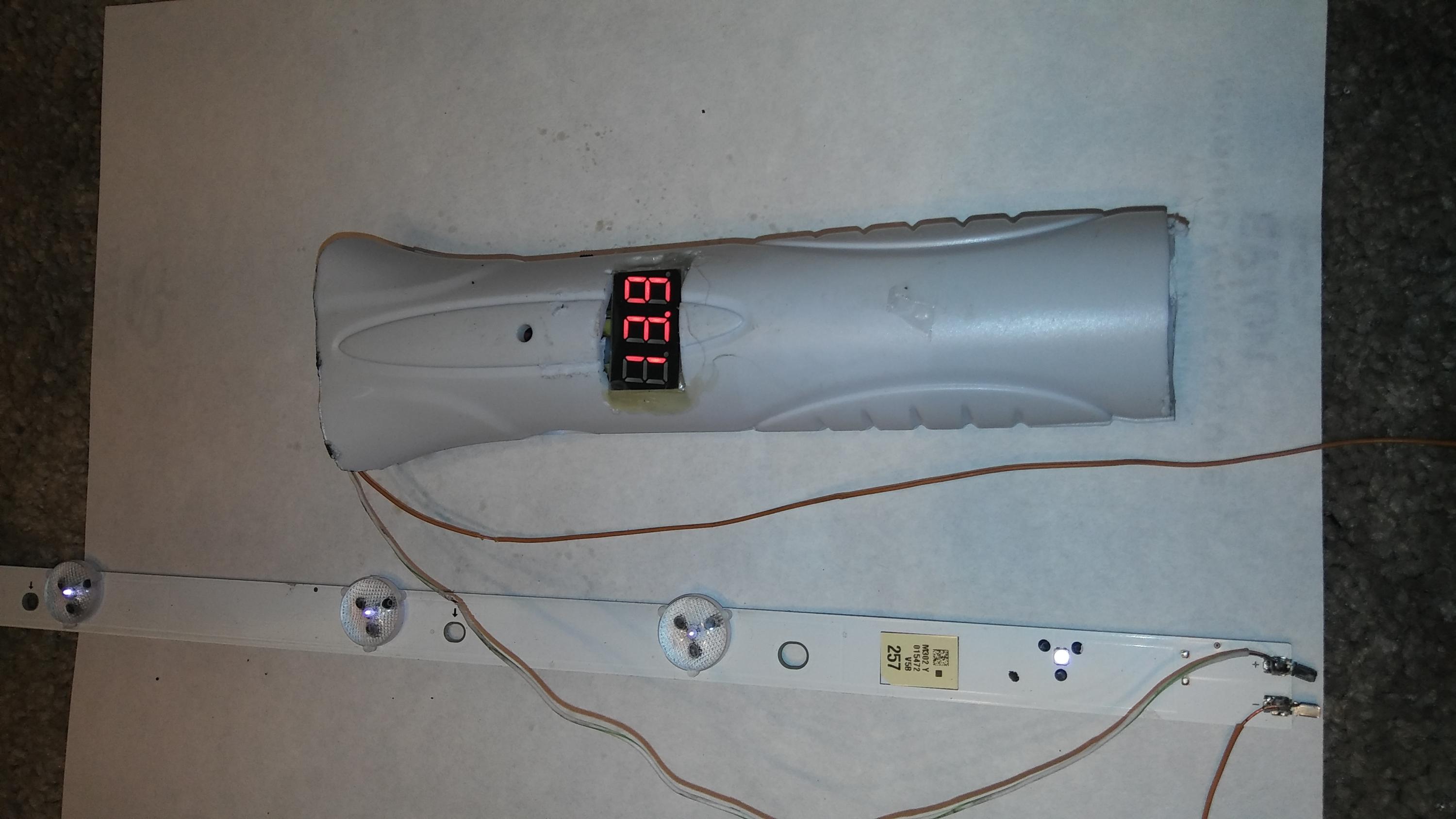

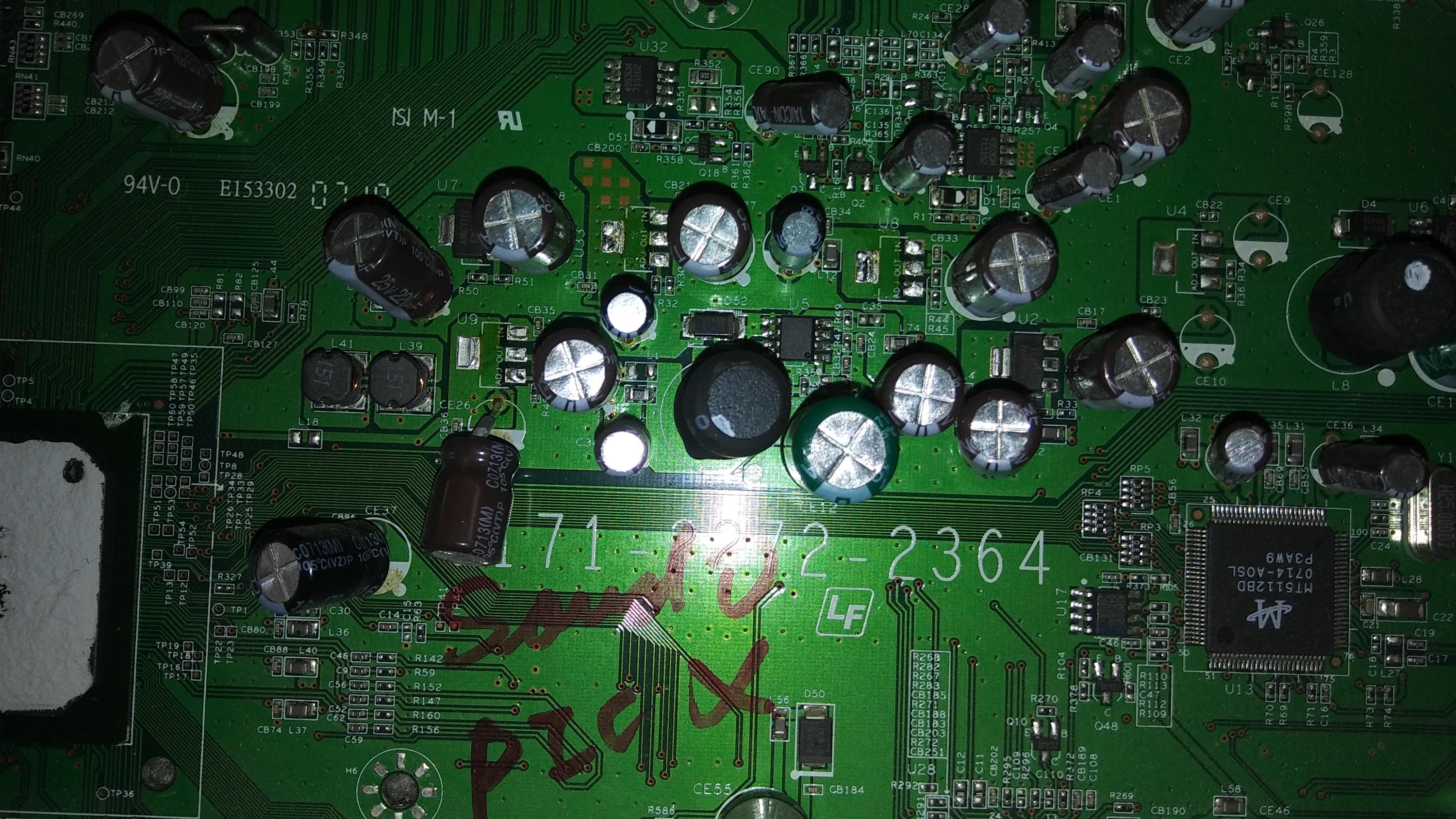

          • capwizard
            • Jun 2016
            • 1991

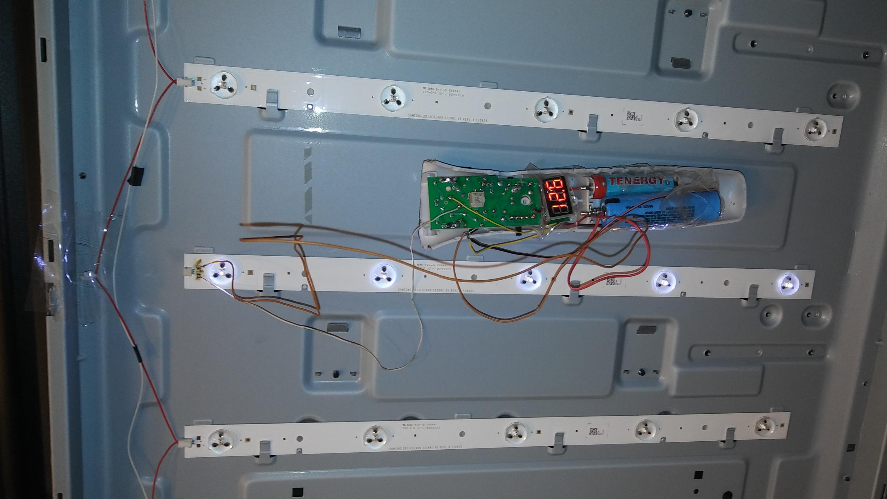

            This is a very good holiday small DIY project. Today we want to commemorate him. Martin Luther King. So I'm going to name this TV LED backlight tester the Martin tv led tester model A.
            I found one lm1117 1.5v over the junk vizio main board. Soldered inside. that's it....to limit use only one battery.
            I put cover and the screws back the finished product is this.....picture 5 and 6.
            Fin........
              • 30934
              no ozone generator,
              i need a very compact 200vdc psu that runs from 9v or less for my zener diode tester project

                  Because I change operating voltage to 1.5 volt for safety reason if you use original voltsge 3 volt. It will have enough current to testes zener diode or Tr breakdown voltage.
                  See the picture because it's not enough current. I think zener diode test need at least 10 mA.

                    my local pound shop sells these zapper things dont be tempted too touch it as it bloody hurts lol my nephew got me with one on my arm.

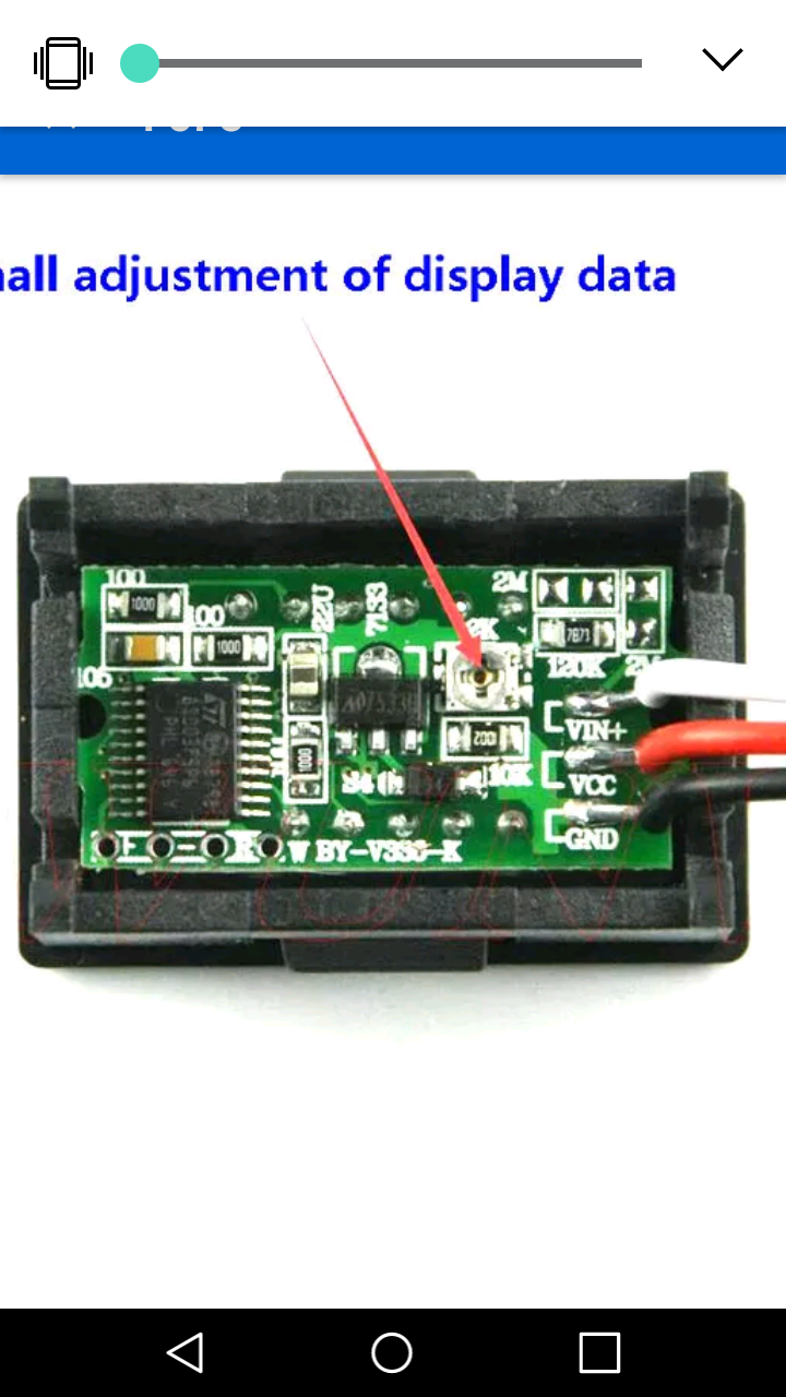

                        • capwizard
                          • Jun 2016
                          • 1991
                          no ozone generator,

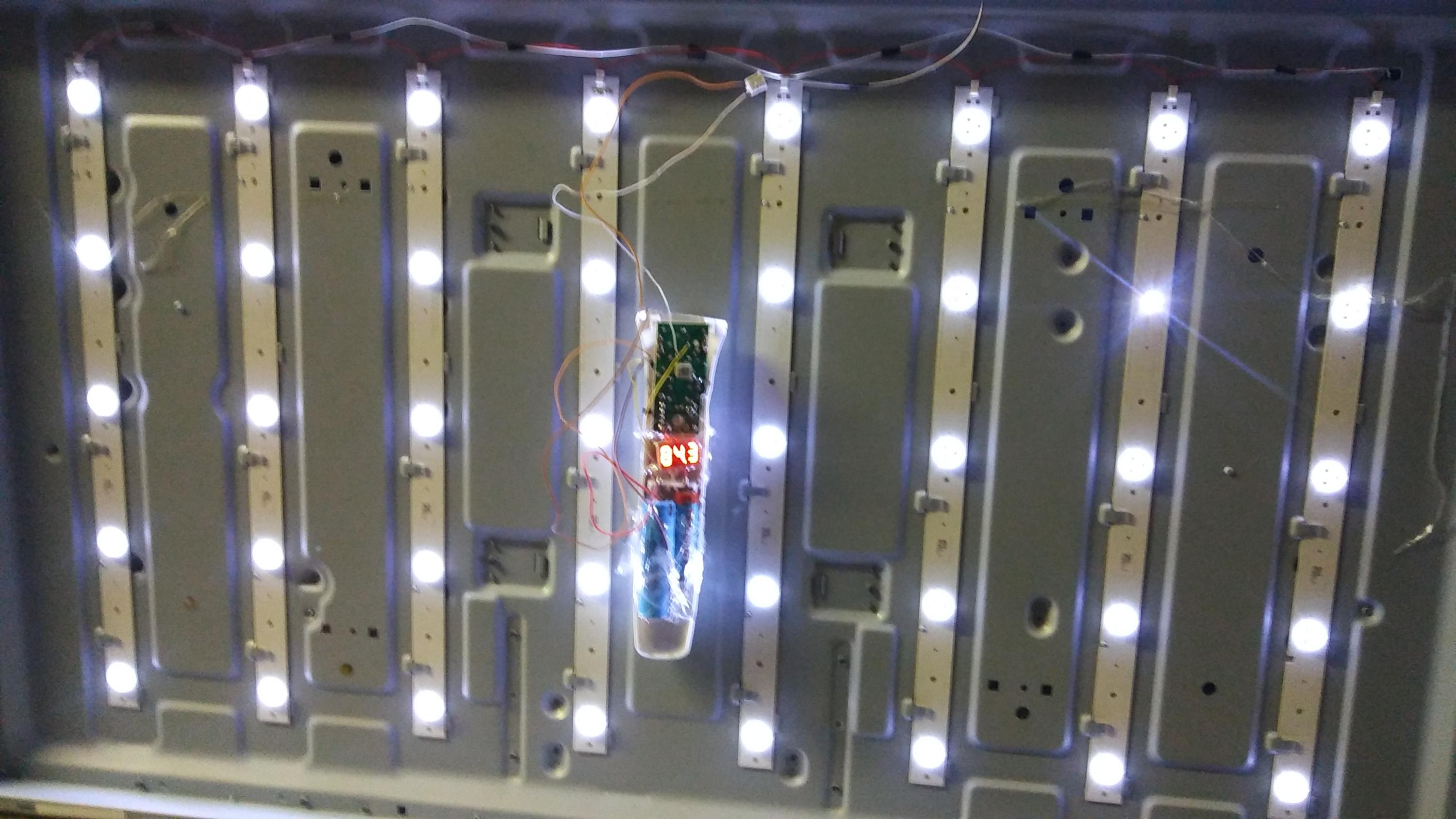

                          Two way to solve this problem one is we can change the meter from 16.1 to 18 .0 volt. Picture 1
                          the other way is use my next project Valentine TV LED backlight CC CV tester model B. Tested current at 10 mA.
                          I am working on now. Picture 2

                            Two way to solve this problem. one is we can change the meter from 16.1 to 18 .0 volt. Picture 1

                              i think a zener can be tested at <5ma
                              the highest voltage zener i come across is 145v,
                              the meter i will use (DT830) has a 200v scale.

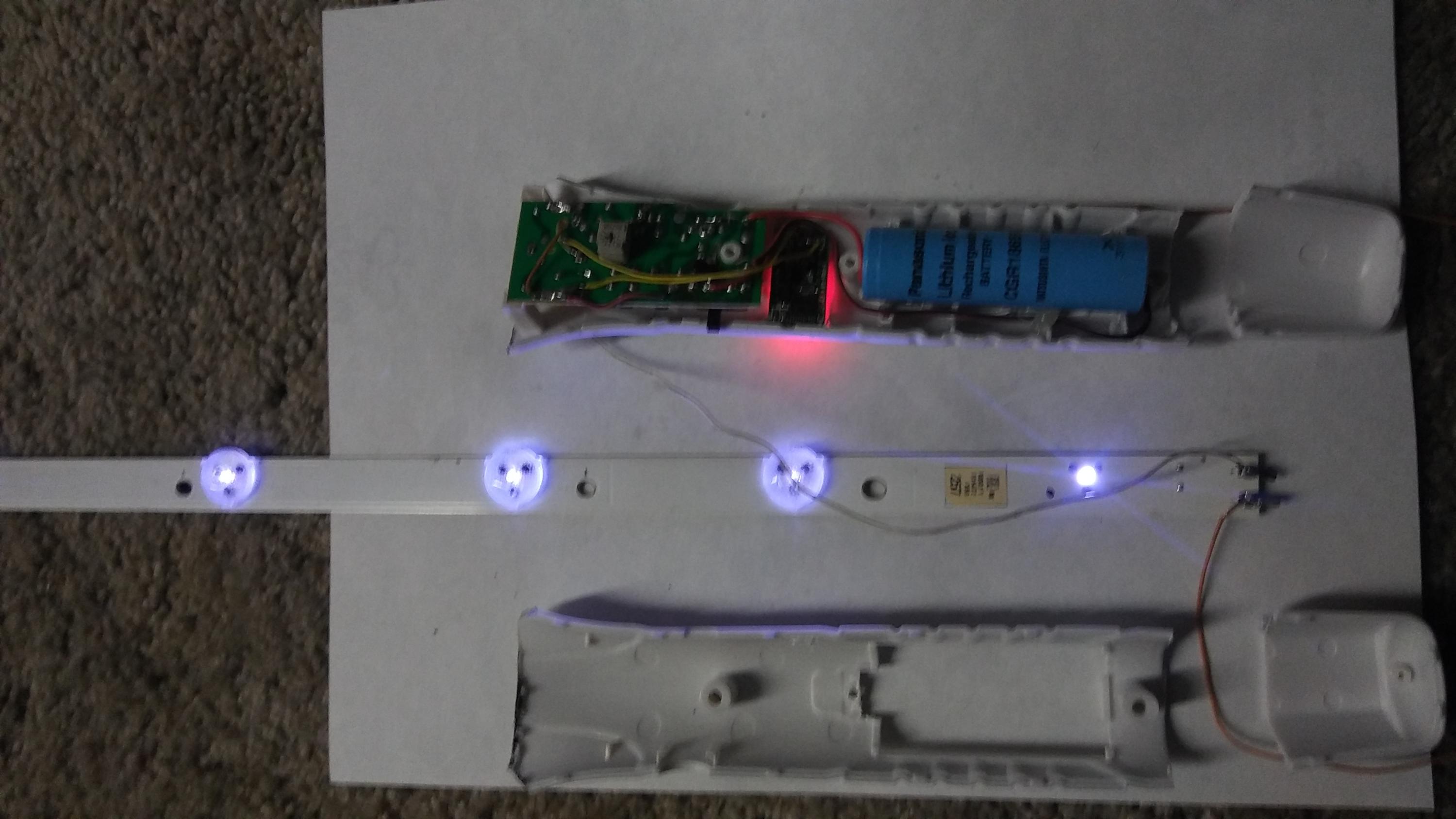

                                • capwizard
                                  • Jun 2016
                                  • 1991

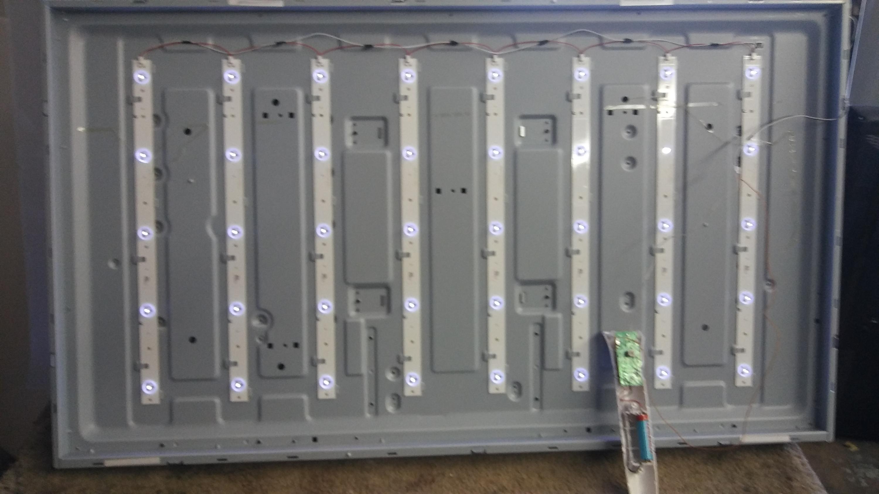

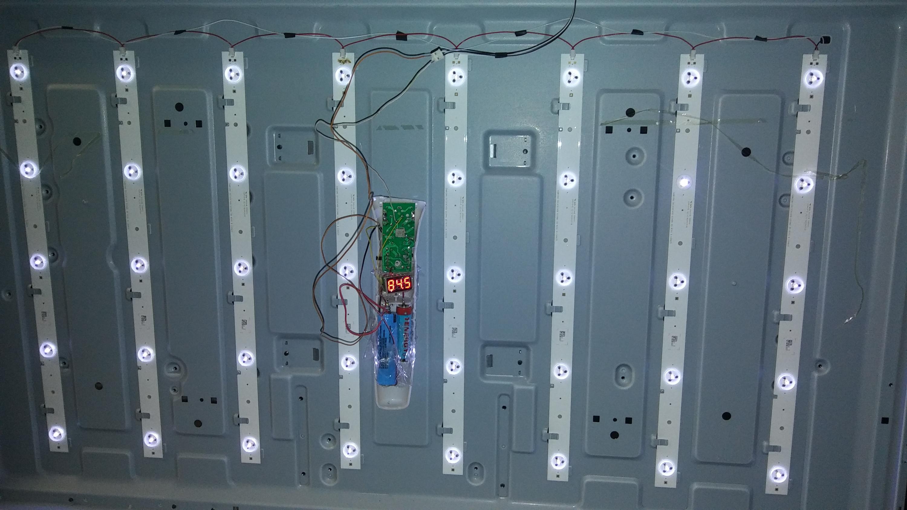

                                  okay that's put Martin Model A to work.
                                  60 inch Samsung TV has screen backlight blinking problem I thought was the power supply problem so I swapped them is still same thing happened.
                                  I have had a walking panel so I can compare the difference of both tv panels for you guys.
                                  The working Panel is
                                  the blinking panel the voltage is
                                  divided by 3.2 you know how many LEDs are not working
                                  actually the the customer brought this TV From Craigslist about $400. I felt sorry for them but I knew this gonna be a tough job. With so many LEDs are not working. so I pretty firm on my price.

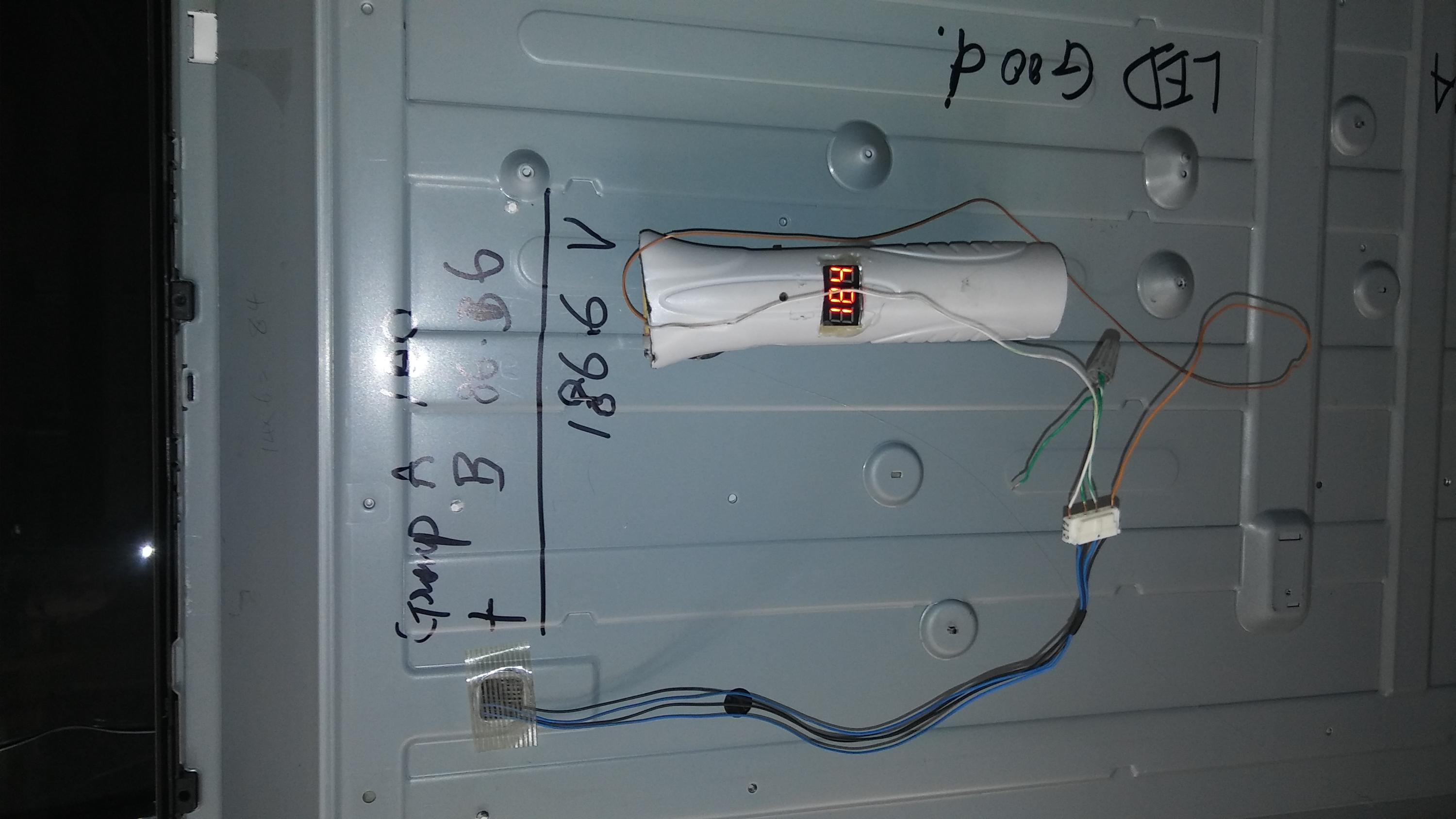

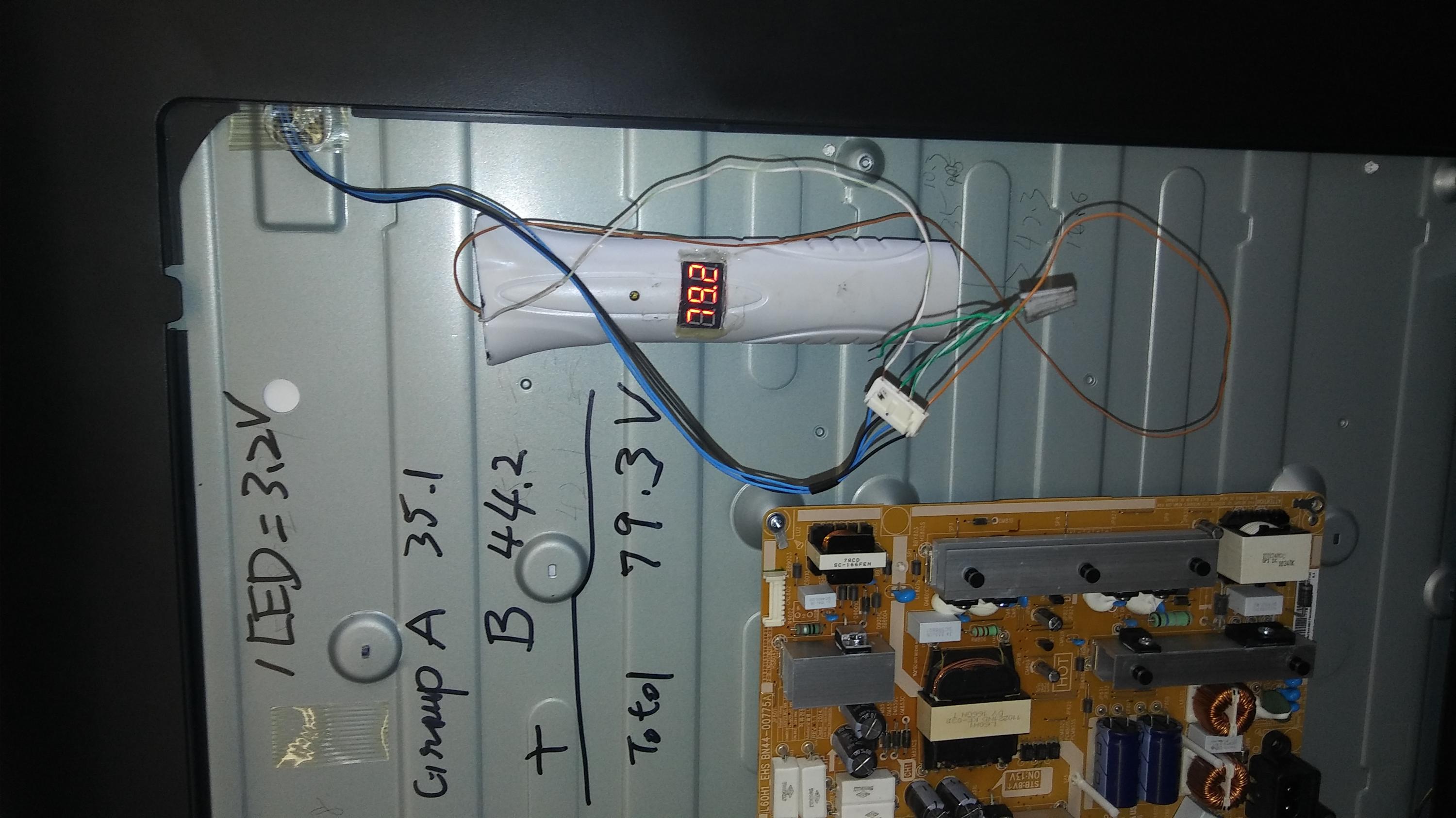

                                    60" Samsung TV has screen backlight blinking problem I thought was the power supply problem so I swapped them. Tv still has same problem.
                                    I have a walking panel so I can compare the difference of both tv panels for you guys.
                                    The working Panel is 184v
                                    the blinking panel the voltage is 79.2 that's why caused the overcurrent protection from power Supply.
                                    184-79.2 divided by 3.2 you know 32.75 LEDs are not working

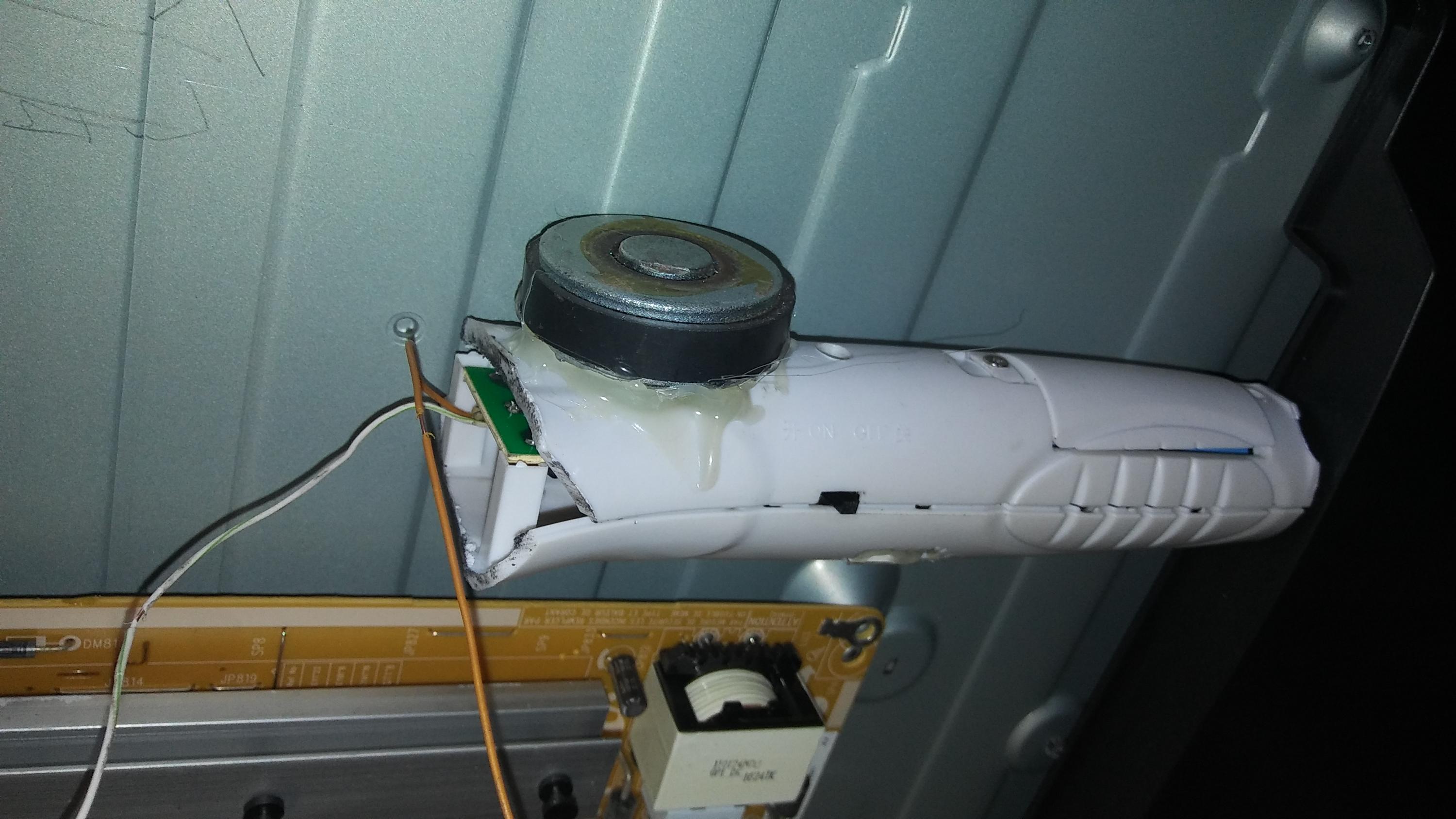

                                    Ps... I glued a magnetic from speaker and Martin Model A works better.
                                    I double post again.
                                      You will get Vf of around 3 ~ 3.2V if you drive the LED at the rated current, but since you only driving with < 30mA then the Vf will be around 2.8V.
                                      For example look at the Vf VS If graph on page 10.
                                      Low current LED tester is good to certain point, bad LED may light up OK at low current but when you drive it at working that is when bad LED will show bad, I.E. blinking on and off, same if you have bad connectors on the LED strips.
                                      "The working Panel is 184v" at that Voltage, do you see the backlights on?
                                      Is the LCD panel model # CY-DF600CGSV2H (84 LED's)?
                                      • capwizard
                                        • Jun 2016
                                        • 1991
                                        yes, its light was very dim. 84*3.3=277.6v and 184v These two have great differences!
                                        is the LCD panel model # CY-DF600CGSV2H (84 LED's)?
                                        yes 84leds 14 leds x 6 strips leds but panel no. a little bit different, I will let you know tomorrow.
                                        I have been thinking about this all day, because the Martin LED tester test one Samsung led result is 3.2v. is it because of the Martin LED tester use half-wave rectification?
