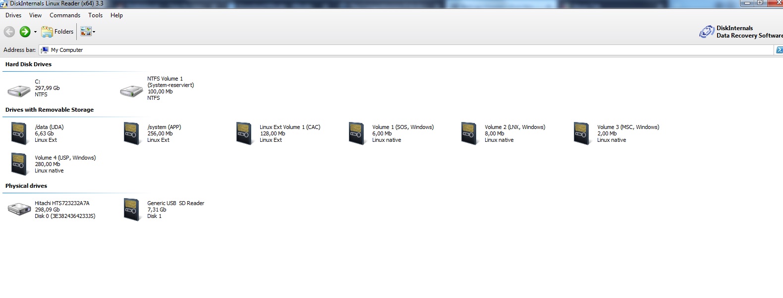

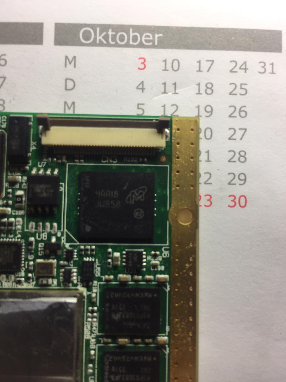

    i have a problem with a device wich is not starting --> issue a damage on the Emmc 7 GB Micron flash. (see in pic 1)

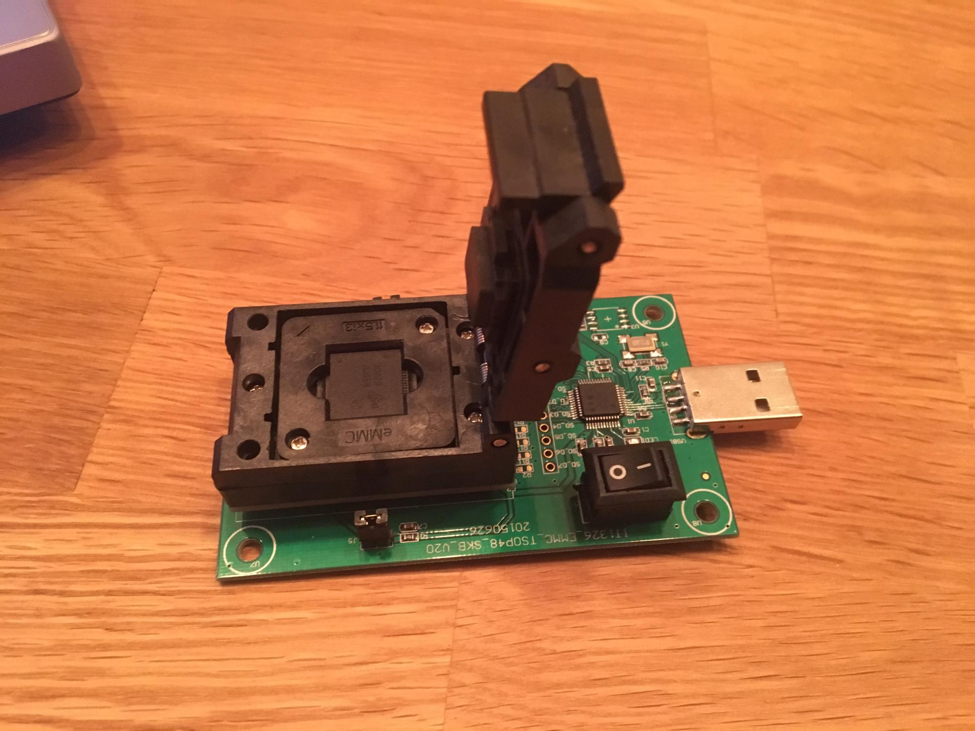

    i have desolderd a healthy Emmc and the plan is to put in into my progamming device i try to make a Image of the whole Software on BGA.
    (see on pic2)
    Afterwards i want to burn a new EMMC Bga to resolder it on the device.

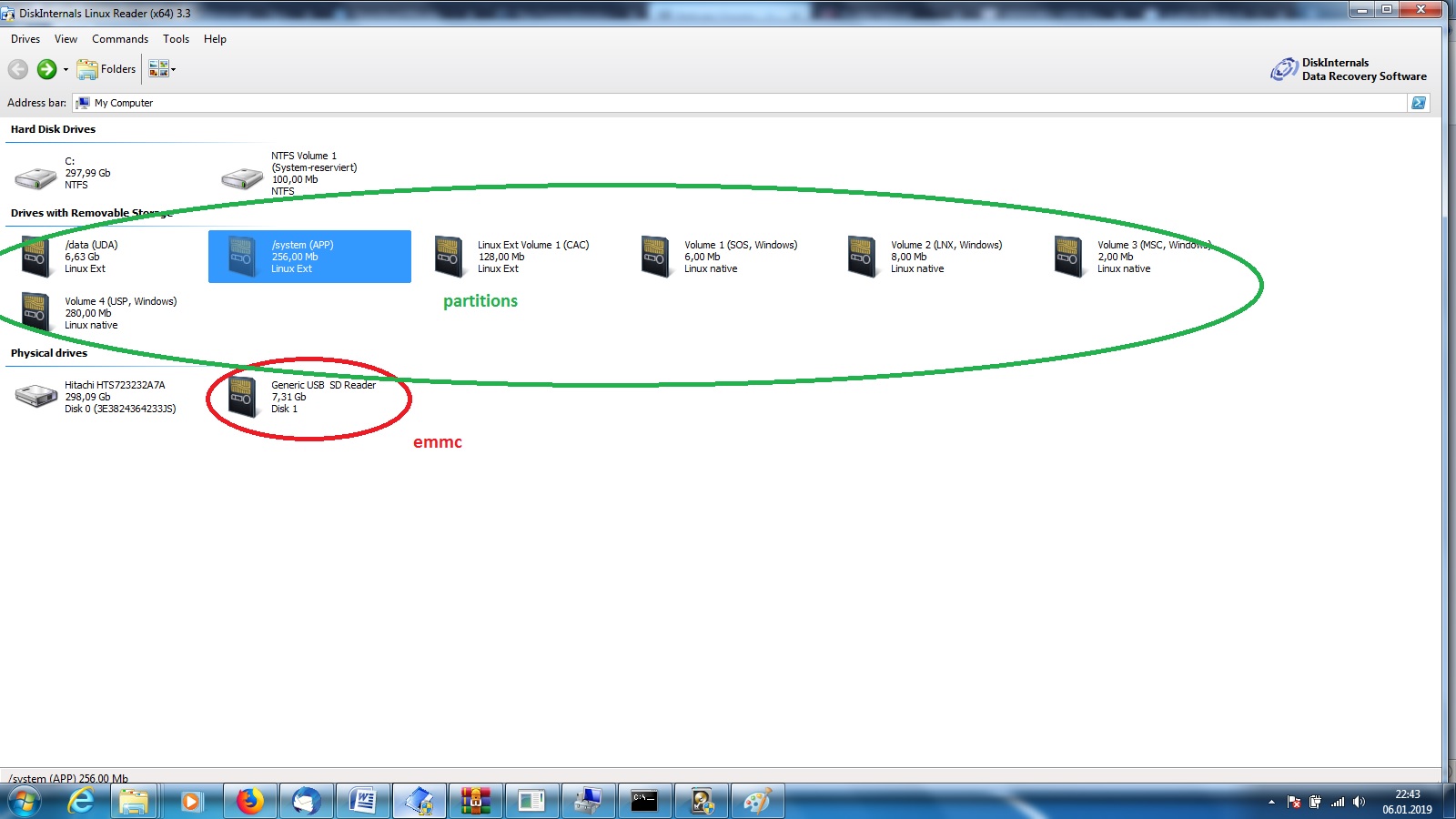

    I can read the media inside the healthy Emmc with linux reader software for win7 called diskinternals (see on pic 3) but even when i try to make an image with HDCLONE oder each other programm it stucks and the process cant finish.
    Somebody know something about the reason or another software which is able to download an image of that Emmc ??
    Thanks for help....

          Maybee yes but why it does not work ? isnt it possible to image the whole emmc incl. bootfiles ect....??? it is also possible to make a img from a hdd (with windows)
          the emmc have 7 partions with android (linux) operating system but also a windows partion as u can see in the picture.
