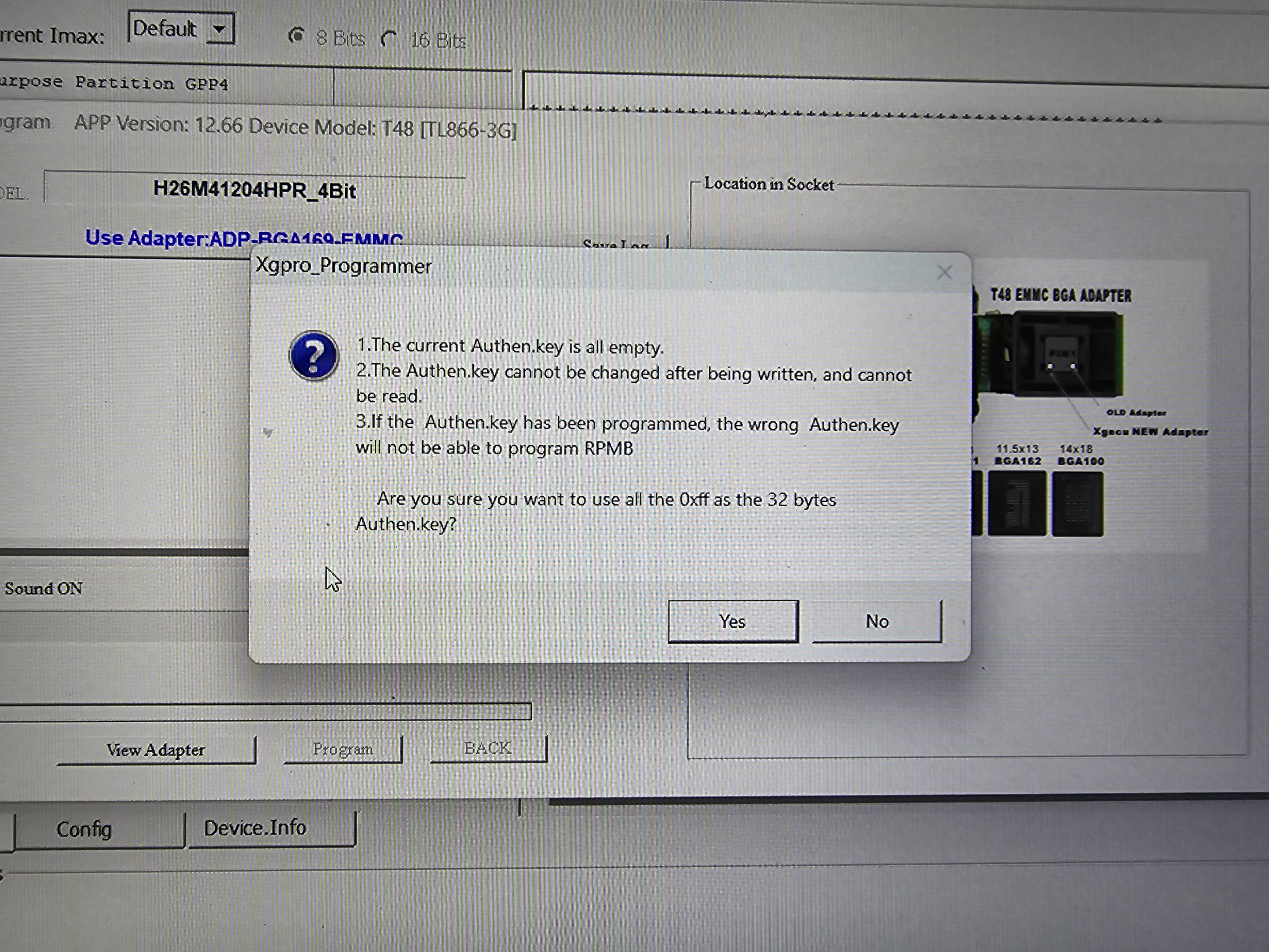

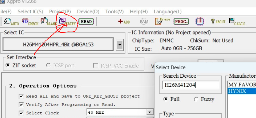

    I am extremely new to programming and dipping into this. I picked up a XGECU T48 Programmer and have the correct socket for EMMC.
    I took the EMMC off a working main board with no problems and threw it into the programmer. I click analysis IC and it gives me a report (attached) of the current EMMC. Model H26M41204HPR
    1) I manually found this chip(above model number) in the select IC section of the XGPRO 12.xx programmer software and it had a option for 4 bit and 1 bit. I chose 4... is this correct?
    2) In the options section point number 2 operation says "30 mhz, vcc 3.3 etc etc" also point 2 reading has boxes checked all along down 3/4 etc. Do I need to click or unclick any of these defaults when clicking read (to save file to computer so that I can copy it to another EMMC for future board fixing)
    3) Does anyone just have the EMMC file for a hisense 244186 main board? its like 8 gigs
    4) When clicking program it says current authenkey is empty etc (see pic at end). Is there something here I need to do or just hit okay? Do I need this key or it ain't gonna work?
    5) I am like completely new at this, absolutely nothing is familiar but I have been messing around with it a bit so bear with me. When I program the new chip, I just select the biggest file and click program and it should just work correct?
    thanks for answers. I just want to get it right because I have tried copying the old EMMC to a new chip and when I installed it the TV showed the android logo then shut off. The original symptom of the copied file emmc was that the TV would turn on as normal but everything was laggy and skipping etc. I took off old EMMC and it said urgent on analysis.. either way. I didnt know if this software would be corrupt and would then corrupt a new emmc that I put onto the board... so now I have a legit EMMC that shows zero life used and I now need to copy the file and safe for future uses...
    any other questions ask.

      If the original eMMC has already died, then it is better to read the dump from it, not unsolder it from the board, but solder the wiring and read it using the ISP; it is better in 1-bit mode (when heated, dismantled), it may finally die and you will no longer be able to read anything. After reading the eMMC, you need to check the saved dump, click on “verification” and it should pass the check...

        I'm not sure what you mean. Why would I suspect the EMMC? I watched a lot of nicks videos and this EMMC fails a lot.. so that's why.
        lotas thx. Do I have to change the mhz frequency when reading or writing back to the chip? Says 30mhz as standard.
        Also what's with the authen key? What's that mean, do I just click yes or do I need that data somehow

          I don't have such a programmer; I usually change (lower) the frequency when the eMMC is poorly read. The RPMB section in the firmware is usually protected by a key; you will never recognize it, only the native processor knows it.
          The main thing for you is to make a good copy, sometimes you need the native partitions BOOT1, BOOT2 (without them the TV will not start), and only the USER partition changes.
