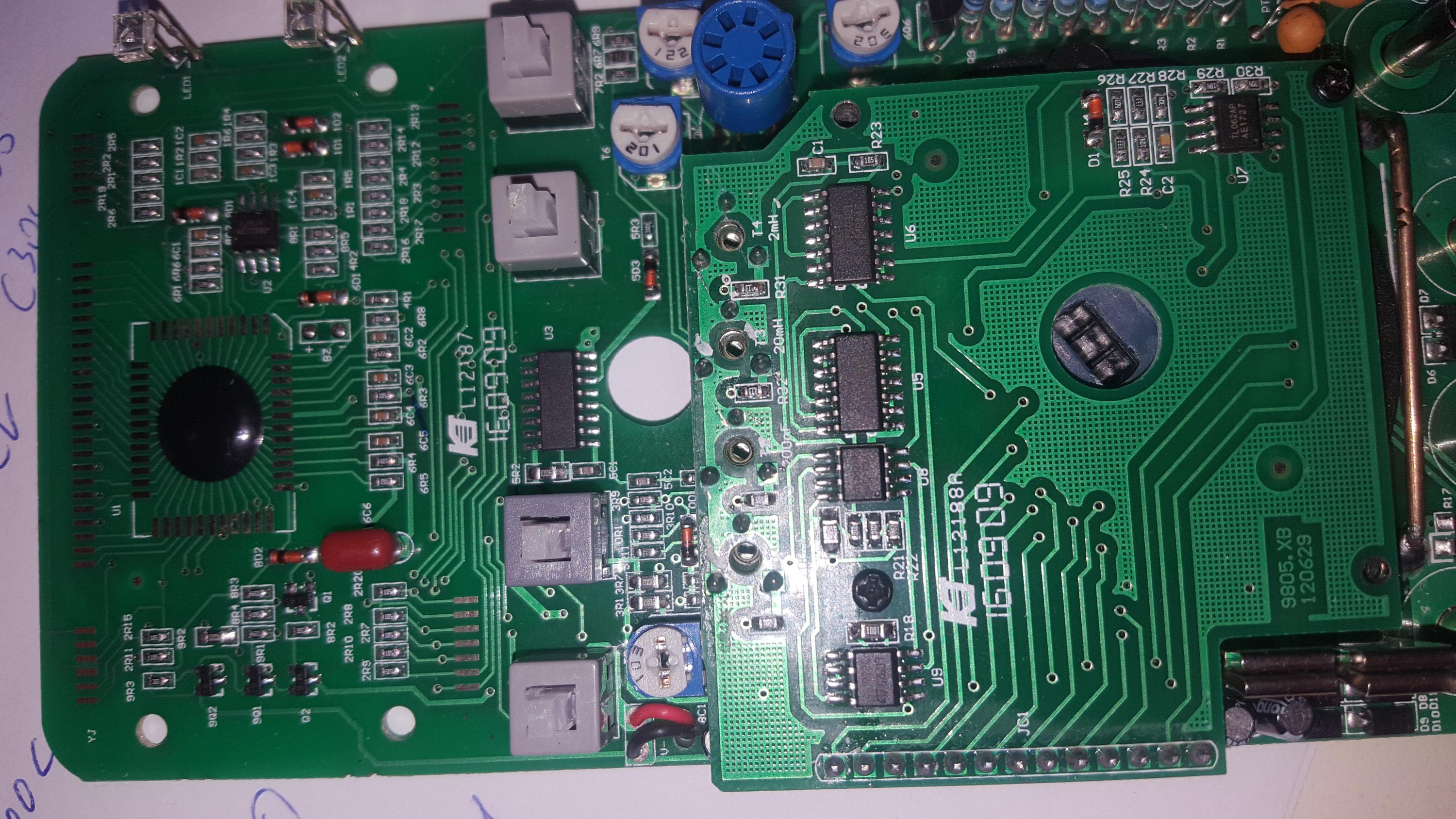

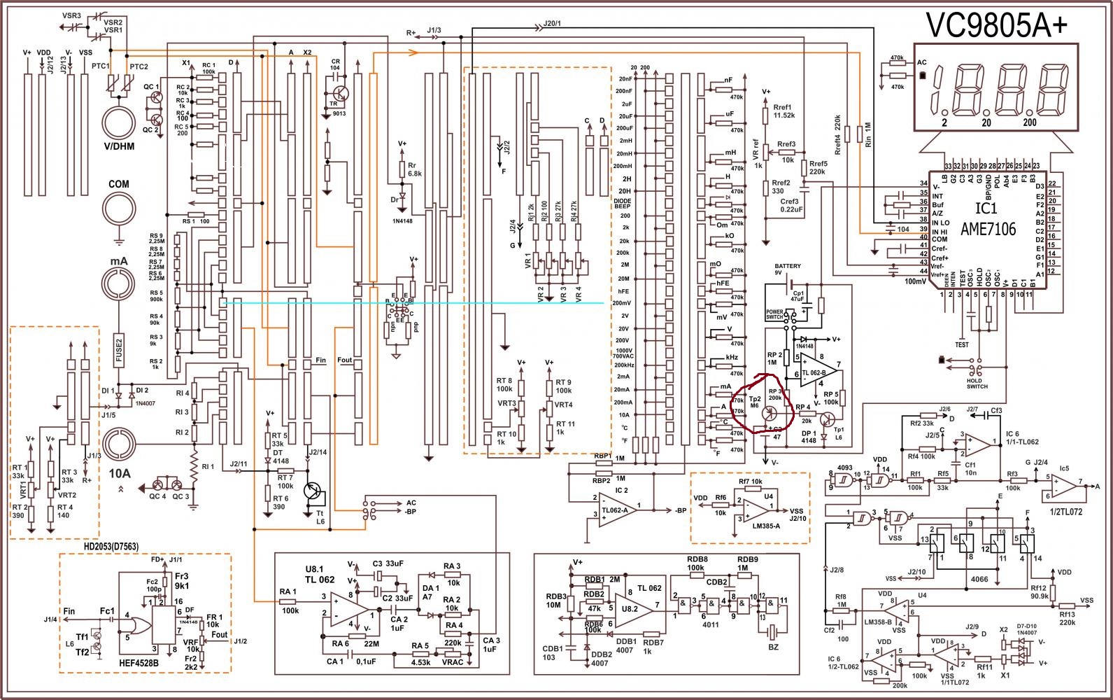

    Thank you for your reply. The m6 smd I marked in the photo and diagram was a short circuit. I don't have an m6 transistor right now. What should I do to operate the multimeter?
    • redwire
      • Dec 2010
      • 3912
      #42
      Re: Fixing a multimeter based on VC9805 schematic
      Ok, that transistor matches the schematic for Tp2, controlling battery power to the multimeter, for the auto-power off.
      If it was shorted, the multimeter would stay powered on, it would not auto-shut off. The on/off switch would still work.
      It would be rare for that transistor to fail short-circuit. It seems strange. Unless there is another shorted part on the board, like a C2 or an IC.
      You can just short C-E with a jumper and the multimeter would power up and work, just no auto-shutoff feature.
          Yes, it doesn't turn off automatically. you guys are great. thank you. good people like you will save the world... so why can't I measure voltage and current? only ohm and diode (buzzer) are working. I couldn't find any other short circuit, contactor wires are in place. Could you please give an idea for this as well?

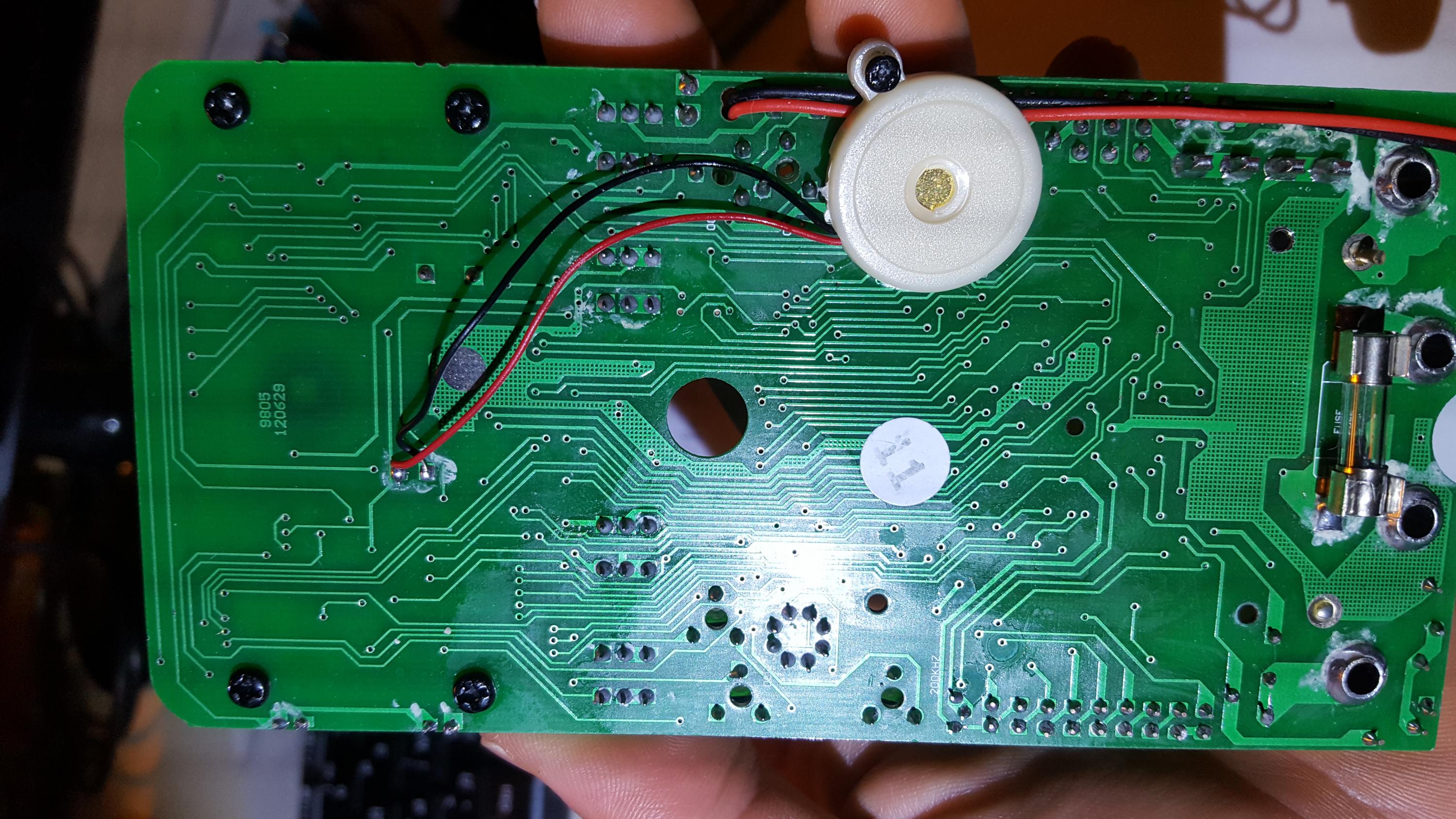

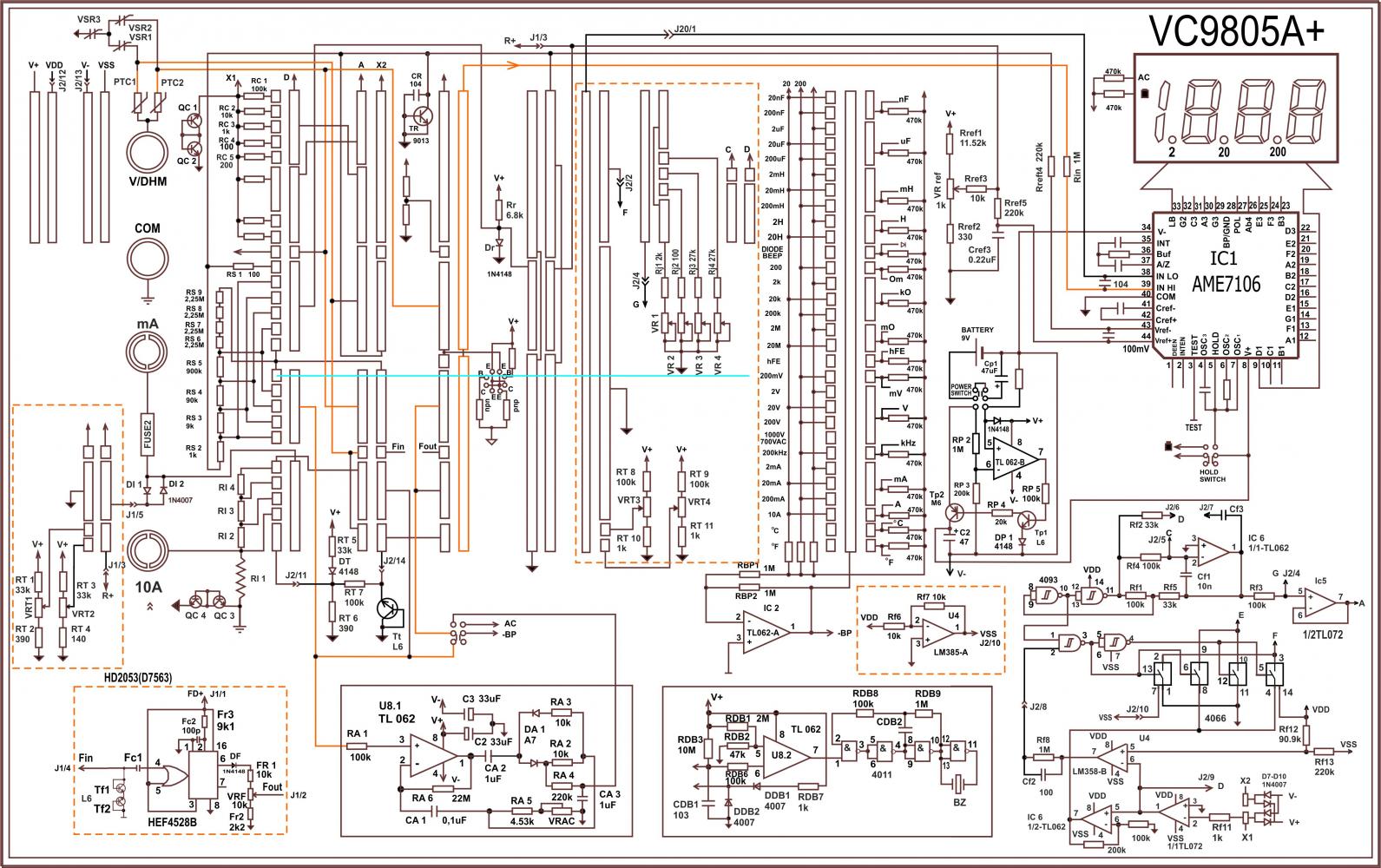

              vc9805 multimetre arızası
              hello, I have the same vc9805 multimeter, whose photos and schematic I have attached below. After replacing the battery only ohm and diode (buzzer) measurements work, other measurements do not work voltage, current ... none. Only the number 1 remains on the screen. When I measured the components, I couldn't find any problem parts. If anyone has any idea, what should I do?

                Re: vc9805 multimetre arızası
                check all the transistors for shorts - some are used for input protection.
                  I checked all of them, unfortunately I can't find it, I don't understand where am I doing wrong?
                      Post #28 I said to use a multimeter and measure some voltages "On DCV 20V range, measure the A/D voltages: IN HI, IN LO, REF HI+, REF LO-, COM wrt V-"
                      That is 5 readings to take.
                            Display shows 1___ with those readings?
                            Pin 40 COM voltage is too low, it needs to be at least 1V above V-. On the schematic it would be QC4,QC3 to check- that would short COM below 1V. On your board check whichever two are the same transistors as those. 9Q1 maybe?
                            There should be two protection transistors between COM and V-. If your meter does not have them, the IC can get damaged on pin 40.
                                I solve the problem. I change the u2 integrated diagnostic tl062 in the diagram and the multimetrem started working as it old. If anyone experiences the same problem with me, remember this and benefit from this information. Thank you so much to the good people who answered my questions here...

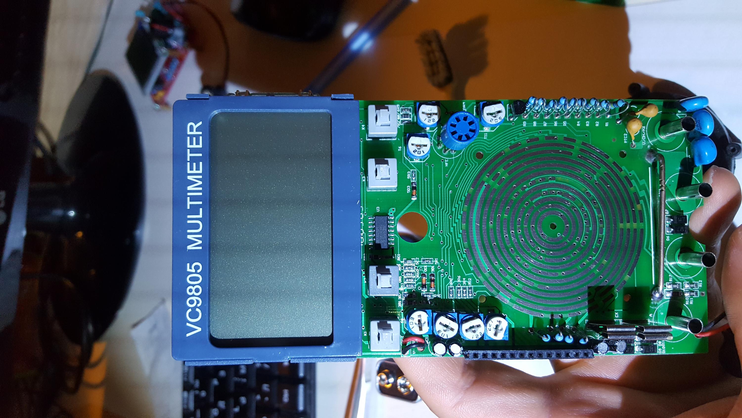

                                        #59
                                        Sorry guys, I didn't have the time to work on this. Probably tomorrow will be able thoroughly check your replies and do some more tests.
                                        Meanwhile here are some photos to get an idea about the particular DMM.
                                        p.s. 6R3 = Rin
                                        Dude, I have the same multimeter. I confused the wires around the position selector switch. Can you send me your photo?
