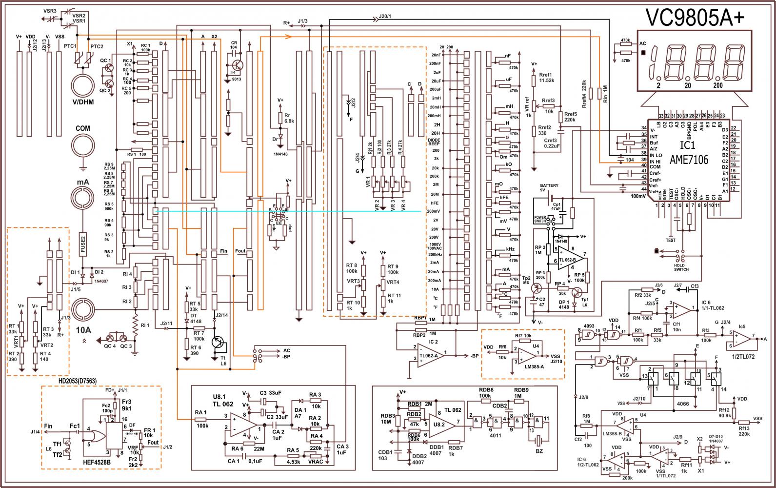

    Hi there, recently I got a not that cheap chinese multimeter based on VC9805 schematic.
    Unfortunately it doesn't measure correctly.
    Here is an example:

    Both V and Ohm measures go through RS2 RS3 RS4 and RS5. All that resistors measure as shown on the schematic - 1k, 9k, 90k and 900k. RS6-9 are 1.75m, 2.95m, 1.75m and 2.95m or total of 9m ( while it should be 10m, but even with added 1M resistor, the measure pattern still stays the same ).
    I also have measured the resistance of the paths for all V ranges between Rin and the corresponding resistor ( for instance range 20V - Rin <-> RS5xRS4 ) and all paths have almost the same resistance ( +/- 0.2 ohm ). These are the paths which go through the range selector knob. Also, the multimeter is almost brand new and no damage is visible on the contacting surfaces.
    Rin is 1M
    Any ideas what else to check?

        I would check the protection circuits and maybe the rotary switch because the DMM is measuring off numbers only on some functions/ranges?
        There are a bunch of diode-connected transistors for clamping overloads. These can get damaged (leaky) which makes low values read low or zero. Or they can turn on early and make higher readings stuck at a mid value.
        I would check transistors QC3, QC4 which protect between the two grounds.
        TR 9103 (by CR 104) seems to be protection for the ohms (output) current source.
        QC1, QC2 for overloads on capacitance measurement.
        Tr L6 is protection for thermocouple input.
        DI 1, DI 2 protection for current shunts.
        Tf1, Tf2 protect the Freq. input
        The ICL7106 A/D is a bit hard to understand because DMM input COM is to A/D (-) IN LO, not A/D COM or V-.

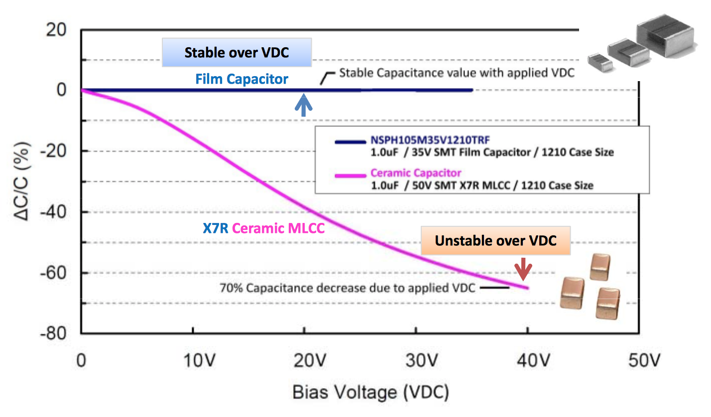

                      If the A/D linearity is poor, the Integrator capacitor (pin35) might just be a cheap ceramic part.
                      Some DMM's have the required big through-hole film cap, and a tiny X7R might explain the poor linearity seen here.

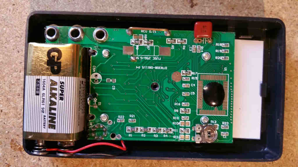

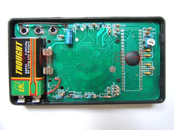

                              Look at pics of the vulnerable DT830B DMM which is like OP's.
                              Some use a big through-hole film cap 0.15uF and others use ceramic X7R for the integrator cap.
                              SMT filmcaps (PPS dielectric) still melt easily in reflow and I rarely see them used.

                                I would imagine that leakage would be a bigger problem than capacitance reduction due to voltage. The capacitor must be low leakage and not have microphonic characteristics. I don't think the voltage across the capacitor should reach more than a few volts (3V would be my upper bound guess) so it shouldn't be a huge concern if a high-ish voltage part was selected.
                                Yes, I was wondering how the heck SMT Polyester caps would survive reflow hence assuming that they didn't exist... but they sure do and how the heck would these be safely reflowed?

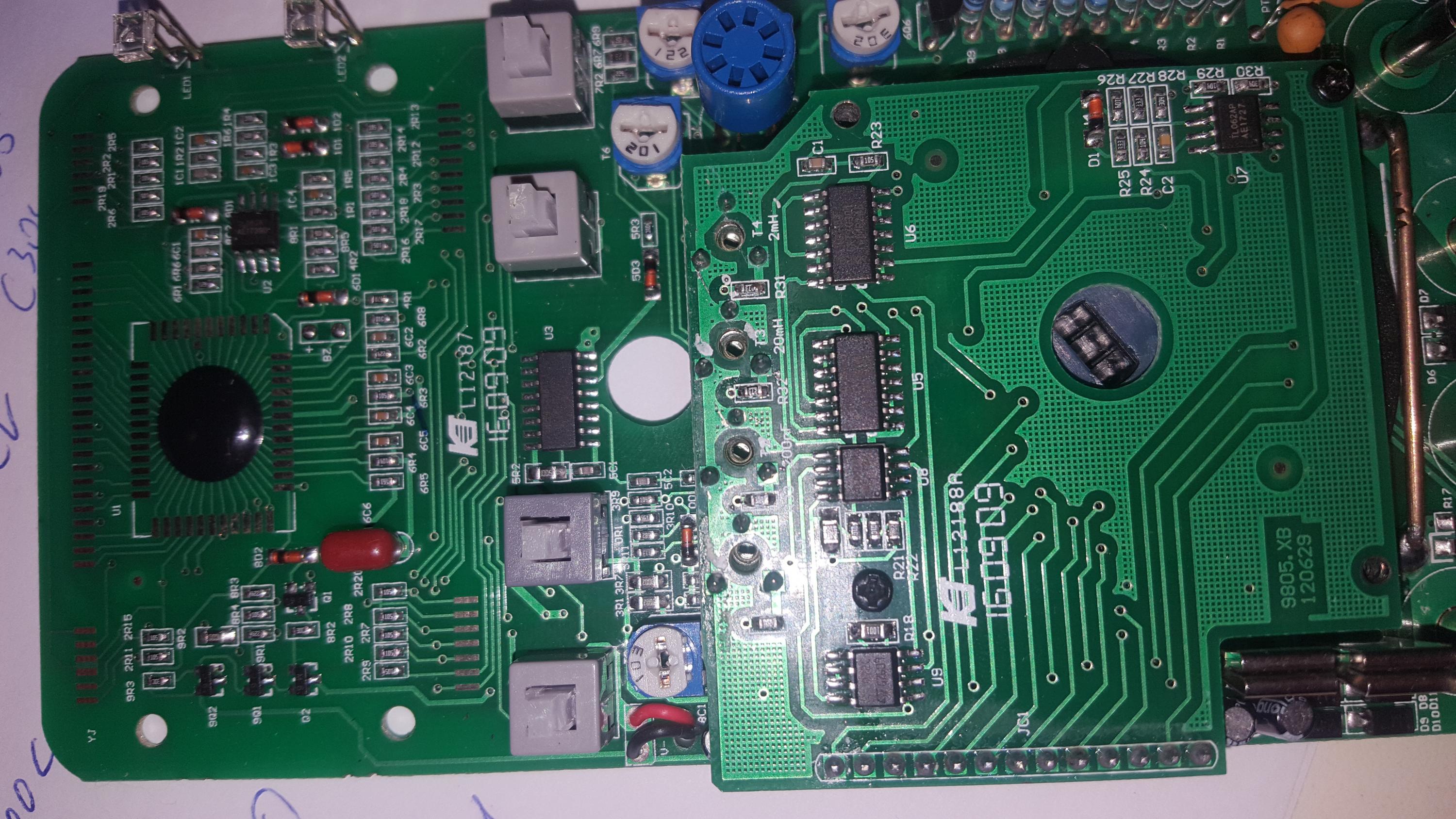

                                  Re: Fixing a multimeter

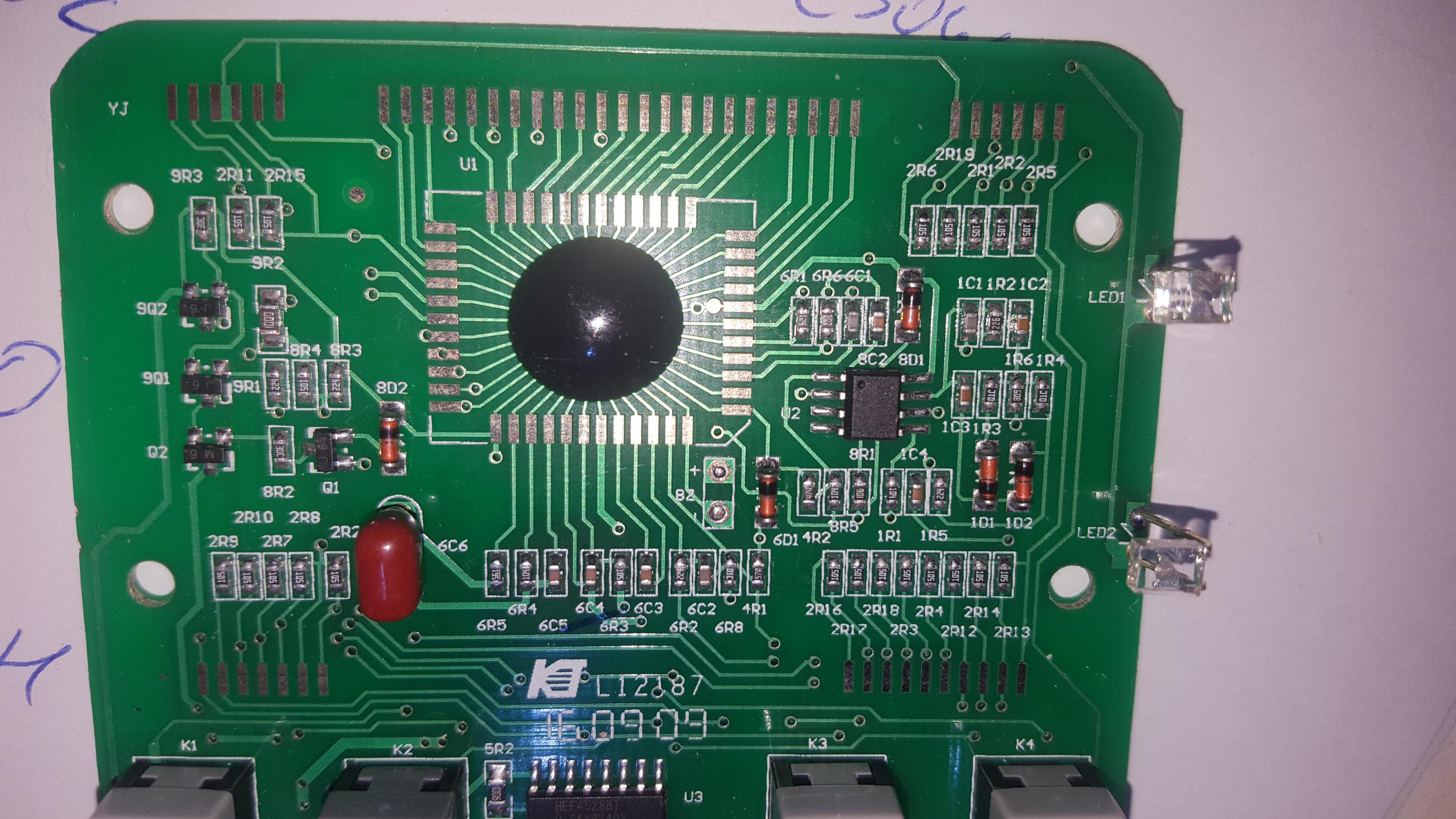

                                  Sorry guys, I didn't have the time to work on this. Probably tomorrow will be able thoroughly check your replies and do some more tests.
                                  Meanwhile here are some photos to get an idea about the particular DMM.
                                  p.s. 6R3 = Rin
                                  • eccerr0r
                                    Solder Sloth
                                    • Nov 2012
                                    • 8711
                                    Eiew COB, mark of cheapness
                                    At least it looks like it is probably using a film capacitor 6C6 for the int cap, though I'm not sure how the board correlates to the actual schematic, they look a bit mismatched. I don't know why there's a resistor in series however, that seems a little out of place from all the 7106 series chip circuits I've at least seen...
                                      I have traced the V line from the probe to the IC and it exactly matches the schematics ( the components are marked differently though ). Tomorrow will trace the Vref lines and will check the components pointed out in the above comments.
                                      • madan1
                                        • Nov 2016
                                        • 726
                                        • Bulgaria
                                        Well, I guess I killed the analog part. I shorted 6R5 and after that I'm not able to get a zero ( even after I removed the bridge wire )... not it just loops between -1 and +1 ( for V ).
                                        edit False alarm... It turned out the selector knob is causing the issue..
                                        edit 2:
                                        I shorted again 6R5 and this reduced the difference between 20V range and 200V range to ~0.14V ( battery 7.74 in 20V -> 7.6-7.7 in 200V -> 007 in 1000V ). Still to test it with other voltages and resistors, but I guess the results will be similar. Any ideas how to improve even more the accuracy between the ranges?
                                        The capacitance of 6C6 is OK.
