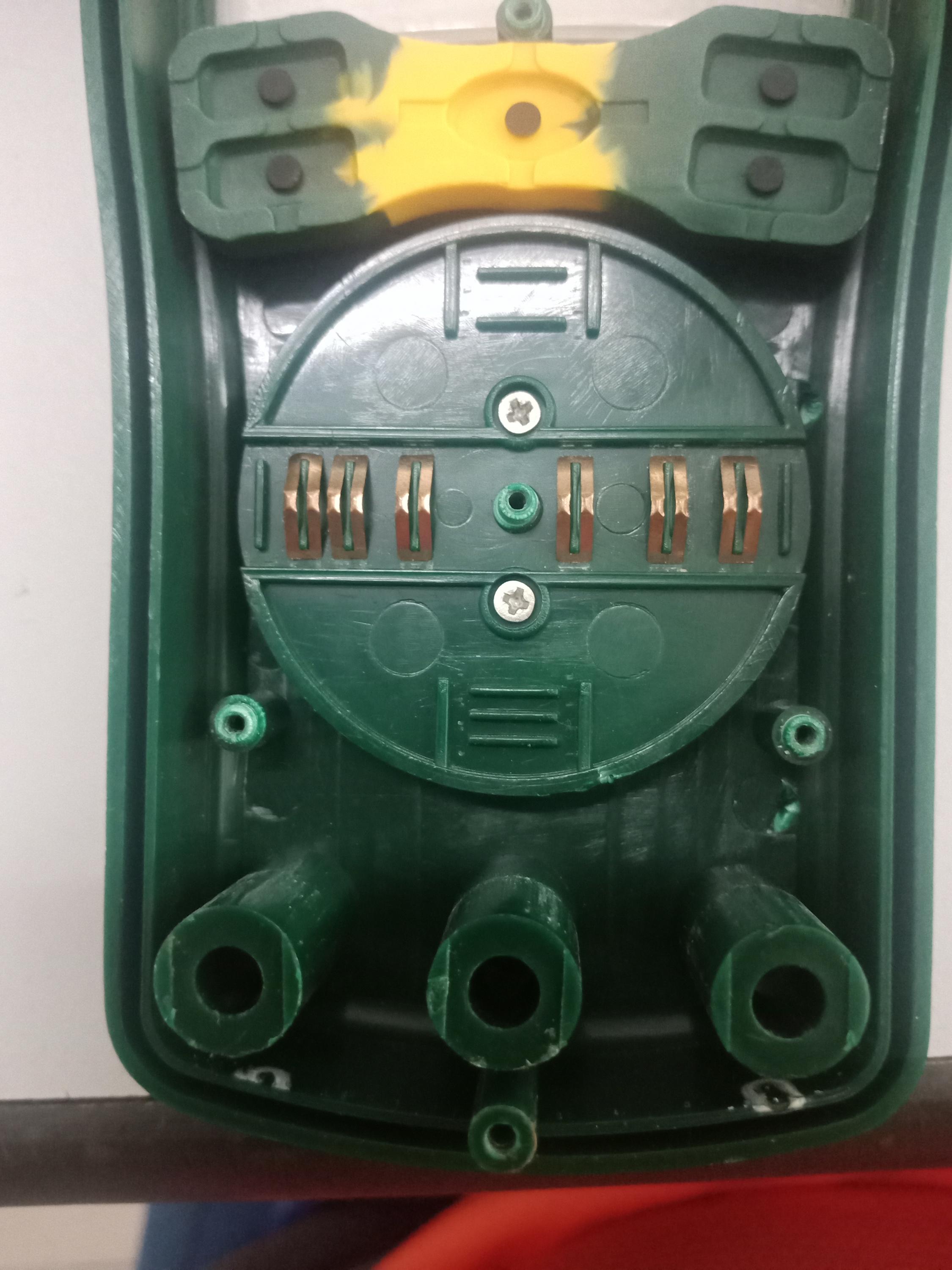

      Can you give me the picture behind switch multimeter? Behind switch Off Vac Vdc Hz...

        Re: Extech EX330 multimeter current range offset fault
        Is it like this my picture?
          please help me to solve this problem
            is the problem that you dont know where the contacts go ?
              Here you are:
              https://drive.google.com/file/d/1Wk9...ew?usp=sharing
              https://drive.google.com/file/d/1WlL...ew?usp=sharing
              It seems that you are missing 2 contacts.
              Or possibly you have a lower specification model that does not have those contacts, maybe?
                Originally posted by PanicMechanic
                Here you are:
                ok, thankyou, I think i am missing 2 contacts
