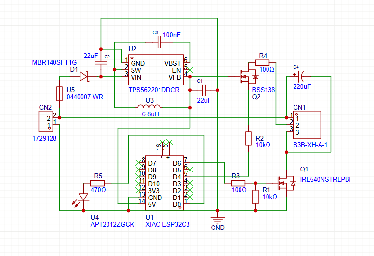

Please review my ESP based WLED controller board for WS2815 12V LED Strips - New to electronics.
  • Geeker007
    • Jan 2025
    • 20
    I'm designing an ESP-based WLED controller board for WS2815 12V LED strips, with a primary focus on energy efficiency.
    To minimize power consumption, my goal is to completely shut down the system when the LED strip is turned off.
    However, the current buck converter powering the ESP module draws about 8 watts even when the LEDs are idle, making it unsuitable for low-power operation.
    I am using below components:
    • Buck Converter: TPS562201 (12V → 5V regulated)
    • Microcontroller: XIAO ESP32-C3 (with built-in USB-C)
    • LED Strip: WS2815 (12V digital LED strip)
    • Switching MOSFET: Logic-level N-MOSFET (IRLZ44N)
    • Level Shifter: BSS138 MOSFET-based (3.3V to 5V data line)
    • Status LED: Green LED
Name:	Screenshot 2025-06-29 161310.png
    I've attached the schematic—could you please review it and let me know if I've missed anything or if there are areas for improvement?
    I designed it with limited experience, so I’d really appreciate your feedback on whether the setup is correct and functional.

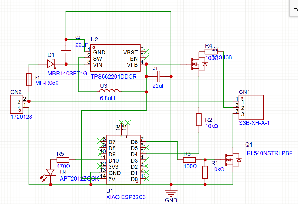

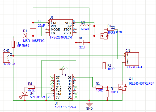

    I have updated TPS562201 with TPS62840DLCR as per search online. Better option?
    Adding updated schematic

    • Geeker007
      • Jan 2025
      • 20
      Click image for larger version  Name:	Screenshot 2025-06-29 165245.png Views:	0 Size:	47.1 KB ID:	3671071
      Ignore this change. I think I made a mistake by adding lower input voltage buck converter? So TPS562201 is fine or there is better option?

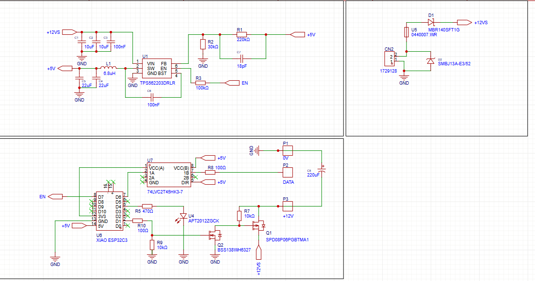

              • Geeker007
                • Jan 2025
                • 20
                Made some changes. Can you guys please review now and provide me the feedback. Any other suggestions here?
                  • 30979
                  whats that ttl chip about?
                  is it intended as a buffer for the esp output?
