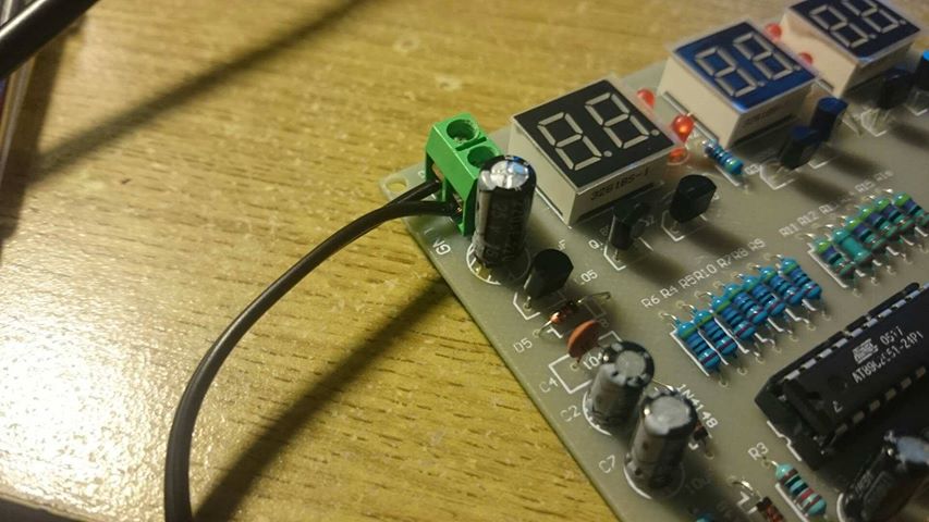

    Ok so I bought one of these kits from eBay, which eventually arrived:
    https://www.ebay.co.uk/itm/DIY-Green...72.m2749.l2648
    Now I soldered everything how I thought was a-ok with my knockoff of a Hakko 936D iron.
    However when powering nothing happened at all. Even using a 3V coin cell nothing also happened.

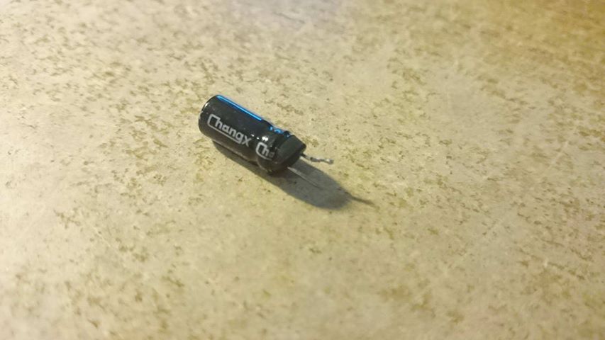

    I tried rotating the switch (see centre right) and the cap in the images blew its guts out.

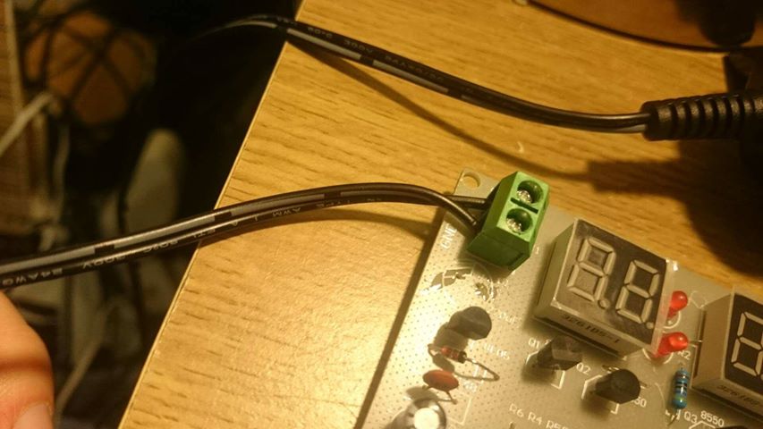

    The polarity seems ok as I think that the solid line on the PSU (little 9V 100ma switcher) is the negative which would go to ground?
    How do I know which way round the switch goes?
    Am I a dummy?

    did you test polarity of power supply ?

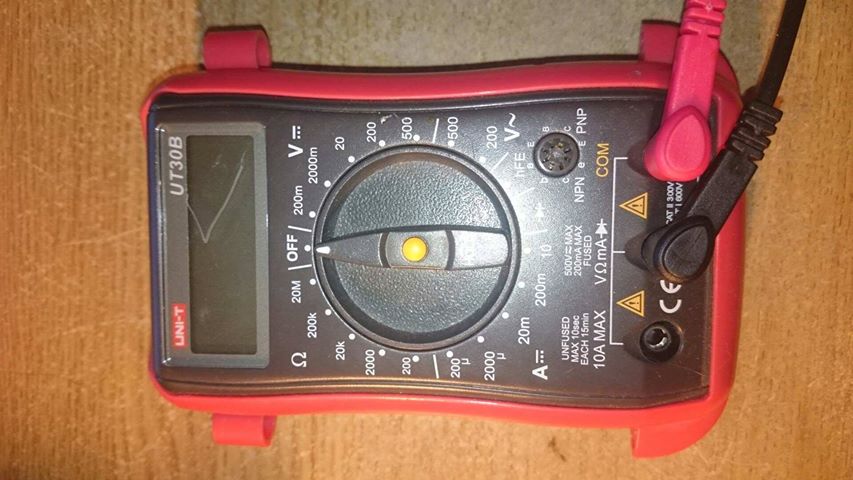

      Ok - another stupid question - the black lead is going V(Omega cymbol)mA and the red is going to COM - let me guess... this is the wrong way around??
      Btw I have no formal background in electronics!!

        if you have a multimeter test the power supply voltage just incase its been wired up wrong inside the adapter part. Can you post a picture of the back of the clock pcb so we can look at the traces etc.

          cap is correct way round and is rated at 25v .
          the switch is easy to work out with your multi-meter .
          mostly capacitors blow up from reverse voltage or too high voltage .

            This is how my multimeter is wired... the black connector (negative) I am putting against the wire with the white strip down it on the PSU... it reads 8.88V which seems about right.
              if this is your multi-meter black goes to com . red to VΩ
              if wiring is backwards meter will read in negative .. example -9
                Looks like I am reading the PSU backwards then... which means white line is +VE!!! That will be why cap has blown!!
                D'oh!!!

                  the transistor next to it might be blown too plus other things .

                      try a new cap and see how it is then . best to get quality ones anyway .

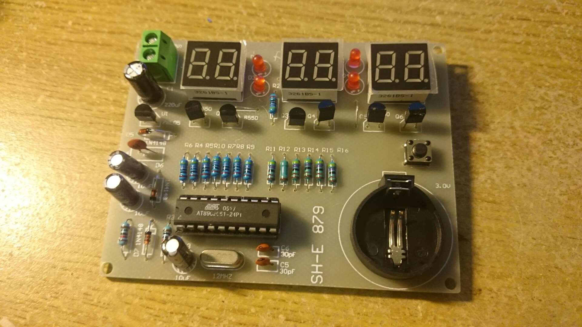

                          Underneath the cap is a 5V 78L05 regulator. They generally withstand reverse voltage on them for a while. It might be worth trying the circuit without the exploded capacitor, it should work given 8V.
                              http://hipcatcoolcap.blogspot.com/20...879-clock.html
                              i did wonder where the regulator was .i did guess it had something to do with it but never thought it was the actual regulator .
                              if dc is smooth i agree it shouldn't need the cap to test it . old 9v block battery might be a better choice as supply

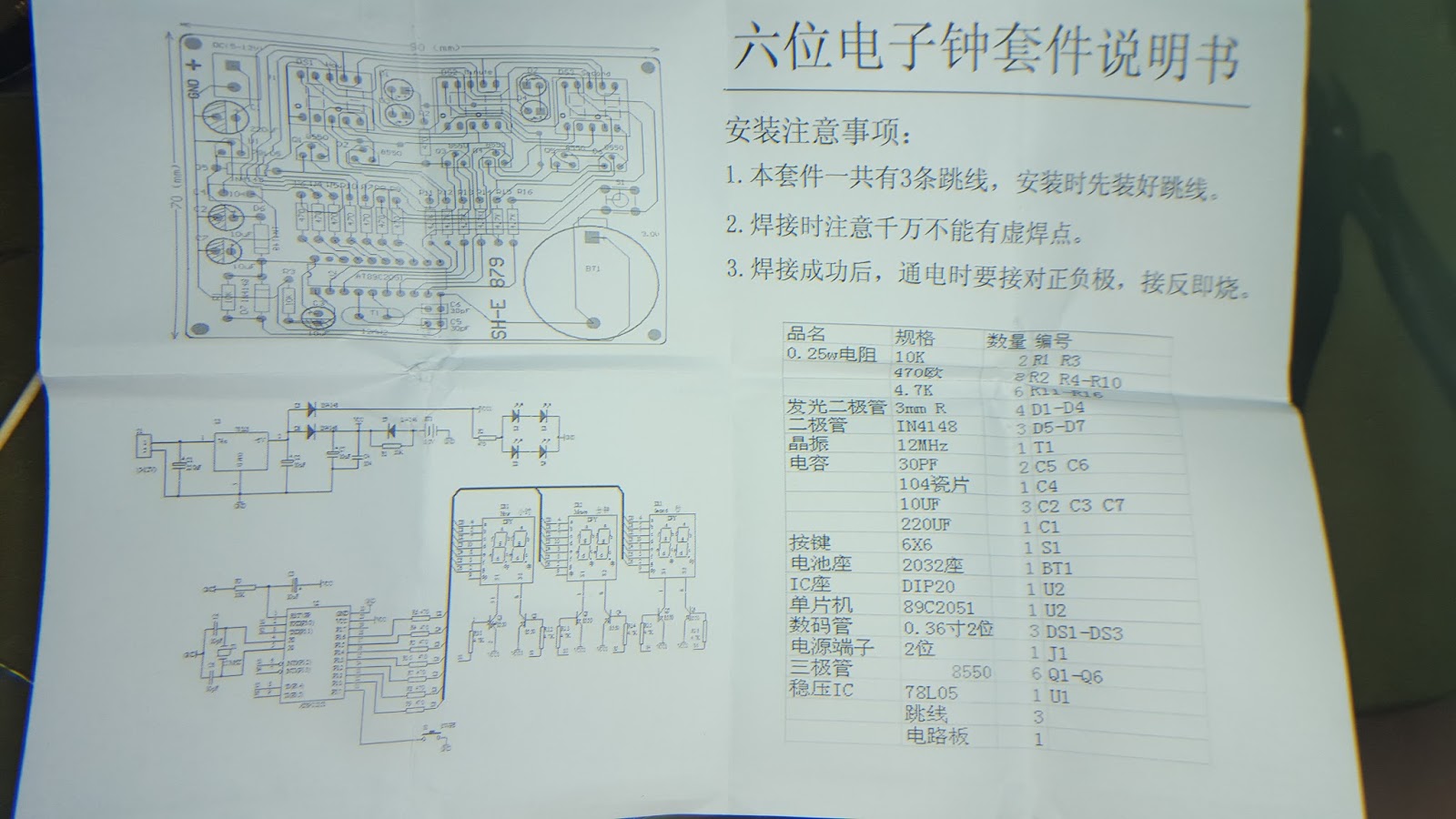

                                Actually, having looked at the circuit diagram, the clock should work just off the 3V battery...

                                  i assumed 3v was a backup supply . will check schematic now .
                                      I assumed that too, but its to be connected through a diode to the vcc supply... unless the MCU has voltage sensing and goes into backup (no display) mode below a certain voltage.
                                      I also notice there is a resistor bypassing this diode (I can't make out the numbers on the circuit diagram) that CHARGES the 3V battery when connected to a supply! So DON'T use a standard 3V coin cell in there or you'll have another exploding component!.
                                      *EDIT * What goes on with R12 on your PCB? Trick of the light or has that only got one band?

                                        gah, I do wish people would scan circuit diagrams in with enough clarity that its possible to read them. I'm wrong, it DOES need more than the 3V supply, there's 2 VCC rails, one for the MCU, one for the LEDs.
