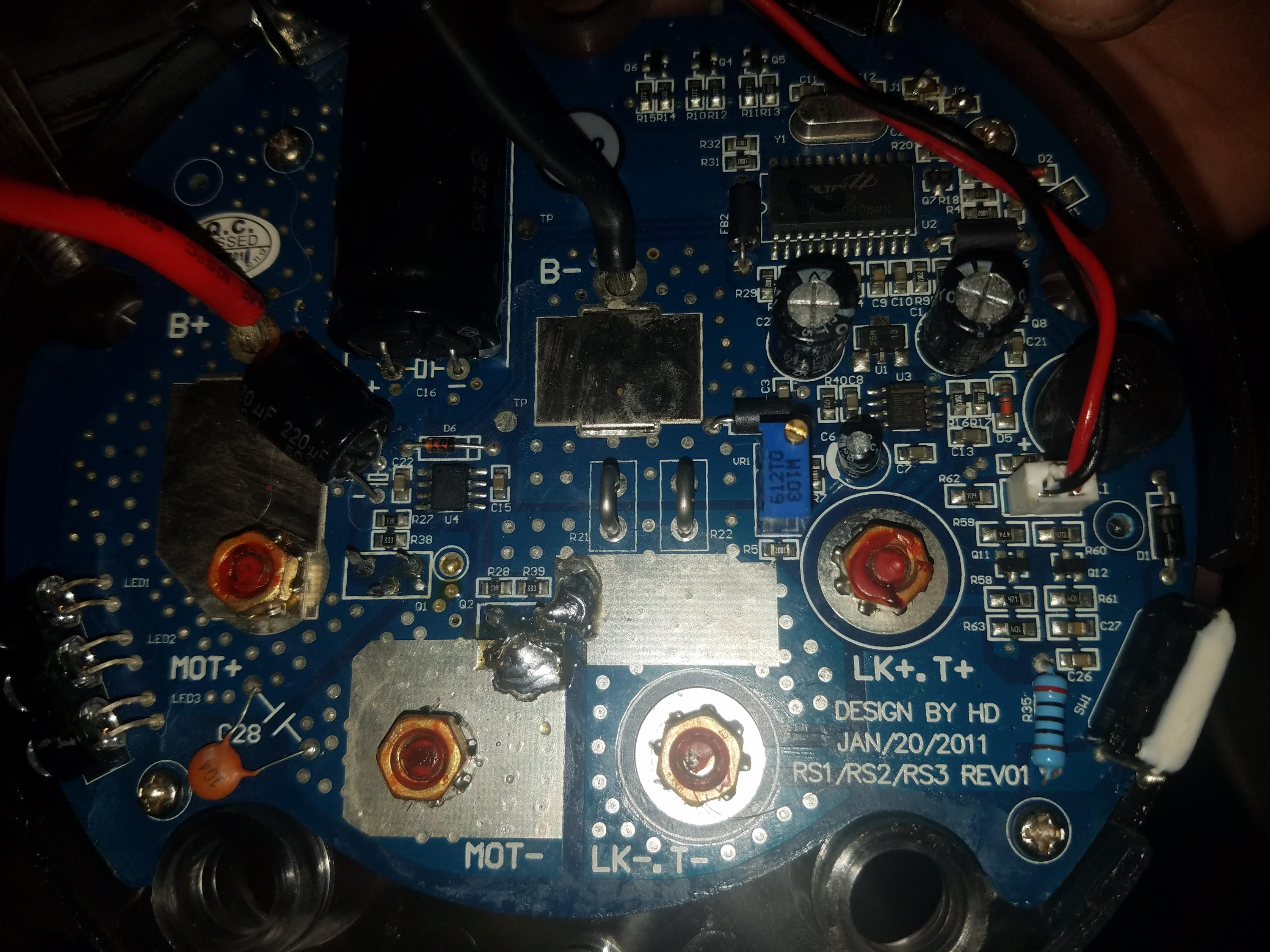

    I have a seadoo RS1 seascooter that is stuck on and its pretty basic inside.. I have narrowed it down to a mosfet that is totaled, showing open on all 3 legs. part nmber is FB3306 on both but one has 012p and the other 904p under the part number.. does that make a difference or are they the same thing??
    I would take a picture but they one is barely visible under mag glass..

    Re: mosfet question
    Should be the same, seems to be IRFB3306,
    904 = 2009, 04 work week, P = lead-free
    012 = 2010, 12 work week, P = lead-free

            Re: mosfet question
            "I have narrowed it down to a mosfet that is totaled, showing open on all 3 legs."
            When measure the resistance between Source pin and Gate pin it should show open circuit, same result when measure between Drain pin and Gate pin, and when you measure in diode mode it should show like diode between Source pin and Drain pin.

              oh right, of course, the one is dead short on all 3, doesn't matter which way I test it... i also hooked it up to my component tester and it shows 1 resistor of .2 ohms. the other one is showing diodes as it should.. at least my component tester said it was good.. im going to replace both anyhow, just want to make sure im ordering the correct part..
                Re: mosfet question
                So the MOSFET is SHORTED, not open circuit, just trying to get the correct data.

                    Re: mosfet question
                    Well the Gate better show open, the resistance be between GATE and Source pin or Drain pin should show Open, if it shows resistance then it is bad.
                    MOSFET typical failure mode is shorted.

                        Re: mosfet question
                        "shorted D-G so both were trashed" That can be real bad for the device that drive the GATE since the Voltage of the Drain pin will be dumped into the output of the GATE drive device, you need to trace out where the trace from the Gate goes to so you may be able to check the Gate drive device.

                          Re: mosfet question
                          yeah that goes straight into the motor, which caused it to run away.. the board is SUPER basic, If i can get a picture ill post it so you can see..
                            Re: mosfet question
                            I am talking the Gate pin which should get the drive Voltage from Gate driver circuit, if the driver circuit is damaged and you do not replace it the your new MOSFET can be damaged.

                              so after removing all the caps and 2 rectifiers, one is fried, one cap is half of its rating and the main cap 3300uf 50v was only 110uf... so my guess its that it was toasted from too much current.. as soon as i get the new parts ill chime in if its fixed.

                                Would really be interesting to see some pictures of the board and also what cap brand is used in this seado. 110 uF for a 3300 uF cap is pretty bad. Could be why the MOSFETs failed too. Or the other way around too, of course.

                                  they are junk chinese, can't even read the brand its so badly printed.. no bulge or leak.. I replaced with nichicon and checked everything and seems to be close to spec.. im just waiting on the mosfets to come in..

                                    received the new ones, and they sent 3306G which no idea the difference.. Installed the new mosfets, and the unit worked for 1 second, then died, now is shorted out, and drawing tons of amps.. this is the best picture i can get with the power outage.. the other side is only the mosfets and 2 sets of wires that control the deadman magnets..
