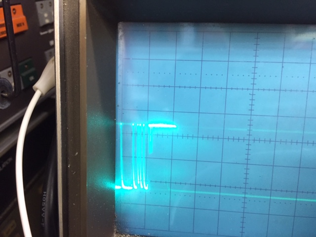

                  I use an oscilloscope and a simple octopus circuit for testing relays, allows me to look at contact quality at varying rates and loads. I will post some details when I get back to the workshop.

                          Mainly I look for degraded contacts which shows up really well on a scope tells me more than measuring the contact resistance itself as this can vary significantly from throw to throw. Essentially using a variable rate relay pulsar poor contacts will show up as excessive bounce and or noise on the trace, I appreciate this method is rather different to a pass no pass solution but its one I developed for testing relays on commercial bar aid washing machines that have about a dozen on each board.

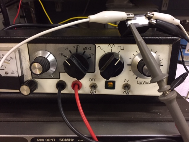

                            Re: how to automate relay testing

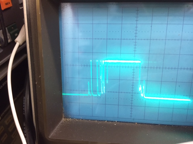

                            I have come into the workshop 10 Baraid controller boards with a large number of relays on each for testing, so I looked into the way I was testing them again and came up with a 'simpler' method. I am not sure how this got overlooked last time but rather than a crude pulser I got around to using a function generator, square wave output, a variable power supply (100ma) set for the test signal and the scope.
                            Inject the square wave into the relay coil, set desired frequency and watch the signal developed across the switching contacts from the power supply on the scope. Should be in theory be a square wave, but it will show up contact bounce and poor contacts, use the function generator to vary the test frequency.
                            When I get around to it I might put some pics up.

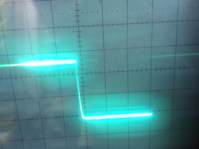

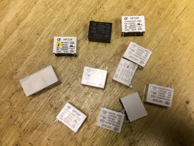

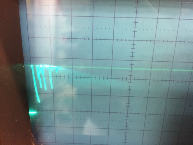

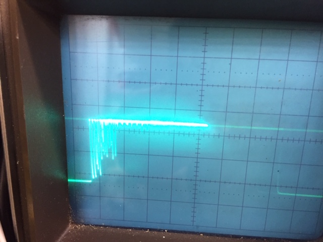

                                  So here we are then, having worked my way through 10 of these hobart bar aid boards here are some of the resultant relay failures.
                                  So first the test layout, then a good control sample then a selection of bad relays.

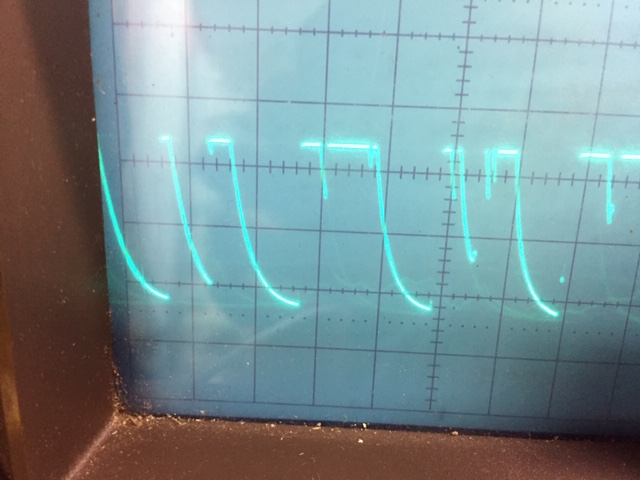

                                    And of course not to forget some of the dross, I had 15 final pulls from 10 boards, some tested completely welded closed and some were completely open. the rest tested as intermittent but showed as clear fails when scoped.
                                      Are you saying the debounce scope waveforms tell you pass/fail? (for a relay that still switches, not stuck).
                                      I wasn't sure what scope traces are OK or not for your criterion.

                                      • llonen
                                        • Sep 2014
                                        • 495
                                        • hampshire
                                        With the waveform I am feeding into the coil actuator, that being a square wave the resultant switching waveform consisting of a dc 12 supply limited to 100ma or 500ma should look within the limits of the switching arrangements to be a square wave as it is simply switching the relay between two voltage / current states. I find this method good for identifying failing relays where the failure mode is attributed to degraded contact and contact resistance since a simple measure of resistance rarely identify's this unless the seriously degraded.
                                        I used to use an octopus circuit and pulsar but prefer the level of control that a function gen gives me, I can more easily vary test frequency and coil voltage etc. In the case of the hobart controller boards I use the customer fault report along with this testing methodology to verify relays on each board.
                                        I am sure there are many other ways of testing relays but this method seems to work reliably for the work I carry out.
