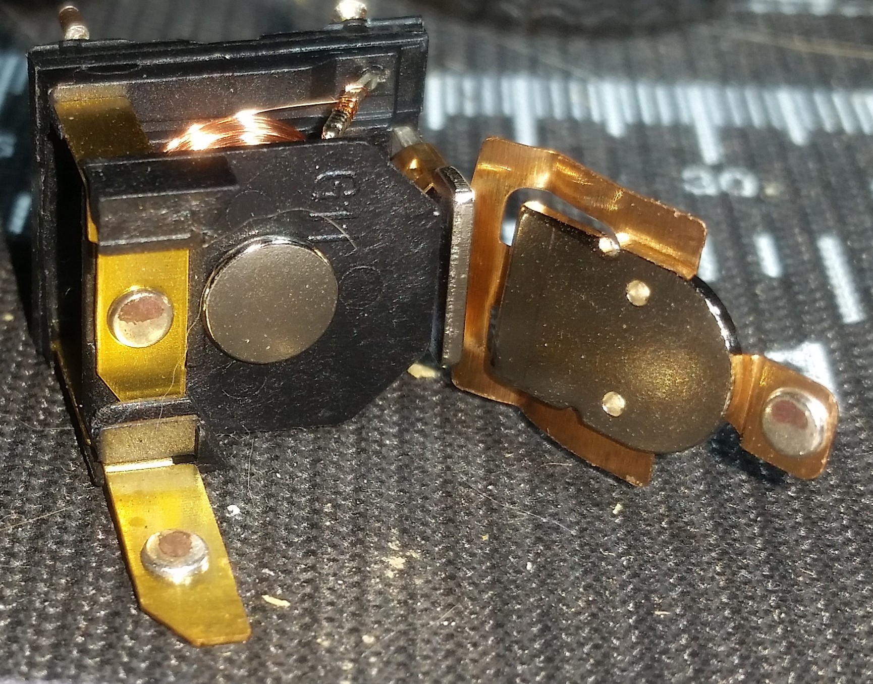

    I have ~600 state changes in my logs 11/26/21 - 1/31/22
    this include both relays, i have sanity checks to detect bad data to prevent random state changes, eg if the temp sensor goes from reporting say 20c to 80C in 2 seconds i call bs and read the senor again
    edit: just updated the git repo with my current script reversion

      Re: Mechanical Relay Quality
      600 seems quite low before failure. So it did only ~10 states per day, i.e. 5 on and 5 off per day, for 2 months?
      Hmm...
      how are you driving your coil? DC? Full rated current?
          Hmm...
          the contact failed on the coil powered off state 1st, so i am not sure that the could voltage it the issue, but it is running with 5v -transistor vdrop, but you can see how it was done in this image
          "600 seems quite low before failure. So it did only ~10 states per day, i.e. 5 on and 5 off per day, for 2 months?"
          yes, though we need to extrapolate time cause it was close to 4 or 4.5 years IRC, but that would be under 15k changes or 7500 full cycles and that includes cycles for both relays
          also worth noting that this relay did not have the snubber for probably a week while i wanted on parts
          the bottom relay has around 6 years on it, 2 years without a snubber and is still working, but only has 1 side of the relay (coil powered on) that does anything and it gets far less yearly cycles as it does not get used with the AC is active

                    #49
                    The old relay contacts are not pitted from arcing, but the plating has vanished and gone somewhere. There is no black soot so I'm puzzled what is going on. It might be chinesium plating.
                    Songle SRD-05VDC-SL-C coil is 70R or 71mA and they offer three different contact platings and current ratings 7,10,15A 250VAC as well as basic 10,000 cycle lifetime into resistive loads.
                    UL/CSA rate them only 3A 125VAC inductive loads, and there is a secret long life 100,000 cycle model. Thne specs are a bit deceptive and I've seen plenty of Songle knockoffs too.
                    Driving the relay with a TIP120, the base resistor is large 6k8 so the TIP120 sees about 0.2mA drive with hFE 500 so it is on a bit weak.
                    Changing to 2k gives 1mA drive from the RPi. The TIP120 loses at least a volt so the relay at best will see 4V.
                    If you drive the relay "weak" it pulls in slow and wimpy which would wear the N.O. contact only. The N.C. relies on the spring for force.
                    This is why I think the software might extra pulse the relay, or the snubber is simply too small for whatever the load is, or the relay quality is poor.
                          Actually using a TIP120?! This might explain the failure.
                          How much drive current can a rpi source/sink? If it can drive more, you're better off not using a Darlington there, at least for 5V. Maybe a 2N4401 would be better.
                          i got 10 of these relays in 2015 for $3.92 on ebay, so about 0.40 each, not sure if that is a realistic price for them
                          I have some 2N2222A NPN and 2N3906 PNP transistors on hand and a wide assortment of 1% 0.25W metal film resistors
                          rpi gpio is specked at 16ma max, however there is also a shared total max as well, i think that is 50ma, not sure if sinking and outputting both count towards this total
                          my LCD panel uses alot of pins, but the total ma should be silly low as i was trying to make the led a bit dim
                          front panel:
                          edit: i checked the voltage across the coil and got 4.14v on the bottom relay and 4.13 on the top relay
                          EDIT: took some pictures of the labels on the outdoor unit: https://imgur.com/a/809clTp they are not in great shape, but here they are
                            The NO contacts get a weak make but the break works fine due to the spring.
                            The NC contacts get a weak break but the make works fine due to the spring.
                            Well it's something to consider in any case. You could use 2/6 of a 74HCT04 to make a buffer so the RPi output isn't as loaded to drive something you can use as a saturated switch. Or even drive a logic level MOSFET,... Would be nice to direct drive a MOSFET but a 3.3V signal limits the number of MOSFETs available without some sort of buffer.
                            I really think that TIP120 is a bad idea for this situation, if you were using a 12V relay and supply then the TIP120 may do much better.
                              What about using this relay, it calls for 4.5v and says it will work as low as 3.2v
                              https://www.mouser.com/ProductDetail/817-SY-4.5-K
                              If this issue is the TIP120 would you expect both sides to wear like this? the NC (coil on state) wouldn't that one not look like this assuming the spring was not worn out, this contact does not look good, but it was not dead
                              i do not know for sure how much voltage the contacts are dealing with, i just know it is low amps based on wire gauge
