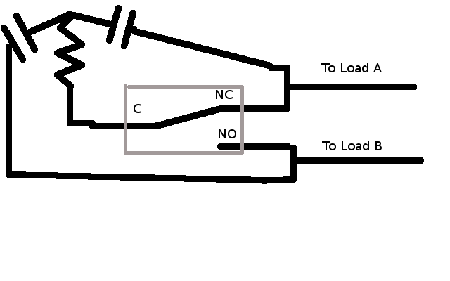

        Re: Mechanical Relay Quality
        Originally posted by stj
        there should be no arcing, you need to add a snubber circuit across the contacts.
        So i need to do this (see attachment)?
        What kind of cap would i need to use here? This is an AC circuit (meter says ~26.995V)
        about how many ohms should i use? (5, 10, 50, 100, 1000, 50k, 1m)
        * my on hand resistors only good for 0.25W, so going below 3k is probably asking it to burn
        AC caps are not polarized right?
        In this case Load B would be used when the unit is set to heat and Load A would be used if the unit is set to cool
        When i designed this board i used the relay to replace mercury tubes, i think i have seen a small spark when they switch, this is why i assume it was arc damage
          • 30978
          that circuit is nice.
          caps should be film type,
          analog is not my thing, but the current drawn by the load is usefull to know.
          you can get snubbers containing the cap and resistor in a single package but most designers use seperate parts.
          probably for cost reasons.

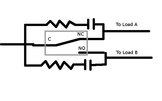

                                The values are not critical, I found 0.1uF-0.22uF 160V and 10R 1/2W worked fine.
                                This is to keep the back EMF from arcing relay contacts or damaging a triac.
                                The cap ends up being large physical size, I used junkbox X or Y-caps.
                                • evilkitty
                                  • Nov 2017
                                      I would use a higher voltage capacitor as 63VAC/100VDC is close to the part's limit.
                                      The load R L values and math and what you can fit/have on hand- it's easier to just look at it with a scope. Zone valves have a lot of inductance 200mH. I can post SPICE sims.
                                      With no snubber I got 300-500V spikes, and down to about 100V with a 0.22uF/10R
                                      • evilkitty
                                        • Nov 2017
                                        • 299
                                        well then guess i will go with a 200v cap 505-mks2g031001k00ko or 505-mks2g031001k00jo which ever is in stock...
                                        In the interest of science would it be a problem if i used only one resistor with a double throw switch/relay
                                        I know it would only save $0.10 but it is 1 less part to solder, now that the logical reasons are out of the way... i am really just curious about it if you can do that
                                        EDIT:
                                        Would i need a snubber for a relay that controls a incontinent light bulb and a florescent bulb?
                                        Last edited by evilkitty; 01-02-2018, 06:45 PM. Reason: 200V not 400V (mixed up AC /DC voltage specs)
