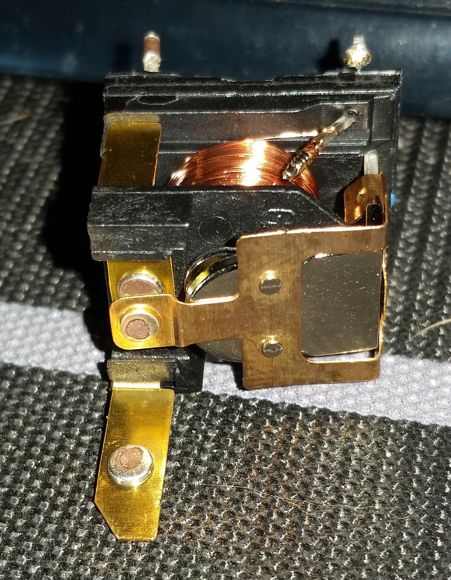

                        Re: Mechanical Relay Quality
                        Lasted ~4 years this time
                        Here is a image of the relay contacts after failure
                        these are the parts i used:
                        https://www.mouser.com/ProductDetail...S2G031001K00KO
                        https://www.mouser.com/ProductDetail...OS1/2CT52R100J
                        • redwire
                          • Dec 2010
                          • 3906
                          #32
                          The relay contact's plating is gone on both N.O. and N.C. which is a bit strange. A thermostat uses one set only I thought. But no pitting or etching and not black. This is 24VAC HVAC? Looks like your snubber 0.1uF 400V and 100R is not doing great. The resistor is too high value I think.
                          I find 24VAC HVAC makes some pretty big arcs with zone valves due to their large inductance. A Honeywell V8043 measures 200mH and 21 ohms, but is only about 8VA load. Best I could fit is 0.22uF and 10R after using scope traces to calm down the spike. Snubber values for mains circuits have different values, there you can use a bigger resistor 33-100R and smaller cap 0.01-0.1uF
                          Before, I recommended 10R resistor and maybe double the cap size. I don't know what the load is, if it's a contactor or furnace gas valve etc. Why did you go 100R not 10R? I'd change the snubber or maybe a MOV is really what's needed.
                          • evilkitty
                            • Nov 2017
                            • 299
                            #33
                            "0.1uF 400V and 100R is not doing great"
                            "Why did you go 100R not 10R?"
                            uhh the spec page says it is a 10 Ohm resistor, I'm not sure what you are talking about, i do not see 100 R on the spec page for either the cap or the resistor. does R not mean resistance?
                            as for why there is wear on both NC and NO
                            Image for reference: https://github.com/GM-Script-Writer-...0.JPG?raw=true
                            I have 2 relays, one simulates the top mercury tube and the other emulates the bottom tube
                            the top one acts like a double throw switch and the bottom is a single throw
                            both failures have been the top relay so far (it gets the most cycles)
                            the coil powered off state is what failed 1st on this relay
                            the bottom relay only gets switched when the temp goes down even though heat is on (this uses a lot of electricity) but when it gets really cold we have a wood stove for heat so that cuts the cycles the bottom relay gets alot
                            this is the 2 bit logic my relays have
                            Top relay coil = on; if cooling: cool=true; else if heat: heat=false
                            Top relay coil = off; if cooling: cool=false; else if heat: heat=true
                            Bottom relay coil = on; if heat: moreheat=true
                            Bottom relay coil = off; if heat: moreheat=false
                            • redwire
                              • Dec 2010
                              • 3906
                              #34
                              Sorry I clicked on the resistor Mouser link and saw "100J" and thought 100 ohms, but it's 10. I'd say the relay should be lasting much longer then.
                              The top relay seems to be a master, its coil is on whenever there is demand- for either heat or cooling. The bottom relay is for switching on aux. heat. is that right? How does it switch between heating or cooling? I'd expect one relay for demand and another for selecting heat/cooling. The Honeywell thermostats are brutal without a schematic showing the A/C or changeover valve etc.
                              You might have an issue with the relatively fast transition from heat/cool as the top relay pole moves, as an arc between N.C. and N.O ends through the center pole. But that's kind of grasping at a straw.
                              Or maybe software glitching the relay because it looks like you first switch the relay then conditionally update flags, it should be the other way around. The decision (relay on/off) should be the last action taken. But I'm not sure what flags 'heating' or 'cooling' are in your program. I might use code like this knowing that some undefined states exist and need error handling. It's good to never assume things and have extra code to catch invalid flags. This isn't correct code but trying to show what I mean.

                                      • redwire
                                        • Dec 2010
                                        • 3906
                                        #39
                                        Just looking at reasons for the relay to have a short life, even with the snubbers.
                                        I am familiar with separate heating and cooling systems, which use a natural gas furnace or boiler, and separate A/C unit. So that just needs a heat and a cooling relay. What model #'s are the furnace or A/C, to see if the current or spike is much larger than we think, for the hardware.
                                        The Honeywell mercury thermostats have their own issues. If anything touches the coils they can jam a bit, if anything nearby makes heat they will also get fooled into thinking the room is warmer than it is. The mercury bounces, even as people walk by or drafts from doors etc. There is a need to sample then and average over many seconds so the sloshing isn't a problem.
                                        The amount of hysteresis (there's two types) is fixed and is just due to the weight of the mercury blob moving over. So at 70F the blob rolled to the side so it takes more force to make it roll back, say 68F.
                                        Your RPi and the relay coils make enough heat to make the mercury switches far off. Your heat sensor is away, so that is accurate.
                                        In the software, I don't see any averaging of temperature readings, or debouncing of the mercury switches. This is a problem because temperature moves up and down from people walking by, doors opening, cooking etc. I would be averaging over a long time like a minute or so.
                                        As well, the mercury switches don't just switch, they bounce and slosh so their readings need to settle for many seconds.
                                        The software seems to read the mercury switches many times in a subroutine which is a no-no because the reading can change while you are in that routine. This might cause oddball errors. A better way is to read tubes once, atomic read into a temporary variable and only use that var for all the consequent compares and conditionals because you know it won't change until next time you read the switches.
                                        The code to reconcile the tubes with the relays state might not work so great, it could cause chatter of the relays if they get turned on and off many times. But it still shouldn't cause that short a life that we are seeing.
