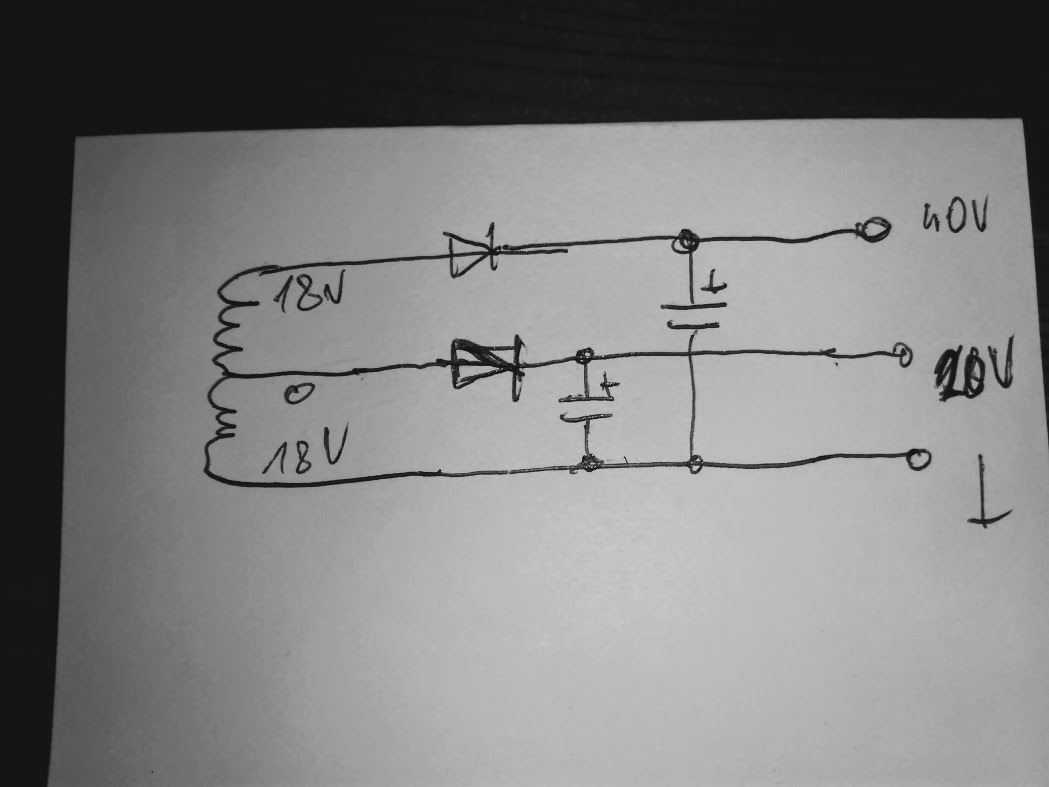

    Good day folks. I'm going to use a center tapped UPS transformer for a project and would like some advice on how to rectify its output. The two windings are 18v each and I already use those on the AC legs of a bridge rectifier to get around 40v out which is fine (the center tap is floating at this point), however a separate part of my project requires a lower voltage of just 18v, so how can I achieve that ? Obviously I could just place another bridge rectifier between the center tap and one of the legs, but that's not very space-efficient, so I was thinking of using 2 diodes on the center tap and other 2 already inside the rectifier....complicated I know, so I put together the rather horrible schematic to try and explain how I see it. Is this correct ?
    Wattevah...
    • 31250
    Re: Center tapped transformer rectifier question
    follow your current paths - boom.
    your shorting the windings with the diodes!!
      Build it and find out for yourself if your theory is correct.
      Look real close at your drawing.

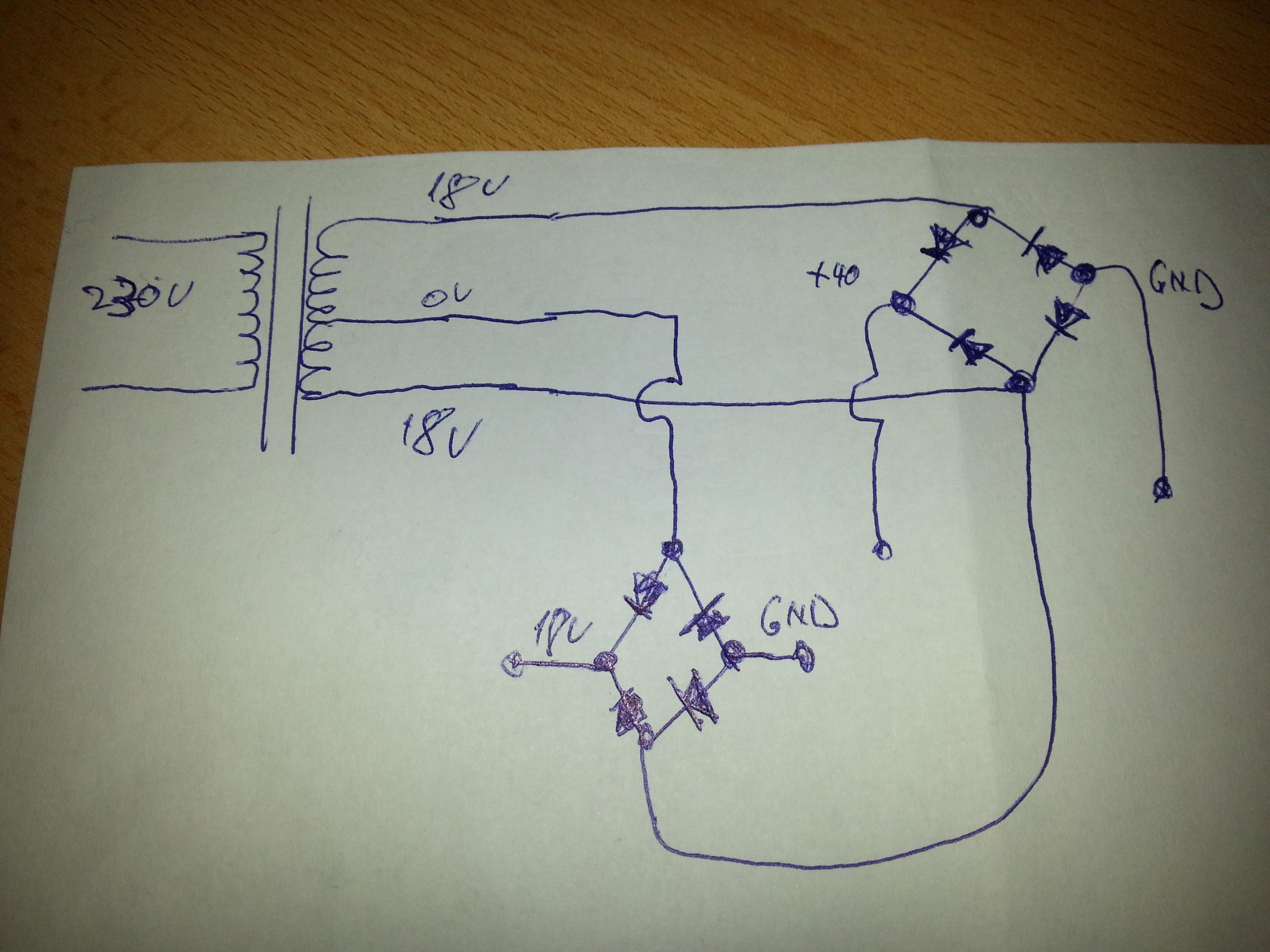

              Then I guess the only option is to have 4 diodes (a full bridge rectifier) for the other winding as well (can't mix them together): AC side of said rectifier goes to the center winding and one of the remaining ones and the output will be 18v DC.
                something like this

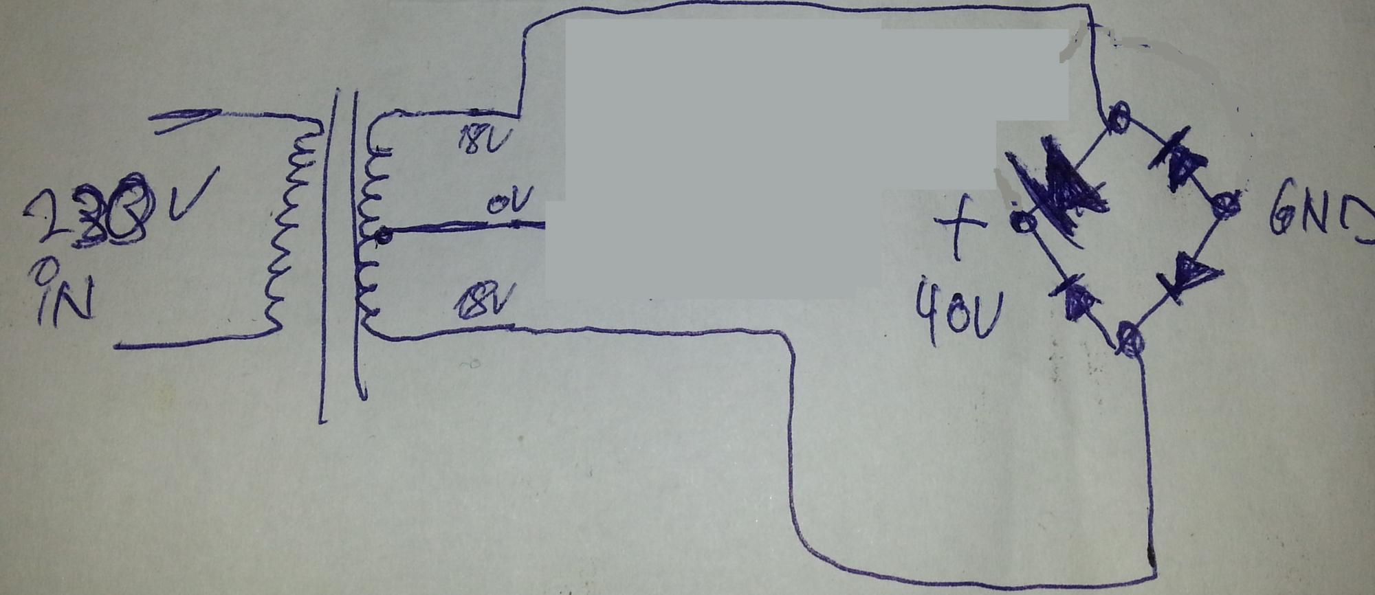

                        The "high" output of the transformer powers one of those ebay power supply modules and I also need a lower output voltage to power a DC-DC converter which runs a cooling fan for the thing...won't go into too many details on how I built this, but I tested it extensively with a variable laptop power brick which goes up to 24v and it works as it should, regulating the output to the fan based on temperature (nothing WOW there), so the voltage, while not too critical, I wouldn't dare let it go beyond 24v either. Current draw ? I'd say around 1A absolute maximum, if that (perhaps if the fan stalls or jams, worst case scenario).

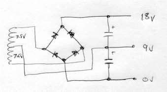

                              Keep it simple?
                              Follow the white rabbit.
                              • petehall347
                                • Jan 2015
                                • 4440
                                • United Kingdom
                                Originally posted by goontron
                                Keep it simple?
                                is the 9v plus or minus ?
                                • goontron
                                  5000!
                                  • Dec 2011
                                  • 4108
                                  • US
                                  ^ Positive.

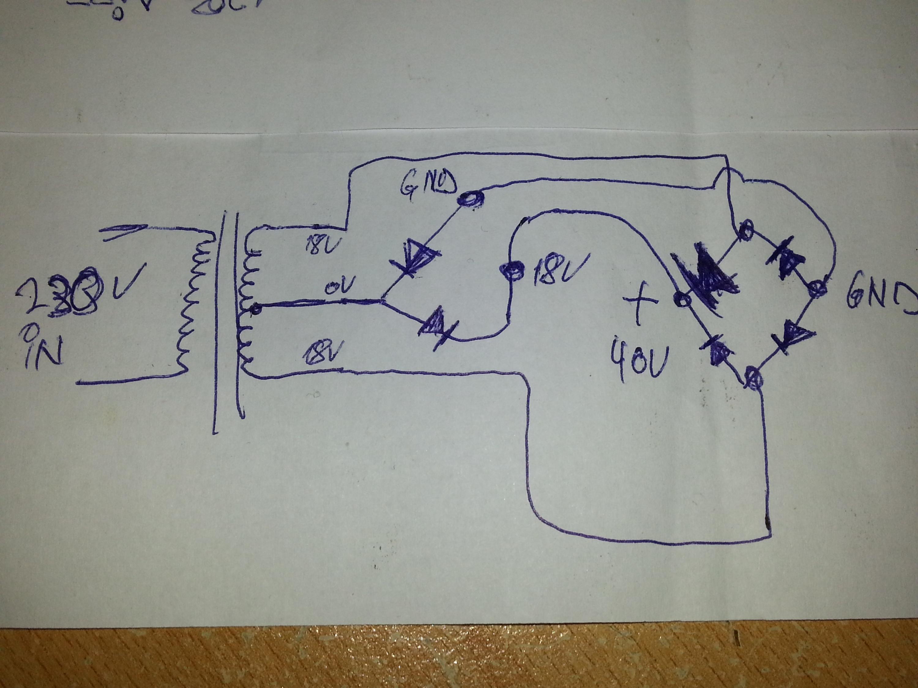

                                      How does THIS looks ? It's actually the original idea I had and I then thought I could simplify by omitting two diodes. One of you guys posted something similar, but the values were off, so THIS is what I believe it should look like.

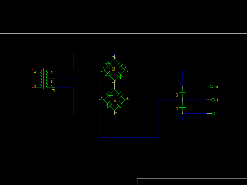

                                        mariushm has the only workable solution as far as I can tell - only 4 diodes needed and though his drawing only has 7.5V windings, you can use full 12V (24V/CT). A lot of these other "solutions" don't quite work because the two windings are not isolated from each other. If there is a need for isolation of the two GNDs (i.e., 0V potentials), then you'll need two isolating switching converters to get this done or another transformer that has isolated secondaries...
                                        Also note that the capacitance on the output legs will need to be fairly large to filter the higher voltage output...
