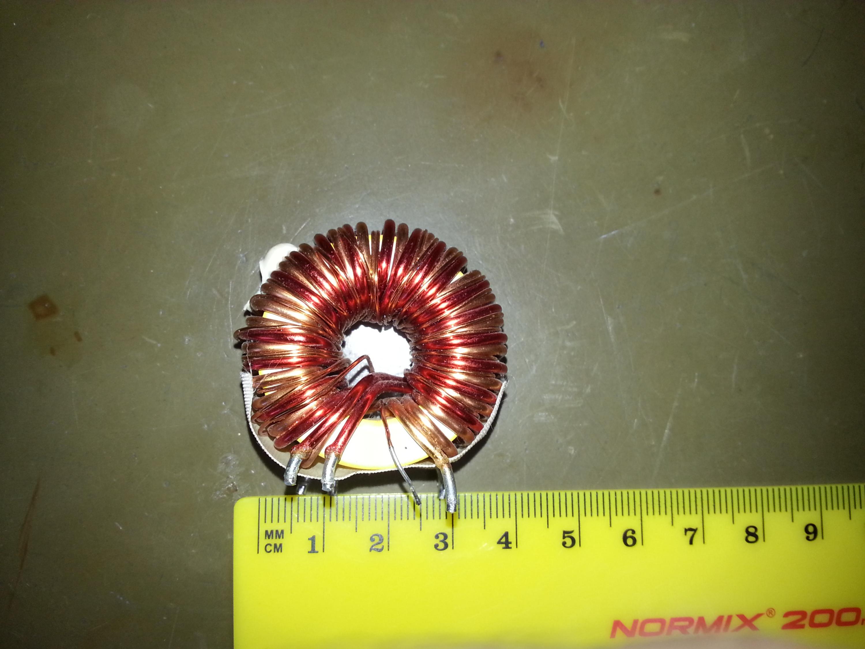

    Good day folks. Some of you may know that a while ago I bought myself one of those Ebay adjustable power supplies which you feed a DC voltage and it does the DC-DC conversion for you - simple and straightforward. Now to power it, I'm planning on using a PSU transformer, which may be overkill but it's the only thing I have lying around frankly
    Of course, the 36v coming from this need to be rectified, so I'd go: transformer>into bridge rectifier>into some smoothing caps and into the input of the DC-DC thingy. Now in many DC rectification applications I've seen, other than maybe very cheap ones, there's a coil in series with the load, meaning in my case, the coil should go between the caps and the input of the DC-DC converter. There IS a coil already on the board, but it's for the OUTPUT stage of the converter - I'm talking about the input, the side where the rectified, unregulated DC is coming in.
    Now I know the very basics of coils and what they do in a nutshell, but haven't done any extensive research or read any books on them to really know the nitty-gritty, so leaving all the numbers aside, what would happen if I took a random big-ass coil I found in my junk bin and just put it in between the rectifier stage and the DC-DC ebay PSU ? The biggest one I found actually has 3 coils in it, judging by how the pairs of wires are arranged, so I'd use one of the 2 larger ones. Would the result be:

    Re: Putting random coil after bridge rectifier for PSU
    dont try using a random coil.
    the circuit is called a Pi-filter.
    the henry's of the coil, and the esr of the caps are selected to create a tuned filter that matches the frequency of the power supply.
    it's a lot of math and work, just to use smaller caps.

      So your answer would be B) - don't
      Ok, had a very quick look on wiki on Pi filters and it's exactly what I had in mind, however, because I don't have the necessary equipment and knowledge to measure everything that's required, I'll probably just leave the caps and scrap the coil (assuming we're talking about the schematic there)....any particular value of caps that's "best suited" for this application ? (which is a misnomer really, since there's no such thing as "best something" in electronics)...
                  If you are powering this with a 50Hz mains transformer you can pretty much forget about the series coil. Big capacitor (>4700uF) after the rectifier bridge and you'll be all set. If you're going to be powering it from another SMPS, then yes, it is worth studying some documentation on Pi filters.
                    Yeah keep in mind inductors have been and still is the Achilles' heel to electronics... At 50Hz mains, the inductor you need would be ridiculously huge, so don't bother with it, bigger cap is best you can do.
